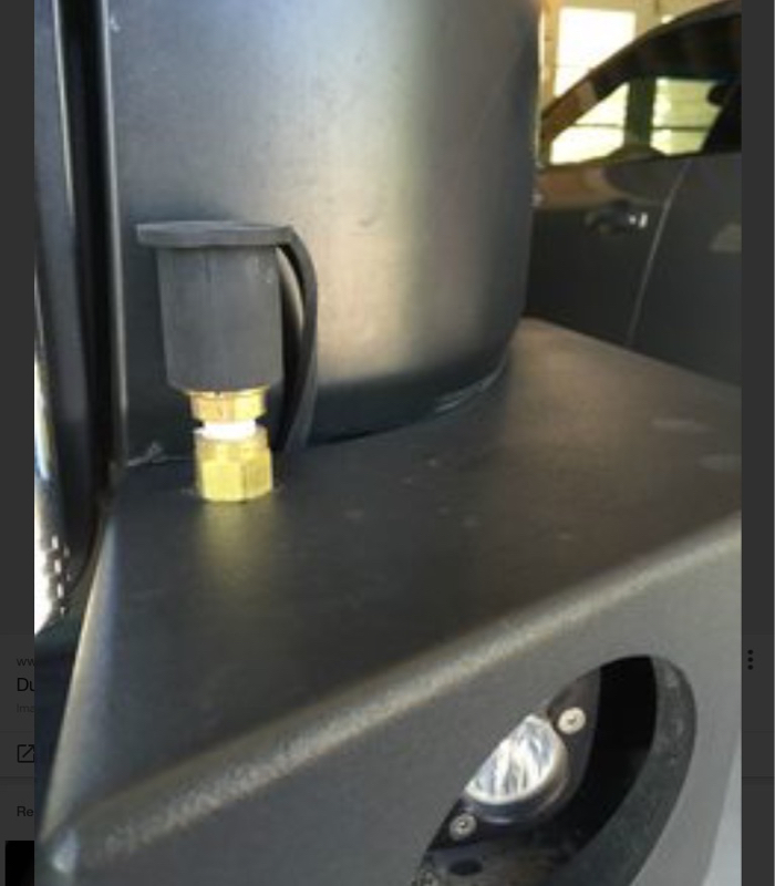

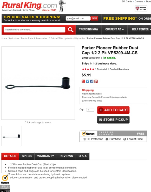

When you plum your quick connect outside, get one of these dust caps for 1/2 couplers to slide over it. Will keep it clean an usable for many years, I've got quick connects on my jeep bumpers and have had these covers on them with real good luck.
   / Outside air line outlet #17
What provides the air on the jeep?

Don't know why it wouldn't. I have air quick chucks on the front and rear bumpers of my truck and they still work just fine after being on there for several years now. I imagine being exposed to the elements on a front bumper is more of a severe environment than a static install on your house.

I used a large York a/c compressor off a ford truck.
