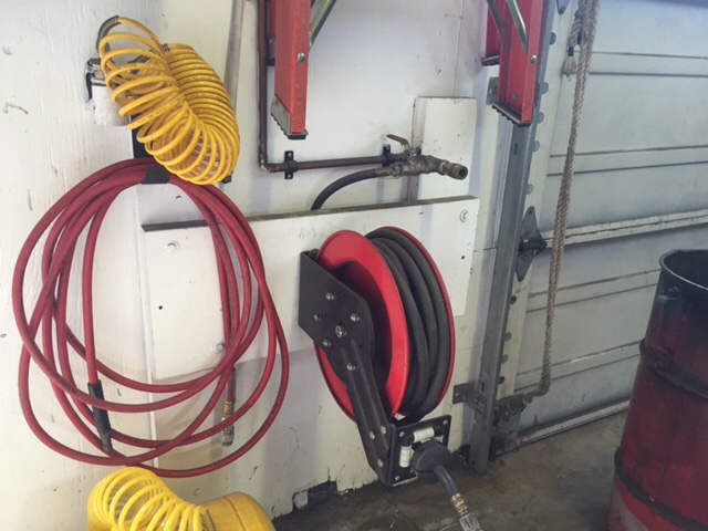

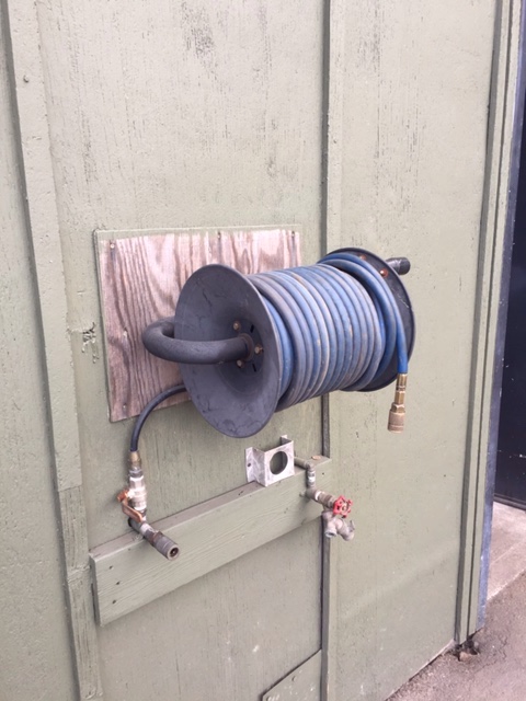

I have compressed air outlets near my shop door. Inside and outside.
Live hose reels are installed with shutoff / exhaust valves to relieve pressure on the hoses when not in use.
Outside wall
Inside wall
Terry

Doesn't the hose on that outside hose reel get really stiff when it is cold outside??
/ Outside air line outlet #7
I've never had a problem, but then we have mild winters here.
