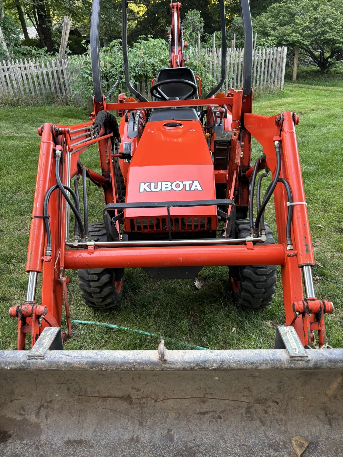

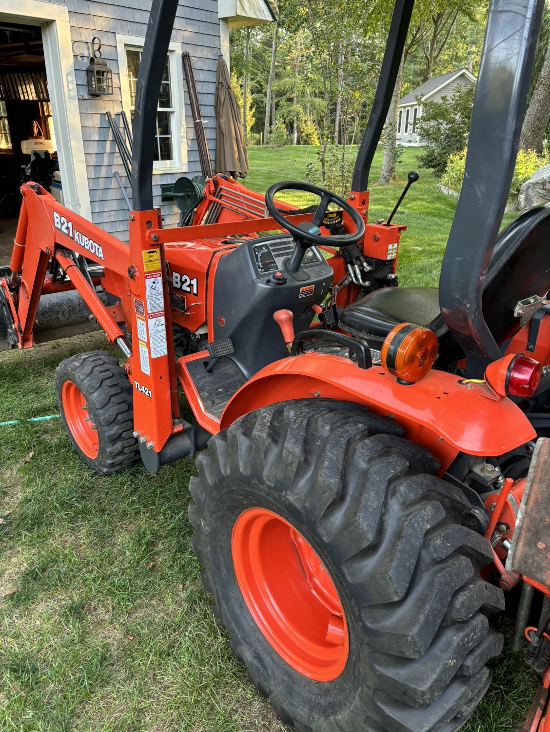

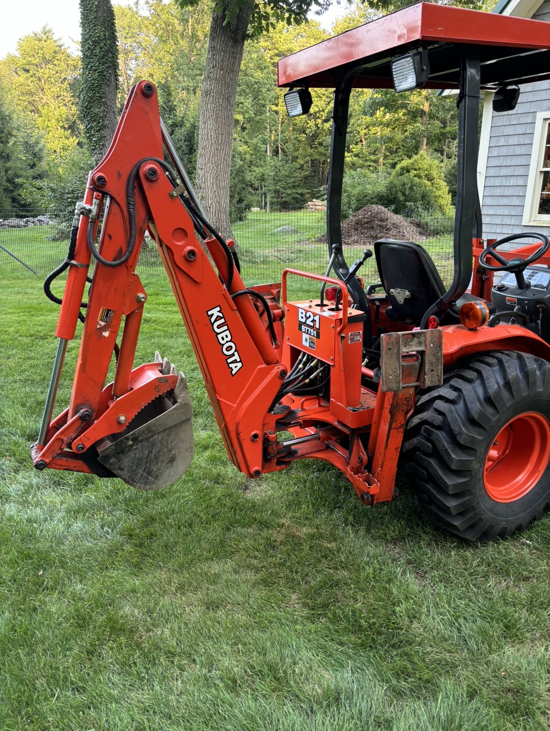

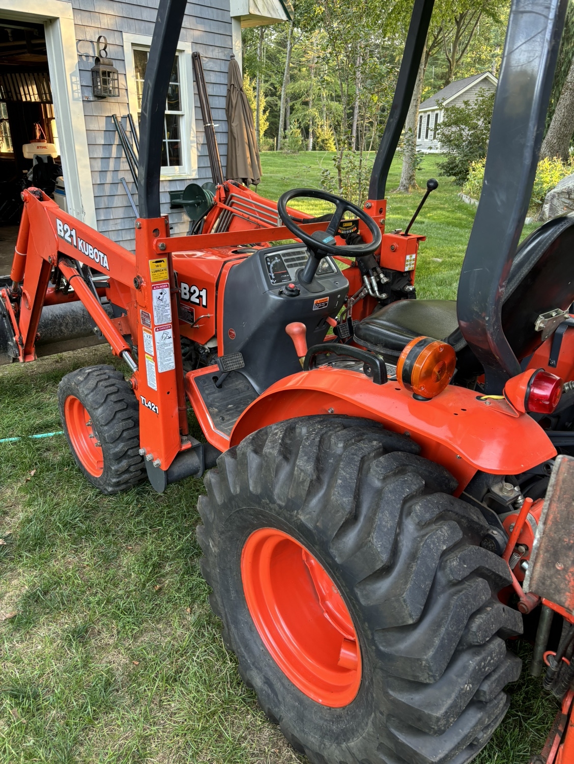

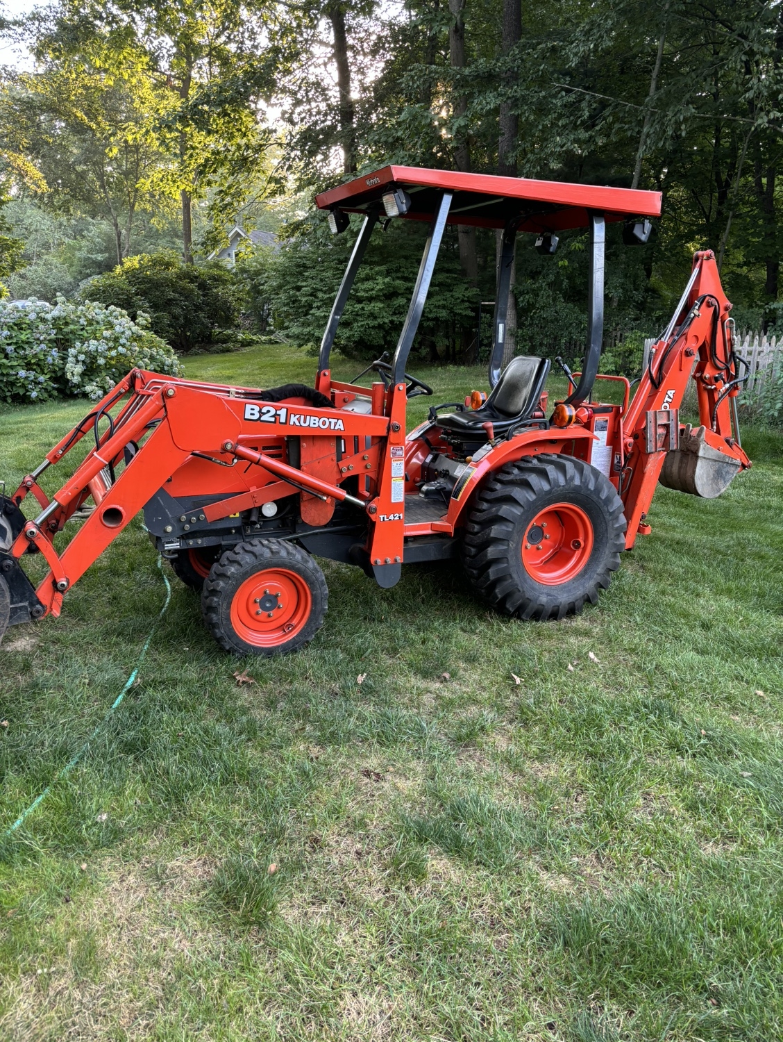

Here’s some pictures of my b21 today- it’s not clean but pretty good shape for 23 years and 750 hours - and I know the maintenance and what it needs - two hyd cylinder seal kits when it gets bad enough- just a few drips when sitting for a week.
Ordered the ati quick attach and plate today 1400 delivered so keeping this one.

That’s a rarely fine looking B21. Sweet! Looks new! Appreciate in value asset, get to use and enjoy it is the best kind of investment.
Surprise it doesn’t have a step on the left.
Our B26 was the first backhoe that had rubber outrigger pads. Don’t have that much pavement but was surprised how much traction they provided on ground. Also the extra height helped plumb on our slopes. Less damage to our landscaping.
If adding grapple be sure improve the front guard from sticks.
Please share your experience with SSQA.

Thanks for the kind words and its stored inside all the time and grease/oil and filter done per Kubota specs,

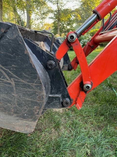

The step into the deck wasn't on the B21's and as far as the ATI Tach All - I am also concerned about the round back HD bucket I have and how a flat plate is going to mount.
I have a request into ATI now on how the plate will adapt to this TL2156 round back bucket and update once I get it and how it attaches.

Thanks for the photos! Wow! That is a beautiful classic tractor from an era when construction machines were made as good as they could be. It looks near new. I was expecting something entirely different.

Thank you Rscotty - its a work in progress, and yes the B21 has two hydraulic filters - one large 8" Long and one small 5", then the suction side screen inside the sump.
I heard from ATI this AM that the TL2156 HD round back bucket is "uncommon" and that the QA plate would need modification with a plate at the bottom. I would likely cut the existing brackets straight to fit the QA plate and then weld a spacer on the bottom.
I am considering a new 60" QA bucket instead of the $300 QA plate and mods as I need to have the local welding shop cut the brackets off mine and do the welding. I have a welder, but not the best, so I put my ATI Tach All order on hold - I'm in no hurry,

Modified an M5030DT loader 30+ years ago to SSQA. Similar HD round back bucket. Welded ssqa plate to the bucket pin-on flange plates without cutting them. Lost some roll back articulation and maybe some breakout force from having extended length from pivot point. Cutting the flanges and rewelding the plate was on to do list but never got done. Had too much fun with grapple and had other skidsteer buckets to play with. Adapter plates were $50 from Bobcat dealer at the time.
Lot of sources for SSQA plates now. $300 seems high. Lately prices have been a real shock. Could buy a used bucket for that.
