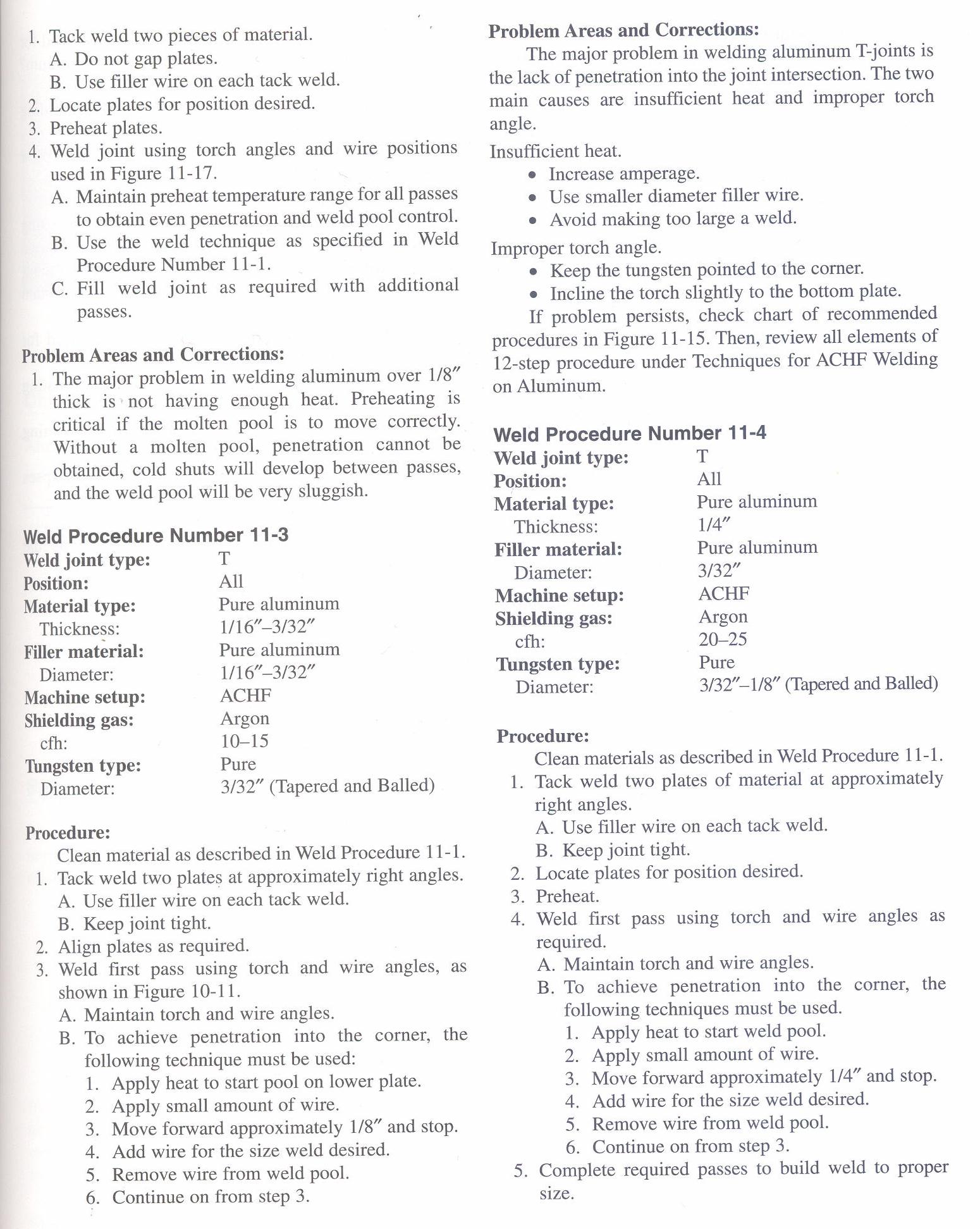

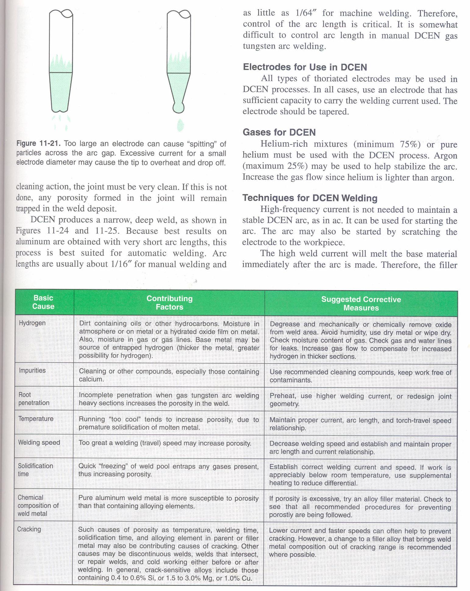

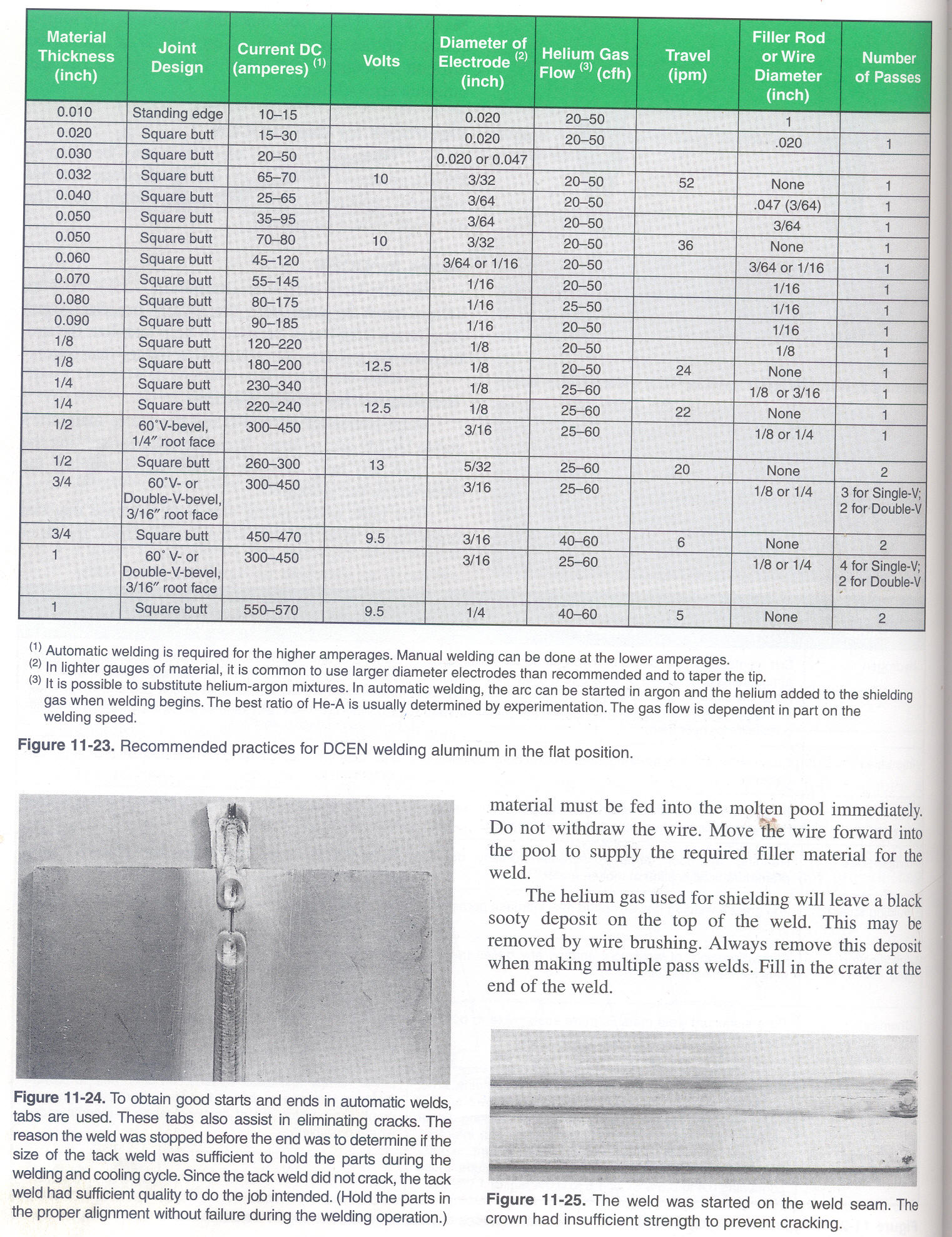

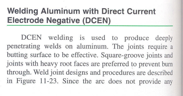

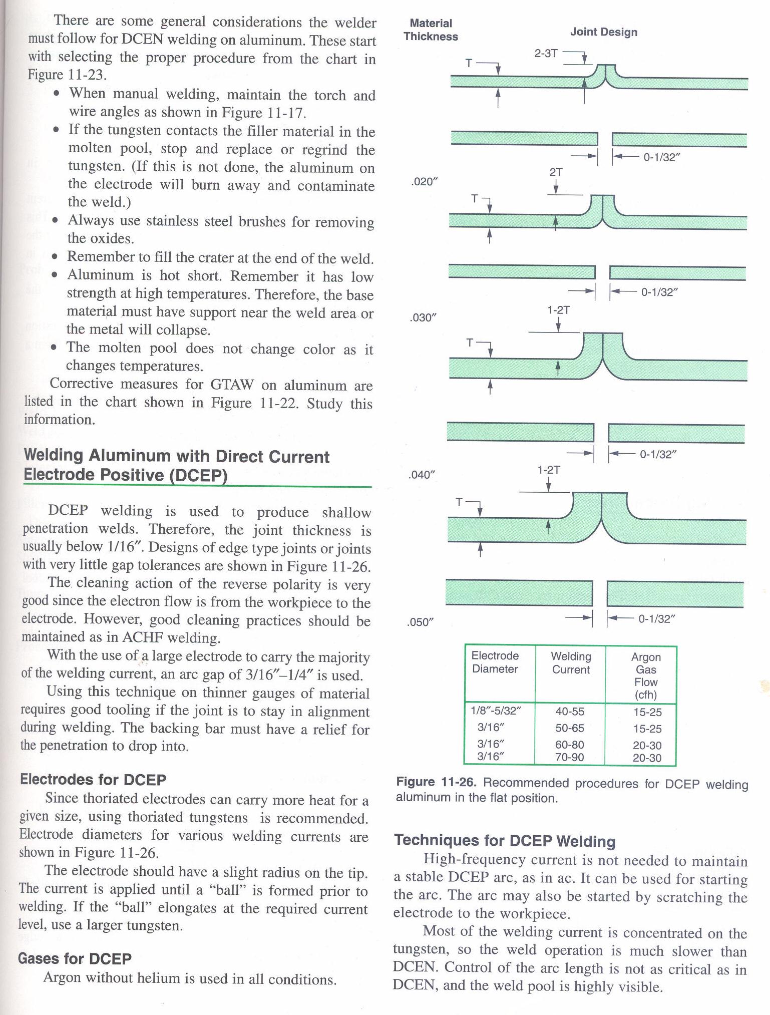

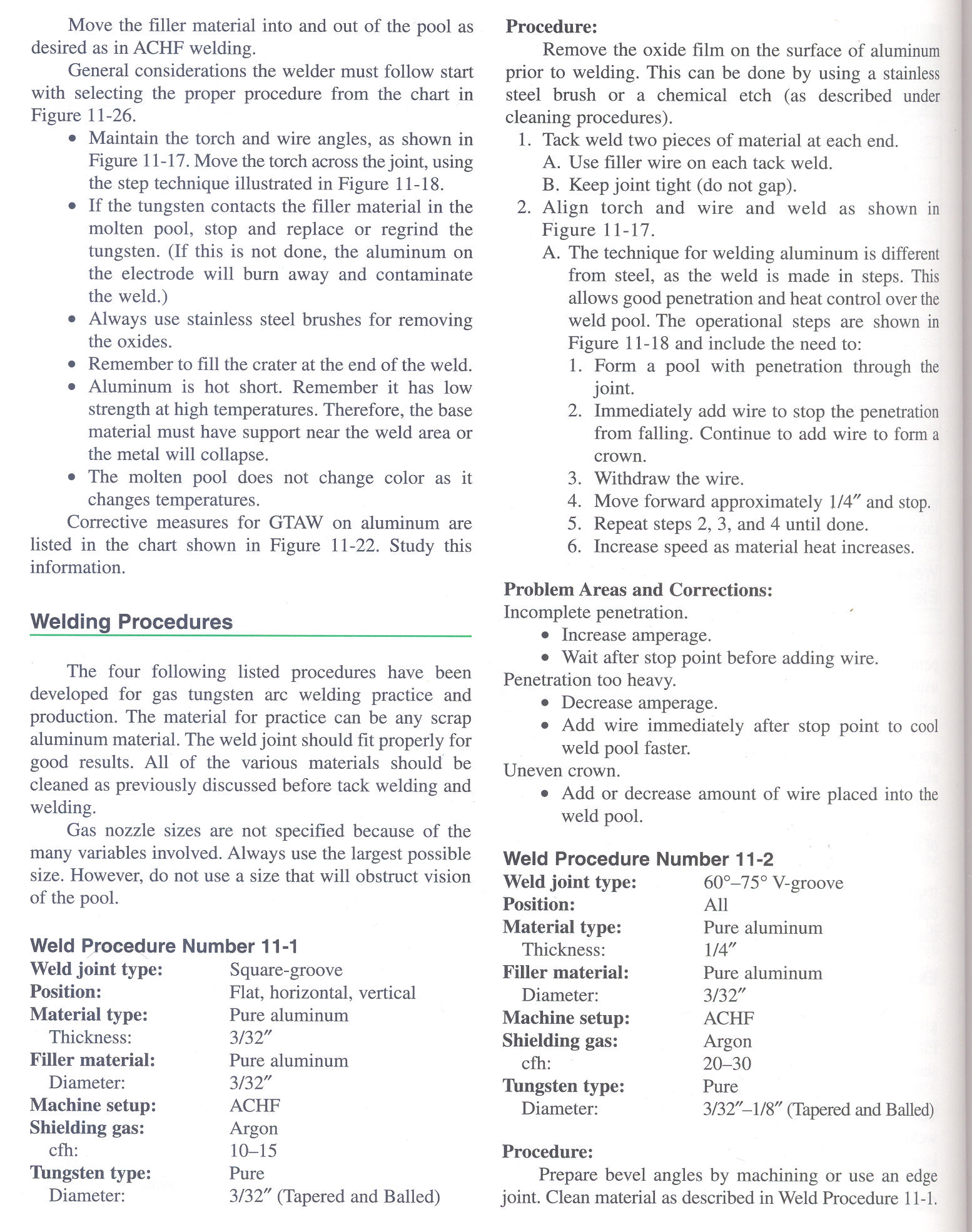

Oh, you can do it old school, DC with helium. Here's one I did years ago.
Shield Arc, can you expand on that a little? I have been told you can't weld aluminum with DC, but obviously that's wrong. Thanks.
   / Notch Master #34
When Linde invented Tig welding aluminum it was called Heliarc, and this is how it was originally done.
Hopefully you can read all this, it will explain better than I ever could!:eek:
