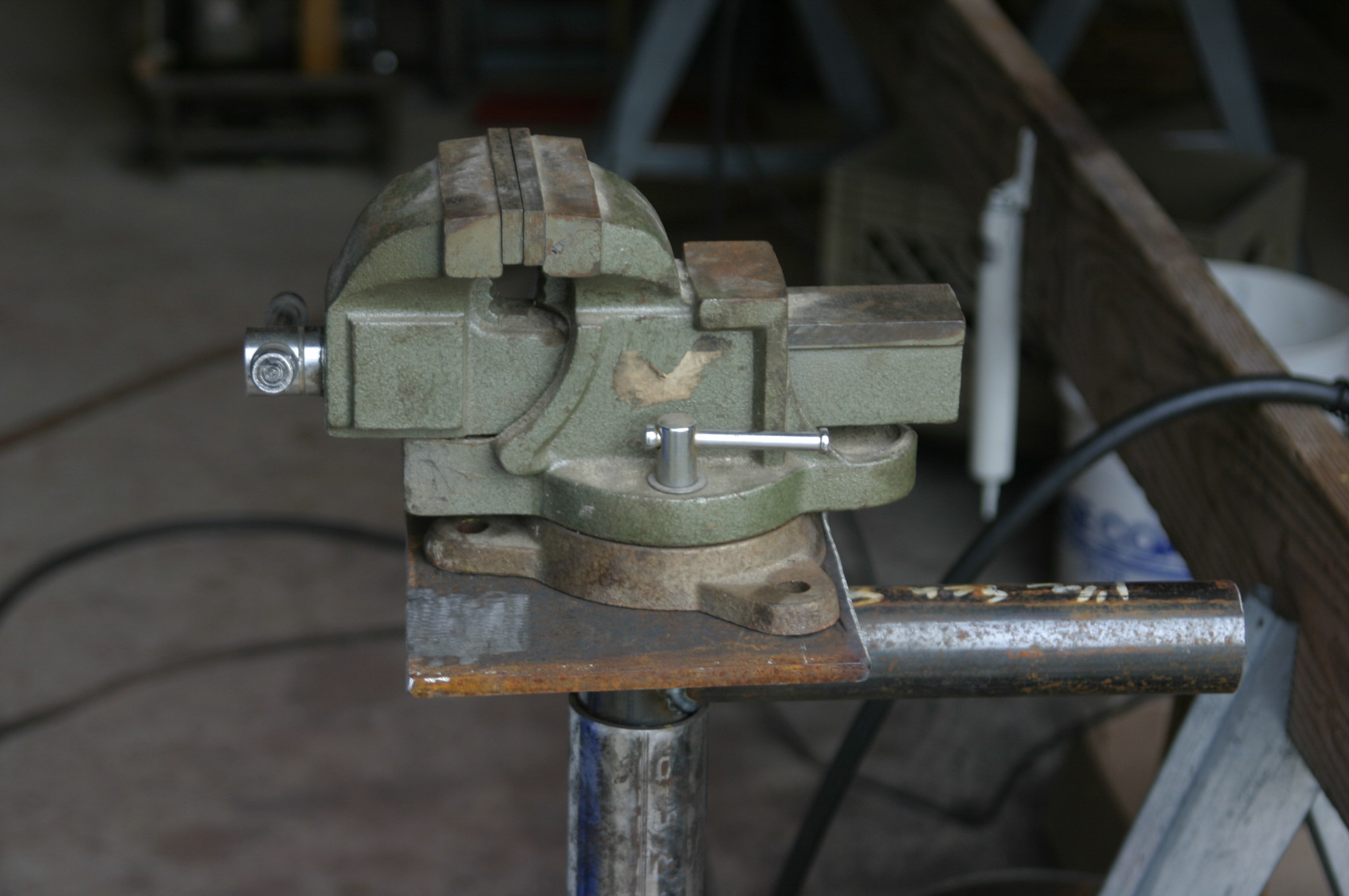

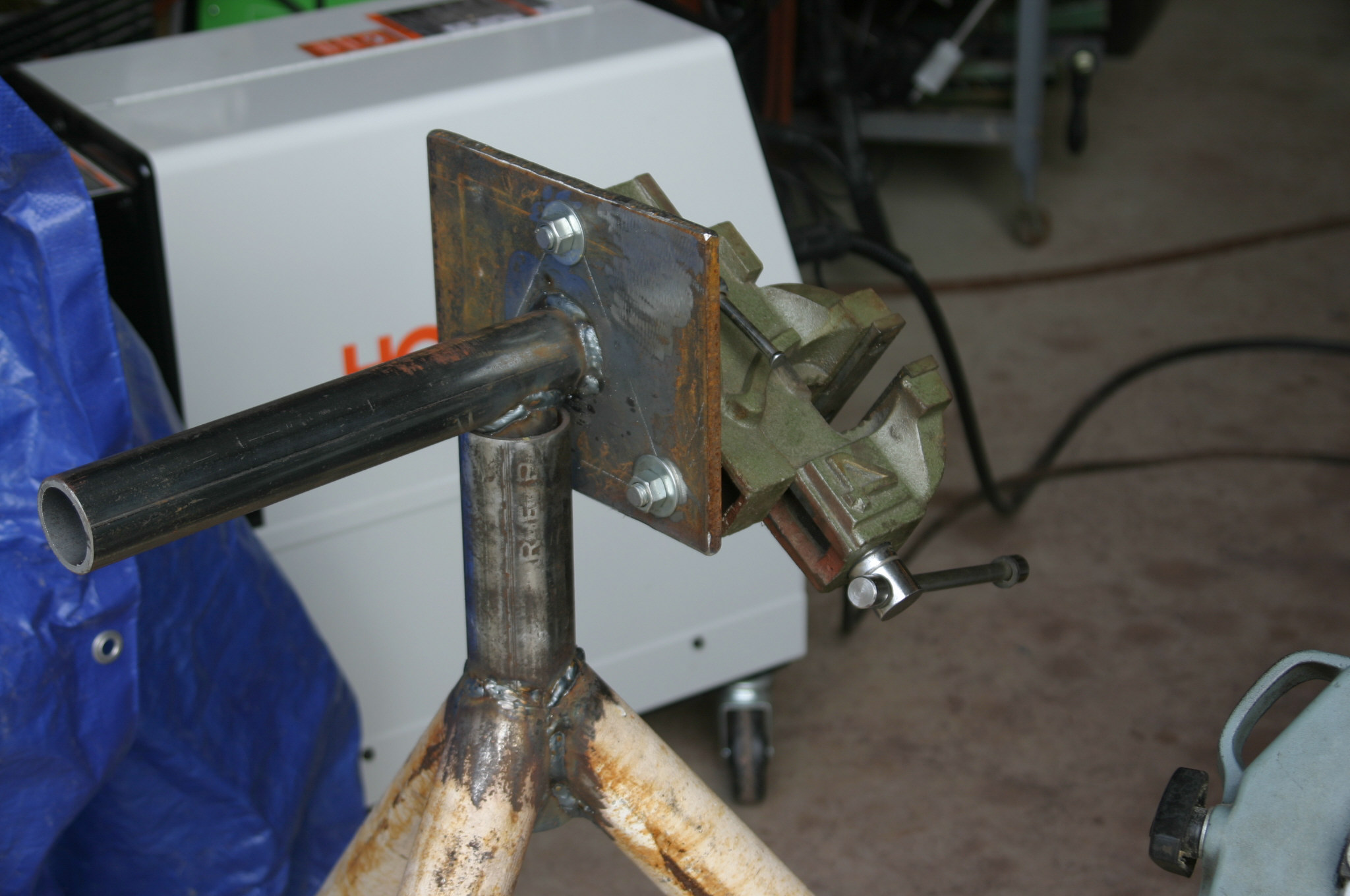

Guess I'll make a base for my vise tomorrow. That'll be handy too, drop it in the same tripod. I'll try to be pro, tho, and weld the bolts on the other side.
I would drill, tap, use threaded stock and use red Lock-Tite. They won't come out, unless you need them to at some point.

made this up today, now I'll be able to find my vise.

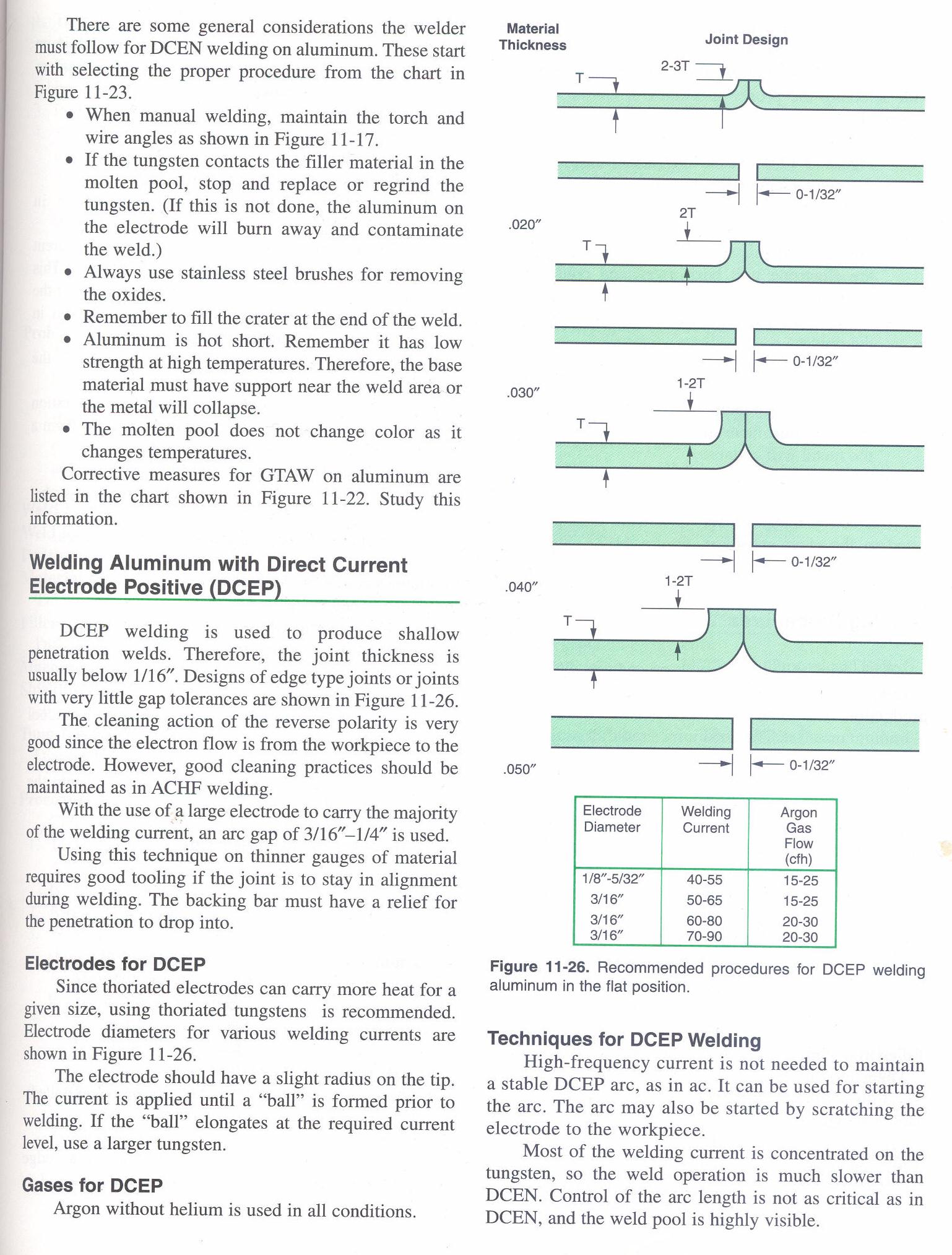

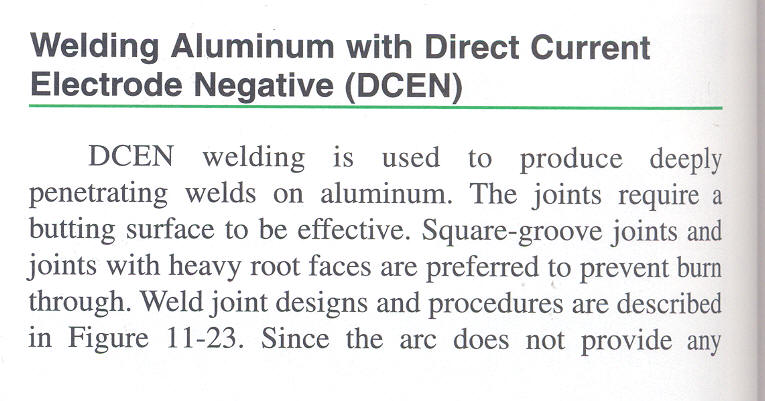

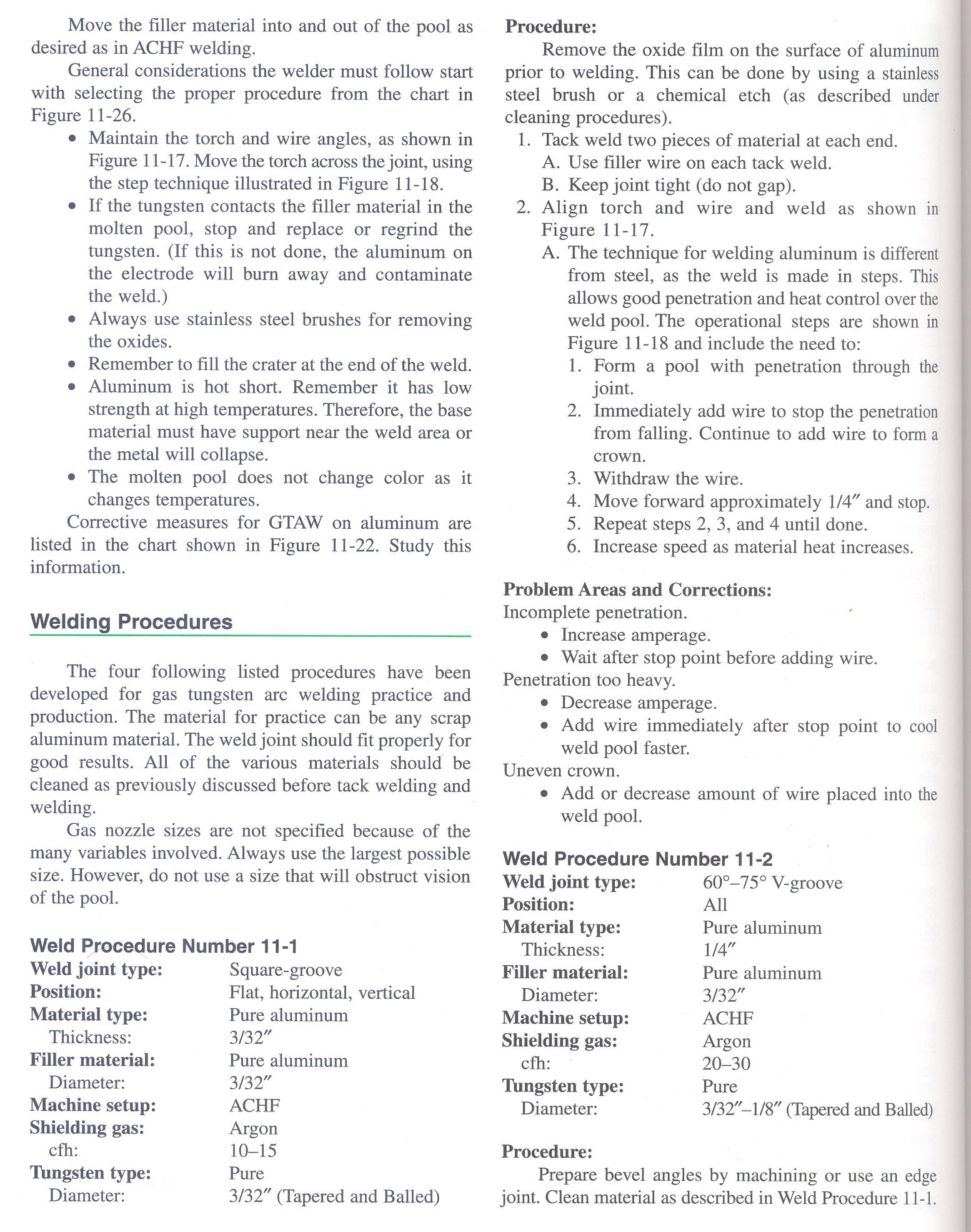

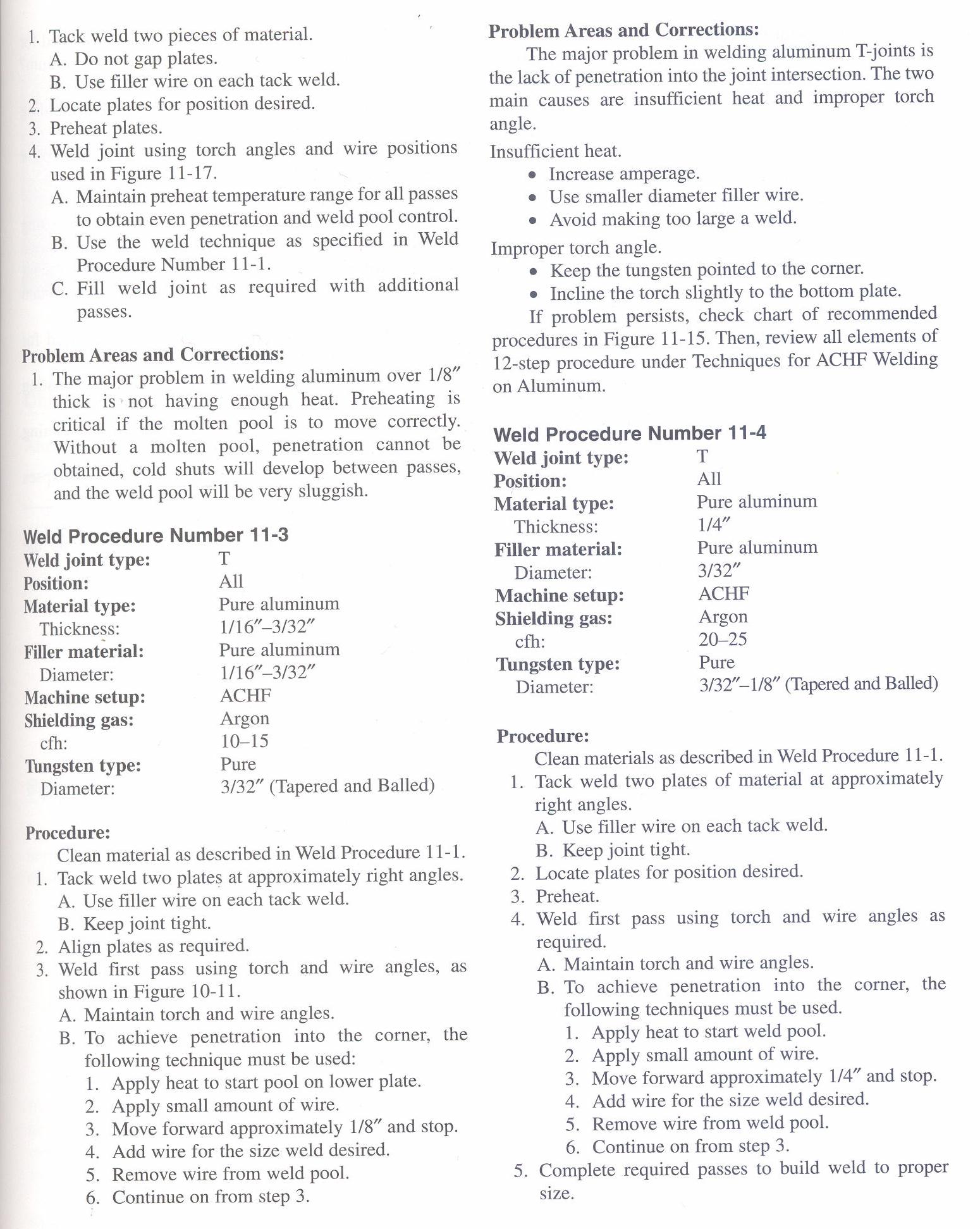

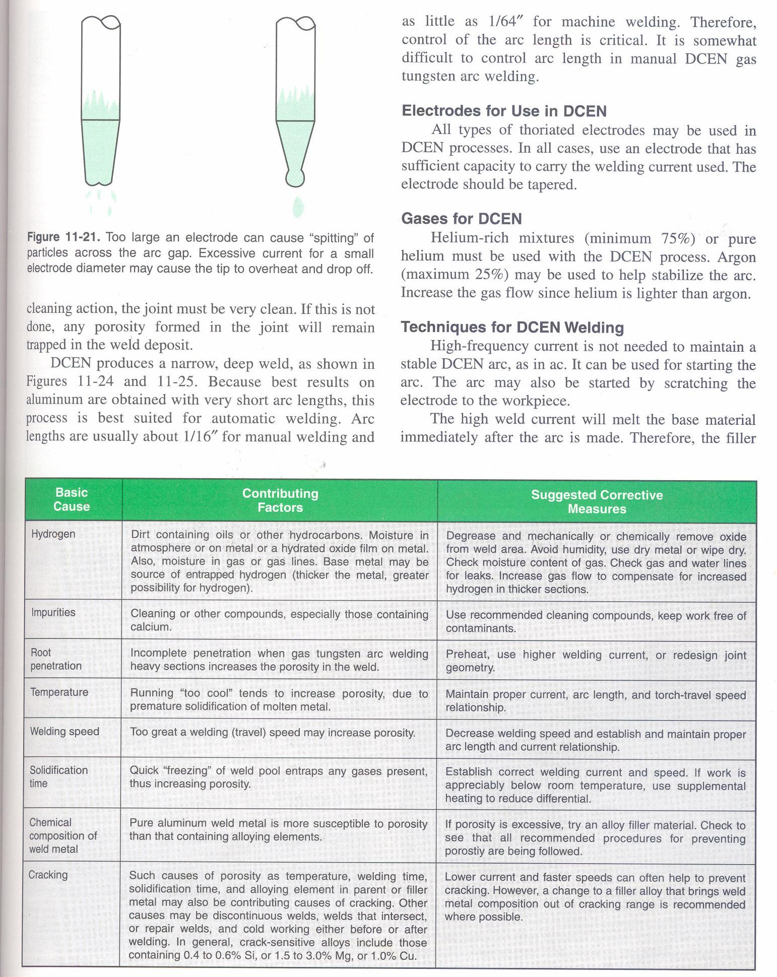

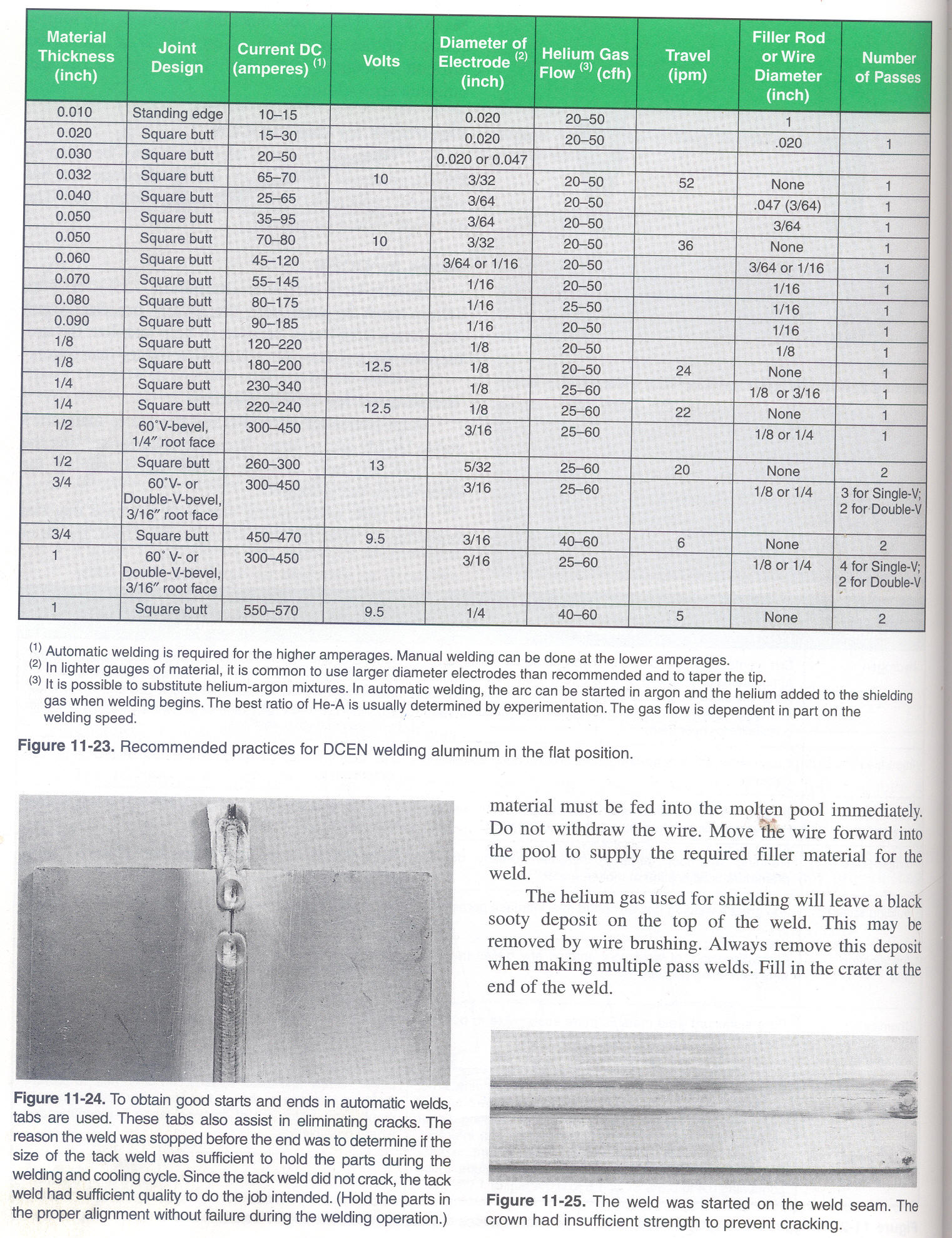

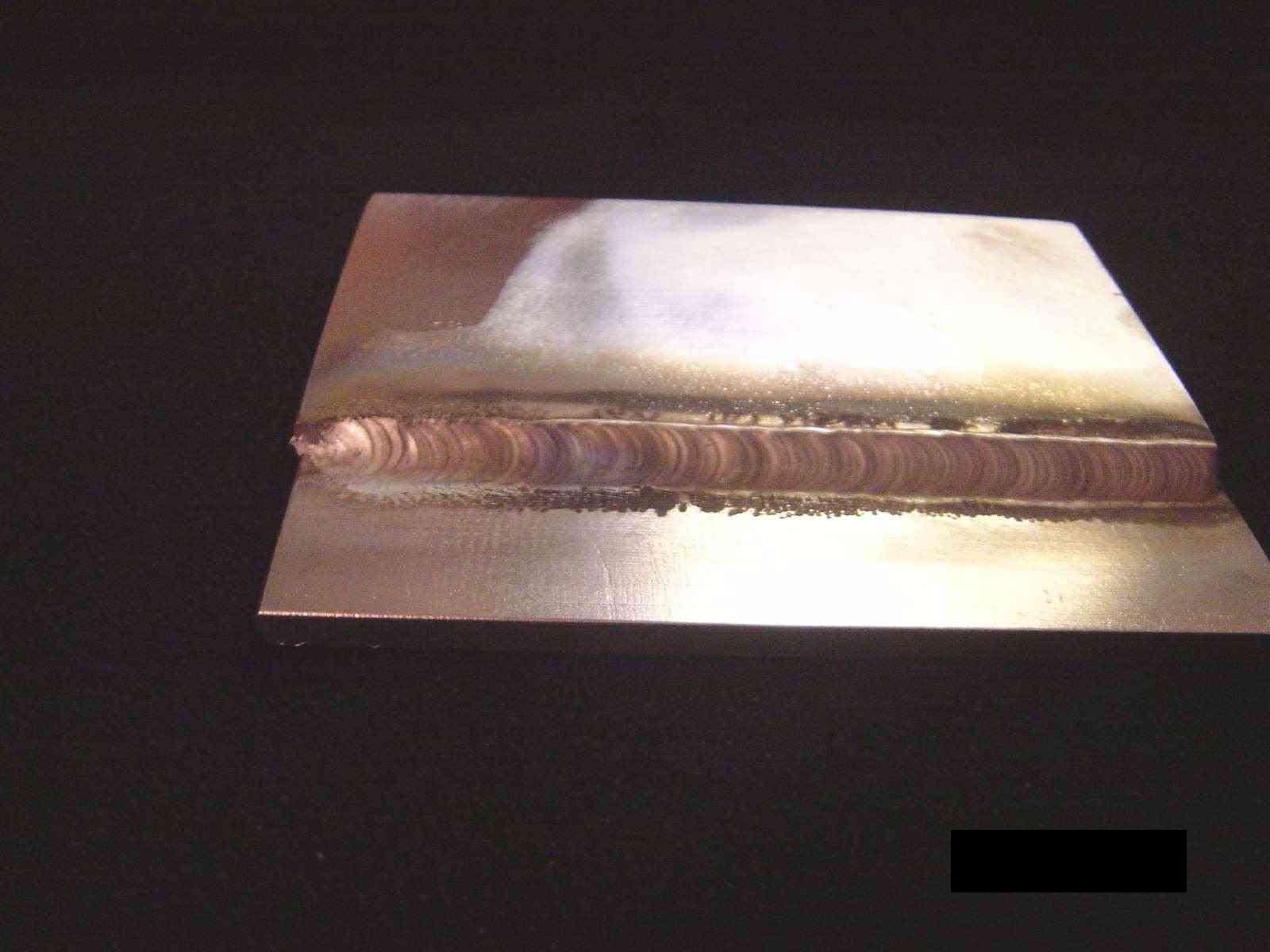

Shield Arc, can you expand on that a little? I have been told you can't weld aluminum with DC, but obviously that's wrong. Thanks.
When Linde invented Tig welding aluminum it was called Heliarc, and this is how it was originally done.
Hopefully you can read all this, it will explain better than I ever could!:eek:
