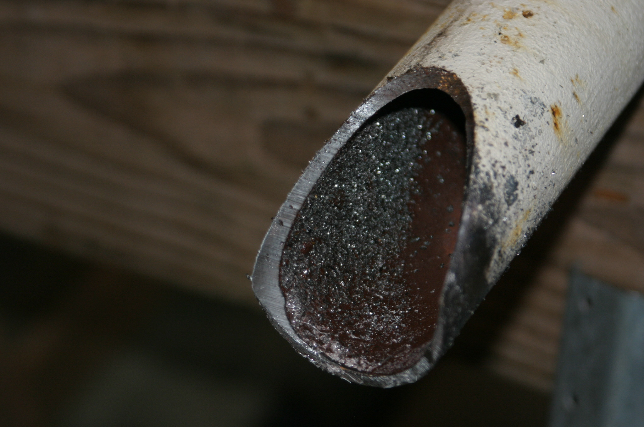

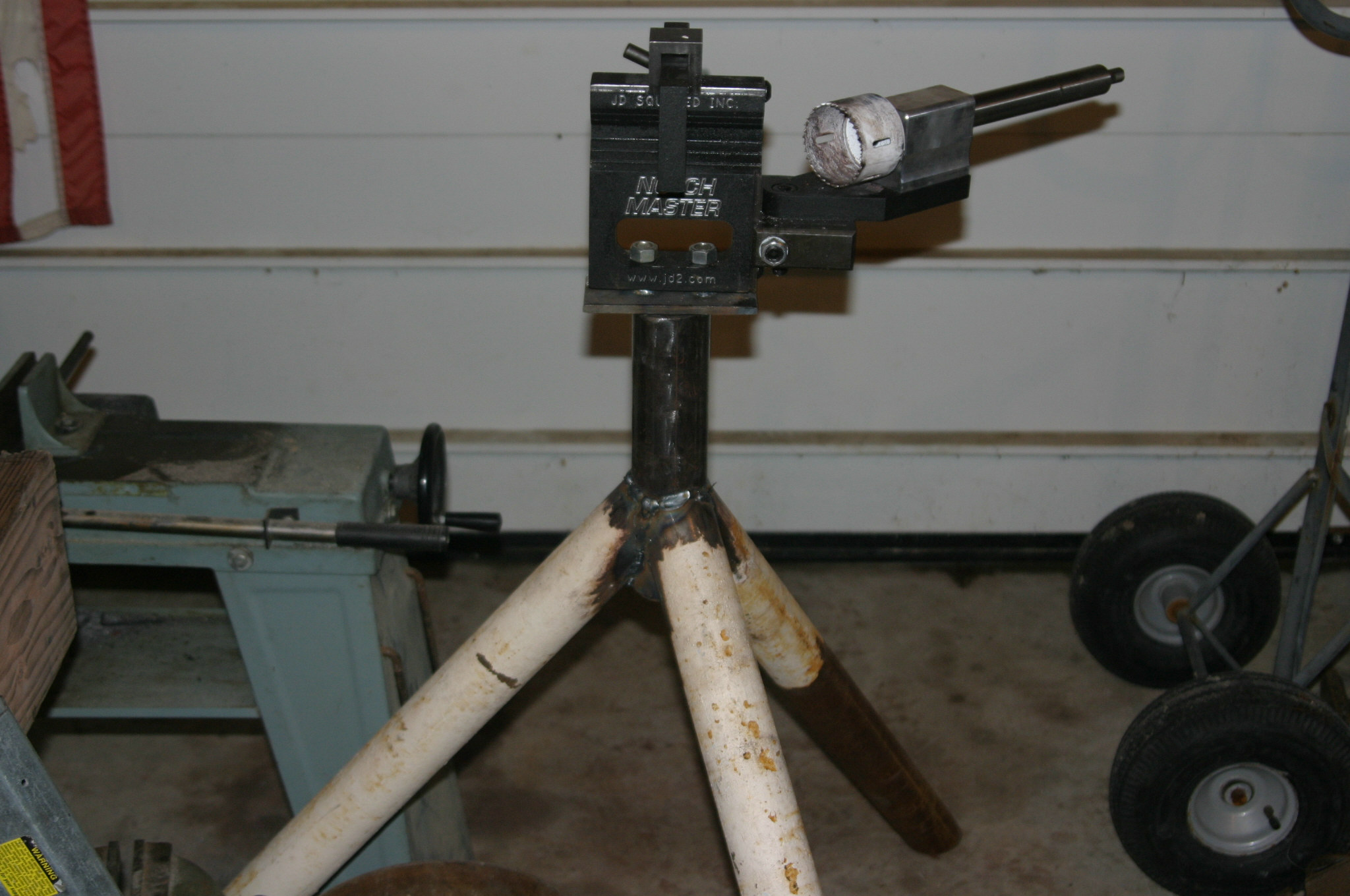

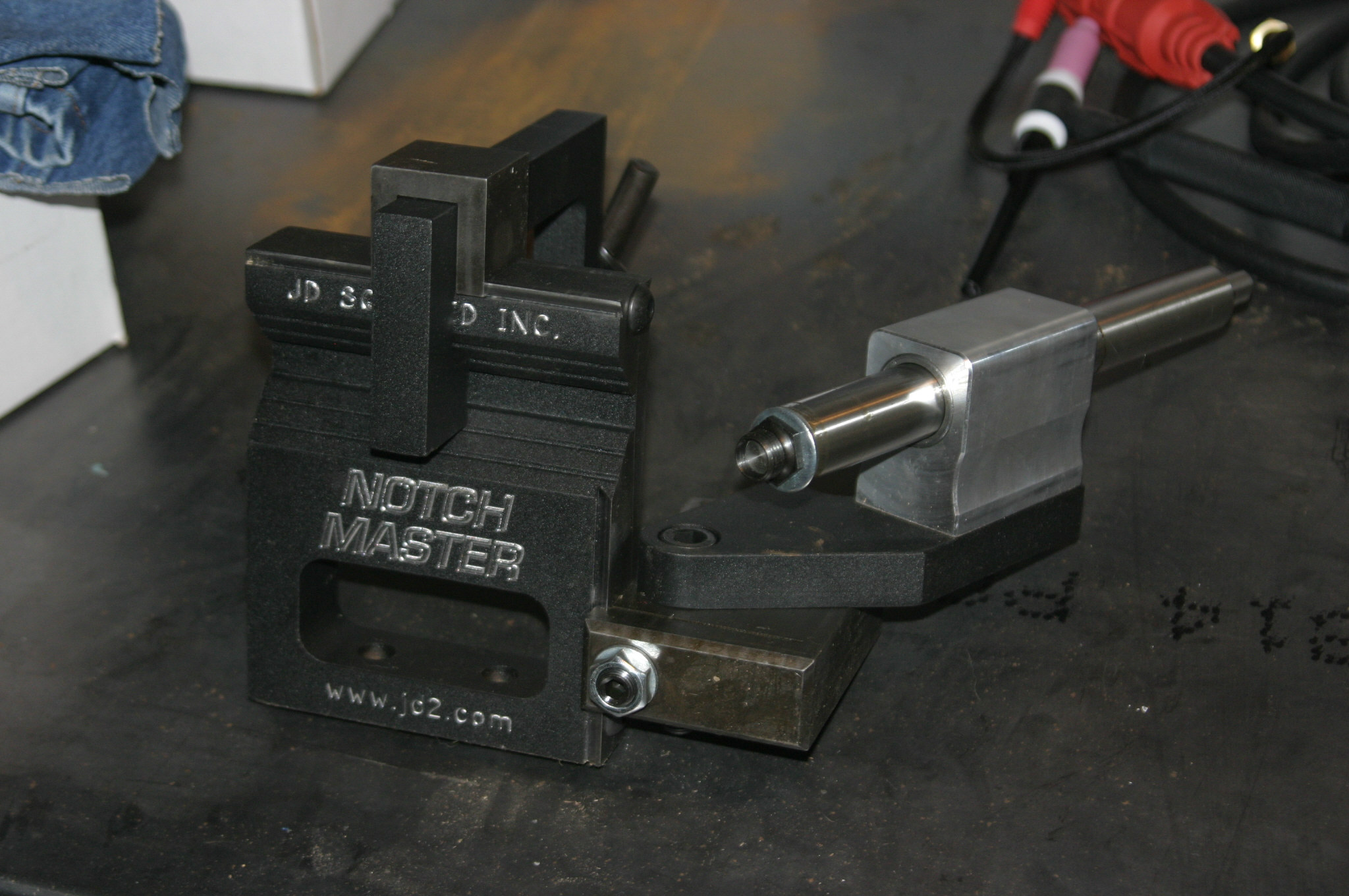

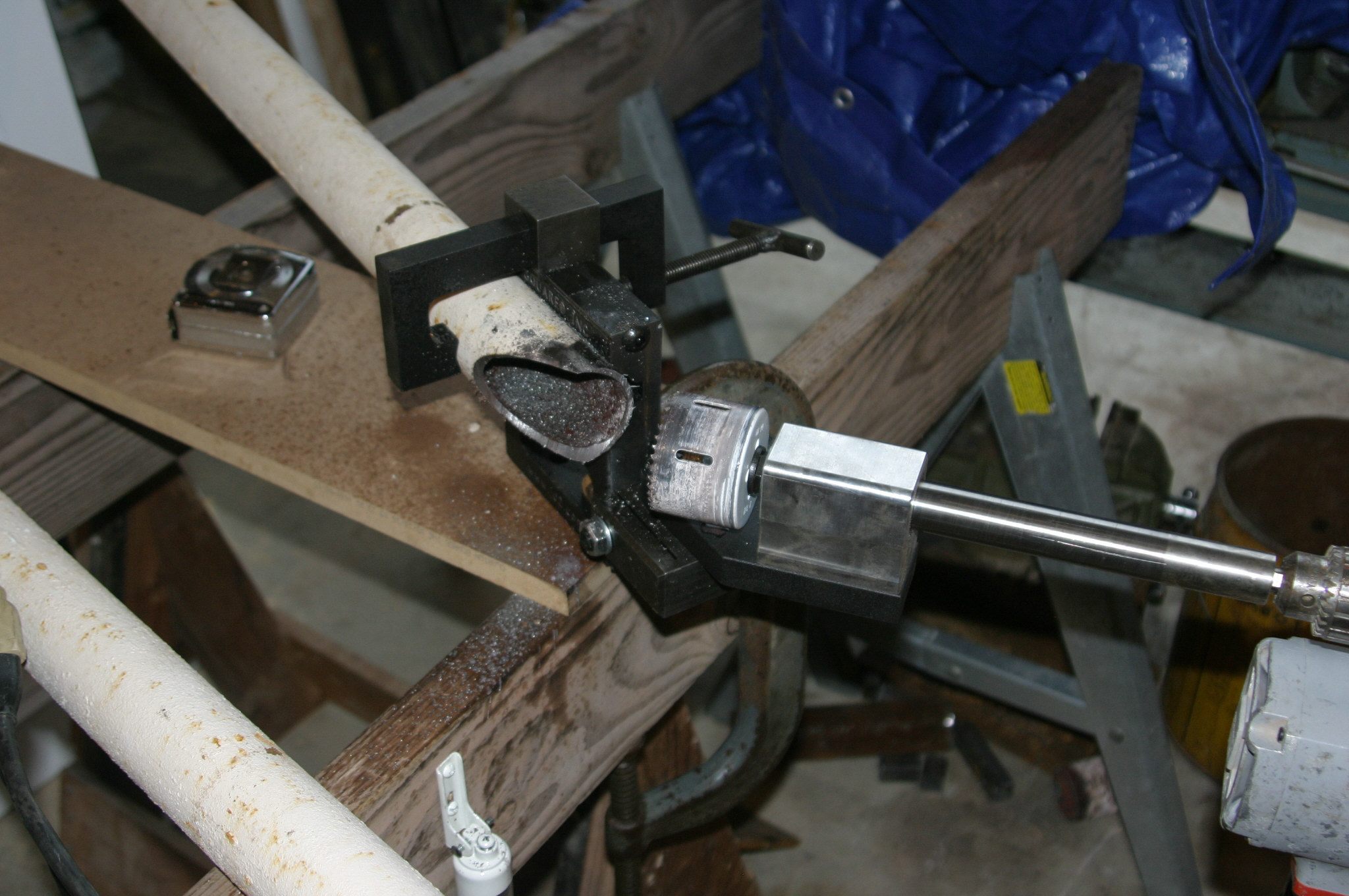

Tried this out yesterday, great tool.. first couple cuts here to make legs for a tripod to hold it. I set it on 50*, the max, and cut the other end 40* flat on the bandsaw for the feet. I think it's going to come in handy as a pipe vise too, for holding stuff in general. :thumbsup: 2" sched 40 (?) 2 1/2" hole saw.

That is really nice cut!
I wish I could come up with more projects with pipe / tube. Been waiting for an excuse to buy a tube bender that will bend 180 degrees. Then of course I'd have to have a notcher as well:D. For now I just use the mil.

That things nice! I can see that being really nice for working with pipe. Sure beats trying to fish mouth tube with an angle grinder...

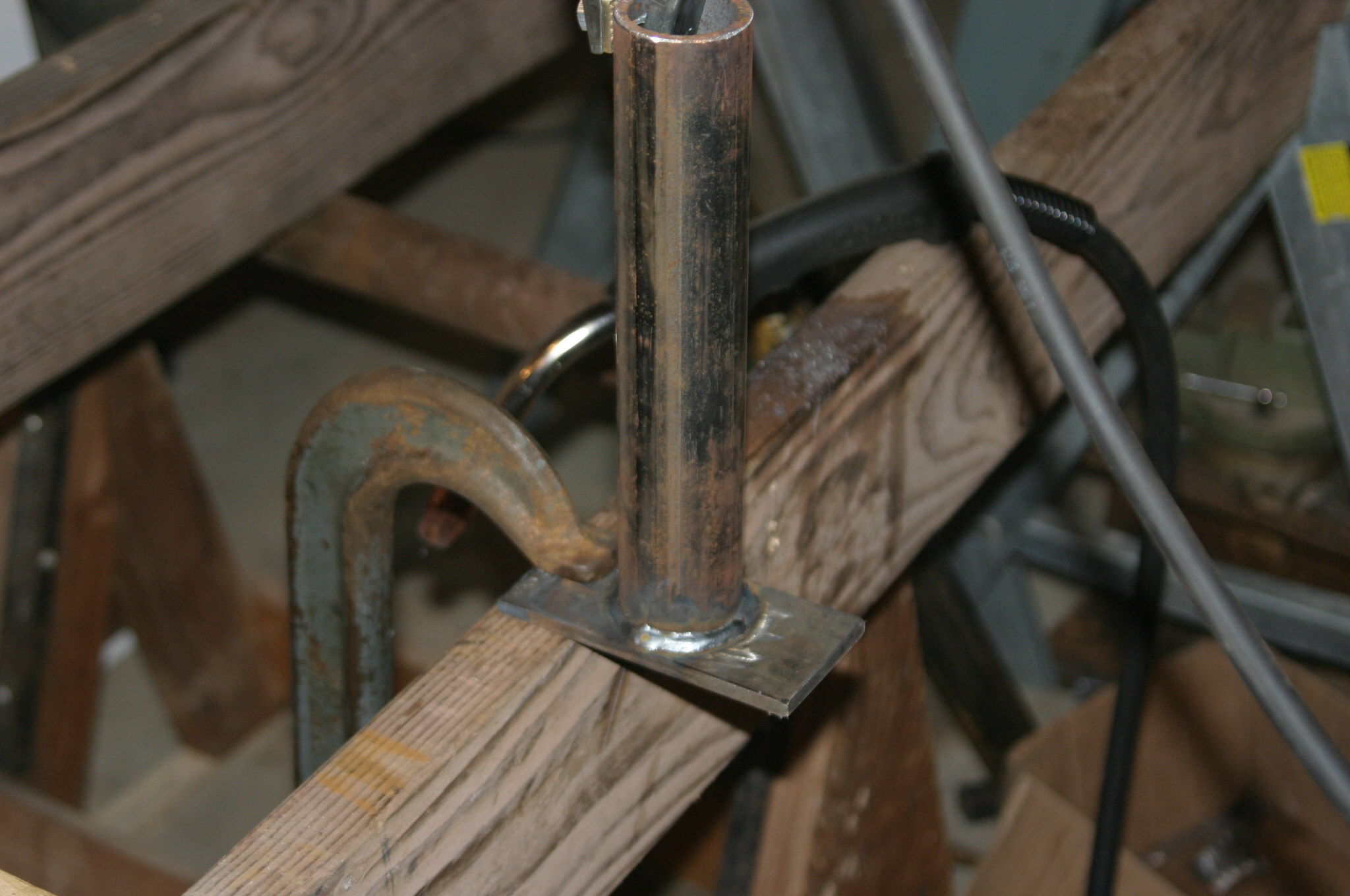

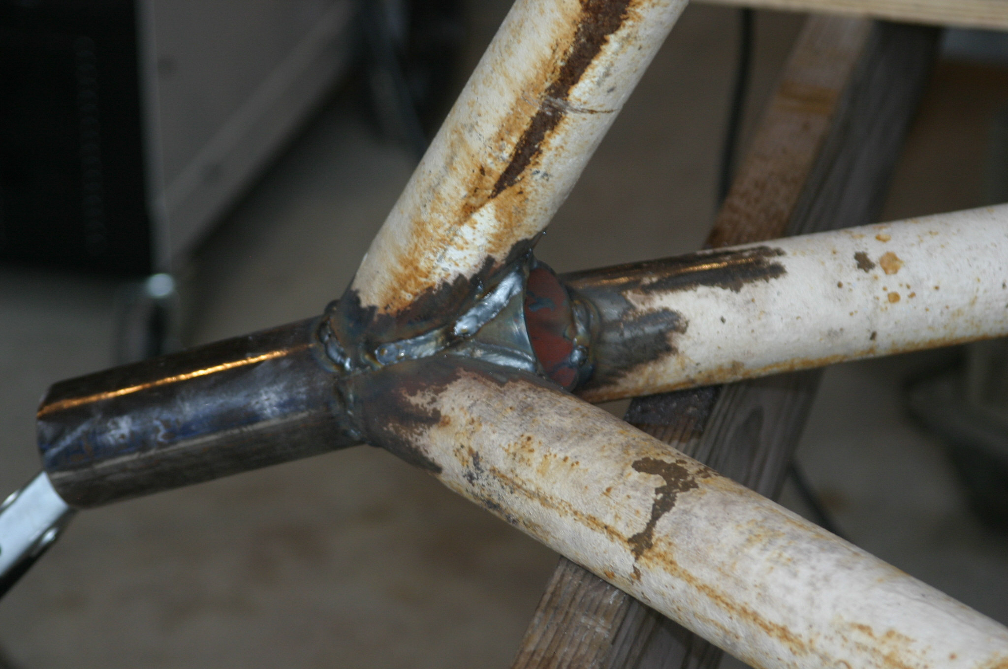

$8 for a 46" scrap of 1 1/2" sched 80, or $75 for a length, I went with the scrap. The old steam pipe I got for free..

So you needed the tube notcher to build the stand for the tube notcher!:laughing:
How come you didn't Tig weld those joints? I see a Tig torch in the background of one of your pictures.

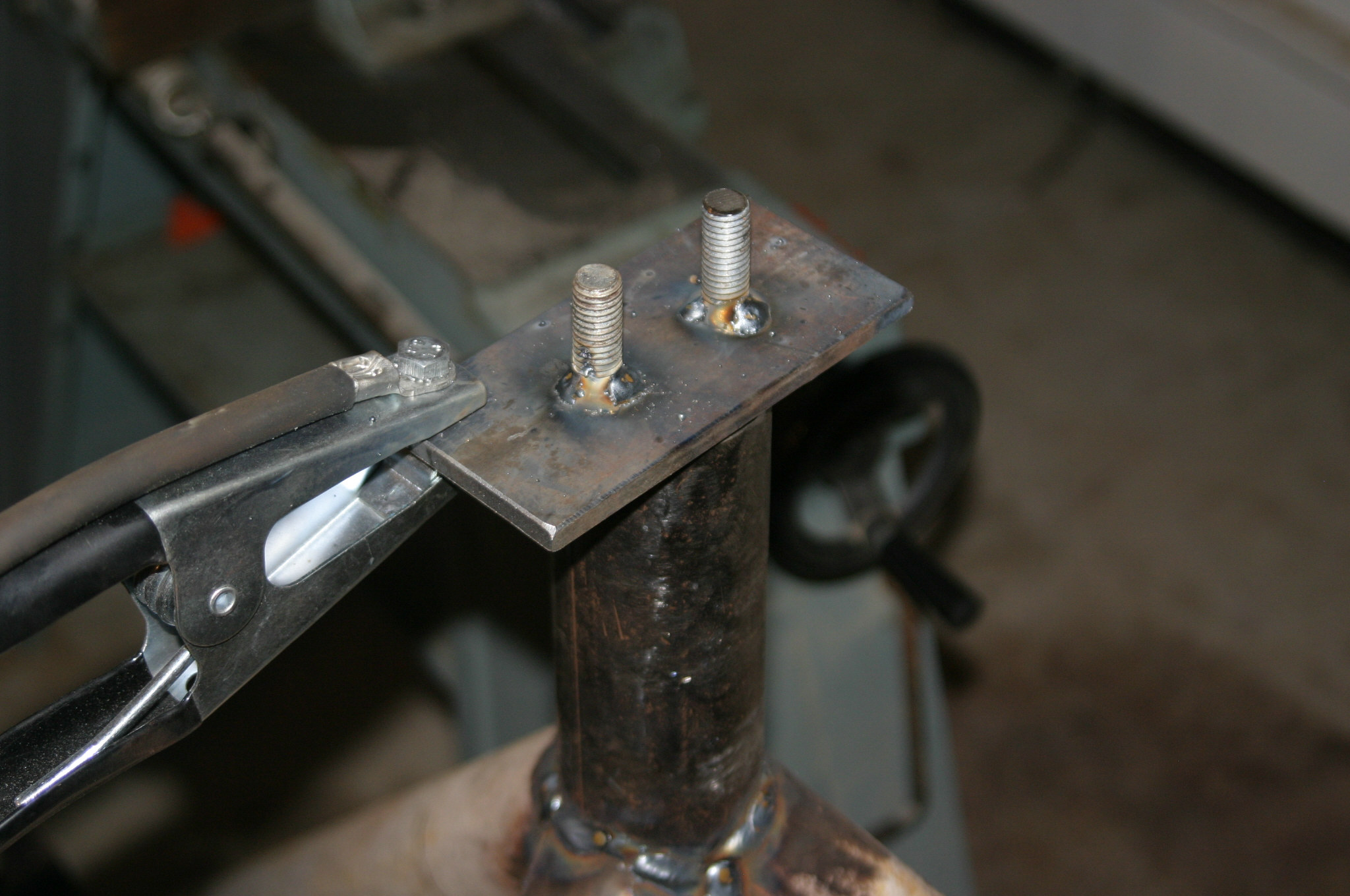

Guess I'll make a base for my vise tomorrow. That'll be handy too, drop it in the same tripod. I'll try to be pro, tho, and weld the bolts on the other side.
I do a lot of tube notching for roll cages in race cars. That is one verry nice notcher. A lot better than my old Jointjigger. Where did you get it from. Milwaukee has some hole saws that are called ICE. I have had great luck with them. They last a lot longer than a standard bi metal hole saw.

Exactly what I was thinking. They say the success of a mans life is measured by how many tools he has at his death. :confused:
I was just kidding about selling it, first couple tries were not very successful. :eek:
It's probably gonna be more time consuming with the practice than I can devote to it, to learn it right anyway, I'll just plod along with it when I can.

Bill, I got it right from their website JD2.com
