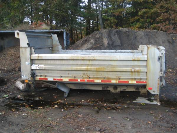

Are you worried about corrosion or dents?
Yes, but I think corrosion (from steel) is less of a concern than dents (with aluminum).
Steel also considerably cheaper.
I think aluminum is too fragile for what I will be doing.

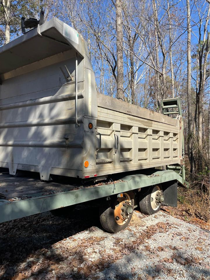

Found this SS 13 footer on CL
   / New (used) IH 7500 Dump Truck purchase, modification & fix up #63
And you could redeck the steel with a new sheet over the old.
   / New (used) IH 7500 Dump Truck purchase, modification & fix up #64
Aluminum bodies are nice until they start needing repairs. Personally, I'd never own an aluminum body of any kind, work trailer, dump body, service body or whatever. They work harden and can't take the flexing. Once you get a crack in a joint or anywhere it'll be never ending repairs and they are a royal pia to work on as they have to be clean.
I'd be a bit leery also of an aluminum rock body unless you line the bottom with something and then you're defeating the weight savings.
Those are my opinions and they're free so take into account what you paid for them LOL. Good luck on finding a good body, be sure to keep us in the loop.....Mike
Yeah, I don’t think aluminum is a consideration anymore.
I‘m careful with equipment, but aluminum dump bodies need to be treated like a china doll

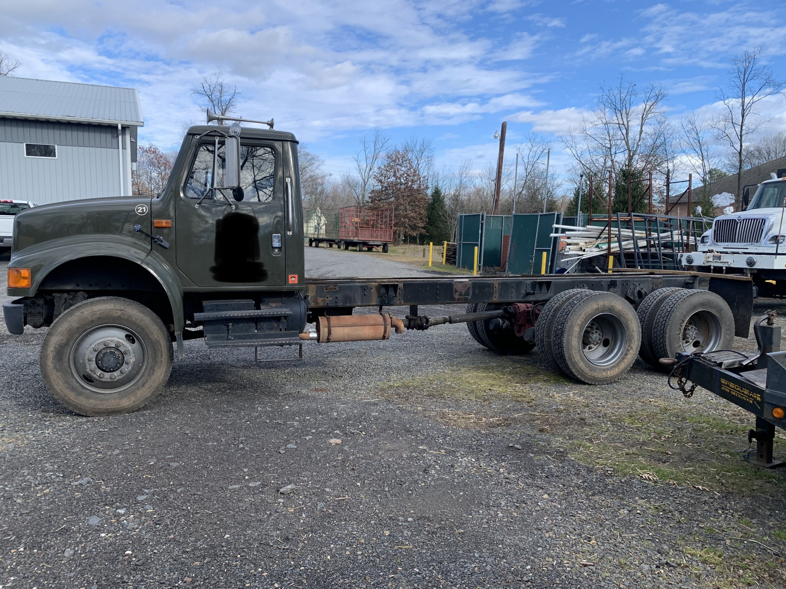

Removed everything. Just bare chassis left now.

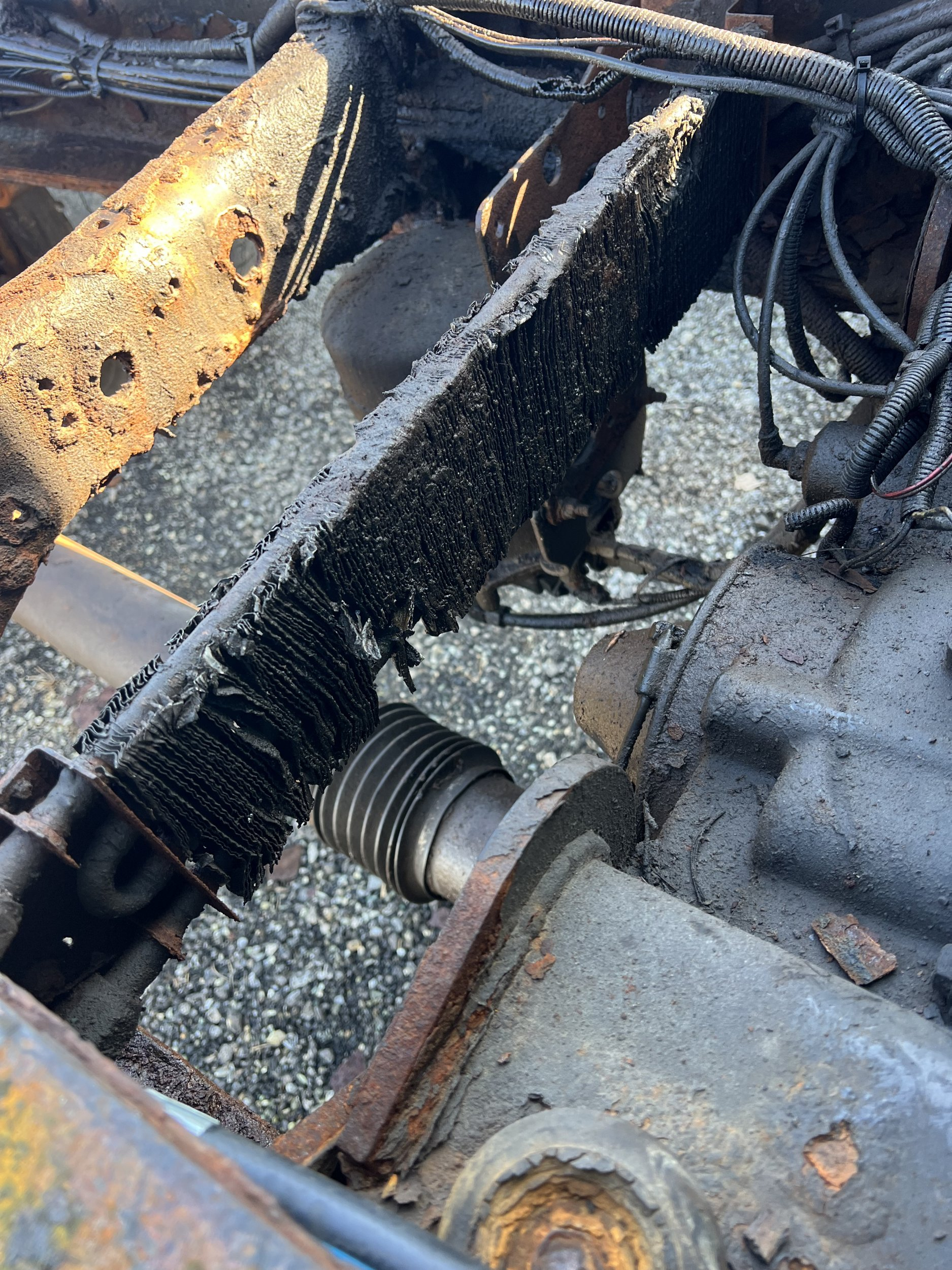

Now the fun begins getting this frame restored and fixing some other things, like the transfer case cooler.

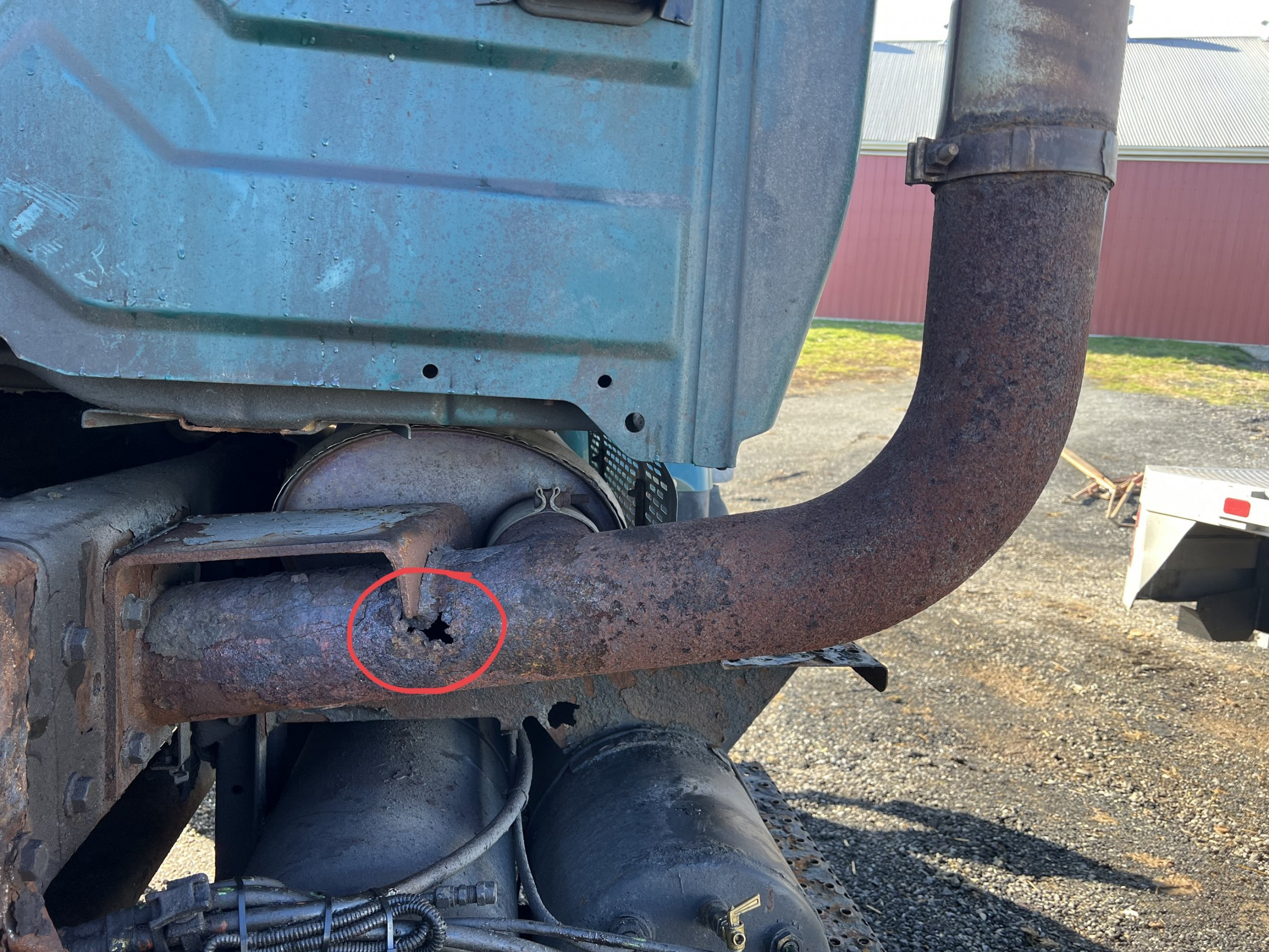

And this exhaust pipe.….you know, I thought the truck had a blown exhaust manifold gasket….maybe this is where the popping noise is coming from? I hope so-heck of a lot cheaper to fix this than the exhaust manifold!

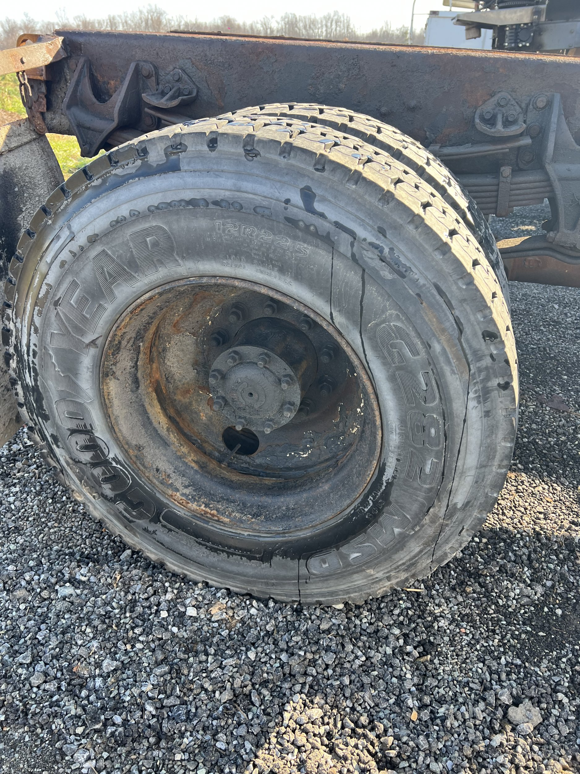

I hope all goes well. It’ll be a fun day to give her some new rims, too.
   / New (used) IH 7500 Dump Truck purchase, modification & fix up #71
A transfer case cooler huh? Never saw anything like that before. Are you sand-blasting the frame? A method of getting the heavy scale from the double frame is beat the heck out of the top and bottom flanges with a sledge hammer. Then get a fluid fillm like oil in there to creep in and stop the rust.

   / New (used) IH 7500 Dump Truck purchase, modification & fix up #73
Probably have something to do with it :). If you can, you may want to go for a downturned exhaust if it'll clear the tanks, hard to tell from that angle.
What's a set of wheels worth as opposed to blasting and painting? We've got a company around here that bakes the wheels to remove the crud and then paints them.
Frame doesn't look all that bad, scaly but wet. I see you actually got the body pins out, any I've ever done requires a torch and a FBH to beat the burnt off pieces off, you lucked out.

Me, I like polished aluminum rims. Even if you don't actually polish them, use SOS pads, keep them wet with lots of soap and the rims look almost as good as polished. Easy, fast and never have to worry about them looking rusty.
   / New (used) IH 7500 Dump Truck purchase, modification & fix up #77
And if you want steel rims, there are cheap powder coated Accuride ones you can buy. they weren't much more than painted rims but they stay looking good way longer.
