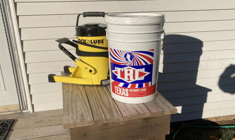

Got my girl a tractor 🚜 and she bought me this grease set up
Go big or go home is her motto .
Texas Refinery Corp Paragon 3000. It’s the only grease my 2000 New Holland has ever seen .
How interesting to see Lock n Lube has now knocked off or rebranded the grease bucket from South Africa. Buying grease by the 5 gallon pail makes grease so much less expensive and the waste goes nearly to zero. No scraping out tubes to get the stuff that squeezed past the plunger, no forgetting to lock the plunger back so it doesn't ooze onto the shop floor, & almost no grease on my clothes because I don't change grease tubes.
Life is good.

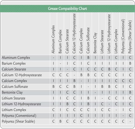

I always buy and use the Lucas xtra heavy duty grease and I use it on everything that needs grease...
Lucas is also a polyurea grease but it's not shear stable like John Deere's. So it isn't compatible with other types greases. I believe JD grease is re-branded Mobil Polyrex EP 2.
All I want is the original factory-filled grease that came with my Branson.....but that information is elusive.

Grease is basically a little bit of oil mixed into a whole lot of soap as a carrier. The type of oil doesn't matter as much as the type of soap that the oil is suspended in. Some types of grease mix OK together, but mix the wrong ones and a chemical reaction makes them become hard as dried clay.
It cleans out with a little work. Sometimes you have to take the joint apart and chisel or scrape it out.
No biggie.
JD sells a green grease that is compatible with most others.
