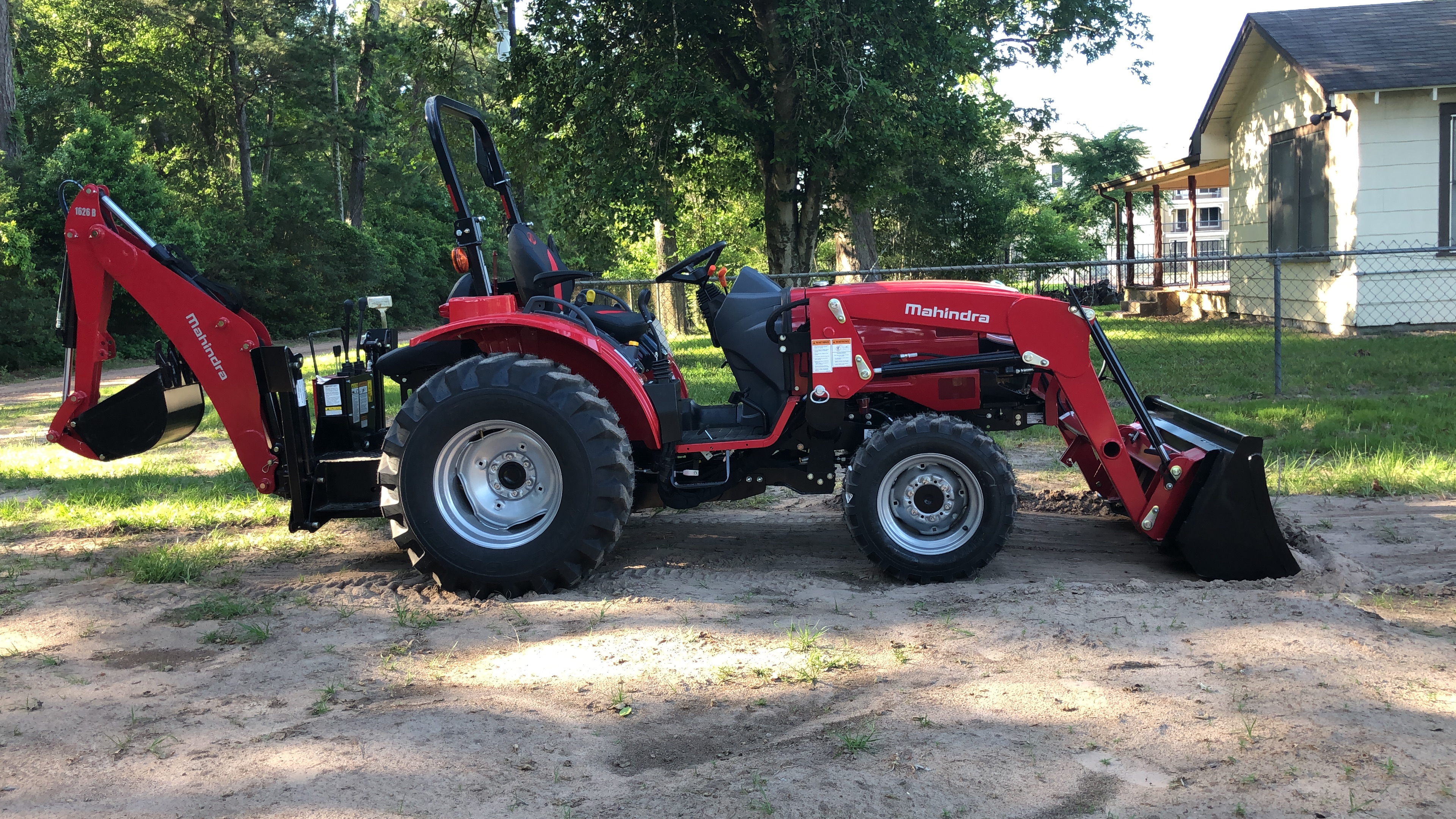

Just brought a Mahindra 1626 with backhoe... First time owning a tractor... Wondering what are the must-haves and and brand / type recommendations... so far my list is
1. Diesel Fuel Can (don稚 laugh)
2. Grease gun - leaning towards Dewalt battery operated
3. Grease - Lithium with Moly ?
4. 1/2 Torque wrench (again don稚 laugh)
5. Chains
What else ?
TIA for all the valuable input for experienced owners !

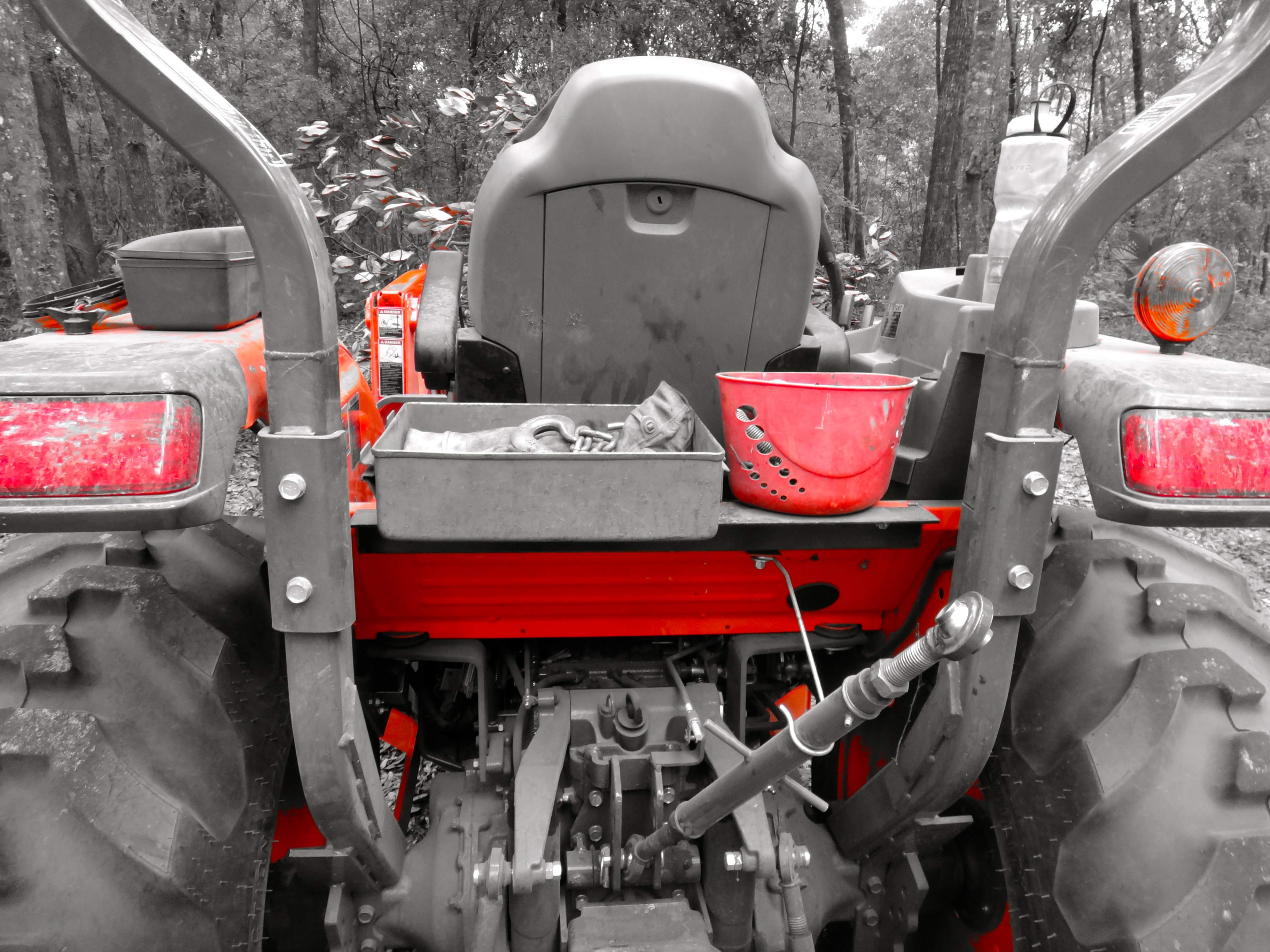

/ Must haves for New Tractor #7
rushipa
Just brought a Mahindra 1626 with backhoe... First time owning a tractor... Wondering what are the must-haves and and brand / type recommendations... so far my list is:
1. Diesel Fuel Can
I have steel and PVC fuel containers. I prefer PVC. Tuff Jug is the brand I like. With Tuff Jug design tractor filler opening bears some of the full fuel container weight.
Your fuel consumption will be 1/3 gallon per hour. Five gallons will last you 15 engine hours, which will be three, probably four days of home tractor operation. Buy FRESH diesel for only one month at a time. Almost empty tractor fuel tank before refilling. (Average residential tractor use is 60 engine hours per YEAR.)
tuff jug diesel container - Google Search
Overkill for just a tractor, but why not?
YES. Molly HP grease is the standard for Loader and Backhoe pins and a good general purpose grease. Molly grease is one increment "better" than plain lithium grease. You will likely use <one standard cartridge per year. I buy Walmart and TSC interchangeably.
VIDEO: How to replace grease in a grease gun - YouTube
5. Chains
Your tractor only weighs 2,400 pounds. Maybe 4,000 pounds with Loader and Backhoe. Tractors with 4-WD can tow about 75% of operating weight, so 3,000 pounds will be your max chain working load. 1/4" GRADE 70 chain will be ample. If you want to be over-engineered, then 5/16" GRADE 70 chain. GRADE 70 slip hook on one end, GRADE 70 grab hook on t'other end.
Walmart, Lowe's and Home Depot have bags of 20' GRADE 70 chain with grab hooks on both ends pretty cheap. Have store cut into 8' / 12' lengths in store. Pretty difficult to cut GRADE 70 at home. Take off one grab hook, replace with GRADE 70 slip hook for cinching up on logs.
VENDER: G7 Logging Chain 1 Feet with Choker Hook 5/16 Grade 7 WLL # 45 lbs | eBay
Rear/center drawbar with clevis mount chain grab hook. For towing loads with chain.
DRAWBARS: https://www.tractorbynet.com/forums...s-drawbars-illuminated.html?highlight=drawbar
What else ?
5/16" Bucket Chain Grab Hooks for lifting. 5/16" bucket hooks will hold 5/16" and 1/4" chain securely.
Home - BoltOnHooks LLC
Maybe a root-cutting hook as alternate to Backhoe bucket if you plan on removing tree stumps.
IMPLEMENTS: https://www.lsuagcenter.com/~/media...aa214276e14dacb/pub2917tractorimplements1.pdf

Nice looking tractor. I agree with forks, I use mine all the time. Is the FEL a quick connect? If it is I’d get forks with the head ache rack. Will you leave the backhoe be left on all the time? If not you might look at a ballast box. I agree on the grease gun. For me it’s much easier with a battery powered gun to get a new cartridge started. I usually use an all purpose grease. I think the type isn’t that critical.

Welcome to the forum, nice looking tractor, I have his little brother eMax 22. No laughing about any of your suggested items, the dedicated diesel fuel can is a must, yellow for diesel of course, everything else around here is gasoline powered, you don't want to take a chance on misfuelling. For people who use a lot of fuel, the 55 gallon drum would work, the fuel would likely go bad before I used it all.
