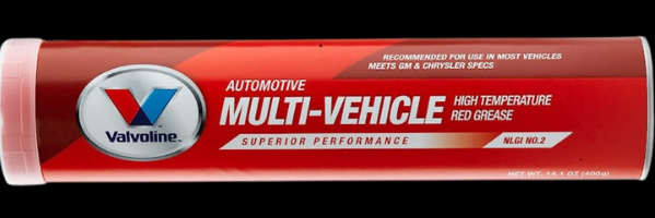

I use FLAPS (Friendly Local Auto Parts) generic grease on everything.... IF I had to use Corperate4 recommended grease on all my machines I would need at least 6 grease gun labeled for each machine .. Most specific tractor brand greases are just more expensive rebranded for same source as local auto parts store...
Think this is what is in grease gun now....
As for failure to start, crawl under tractor and dee if a zerk fitting in on shaft, if not check for gummed up/dirty safety swith...

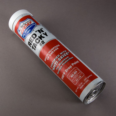

- For 3&4, yes there are greases made for specific applications. When I got my BX I casually went around to a Tractor Supply/Ace/Home Depot and a couple of other places and looked for the most readily available grease. Ended up settling on Lucas Red N Tacky and used a tube or to to displace the factory lube in all the grease-able fittings on my tractor with Red N Tacky.
- As others have mentioned here I am, within reason, firmly of the mind that for a home owner/hobbiest, aka non-commercial applications, ensuring that everything is greased regularly is less important than the specific grease being used.
I have a milling machine that takes NLGI-2. I was hoping not to have three grease guns.
- I'm not familiar with the ins and outs of milling machines (or whether you're talking wood, metal or other material mill). That said a quick google of NLGI-2 and the first result is from nyelubricants:
"The most commonly used greases, such as those used in automotive bearings, would use a lubricant that is NLGI grade 2, which has the stiffness of peanut butter. Grades within this range can operate in a higher temperature range and at higher speeds than NLGI grades 000-0."
- I strongly suspect, again without experience with milling machines, that you can pretty easily find one grease that will work just fine for both your tractor & your milling machine. As example, Lucas Red N Tacky is a NLGI-2 rated grease.
