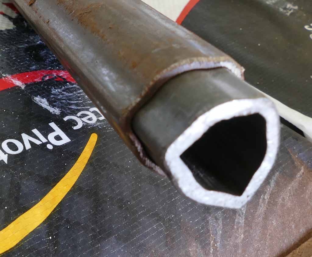

The shafts I have are roughly triangular with rounded lobes...
All the same? Do you only have one brand of equipment?
Of those I've owned, I think most have probably been rectangular cross-section, but I've also had round with two rolled splines, triangular, and probably some others I can't remember anymore.
   / PTO rookie - questions about disassembly and greasing #14
I have five implements, each with it's own PTO shaft, and they're all the same shape - triangular. One implement came with an Italian shaft, however I think the other four shafts are from bareco.com.au.

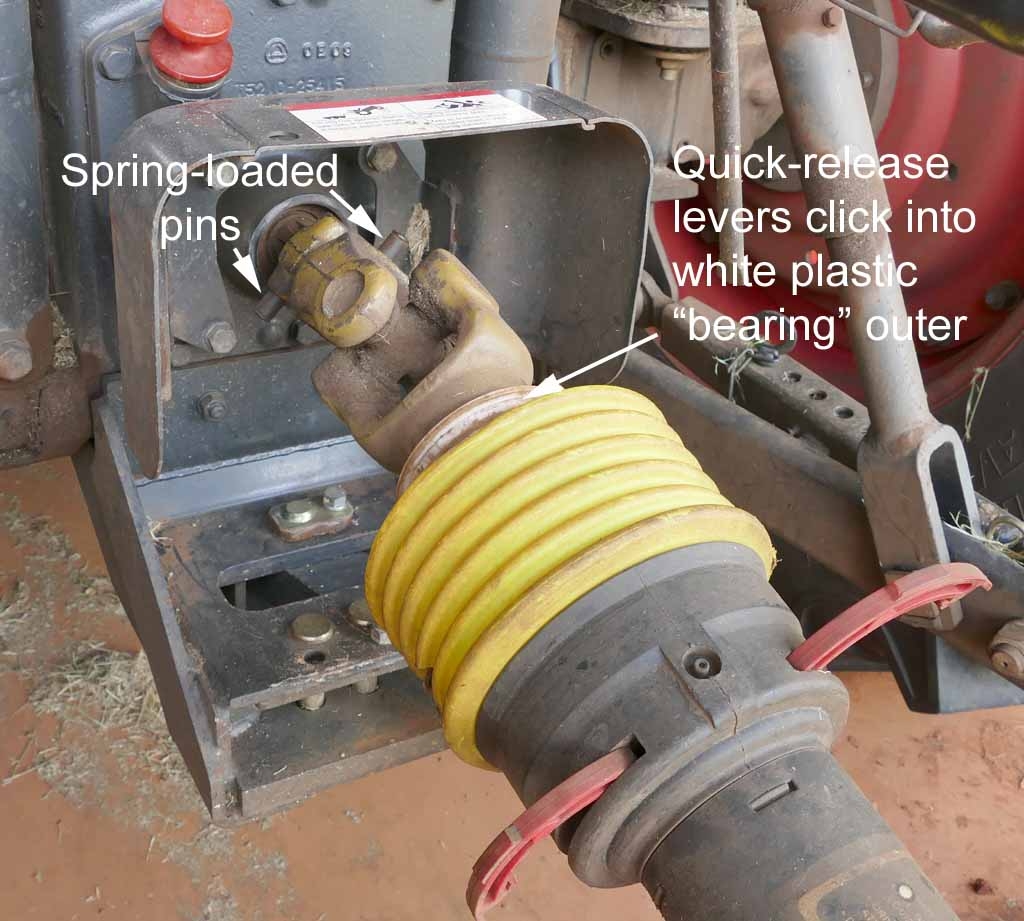

The shaft safety covers/sleeves they supply now have a quick release system to allow the cover tubes to be slid away from the yokes, which makes it much easier to reach and press the spring-loaded pin/s when attaching or removing the PTO shaft from the splined shaft of the tractor and/or implement. This style of safety cover release may well be common all over the world, but it sure beats the older fiddly system I had 20 years ago. :)
