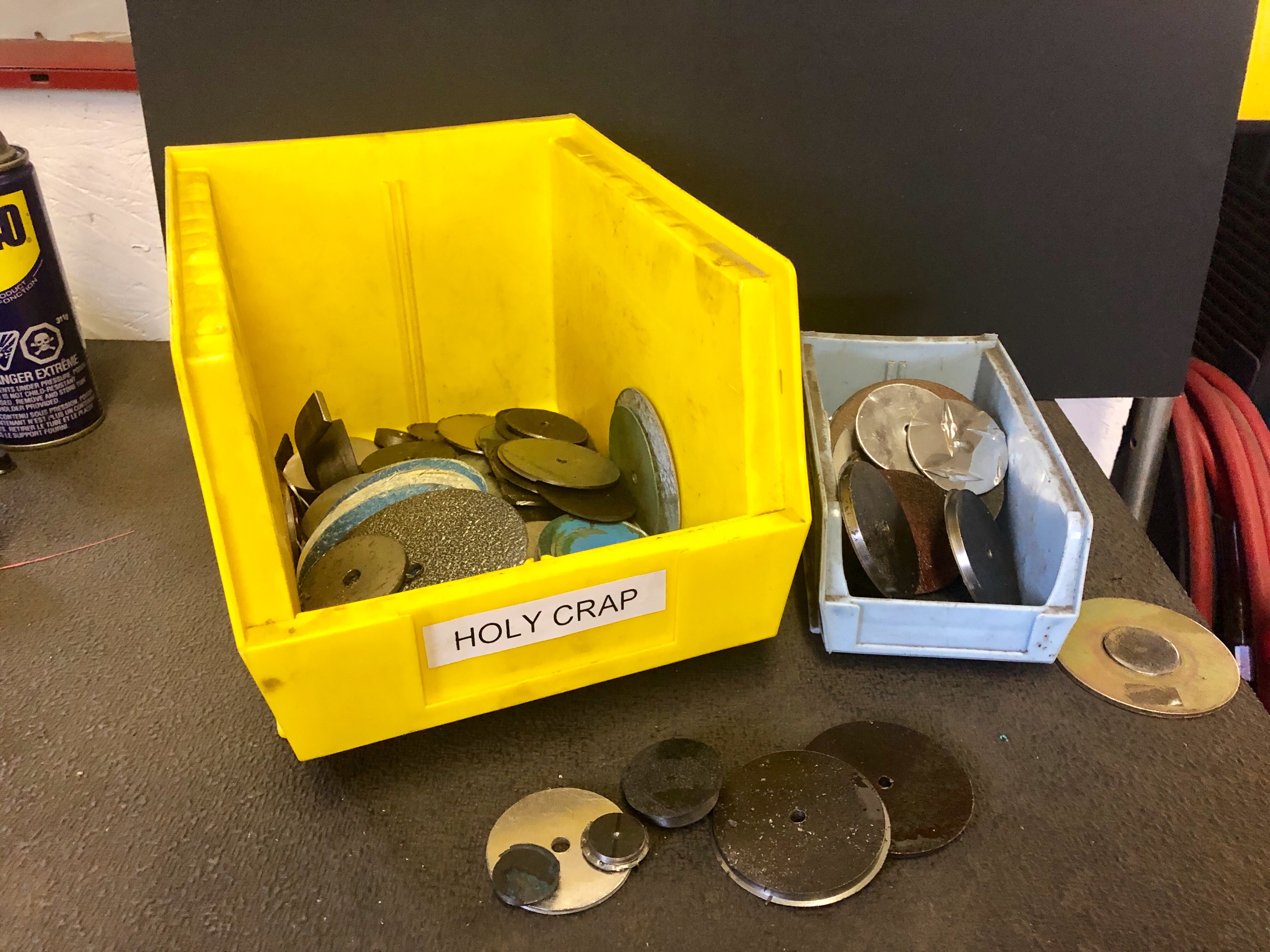

So the main motor control/contact was shot. I got a quote for 1300$ for the 20hp 3 ph 600v (I forget the amps) contact and also a smaller table lower 220v 1ph contact at 1700$!
That is more than the machine.
So, time to take it apart
Burnt contacts, some melted to the point the pads had fallen off
So, sweat the points off.
Grind and sand via jig
Re-silver solder 56%
Working well, now to do the 220/1ph contact

What is the voltage of the system, how many HP is the motor, 3 phase or single phase? Does the starter have the old style thermal overloads? It looks like an older style IEC contactor. Should be able to find a Schneider or other brand IEC contactor that isn't $1700.00. Yeah, those contacts look beyond salvageable.

Ugh, this contact was much harder. The 2 contacts across the bridge connector was “welded” shut on both sides.
I couldn’t get heat in there to separate. So I used an 1/8 mill to cut thought the back of the contacts so I could slide them out. Of course this ruins the contacts on the tabs so 2 new contacts cut with shoulder to solder in and back together. Continuity indicates function so I will test later
/ New shop started
#672
Cammo, here is order minus shipping and tax 1500$ plus about 100$ tax and 80$ ship
3 phase 20 hp, 80 amp circuit with a 30 hp rotary converter.
They were “beyond” so I made new.
Main motor is good, now to reinstall table controls
