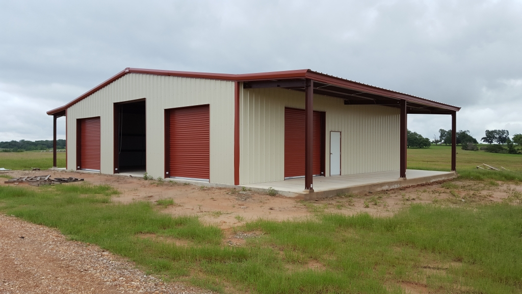

I just finished the shell of my new shop/barn. 50x70 slab, with 50x50 enclosed (10' wings on each side, like a patio). I'm getting ready to add the electrical in the next couple weeks.
attachment.php

Beautiful. Ya my patio will be in the back. Slab should be in this week. I am looking a professional installed epoxy on floor. 1 quote was a bit crazy. Time will tell if I just live w concrete!

Very nice! You should have some good airflow through there.
