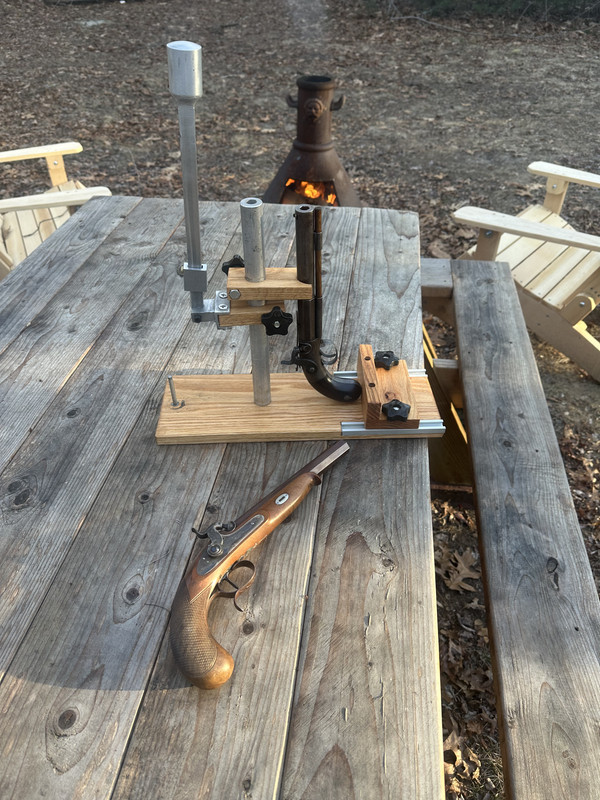

Sorry I missed the response!
Ok, back to the swage press.
So, I got sidetracked by 7 other hobbies.
So to get this press up and working with one of the 22 die sets I have, I needed a holder to hold the punch part. These “ punches” ( I don’t know the correct term) do not fit in a standard loading press holder like my other set of 22 dies. My other set will fit in a standard rockchucker, these not so much. So a bit of lathe and milling and presto!
The holder that came with the press (218 bee brass, and what I was copying for outside dimensions) is to the left. Center is the start of my holder and a factory rcbs holder for reference and “punches” are to the right.
Installed
And it is even coaxial!
Now the 6mm and 30 cal dies use threaded “punches” so now to make adapters for them, slow progress!

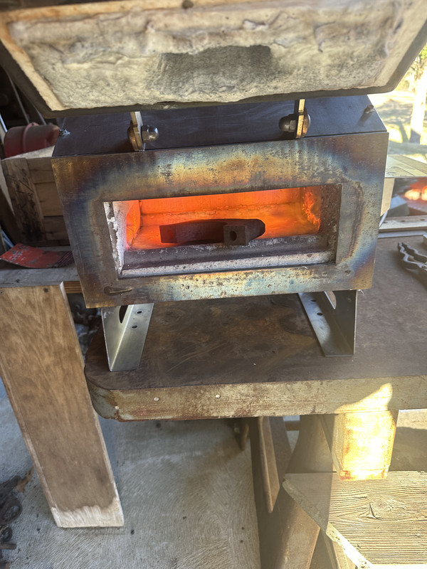

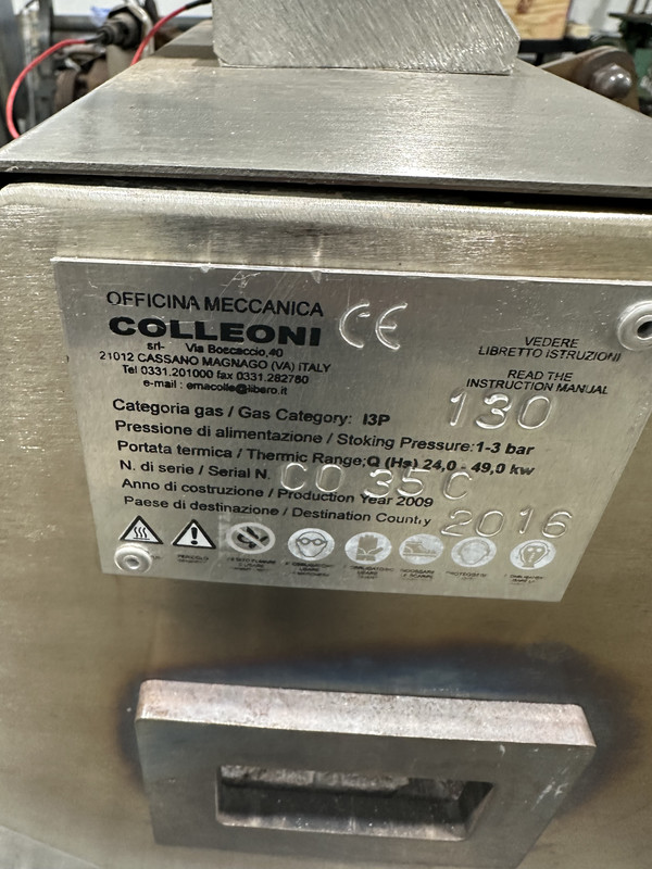

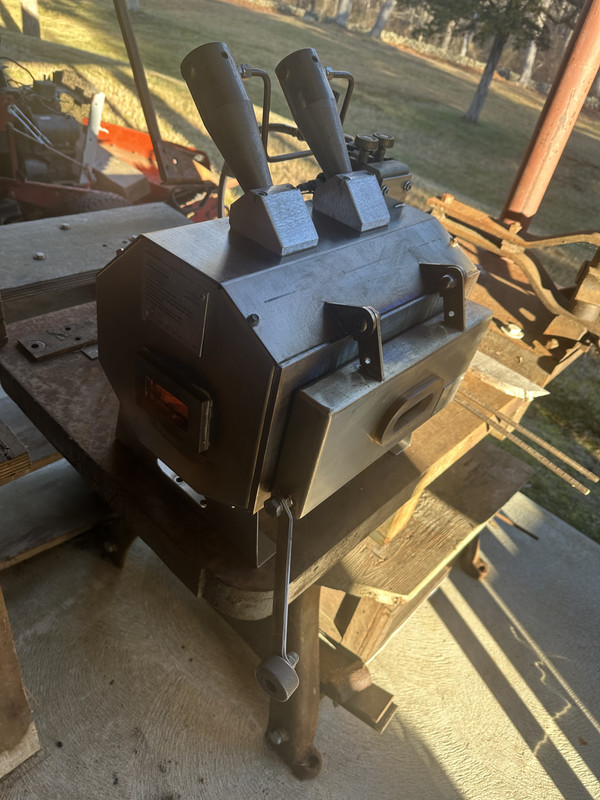

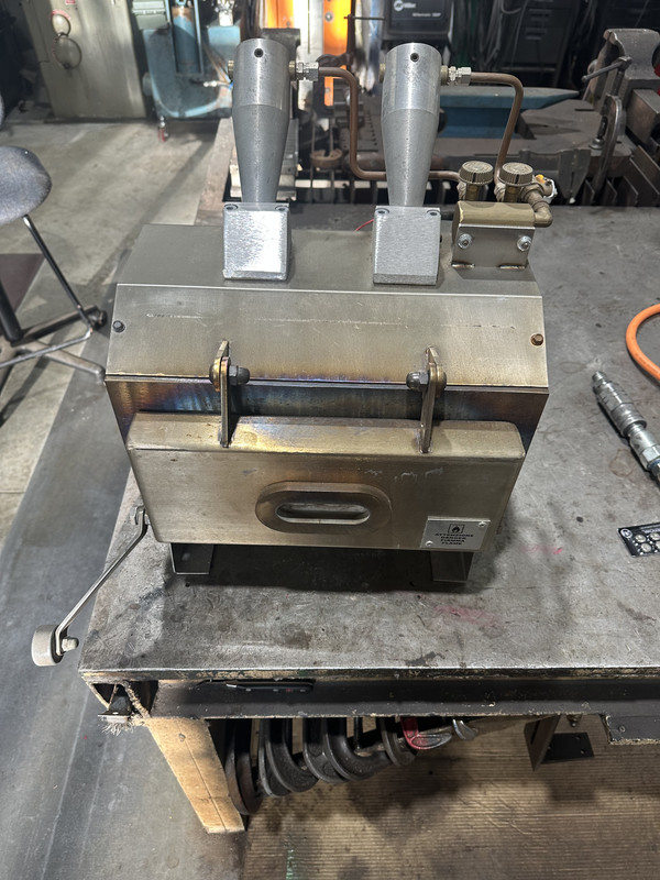

Rehab of a Colleoni co35 forge
Cute little bugger. Stainless steel, burners are independent controlled (milled out of single block of aluminum)
2700deg plus at around 10psi
Fired it today for the first time (day 4 of refractory cement cure)
Heats fast!
It should be a nice addition when I don’t want to fight the large coal forge

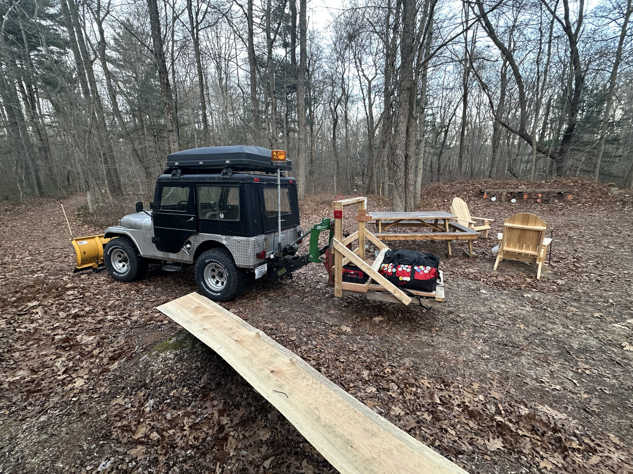

#717

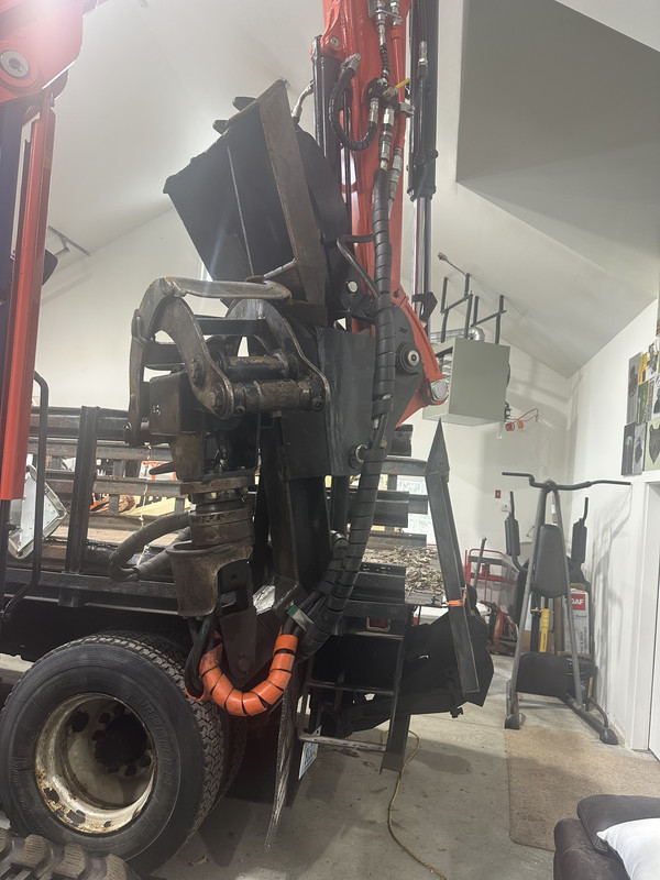

Added a vably grapple and custom heel to the u55 along with thumb diverter valves.
Next is a winch. (Likely electric to KIS(s))

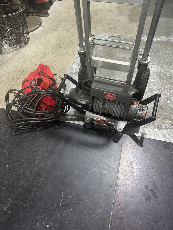

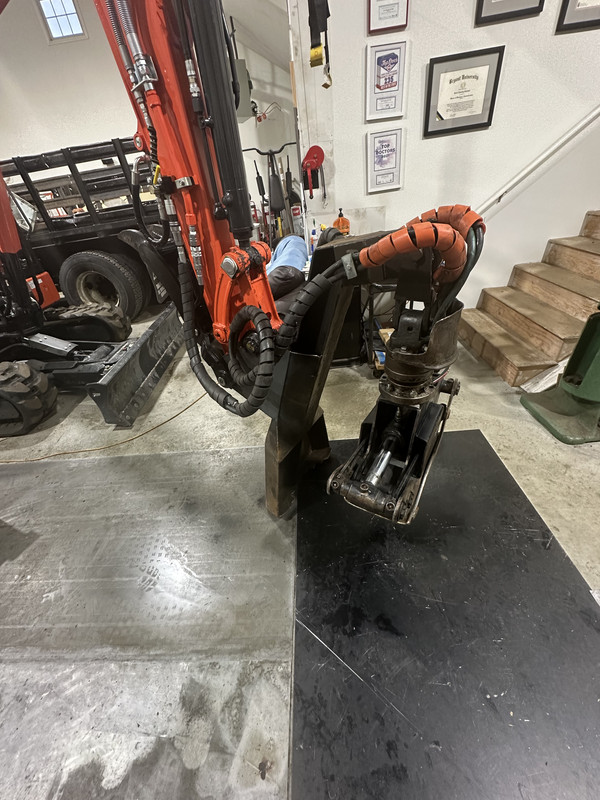

#718
Starting on winch mount, pic of grapple with heel down
Heel will act as a skid winch mount and it is also useful for holding wood “on end” like a fishing pole. Good for loading and feeding chipper. Frankly, the most frequent use for me will be to allow me to still do pivot turns or have something that you could still push or manipulate things with as you really can’t push down when you have a grapple.
Warn 9000 to be added

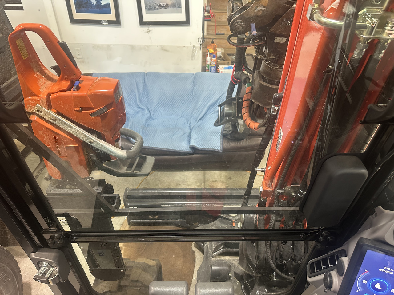

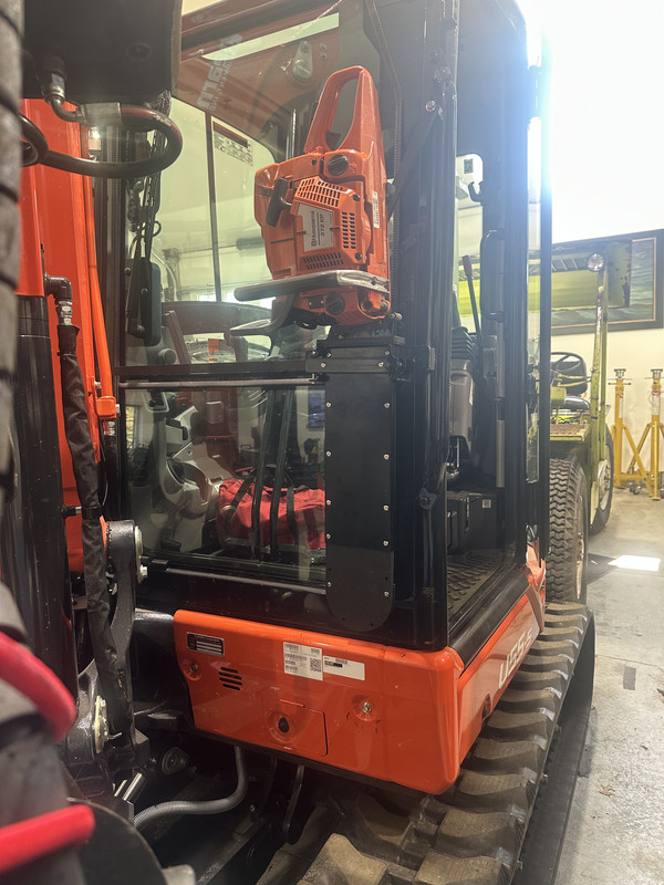

#720
Added a saw holder, there just wasn’t a great place to keep one until now. Just need to add a chain/storage box just behind plow blade and I’ll be happy
