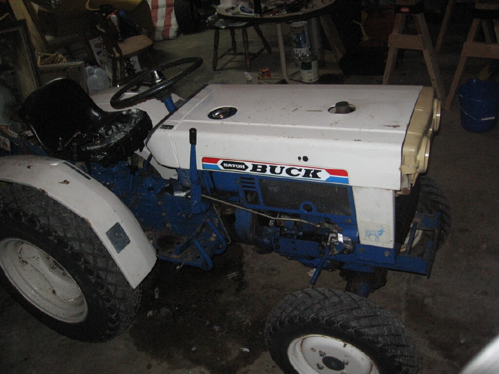

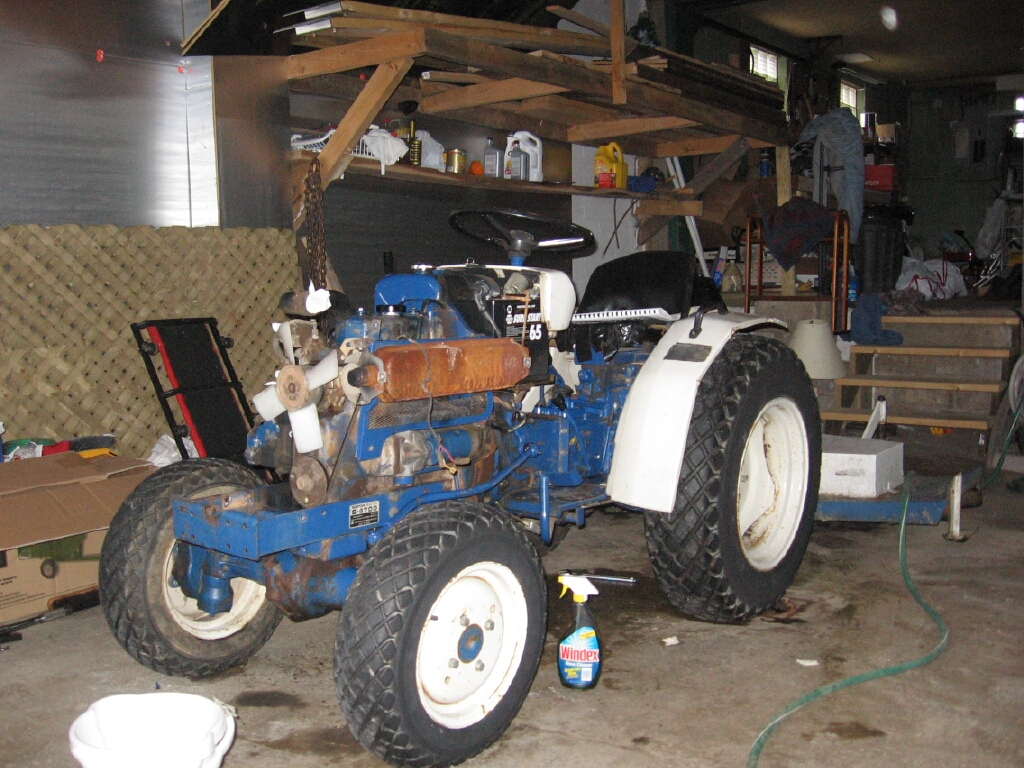

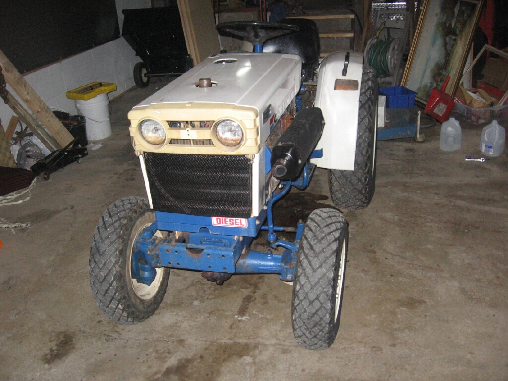

Looks a lot better than my Buck! You're going to enjoy that tractor. Glad things worked out on the repairs. I'm envious of the turfs.

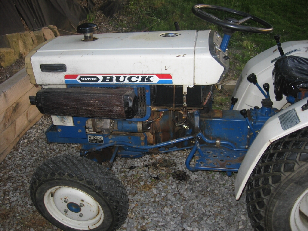

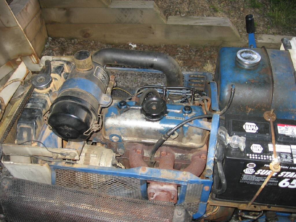

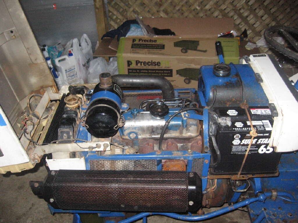

Everything ran fine. Nice cut. Seems to run pretty hot, maybe that's just normal. Lots of pressure on those radiator hoses. No real leaks found. I noticed a 'ring' of moisture around the bottom of the gooseneck (right on the flat part of the block). No drips, though. Must be a tiny hairline leak there.
Ran it for about 2 hours + yest. w/ no problems.
Is operating temp pretty hot for these?

Does anyone else have a 3-cylinder model (Beaver III, Buck, etc.)?
Does it run pretty hot, under normal conditions? I went from a John Deere Lawn Tractor (LT 150) one-cylinder air cooled gas engine to this Buck, and it's much hotter.
Is it normal for it to run pretty hot? By this, I mean that the motor is pretty hot to the touch after running for an hour +, the rad hoses are very pressurized (brand new, , the hot air coming off the motor from the fan/rad is pretty darn hot. Maybe it's because I'm sitting just about right on top of the motor. :)
I guess it's running normally, but I don't really have a point of reference, and these do not have a temp gauge, just an idiot light.
/ New S470d owner here #25
Been gone a few days. Both mine run a little on the warm side. One day I'm going to get temp gauges. Make sure you have an overflow line on there and run it out where you can see if it starts spitting. The last couple years I have been changing coolant every other year and don't seem to be losing any. I don't have a bush hog and used the Woods RM 48 to trim inside the pasture so we can use the 15' batwing. It's been dry here so not much of this was thick stuff but I ran it for about 3 hours last Saturday. Checked coolant yesterday before mowing yard and it was OK. I did blow the fins out though before starting. Now I gotta get a new belt for the Woods. I use 50% distilled water/antifreeze. Is your radiator good and clean inside and out?

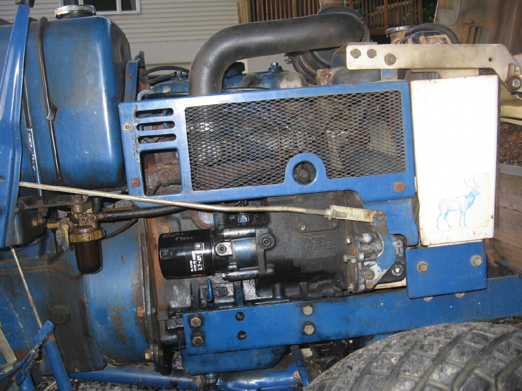

An oil leak.
I will do my best to describe it: There's a vertical 'plug' sensor with a wire lead coming from it. This plug is located between the oil filter casing and the fuel pump. What is this plug/sensor? It is obviously not a spark plug, but it's a similar shape. The oil is not coming from where the plug screws in to this casing on the engine. It's actually coming from the middle of this plug itself, and dripped off, and ran down the engine block. I'm guessing this sensor thing is bad/leaky, but I just don't know what it's for, and what it means if it's leaking. I didn't see anything about it in my owner's manual. It's not spraying out, but it did flow out at a decent rate, enough for me to have to add a little oil. Must've been flowing for awhile before I noticed it.
Anybody know what it is/what it means if it leaks?
As always, much appreciated.
/ New S470d owner here #33
It sounds like the oil pressure sending unit, pull the wire off of it and see if your guage still works or idiot light stays on when you start the tractor.
/ New S470d owner here #34
i agree with washaw. you may need to replace this oil pressure sender unit to fix the leak.

Got myself a new sending unit for $19. Will try it out soon.
The old one was only threaded in about halfway, and looks like they used some kind of pipe threading sealant or something on the threads; looked like a really brittle washer, but I bet it was some type of sealant. The shop said to use Teflon tape on the threading when I replace it.

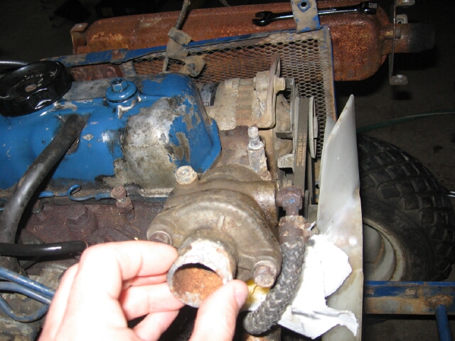

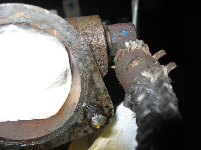

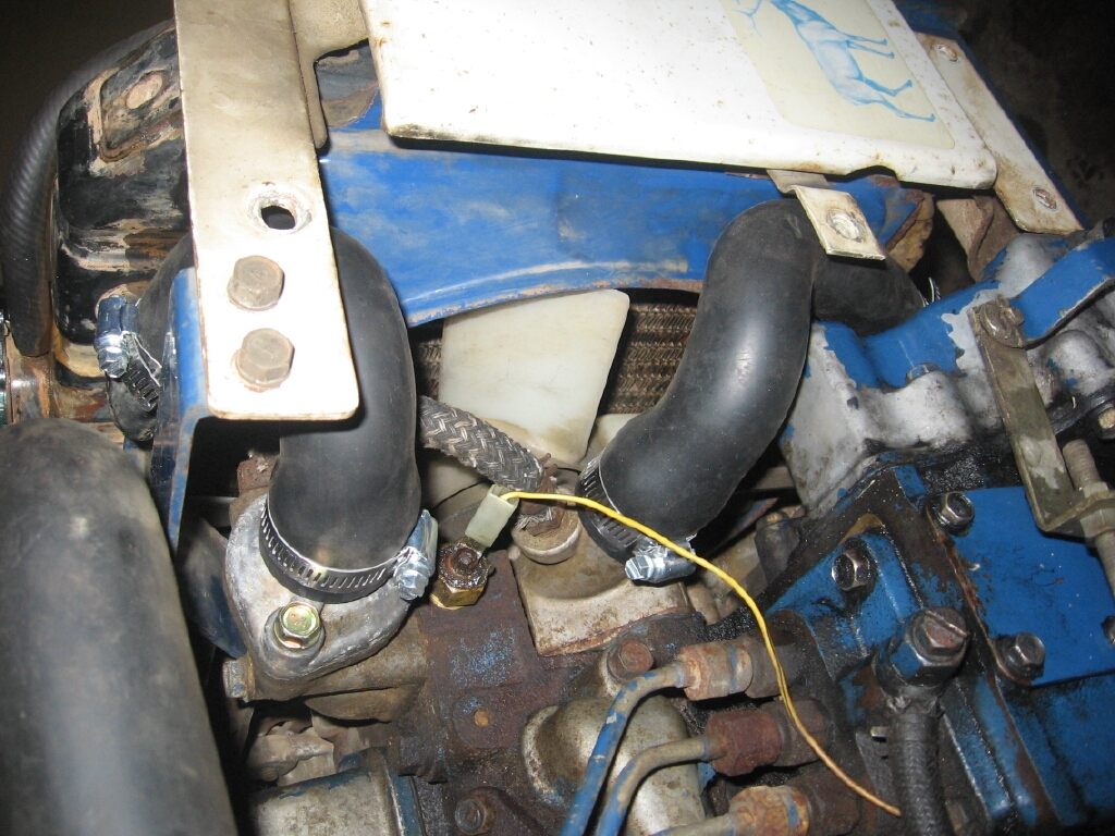

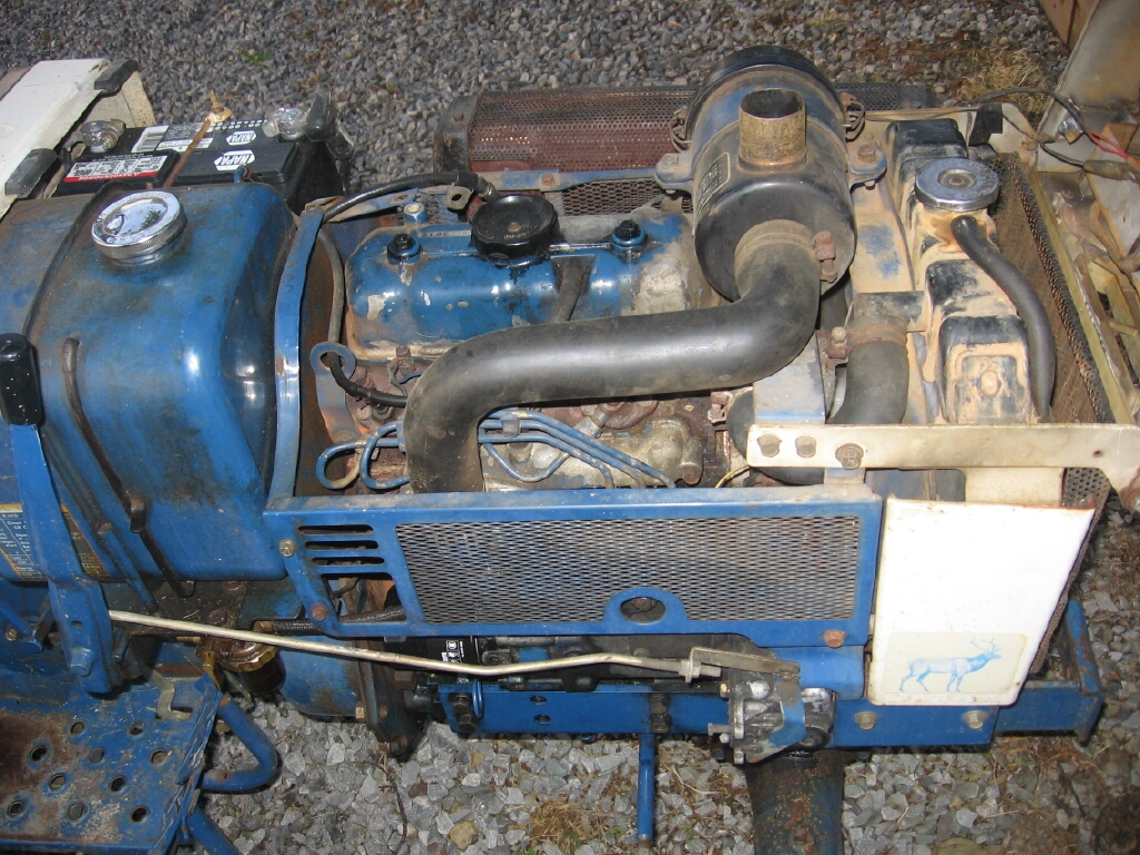

I do have another issue. It just runs too hot, and now it's causing me new problems. It leaked around the thermostat housing, so I started to take it apart. When it's running for awhile, the hoses are hard as rocks, nearly too hot to touch. It's really, really belching heat. Run great; no smoke, etc. So, I let it cool, and pulled the upper hose off to get some room to torque down the housing bolts. The fluid was orangish, and smelled fuelly/alcoholly. The fluid in the rad is bright green. So, it looks like it's not moving fluid, and I may have fuel in the block (I use red diesel).
The thermostat is brand new. Maybe it's bad. I'm also starting to think the water pump might be bad? But, it's not leaking there. My uncle, who is a mechanic, said it's rare to a water pump impeller blade to fail, but it's possible. He said to yank the thermostat, test it in hot water, and only replace the pump as a last resort. He said it's more common for the actual pump to blow out its' bearings, or seal, not a total impeller failure... He also said the symptoms just really don't add up, and it's probably something simple, but not obvious yet. It's also very strange that the radiator is NOT blowing off any antifreeze from the bypass tube at the rad neck, either.
The only other thing I can think of that may be contributing, is that I'm using a non-Mitsubishi Rad cap from Pep Boys. It's only a couple pounds higher than the old one (its gaskets were pretty rotten), and seems to fit real good. Wouldn't explain why the fluid is two different color, though.
So far, I don't think I have engine damage, but if I can't get it to cool correctly, I'm sure I will.

while you have the thermostat out why dont you flush it out with a water hose. the two different color in fluid sure suggest blockage.you can try to run it without a thermostat to see if it is circulating the antifreeze.i hope that you did not install the thermostat backwards.the spring side goes into the block.good luck with it.

It's covered somewhere in this post, but I totally tore down the whole coolant system: pulled radiator, flushed and cleaned it and the fins. Flushed block, etc. Put new antifreeze in there after that, was about two months ago? The rad and block both are clear, and flowed distilled water fine while they were apart.

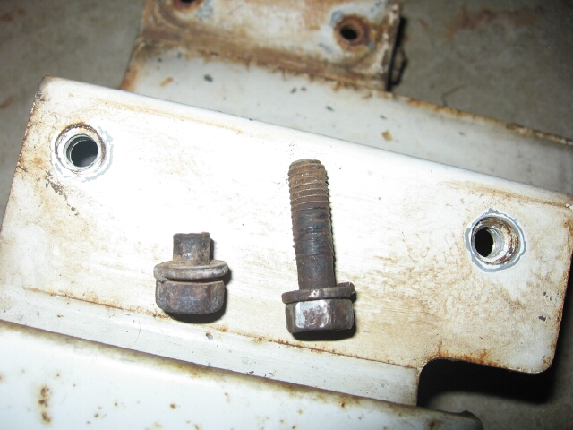

I broke off one of the thermostat housing bolts while I was attempting to replace the stat. Had a shop remove the broken stud, and put the thermostat and new gasket in for me, so I didn't see them put the thermostat in for me. It's possible it's in backward. Or bad.
I am going to remove it and put it backtogether without the stat in there. Might be tough to see if it's moving water while it's idling, though. I might be able to see it flowing, but I'll bet the vibration from the motor might make it tough to tell if it's moving, or shaking the rad. We'll see.

I think the new thermostat was bad.
I pulled it, started it, and it immediately started moving fluid: I noticed the fluid change color in the rad neck right away; I think it had just been sitting in the block and housing for awhile, then it all mixed together from the pump moving it, and now it all looks nice and bright green again when I look at the neck. It immediately started working better. The fan still is blowing hot air on me, but nowhere like it was before I pulled the stat.
I can squeeze the hoses now while it's at operating temperature; they're not rock hard, and when I shut off the tractor, it starts cooling immediately.
I guess I should test the thermostat in hot water, but I'm about 99% sure it never opened, based on that orangish fluid I got when I opened up the housing. I'll bet it was just from the water jackets being open while I had the radiator flushed. Probably minor surface rust from being empty for a few days.
Much better. And, the new oil sending unit works great; no leaks.
