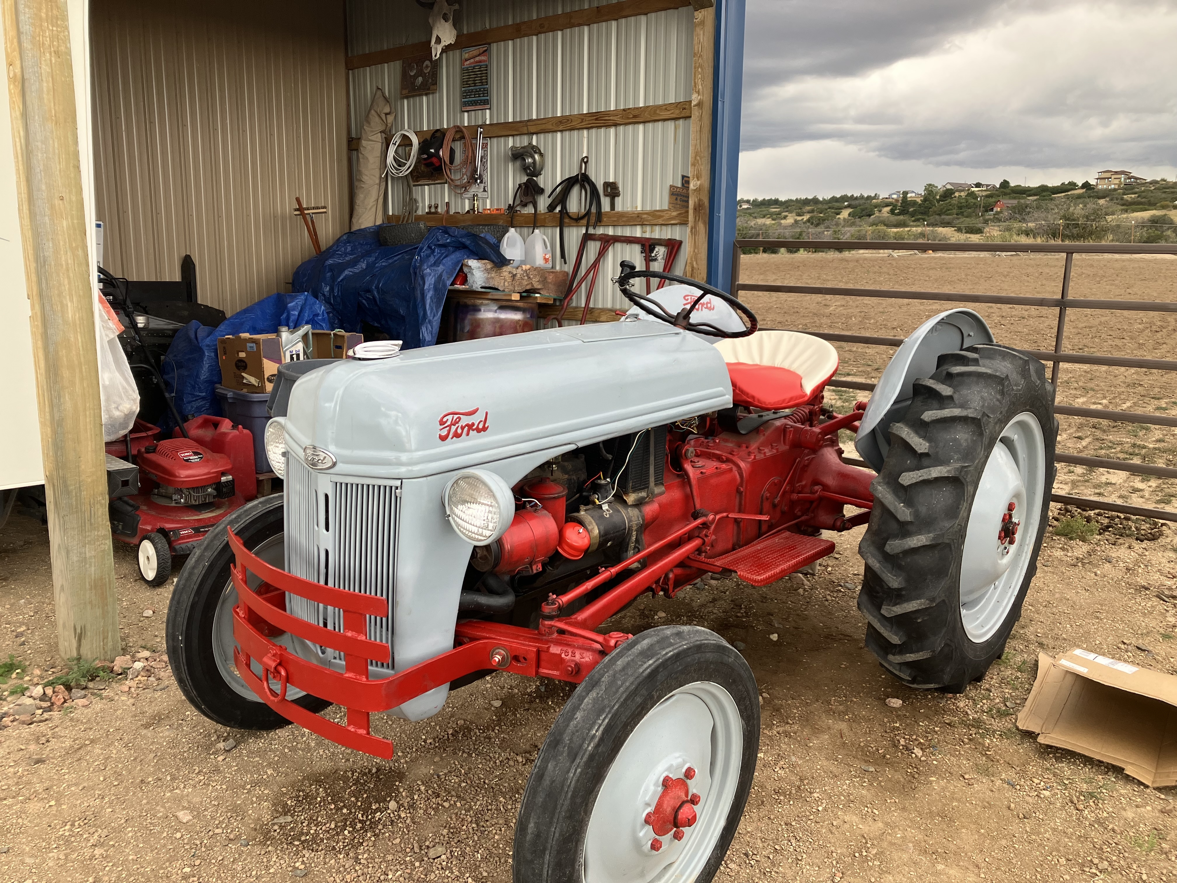

Ford 8N dribbling coolant out of radiator overflow, not overfilled.

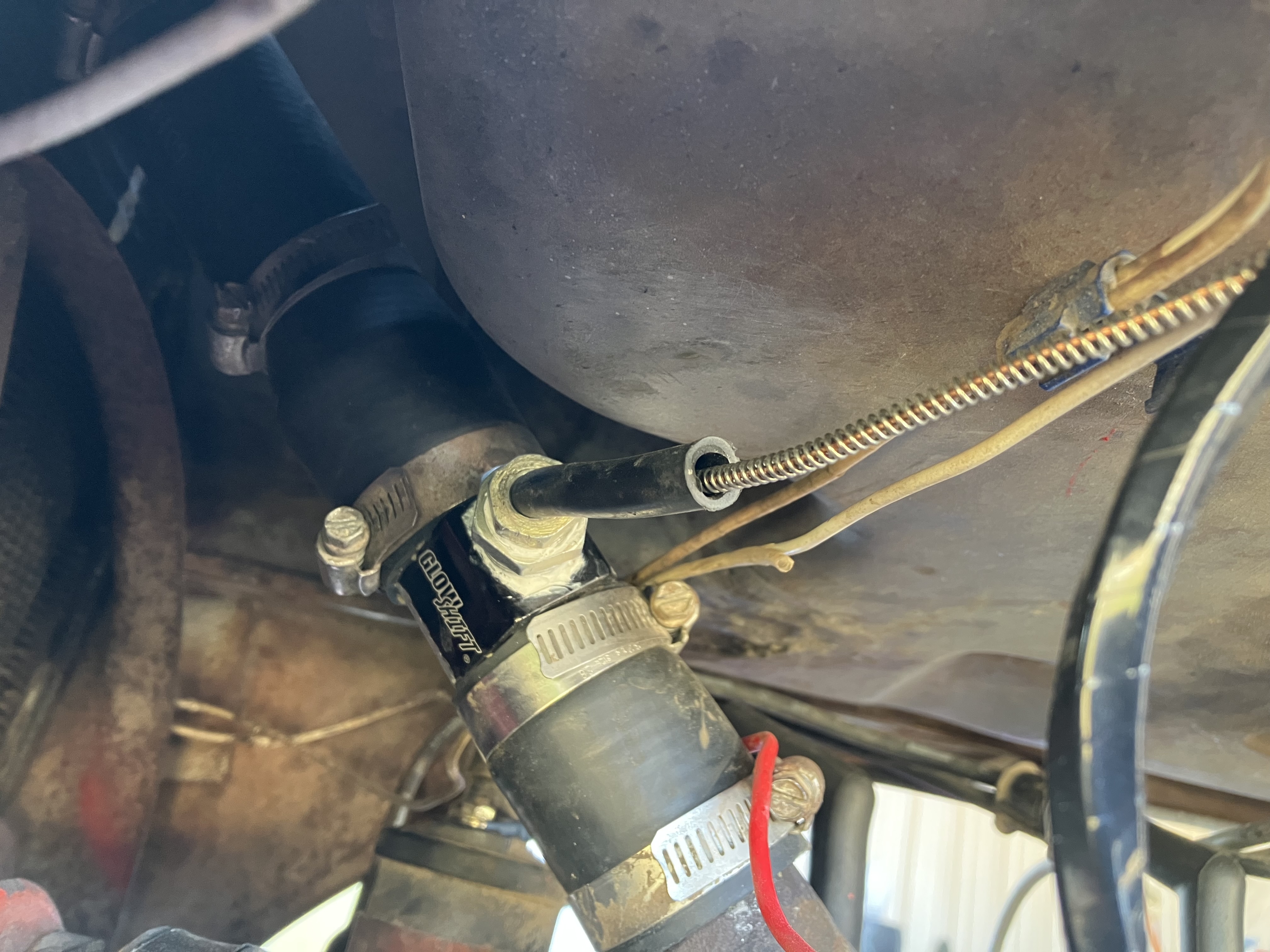

Yep, the thermostat is in the upper radiator hose, and the pointy end is going towards the radiator. I didn’t run it much before I serviced it; but the guy I bought it from was running it without a thermostat in place.

Is the thermostat closest to the engine?

My temperature sender is closest to the engine, and thermostat is after that, directly in the middle of engine and radiator in the upper hose. I thought long and hard about doing it the other way, but then my temp gauge wouldn’t read anything until after the tstat started to open, just because of the direction of coolant flow.

Maybe someone knowledgeable on 8N thermostat position can confirm?
My understanding is the OEM 160 thermostats point to the radiator.
Many use aftermarket 180 that are designed the opposite and point to the engine.

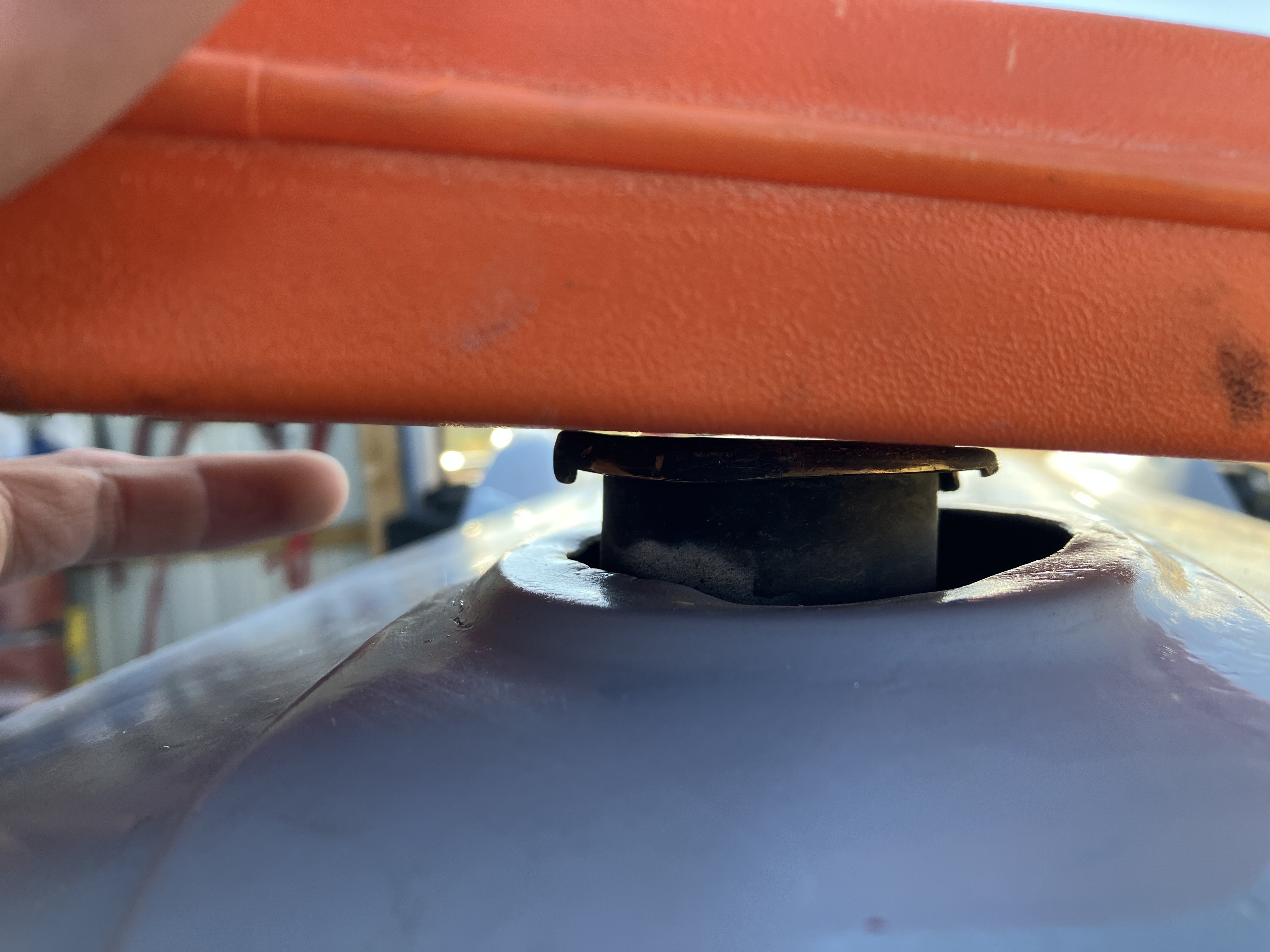

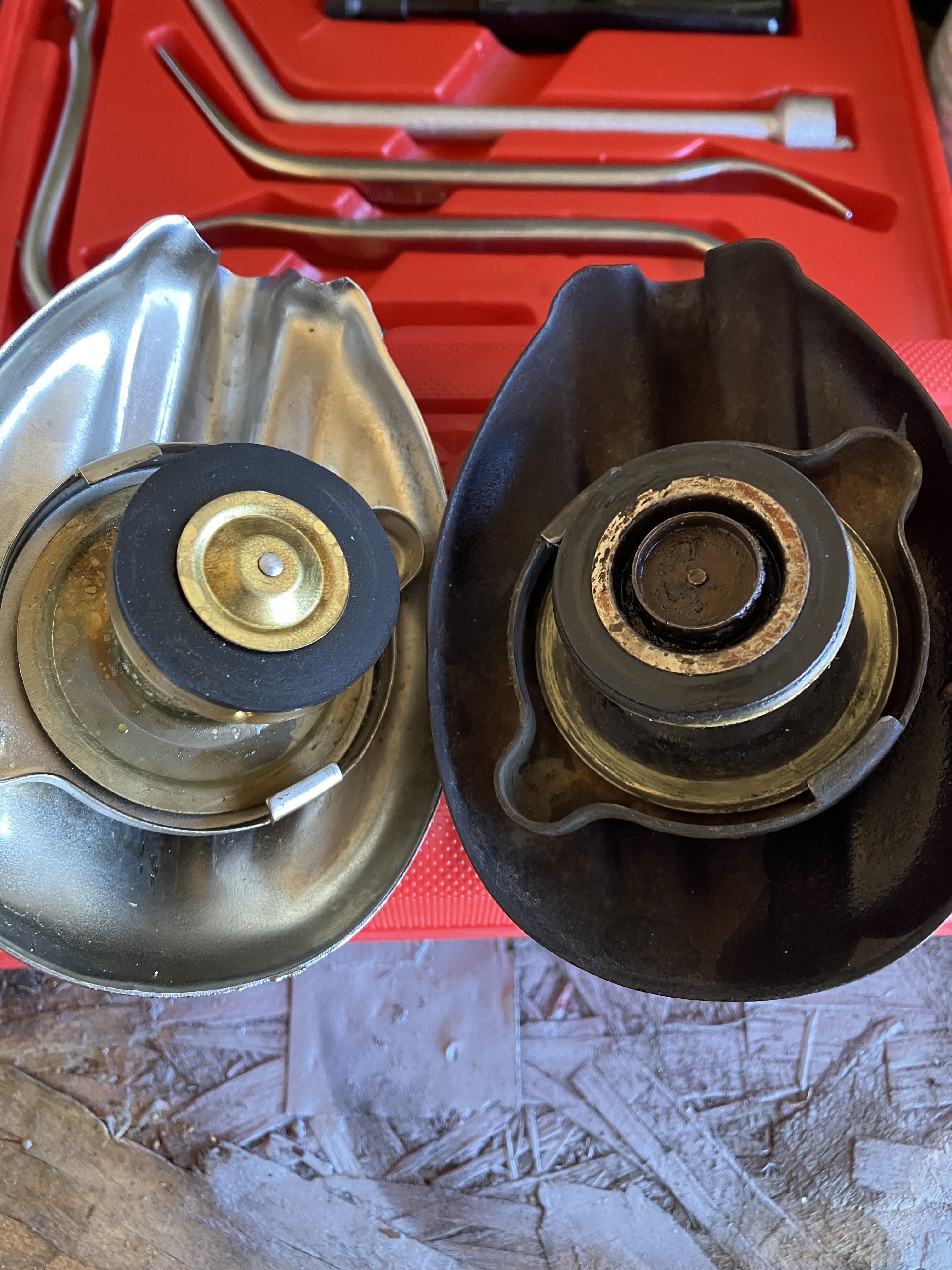

Just curious, can you post a pic of the new cap? It’s almost as if the seal on the cap isn’t doing it’s thing. It’s hard to see in the pics, is it possible the neck is damaged/deformed where the seal seats? I wonder if the top being deformed is holding the cap up and not letting it close all the way? I’m assuming that it does this on level ground and not moving? Because with the cap off completely in those conditions it would sit there all day running and no water should push out if the level is correct 🤔
   / Ford 8N dribbling coolant out of radiator overflow, not overfilled. #51
3) I have attached detailed, close up photos of the radiator fill neck. I believe it to be the correct radiator for the tractor. The fill neck is noticeably bent, which myself and my brother now believe is the cause of my issue. How would I go about straightening it? Would this kind of repair require a radiator shop?

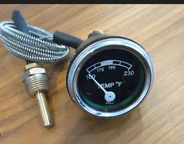

Good pics. 2 quarts down is too much to ignore. The cap may have a hard time sealing on that distorted neck. A radiator shop (these are getting hard to find now) can advise/repair on that neck. What kind of sender is it, that goes in the hose? May be an extra restriction there. Try taking your t/stat and temp sender back out, going back to square one...

I have no idea how much pressure the radiator has, I’m also not sure if it’s an earlier 9N radiator or the proper 8N one. I attached photos of the temp sender I have. Because of its design, it does cause some restriction, but I wouldn’t think it’s a lot. Also, I have included a photo of my new radiator cap next to my old cap. The new one is shiny chrome, old one is standard black.

Without a recovery system you'll always have air in the radiator due to thermodynamics. I would put a 2 liter bottle with the overflow tube submerged at the bottom, take a scotchbrite disc and clean up the top seal on the neck, and verify that the radiator cap has a rubber seal at the top and bottom, so when it cools down it has to draw fluid back in, rather than atmosphere. The bend in the filler neck shouldn't be an issue, unless there is a crack that would allow air back in.
I will remove the tstat and temp sender sometime tomorrow to see if it makes a difference, as I am not currently by the tractor today.
I don’t think the new cap or that sender are contributing to your problem. I was interested in seeing what the seal on the new cap looked like. Both the seal and brass cover on the cap look correct for the type of system you have.

Also the thermostat needs to be as close to the head as possible.

My brother, father and I think the filler neck is “bowed” upwards just enough to cause the seal leak.
Radiator is not overfilled, I always top it off to maybe 1-1.5” above the fins. Attached is a photo of a straight edge lined up over the fill neck. There is a sliver of light in the middle, showing the bend. Could this be the cause of my issues?
