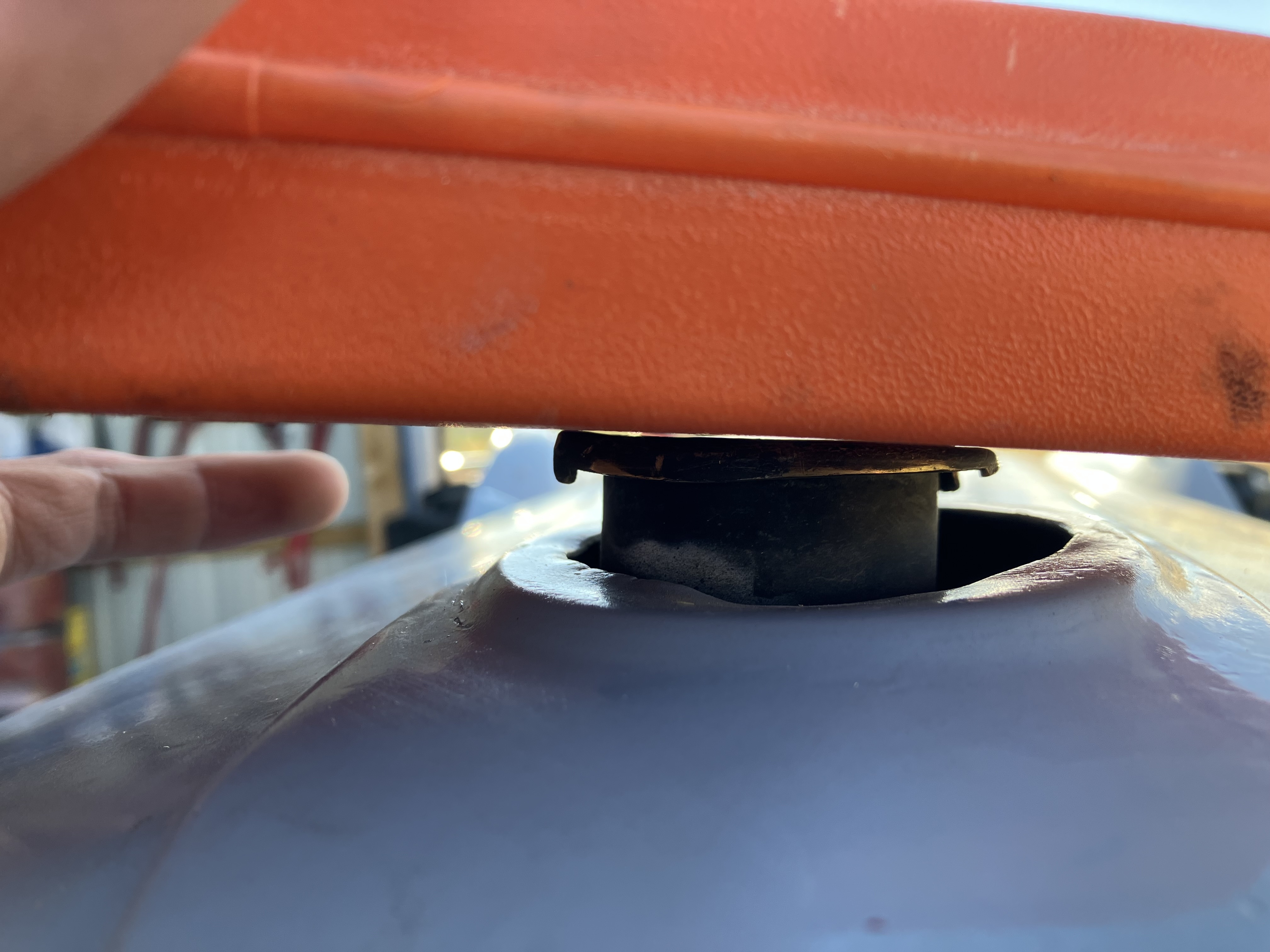

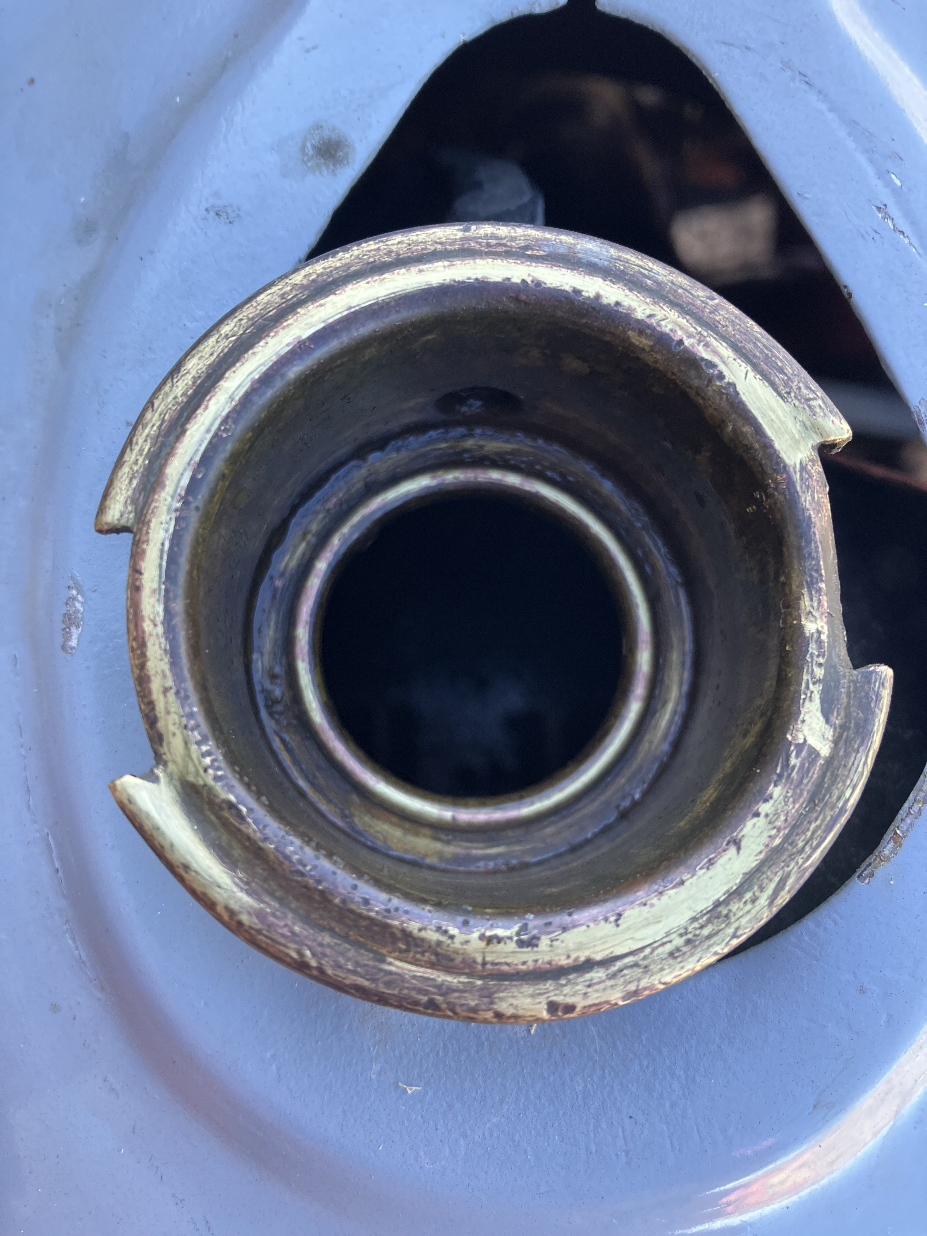

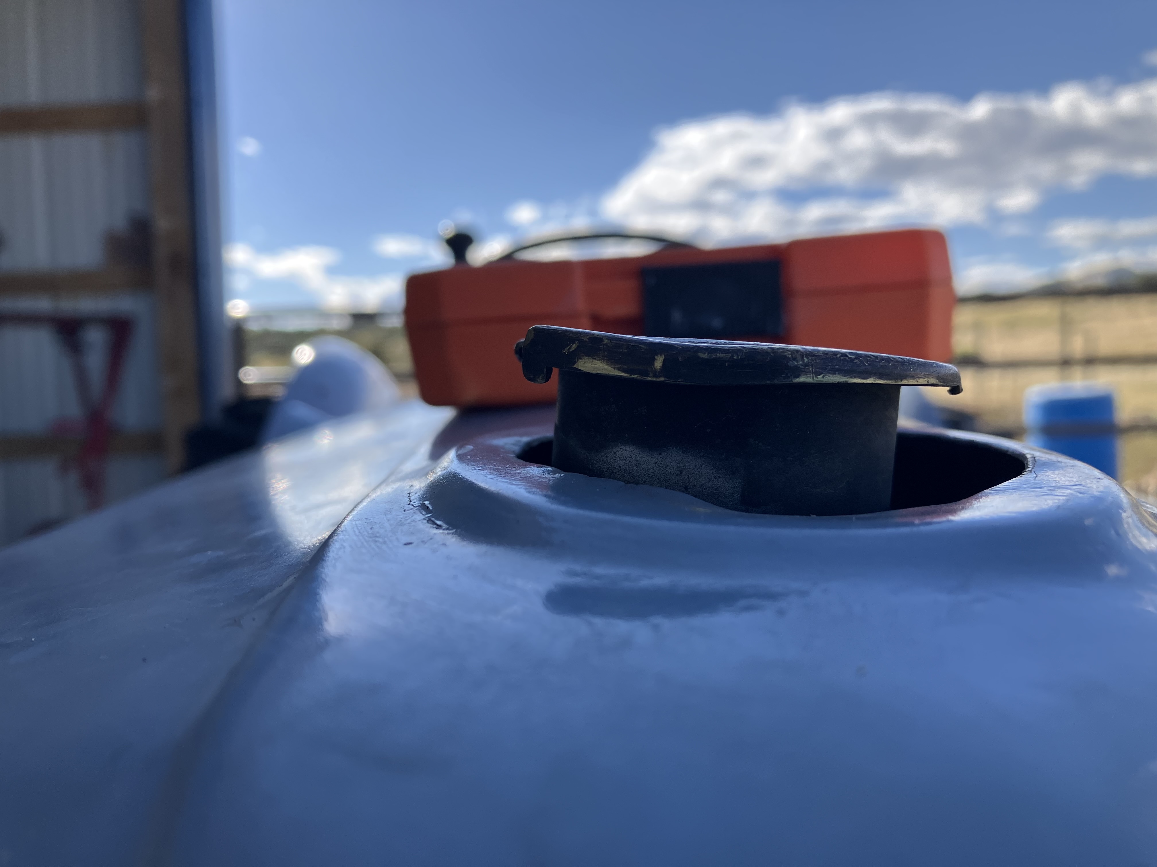

After taking a break from the 8N (and having a 2nd opinion from my brother) I have observed a few things.
1). A new 4 PSI cap from Napa (without the decorative wing) does not fix the issue.
2). After an hour of run time, it has dribbled out approximately 2 quarts. After that the dribbling seems to slow to a barely noticeable drip.
3) I have attached detailed, close up photos of the radiator fill neck. I believe it to be the correct radiator for the tractor. The fill neck is noticeably bent, which myself and my brother now believe is the cause of my issue. How would I go about straightening it? Would this kind of repair require a radiator shop?
