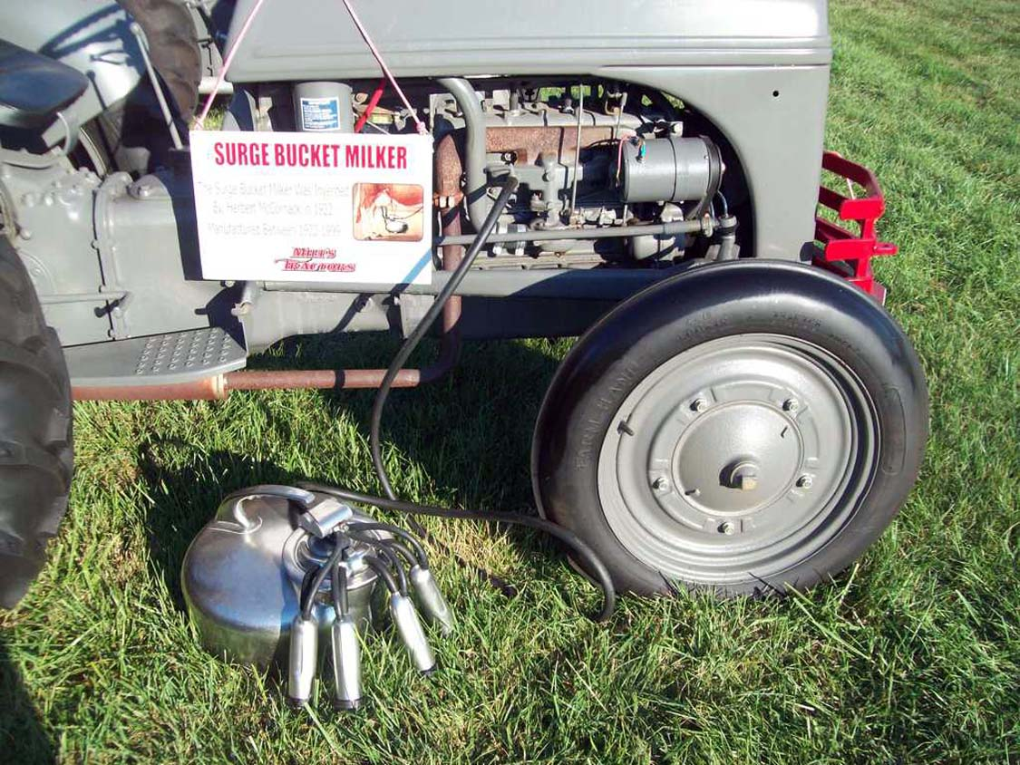

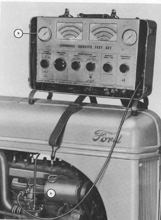

No clue on those two ports. Some N tractor intakes came with a vacuum port that was used for engine diagnosis in the shop and to run milking machines on the farm:
