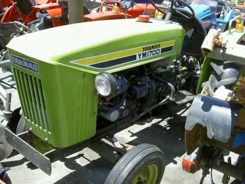

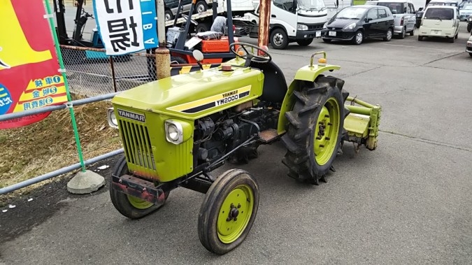

Are there examples of each?
Yes, you can see examples in this posted thread,
Yanmar - Model Cover Pages
The tractor historian in Japan mentioned this on his site too.
When farmers looked into their fields from a distance and seen the green Yanmars, it took on the name Tree Frog as it looked among the crops.
Translated,
"I can not tell the difference, ... Is that a Tree Frog. Is that really the case here."
Lite Tree Frog Green,

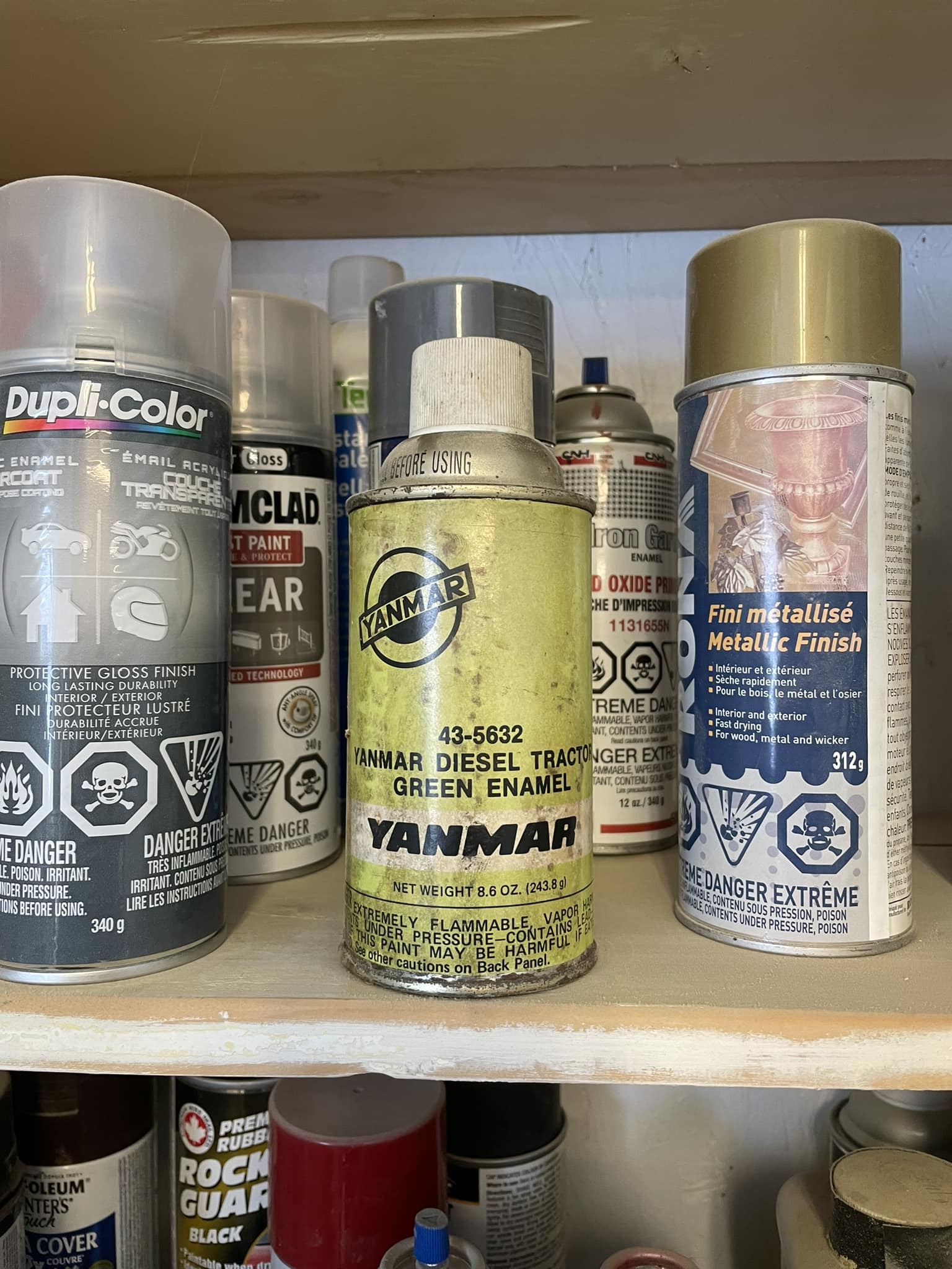

The Kramp swatch matches the Lite Tree Frog Green,
