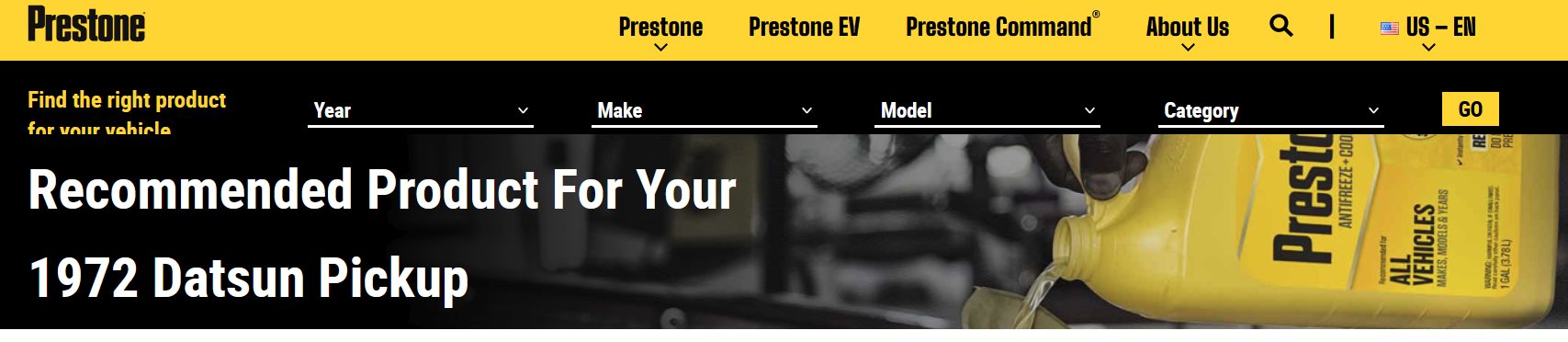

But we have Japan made tractors . . . :eek:
OK, then use this since @California says we can find all kinds of parts from Nissan/Datsun and Mazda 1970s models for our Yanmars. (y)
Let's try this then for a 1972 Datsun Pickup,
