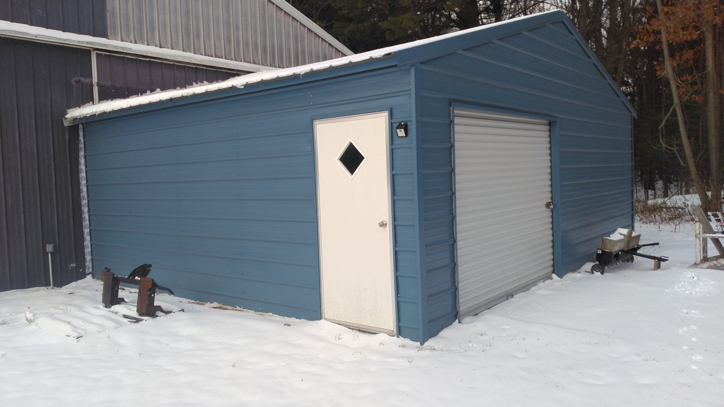

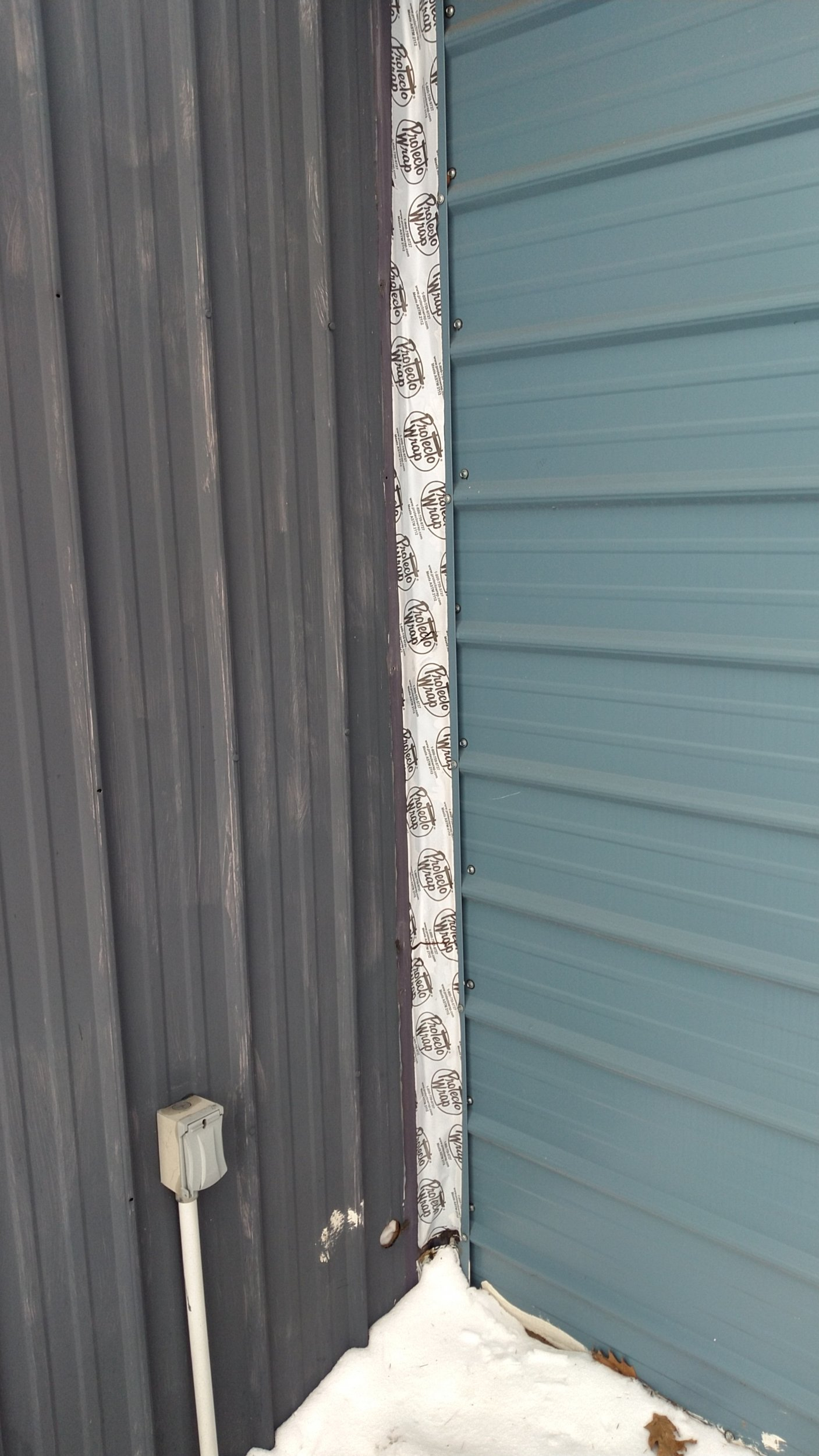

/ New Metal shop #36
Nice I'll be curious to see the flashing you use about 5 yrs ago I used left over adhesive window flashing as a "temporary" dry in fix around walls and roof, unfortunately it's became semi permanent.

#37
That is what I was trying to avoid when I decided to over lap the buildings, the new metal should land just behind the first ridge on the old building
Unfortunately in my case in order to save a few bucks my steel sheets on addition run horizontal, the gable/ wall of existing barn run traditional/ vertical. I at least planned and researched, enough the peak of roof has a three pitch und tucked/ fit underneath the awning of the old sliding door.
