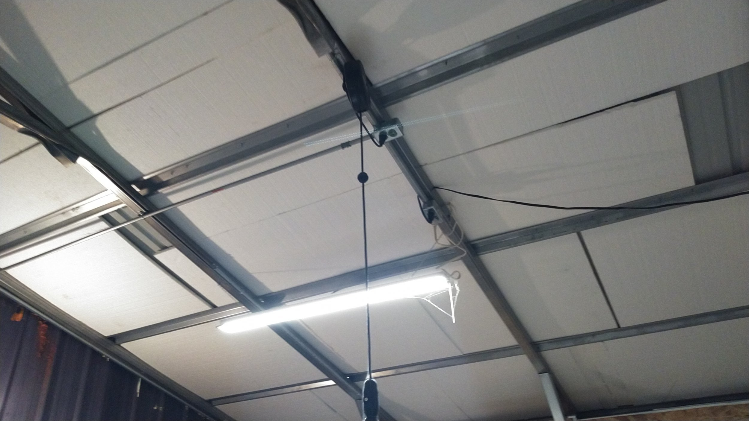

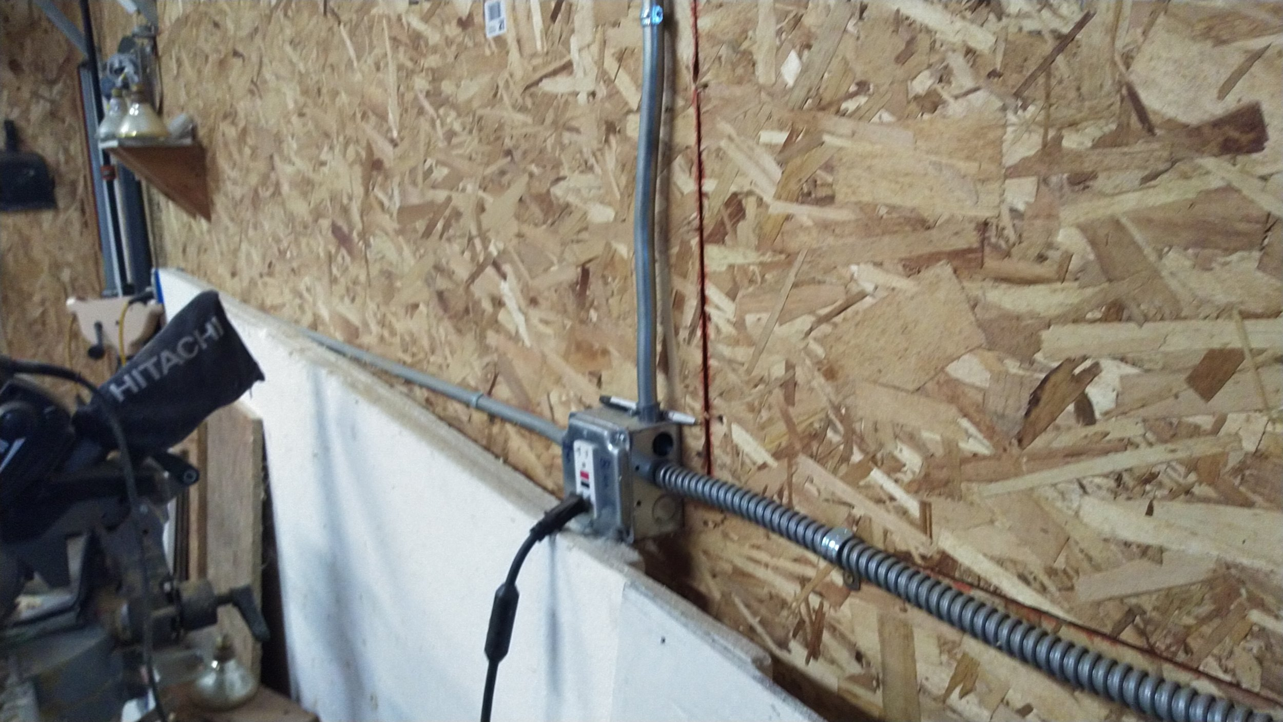

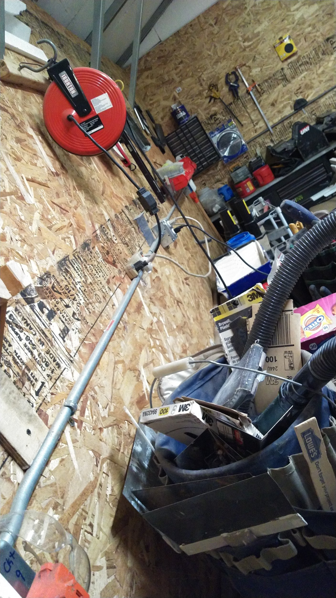

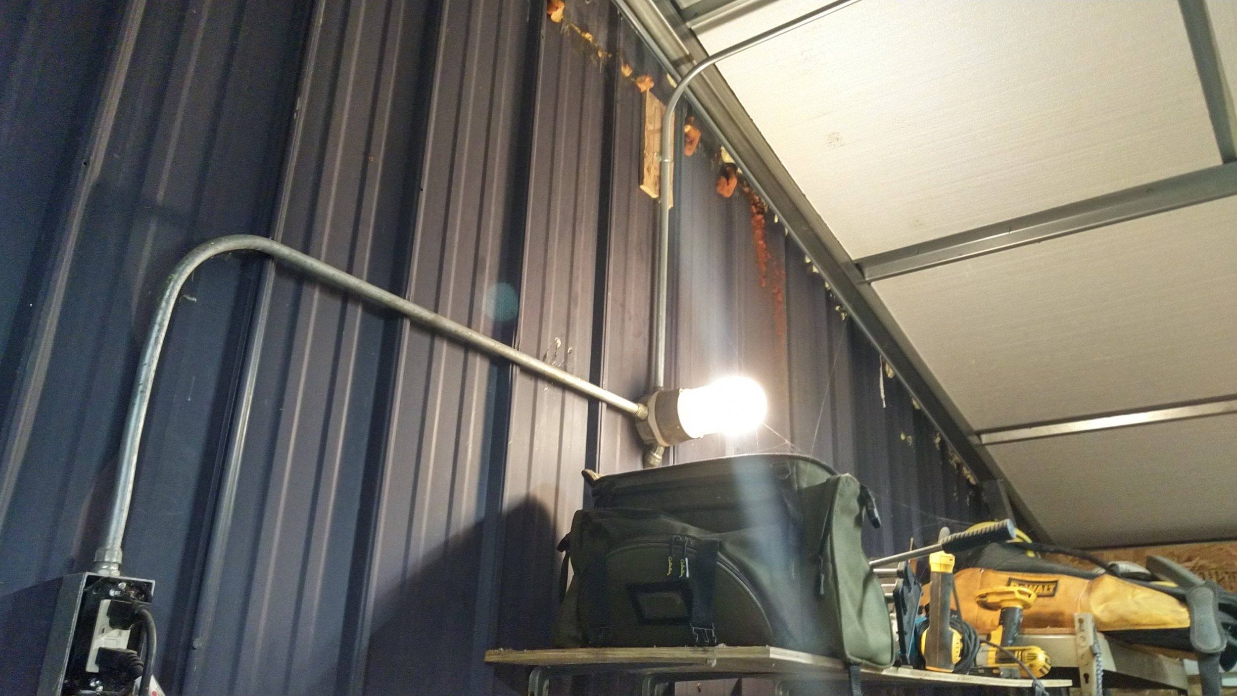

/ New Metal shop #10
Had about a 20x20 3 sided carport added to my existing barn over the existing slab which used to be a green house. It's now my "wood working area" Ran steel conduit over osb, also ran a small piece of steel flex to the existing breaker box in existing barn they do make conduit benders, originally thought of running Romex inside using the ribs of the steel sheets as raceways thought about it went a different route, also thought about plastic conduit steel is better imo especially when it's exposed and probably code, ran 2x3s so the osb would end and start on something fastened osb with self tapping steel stud drywall screws, no problems for 4 yrs now.
/ New Metal shop
#11
Jeff that is so close to what I have in mind, I was considering using EMT because it is metal and I think would be better but I have about 10 sticks of 1/2 inch PVC conduit laying behind my shop I can use instead of buying. I see you used some MC cable and some EMT I may use some PVC and some EMT will know more when I have the building up. Thanks for the pictures
