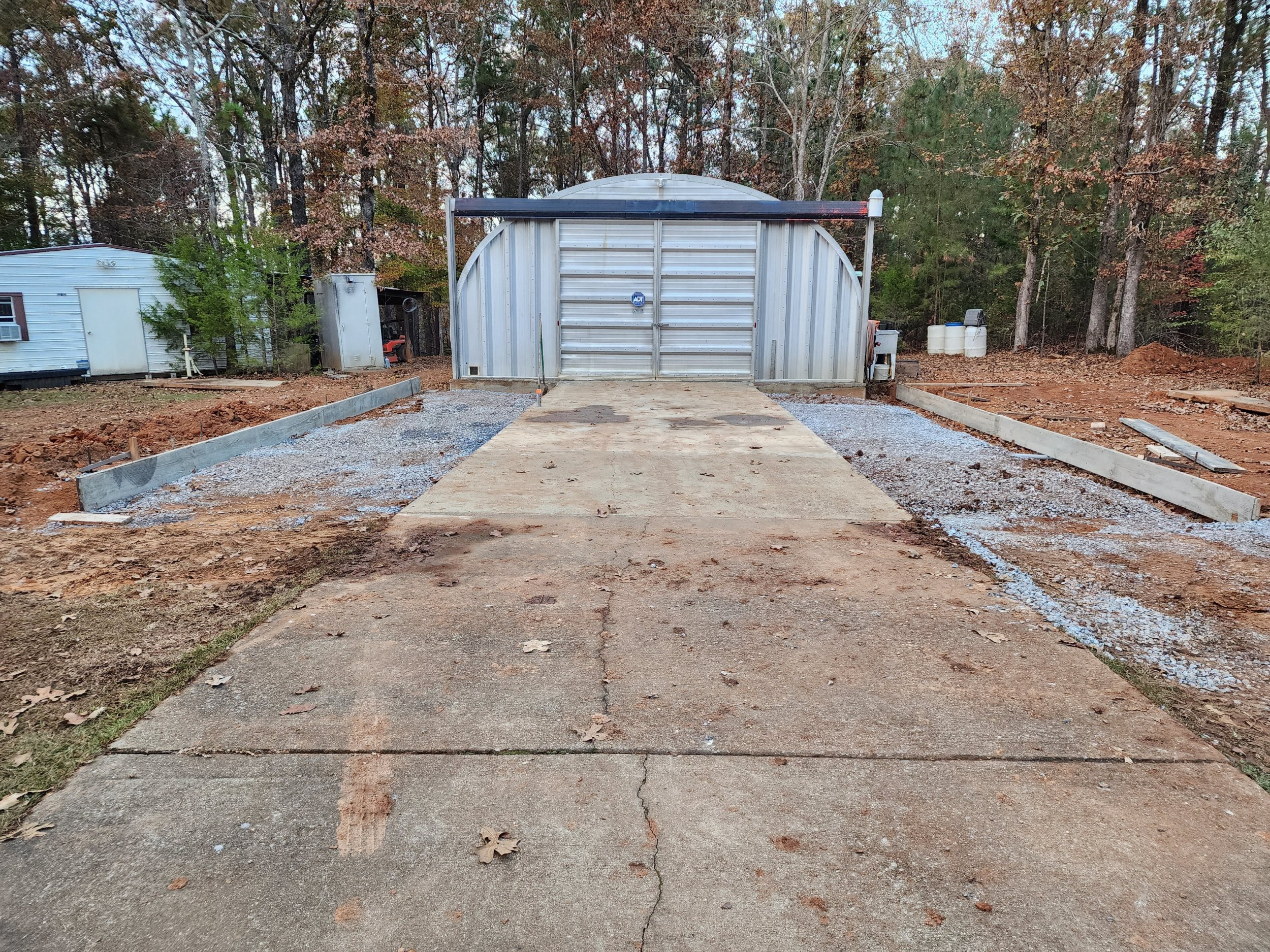

Thank y'all for your replies, I had thought about putting in a GFI breaker in but I had not really decided yet. when I wired my other shop 20 years ago I did not install any GFI's until later when I installed a RV box for my Dad to use when he came to visit and it has a 50A, 30A and a 120 volt GFI so that makes all my 120 outlets that are outside of shop or house GFI protected and I use the one at the shop most of the time when power is needed outside. I am going to finish the rear wall that goes over the old shop and install the front door from my old shop before I start the wiring process. physically anyway mentally I have been wiring this building since the day I decided I wanted it. I got up at 5AM and told my wife I was going to see how the lights look in the shop I worked on them all night while trying to sleep.
PS: no the GFI's at the shop and house are not connected was just saying all outside 120 plugs are GFI.

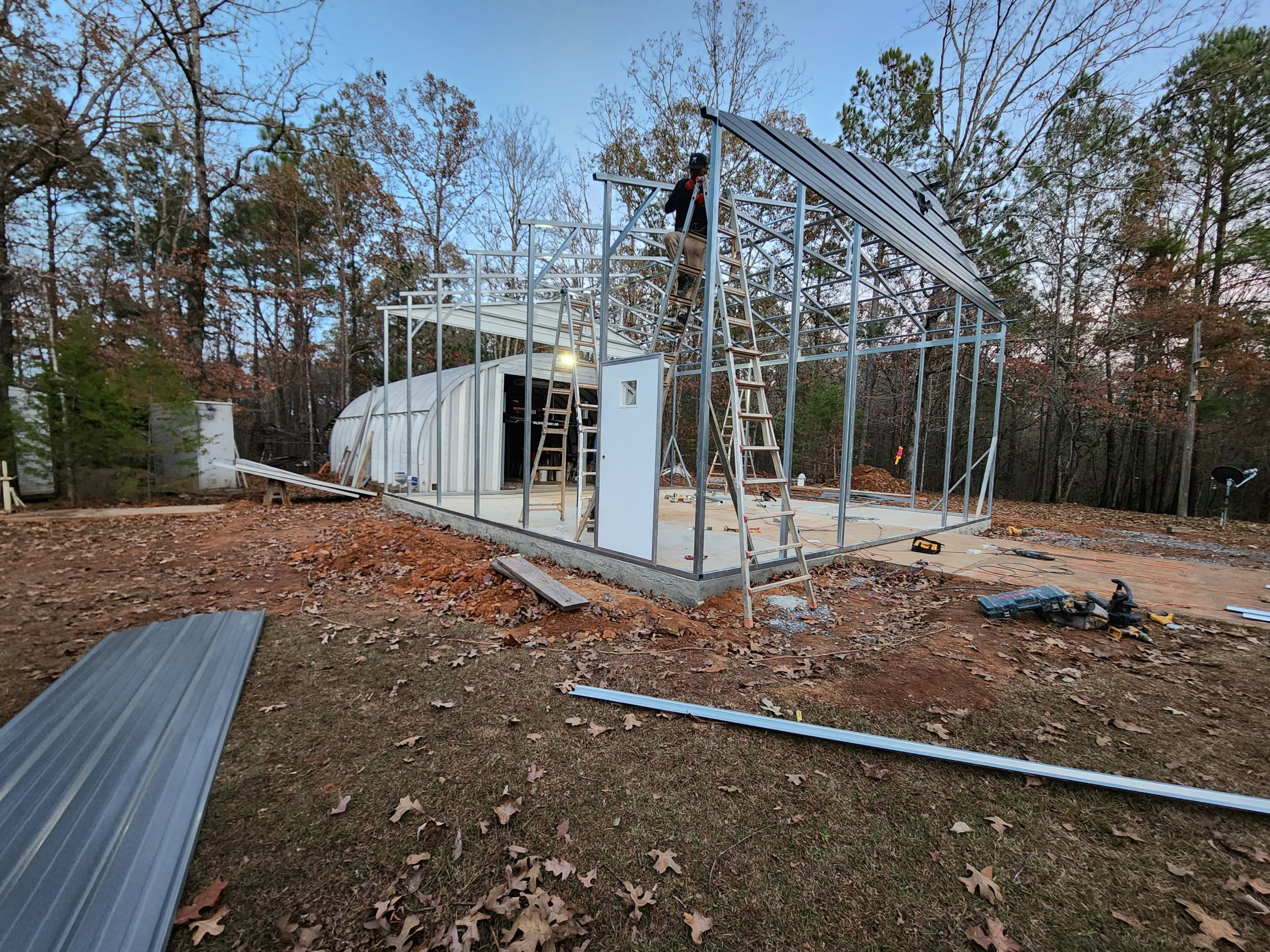

Another consideration of using a ground wire instead of using the EMT for grounding is the amount of movement in a metal building. They creak and move as they heat up and cool down, plus wind can bend the structure back and forth.
I hired an engineer to be involved when I built a metal building shop. One of the first things he did is advise me to pay for extra stiffening of the building. I believed it was the "deflection" factor or something like that. The metal bldg manufacturer knew exactly what I was asking, and yes, they did have the option to ship me a stiffer built building ($$).
I was surprised that the standard metal building spec allowed for a certain amount of movement in wind. It was something like 1" either way at a corner. The stiffening I purchased cut that in half.
Anyway, my point is ... if concern about using EMT for grounding is that a rusty box or loose fitting could compromise the ground ... I believe building movement could contribute to that.

Good point, I plan on running a ground wire from the panel and grounded the building also.

Question are you planning to join your new building with your existing quonset hut?
/ New Metal shop
#35
Yes the new building over laps the Quonset hut about 6 inches so when I finish the new building it will be all closed in, metal to metal and electrical

That is what I was trying to avoid when I decided to over lap the buildings, the new metal should land just behind the first ridge on the old building
