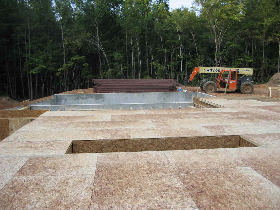

Main floor decking. The lack of decking adjacent to the garage is due to the fact that the garage floor has not been installed yet. Their tardiness is about to have an impact on the framing.

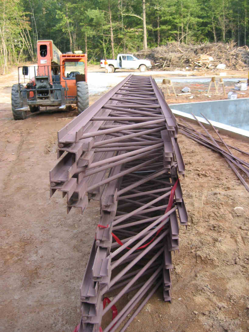

I'll end today with a less than interesting photo of a pile of steel. This is part of the support system for my garage floor. Hopefully, it will go in tomorrow.
Thanks for following along - I welcome comments and questions.

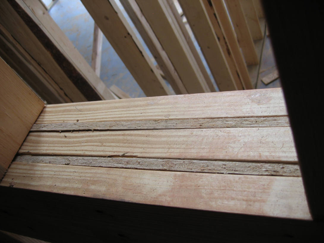

The headers aren't what's normal for me. Using the 2x4 on the bottom works, but I like plywood sandwiched between the boards. Did they use plywood? Again, it's not a big deal, just a personal preference.

<font color="blue"> The headers aren't what's normal for me. Using the 2x4 on the bottom works, but I like plywood sandwiched between the boards. Did they use plywood? </font>
Yep.. See attachment.
