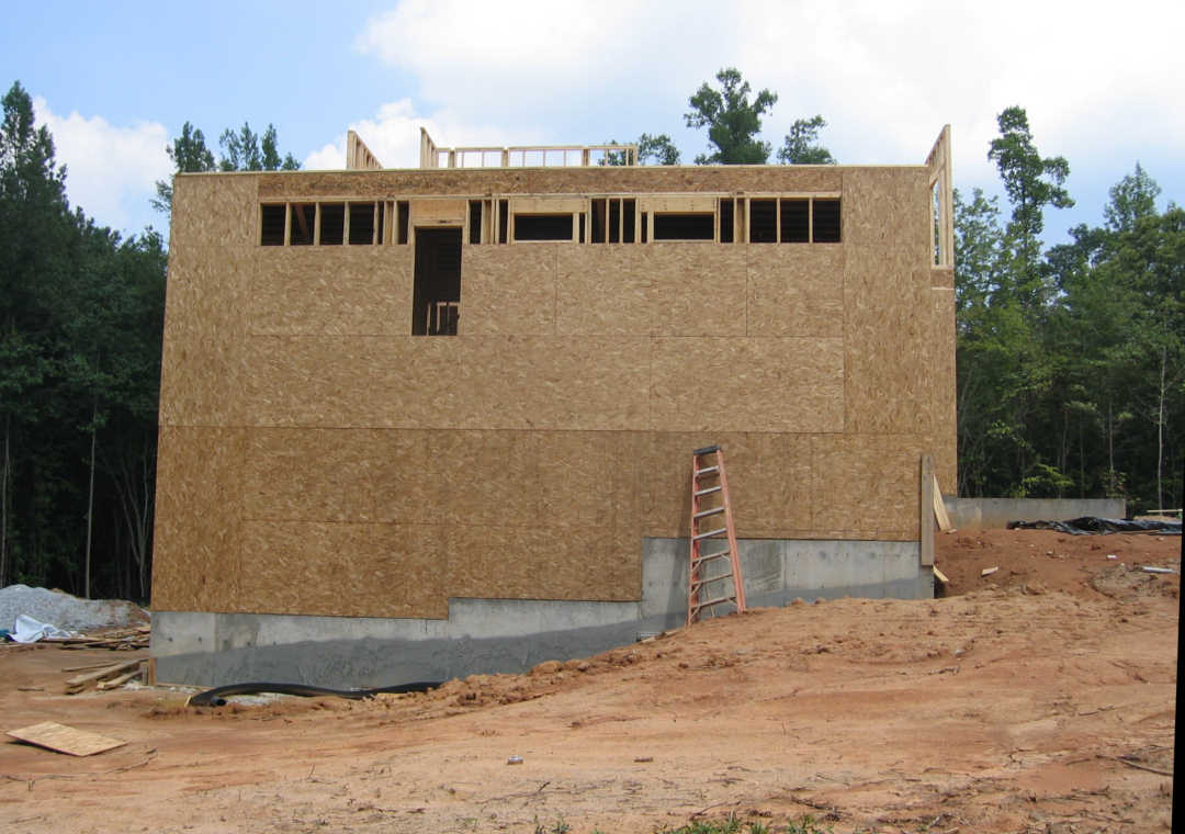

#138
I'm Back!!! First, a short review. The last pictures I took were posted on 8/8 and showed that about 2/3 of the first floor had been framed. The framing crew only worked on our house Mon. and Tues. of that week as they had to put in some windows on another project. While they were gone, the the concrete slab in the garage was poured.
The framers returned on Monday of this week and resumed framing the garage end of the first floor. We had to make a couple of lunch-time runs out to the site in the middle of the week to clear-up some more architectural issues. I did not have my camera for any of those trips. Evening visits were limited by kids activities and evening showers. So, today was the first time I was able to get out there with my camera. Unfortunately, I had to meet a sub out there and by the time we finished with him, I only had an opportunity to take a couple of pictures before I had to leave.
The design problems this week were a mixture of changes in the second floor plan that my wife wanted to make. These were minor changes that did not present any real challenges for the builder. But, by simply changing from a shower to a tub in my daughter's bathroom required changing the location of 2 small closets. Fortunately, there is so much wasted space in this design, we had no problem finding a new space for them.
The real problem that was due to negligence by the disappearing architect involved ceiling height in the guest bedroom. It appears she disregarded the pitch of the roof when she drew the floorplan for this area. She had a 6'8" door in a wall that, due to the roofline, would only be 5' high. OOPS!! According to her design, one would have to duck one's head to sit on the toilet in the guest bath. Now, as I am not all that fond of having company stay with us, I thought this was a good feature. Might prompt an early departure. My wife thought otherwise. So, the builder said he could put in some knee walls and change the roof design to improve this. I lost the arguement.
The attached picture is from the front. The center portion of the second floor has the exterior walls framed. My son's bedroom and bath is on the front half of this section. A hallway runs left-to-right down the center and my daughter's bedrrom / bath is on the back half. The cursed guestroom will be in the as yet unframed portion on the left. Over the garage will be unfinished attic space. Many might use this as a finished bonus room. However, with each kid having a large bedroom, we didn't see the need to finish this space. And, it will be much easier to store and access stuff here than in the true attic above the upstairs bedrooms via a pull-down stairway. In fact, I'm thinking of putting upstairs HVAC in the "bonus room". My thoughts are (1) easier access to change filters and other maintenance and (2) in the unlikely event of a condensate leak, the only thing to be affected would be the garage ceiling. I haven't run this by my builder yet. What do you good folks think of this idea?
Well, when you don't have many pictures, you have to type alot. Sorry for the long post. If I get out this weekend and see anything worth photographing, I'll take some more.

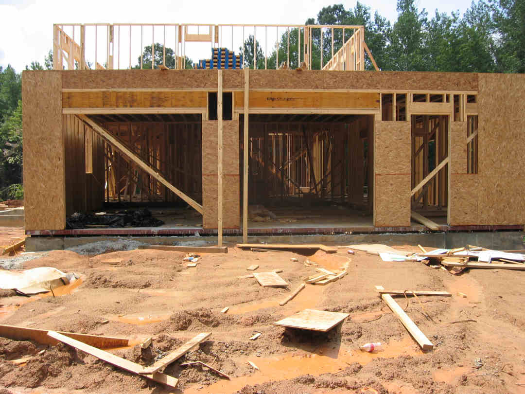

#139
Here's another from the garage end. When the muck dries out maybe I'll venture out to get other perspectives.
The garage door openings are 10' x 9' (or that's what they are supposed to be. Haven't measured them yet). I told the architect to make them big enough to accomodate any sized vehicle I might want to get. With 24' of garage depth, I think we accomplished this. Now that I think about it, would a Unimog fit in there?
