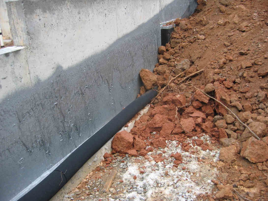

Today, the waterproofing material was applied to the exterior of the basement walls. I'm not sure what they used but it is a spray-on product, silver in color, that, according to my builder will set to form a flexible rubber-like material that will not crack even if the underlying concrete forms a crack.
Prior to applying this material, they removed all of the exposed wires that held the forms in place and covered each of these wire holes with a caulk-like material. Again, don't know the exact product they used.
My wife is on a short trip with my daughter and has the camera with her. Hopefully, she'll be back before they backfill the trenches so I can get a photo.
/ New Home Construction #75
Sounds like your contractor knows what he is doing and is gona give to a dry basement, that product is one of the best waterproofing methods to ensure a good seal. keep the pics coming

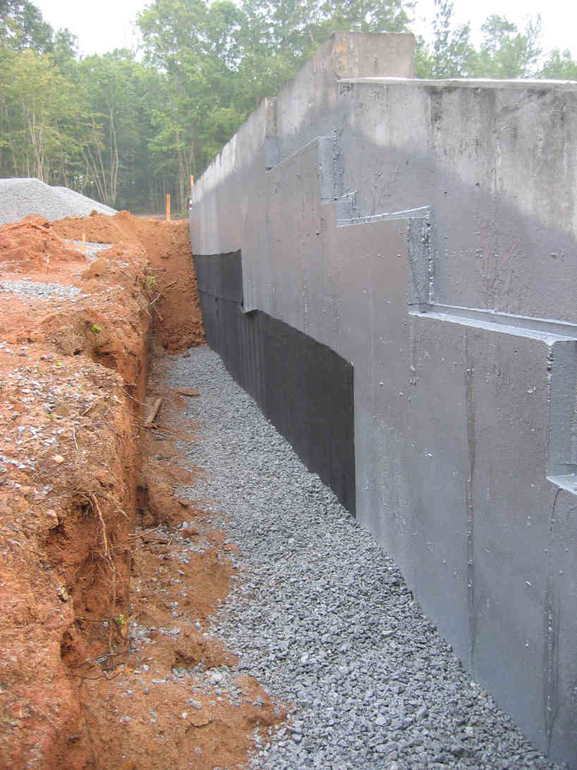

Today, the tractor man backfilled the trenches around the basement walls. Fortunately, he was still working when I arrived so I was able to get some photos of the waterproofing efforts done two days ago.
The first pic shows the silver spray-on material over which they placed a black fabric of some sort. The fabric is to keep the gravel and dirt from damaging the waterproofing material. Below the gravel is a fabric covered corrugated drain pipe. This photo also shows the brick ledge on the concrete wall nicely.
