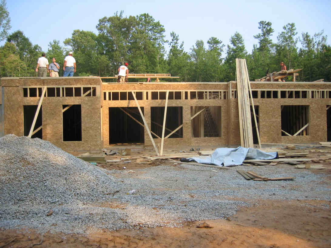

Here, building codes require that any seam in the sheathing be secured. For our purposes, primarily it has to do with giving strength against the various wind loads experienced from hurricanes.
That aside, there are a number of circumstances that present themselves regarding the seams. First, there is air leakage from and into the house which affects the energy effeciency of the home. Second there is the strength and/or the integrety of the wall. By blocking and nailing all the seams the house is a stronger house. Thirdly, although the point could be argued and considered nit-picking, I personally would consider it sub par workmanship. The house just isn't as solid and structurally sound. This doesn't mean that it's gonna fall down tomorrow or any other time. Ask an engineer if nailing all the edges of the exterior sheathing makes a difference in the soundness of the house. Even though I have been endoctraniated to the codes of my region and I recognize that we are not building a piano here, good work is good work and somehow I don't think that your agreement with the builder suggested that the price you two agreed on was for OK workmanship!! Do you pay your mechanic to under fill your vehicle with oil? All I'm really suggesting here has to do with doing the right thing. There is no question that compromises have to be made along the way. Sorry, that's just not one of them.
PM me any time and I'll give you some insight on other things to look for that probably won't manifest themselves till later and will be too late to do anything about. I'm not trying to open the proverbial can here but the more educated a consumer you are the better the chance you'll get what you paid for. More importantly you'll reduce the chance of getting something you didn't bargain for.

What photo has the daylight? I am not familiar enough in your technical terms to know which picture has the daylight. Also I can't figure out on this message board when people replie, where do I find the orignal message that they are replying to?
In this instance, I went to go see what post you were replying to and could not figure out which one it was so that I could see the photo and look for the daylight.

If you go to pg 21 and look at the first few photo's posted for his lat trip you'll see what I'm talking about.

bmac.....I do want to add that the framers appear to have done a nice clean job and I really didn't notice anything else that I would find suspect in the pics you provided. I wanted to be sure not to send the message that the carpenters did a less than good job.
This is the sort of thing that I would find unacceptable. See the gap at the top of the wall. Had the sheathing been placed along the top plate of the wall and nailed, the wall would be stronger. There are many ways to do the same thing and carpentry is no exception. When I frame my houses I run full sheets along the top and bottom of the wall leaving the odd space in the center. This allows for nailing at the weakest part of the wall which is typically at the joints and helps makes the wall rigid. When that's done I run blocking along the seams in the center. This not only seals the seams but provides mid-span blocking again adding to the strength to the wall. Mid-span blocking is generally used in walls over 8' and/ or multi story buildings that are all or mostly frame. Again...different things are done in different places but I think it's fair to say that what I suggested would be considered common practice.

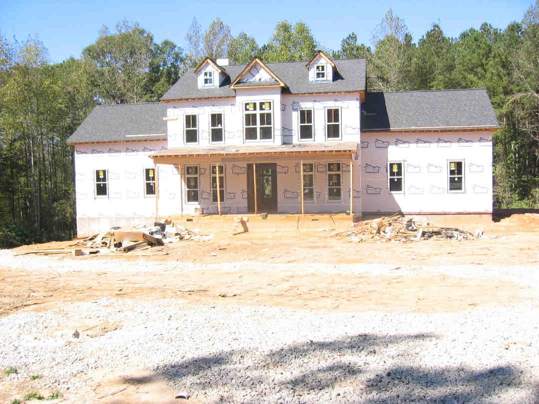

The past couple of weeks have been busy, just not very photogenic. Things accomplished include finishing the HVAC, electric and low voltage rough-ins and setting the windows and exterior doors (except the front door - still haven't picked one out yet).
I took some pictures today. I'll begin with the front elevation showing the new windows.

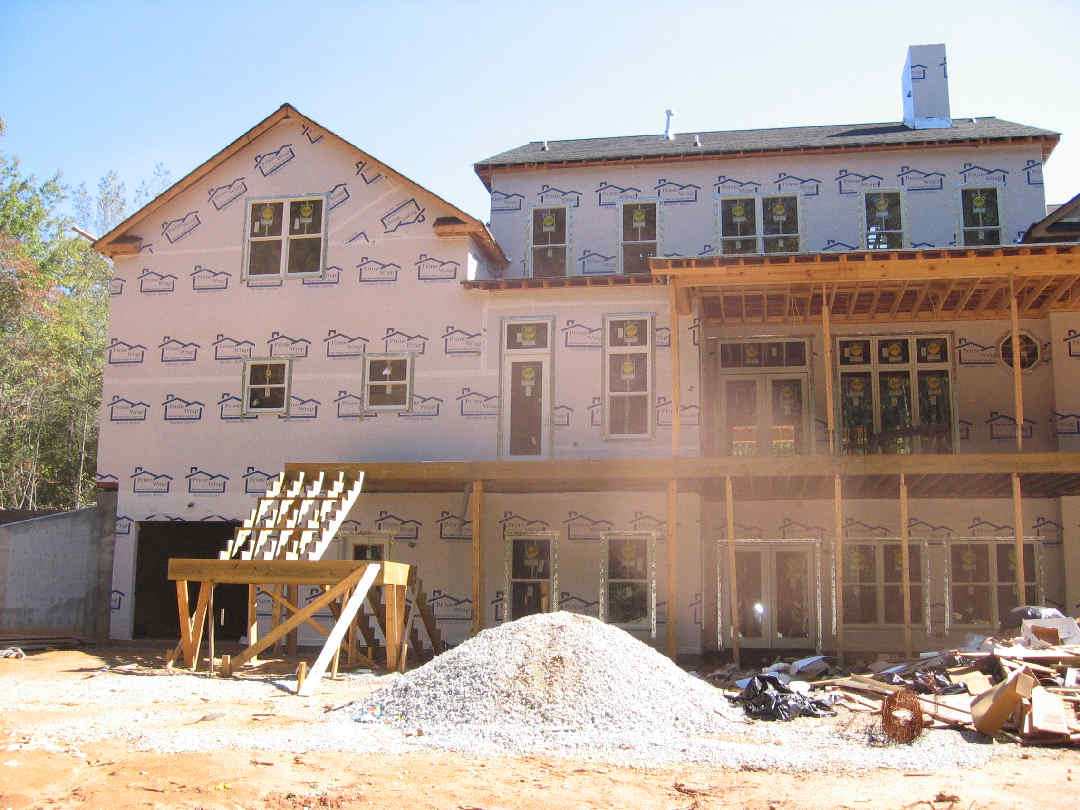

Rear elevation. This picture and the next two are not great. Sun was at a bad angle. Sorry.

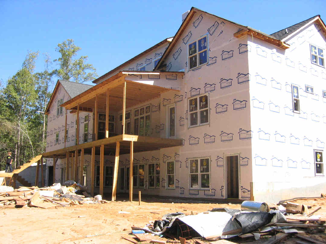

Panned to the left.

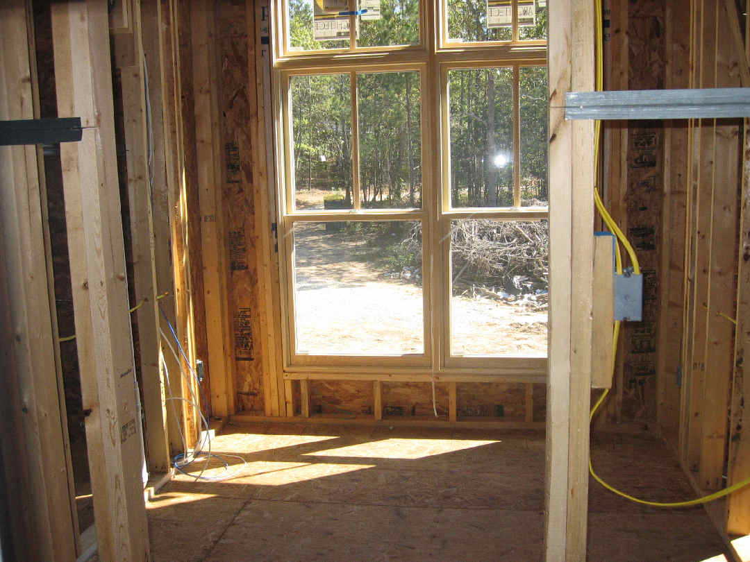

This will be a study in my son's bedroom. This big window is seen above the porch in the front elevation picture.
