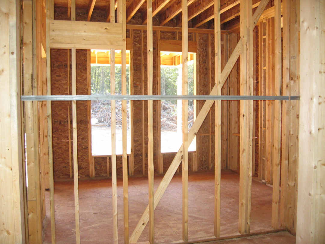

Here's an example of the interior bracing. They used the horizontal metal braces on all wals. This wall seperates the living room from the family room and I think it is the only wall that has the 1 by let in on a diagonal. Anyone have an explanation for this?

You will find that there are many regional nuances when it comes to construction. In the old days diagonal bracing was an intrigal part of the framing process. As technology developed and design methodology changed it has become something that is used more on an as needed basis or by a designer or architect who is comfortable or familiar with it's usage. It's one of those things that If you've been taught to believe in it, you use it.
