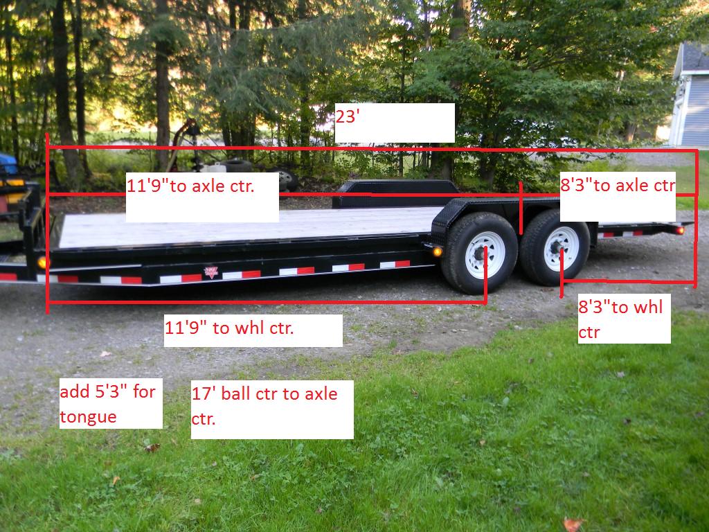

My PJ full tilt measures 17' from hitch to the center of the first axle. Using a digital scale and lifting the empty trailer at the tongue I show a weight of 1195#. I have not weighed the trailer but the brochure lists it at 4000 lb. My 2500HD only drops about an inch or so when I hook up the trailer. Even when loaded with my 5600 lb tractor the truck sits fairly level.

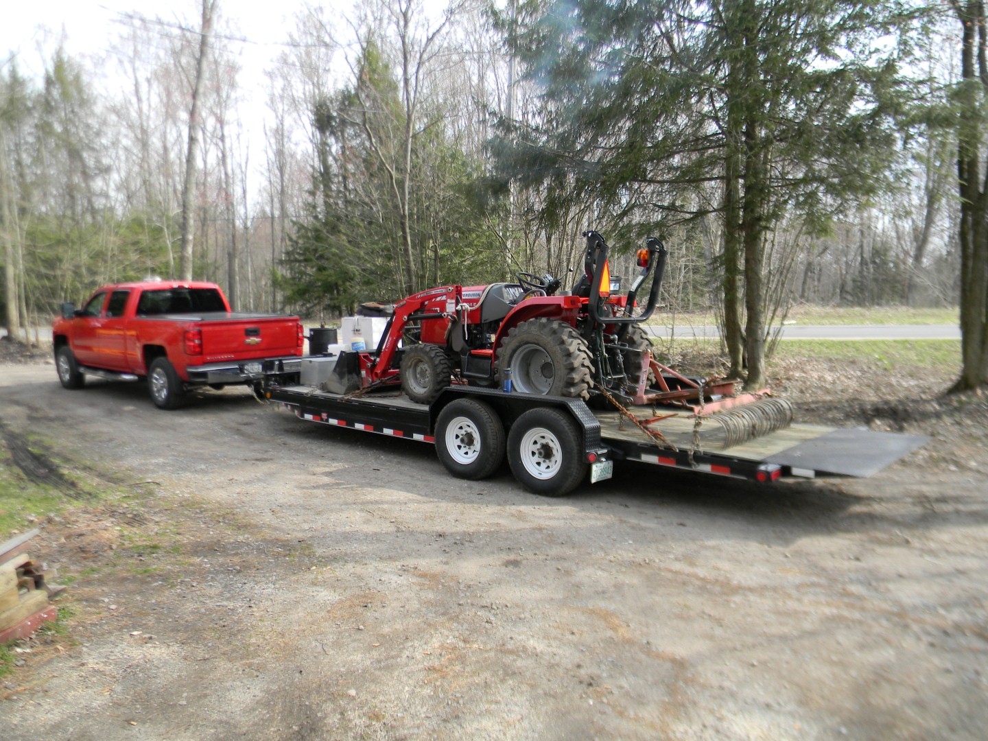

I've attached a few pics. I don't have a good pic of the truck with my tractor on the trailer but have one with my neighbors MF 1734E and the rear still seems higher than the front.

Are the 17.5K trailer axles quad or dual wheel. (Meaning 4 or 8 tires per axle on the trailer). If 8 tires the trailer probably weighs at least 6-7K by itself and if the axles are more toward the rear your tongue weight may be 2K or more causing a lot of squat you are seeing. If you have a standard 2 5/16th hitch you can (and should) use a WD hitch. A pintle hitch trailer is usually on a bigger truck.
