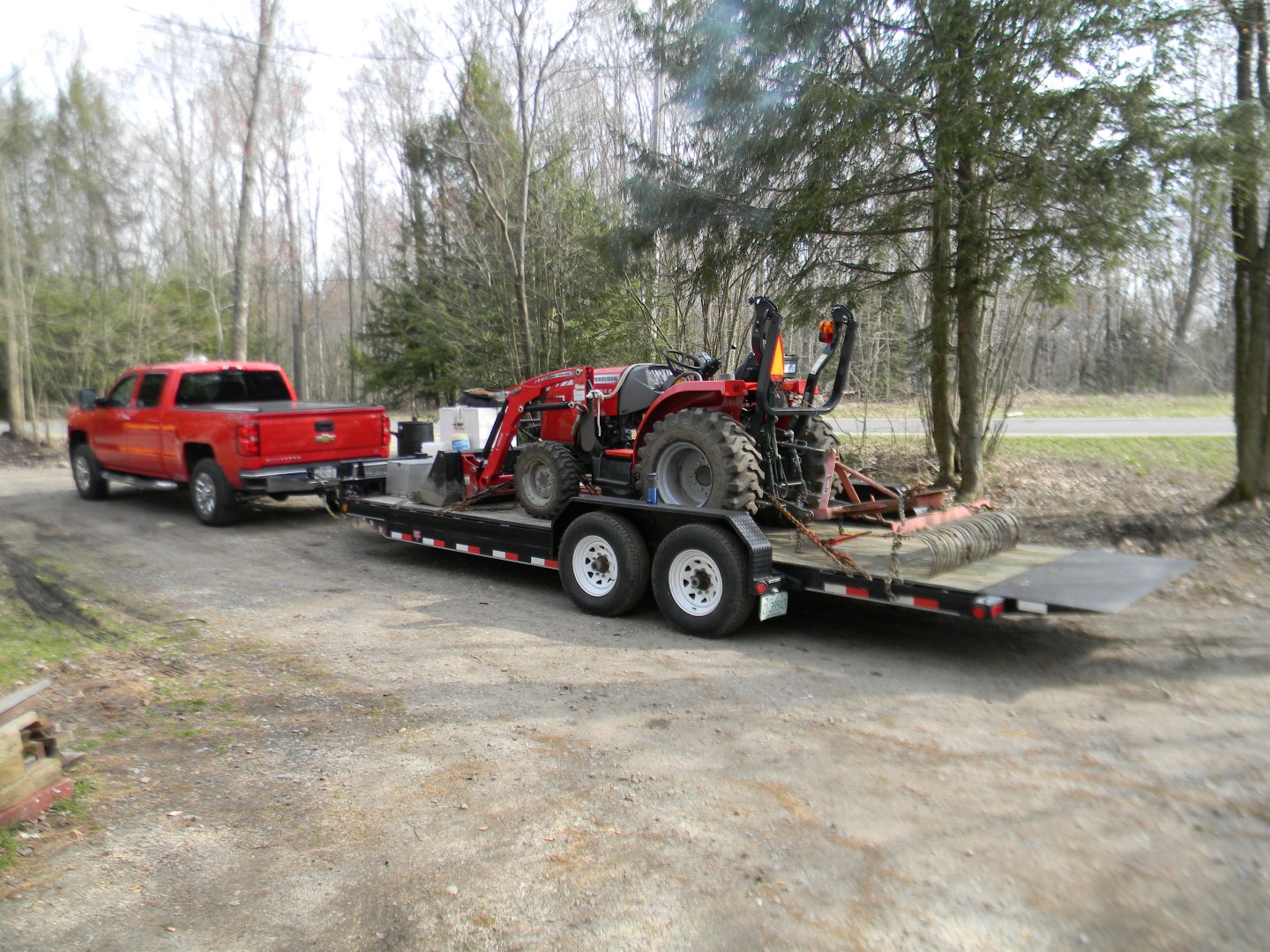

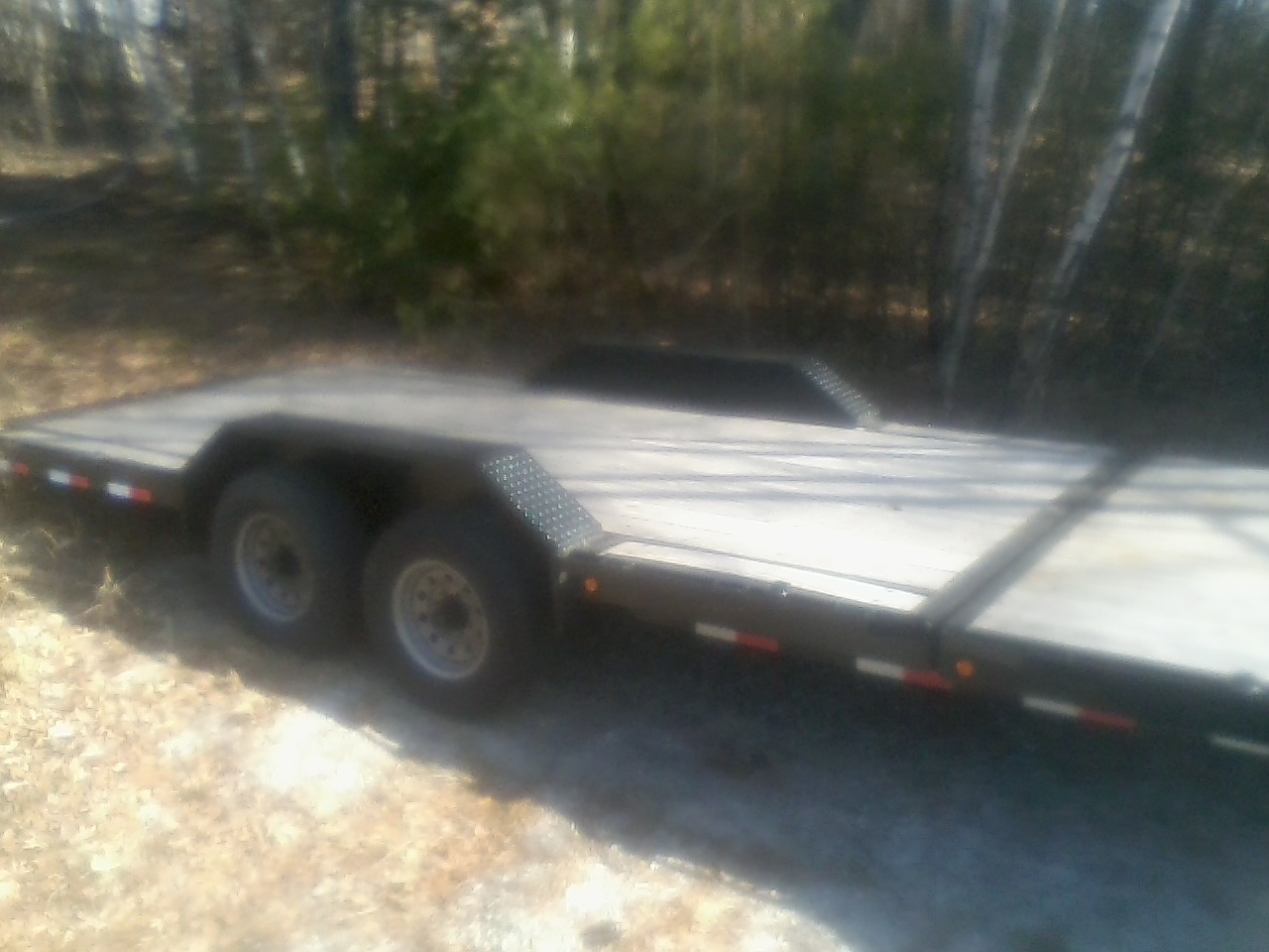

I'm happy with my 22' 14K PJ full tilt trailer. I agree that you may want to go longer. I went from a 20' to 22' when I upgraded trailers.

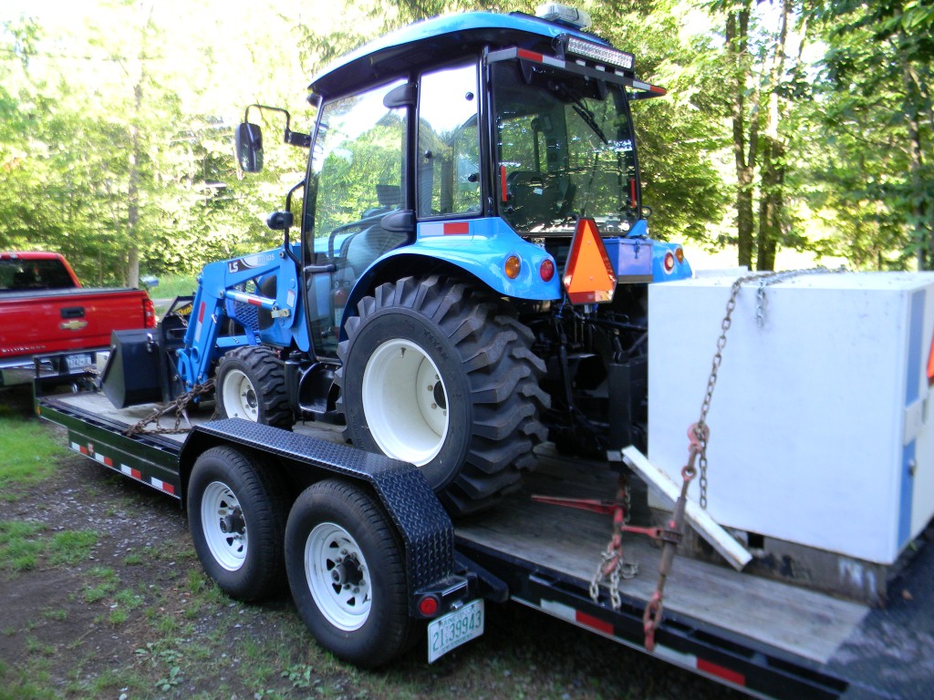

TLB + trailer = exactly 12,000 lbs. Tongue weight 1250 Lbs. Perfect!
I put a red flag on the hoe for towing, but it is less than 2' beyond the tail, so not legally required.

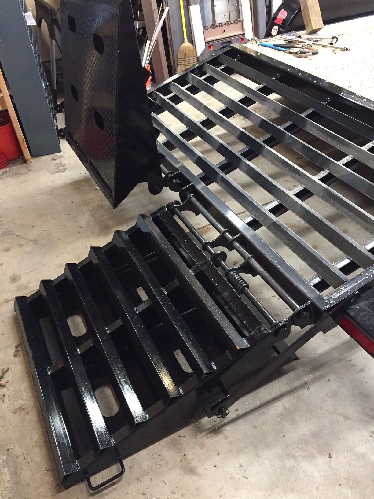

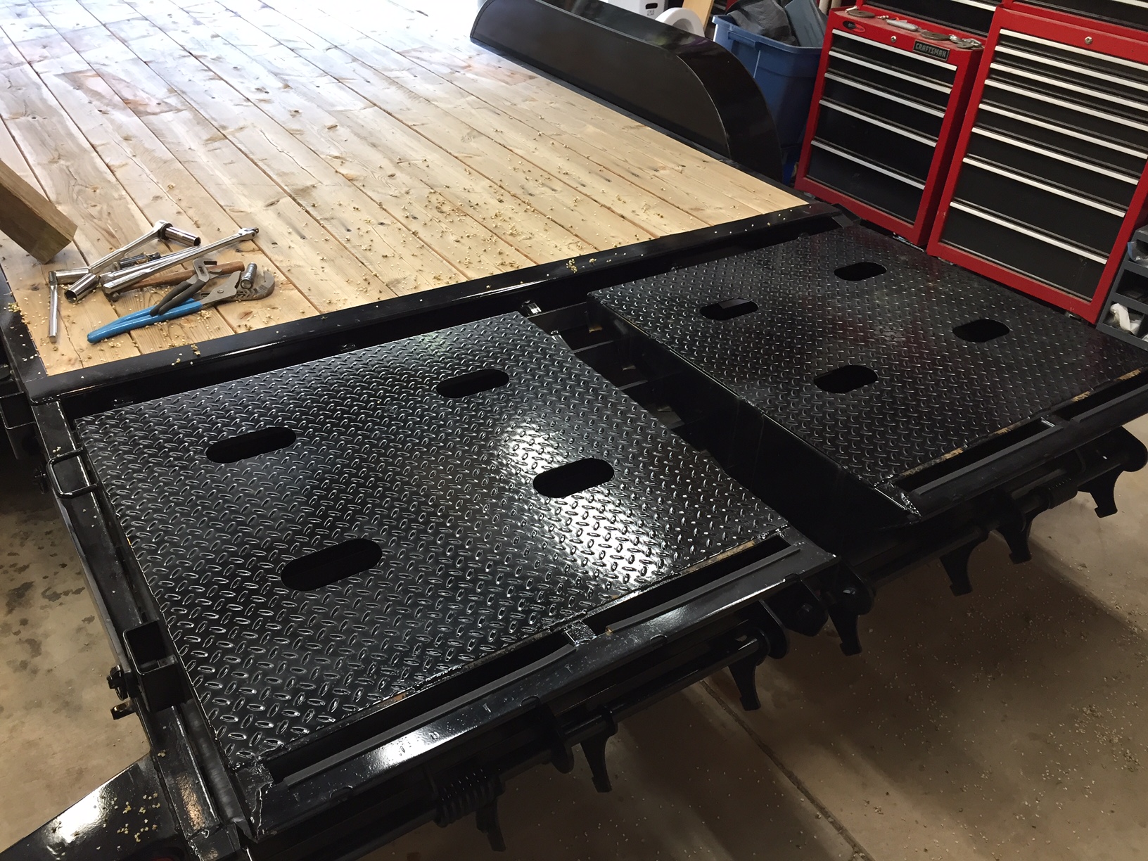

I had a PJ 14k 20ft equipment trailer with dovetail and fold up ramps, that was a very nice trailer. But I found I really did not need the carrying capacity. And the dovetail subtracted from the useful length. I replaced it with a Big Tex 10k 18ft trailer with what they call Mega Ramps. Folded all the way up, they provide a full flat 18ft bed. They can be left straight up too. And they are full width, so loading is easier and safer than on the usual fold up ramps. So far I like it fine.

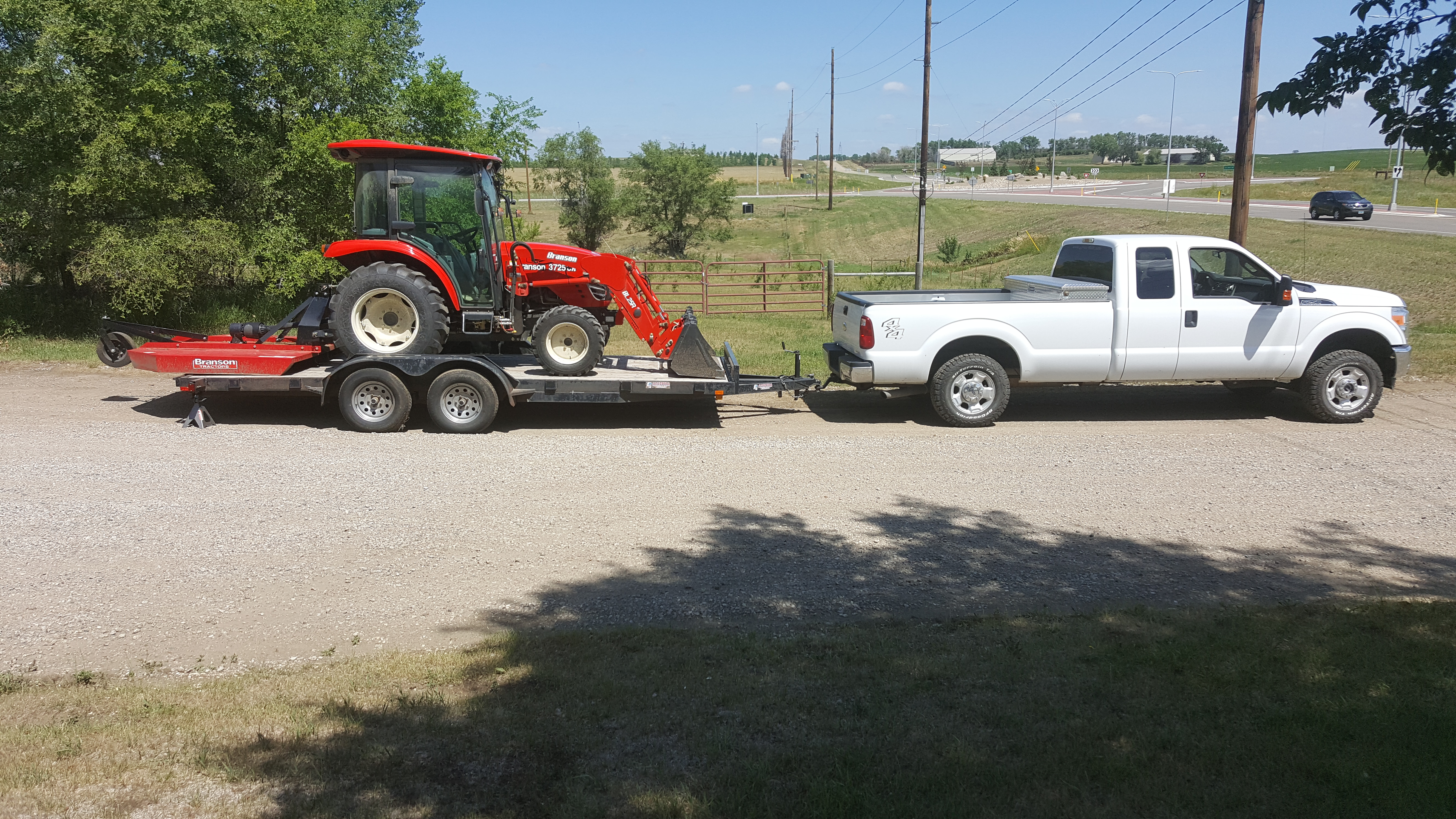

I was looking for a new "Last Trailer I Will Ever Buy" ....
I needed it to be big and strong enough to haul my Mahindra 4025 with a FEL and backhoe as well as easy enough for me to use hauling motorcycles. Ramps were out because my wife rides a Can Am Spyder (3 wheels) and I also have a JD AMT 626 (5 wheels). So a tilt bed with a straight back edge was the ticket.
There are 2 manufacturers of trailers within driving distance so I looked at them as well as "Big Tex" and all the other major brands. I went with the Gator (picture below). I went with a 16K 20' + 4' tilt bed. The 4' stationary is big enough for my needs and I really like the low bed tilt. easy to load anything including my wife's Can-Am - Spyder 3 wheel motorcycle.
The Gator has a much stronger gooseneck made out of 12" "I" beams and the frame is all 6" X 3" (I believe) square tube. The tires were upgraded to 17.5 in 16 ply, and came with a spare.
This is a beast that's easy to handle, drives great, loads easy. looks good (powder coat finish), and was significantly cheaper straight from the factory.
Take a look at them, you may be surprised.
