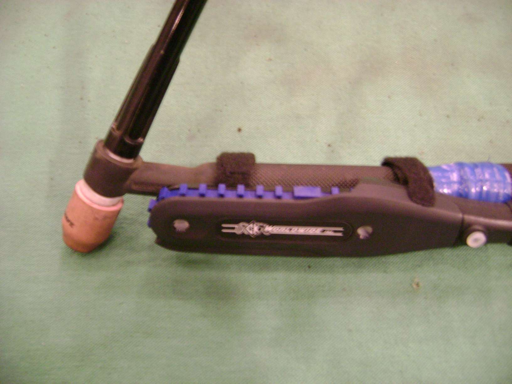

If you're going to get into aluminum work with Tig. Dust off your wallet! And if you plan on doing any work on thicker aluminum, you may want to take quite a few aspirin because it's really going to hurt!:eek:
My 300-amp Tig welder really struggles with 3/8-inch thick aluminum, especially if it's of any size.
Water cooled torches are nice because they are smaller than air cooled. Yes you need a foot pedal or hand control when doing aluminum, you start out with high amps, then start backing off the amps as you continue to weld.

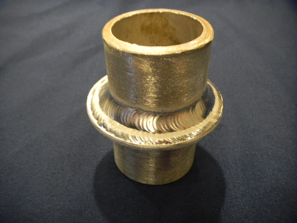

Here is what a good Tig machine can do. Now this is all machine, (Dynasty 300) because I wouldn't make a pimple on a real Tig weldor's behind.:eek:

Wow, Shield Ark, that is quite the weld.
