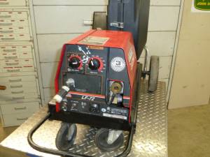

/ Need TIG machine purchase advice #28

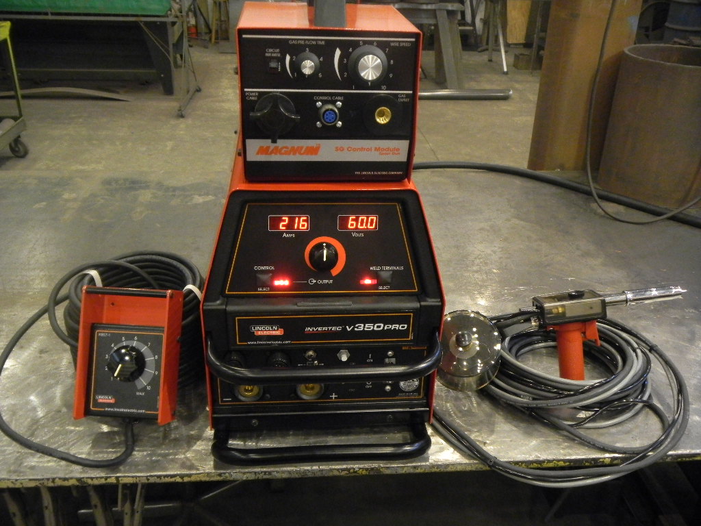

Jim why not look at multi-process machines? I just love my Invertec V350-Pro with SG spool gun, and LF-72 wire feeder.
Invertec?ョ V350-PRO Multi-Process Welder (Factory Model)

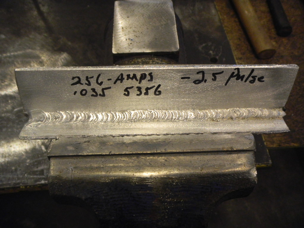

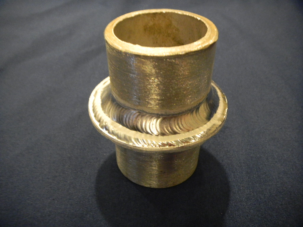

I've heard nothing but good things about Miller's 350P. My Invertec V350-Pro is the pulse version. Here is what it will do with spray, and pulsed Mig aluminum with the spool gun.

Yes you need a separate wire feed, a spool gun, and a foot pedal for Tig work, now remember the V350-Pro is DC only. So if you want to do Tig aluminum you'll need a bottle of helium. Everything is plug and play, couldn't be easier!
Invertecョ V350-PRO Multi-Process Welder (Factory Model) Ready-Pakョ w/ LF-72 Wire Feeder
You might find a better price if you don't buy the package, take the Lincoln part numbers and search for them on this site. I bought the V350-Pro from these guys, but found a really good deal on the LF-72 wire feed on Craig's list.
