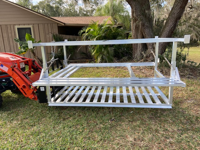

I do a ton of aluminum welding. I used to use a spool gun for years with success on a old Millermatic 200 I bought new over 40 years ago with straight argon gas. Over a years ago I sold it after purchasing a new Millermatic 255 pulse welder and use their Alumapro push pull gun. It does a very nice job. This is only good if you are planning to do lots of welding due to the expense involved. The most cost effective is the spool gun. Look at USA welding supply on line for the best gun choices at a reasonable price. I went back to Miller for a new welder only for security. I feel like they will be around for service for as long as I will be around. This mig I use will go places a tig won't (I used to do tig) go. Also very fast as compared to tig. I had a old Miller 300 water cooled tig years ago with the frequency option to make the arc jump to the work. Every time I hit the pedal and welded all the TV`s in the area had their pictures screwed up. They never did figure it out!
