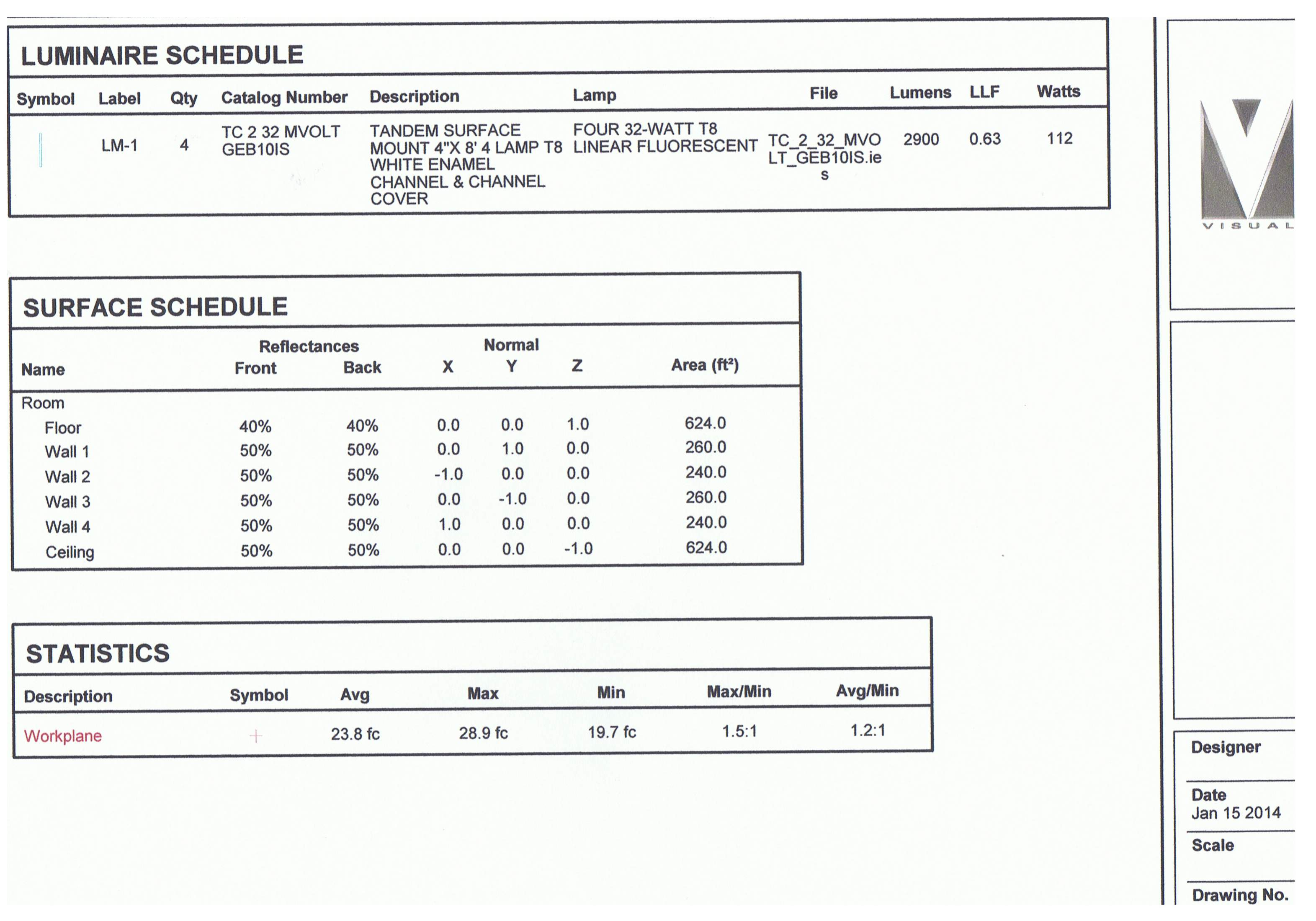

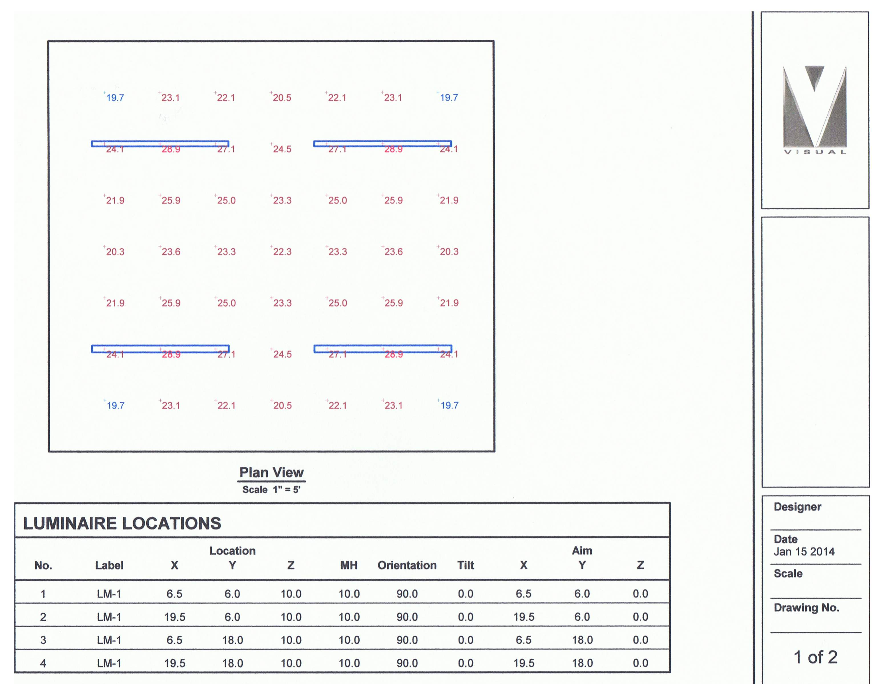

There are programs to calculate your lumen requirement. This below link is interactive and free. You model your building (rectangular only) and pick a fixture and bulb output and the foot candles and it calculates the number and location for even distribution. You can try different fixtures and bulb ( like HO for High output) I used this in my shop and decided on 96" twin HO every 15'
Visual
You can determine your foot candles from the insert
