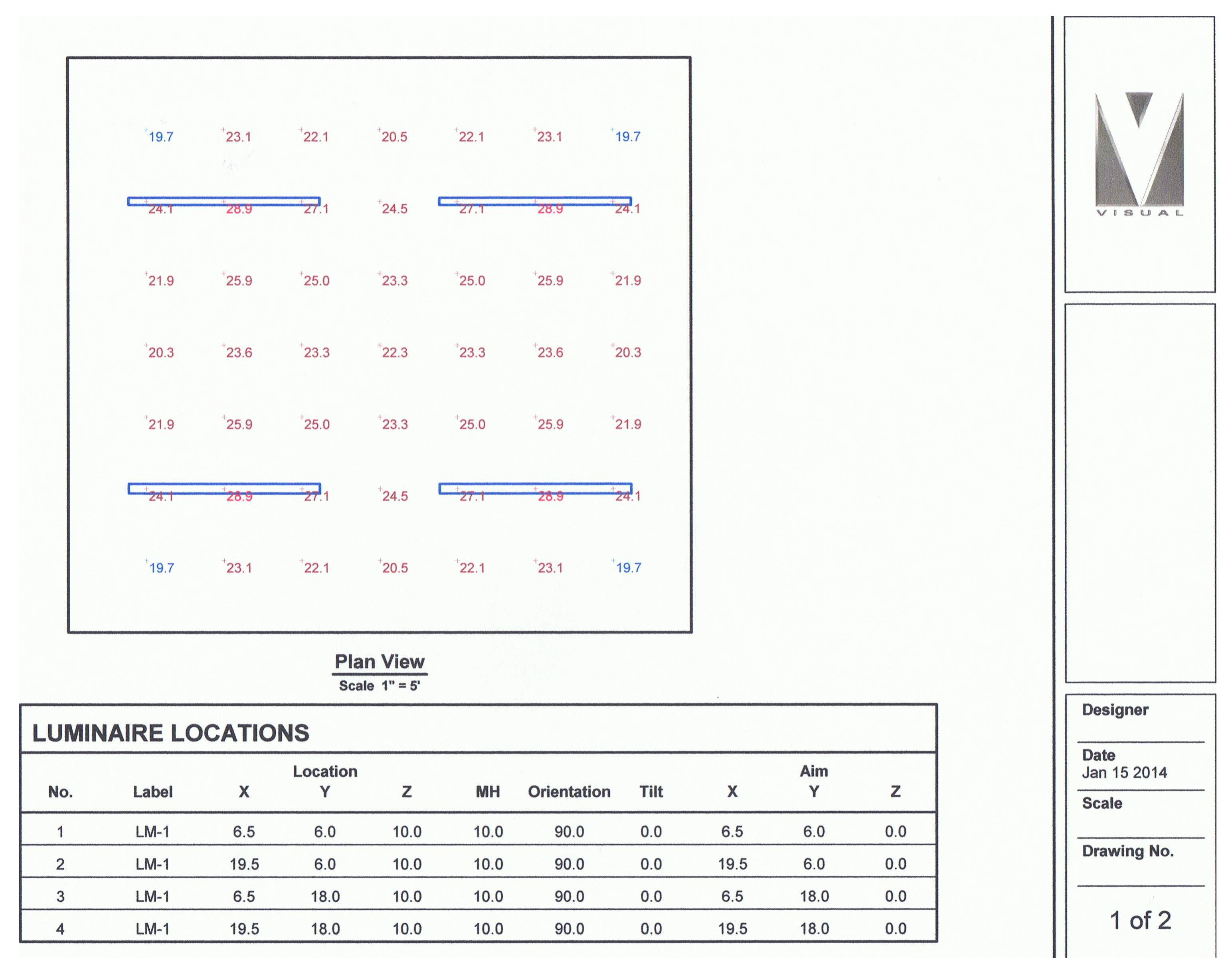

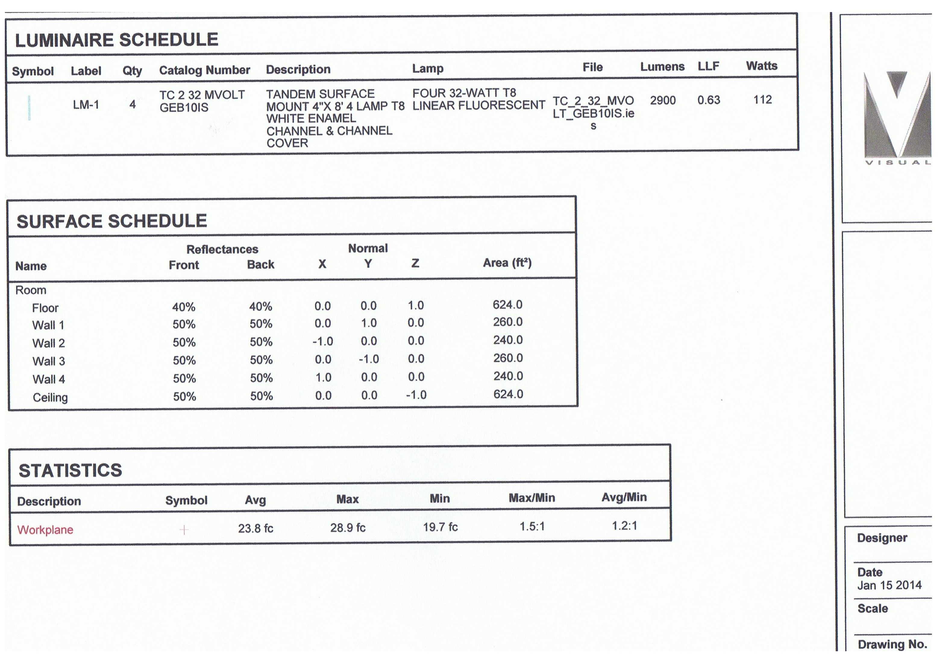

actually have a lighting software program on my comp0uter provided from Lithonia. The only problem is that it gives output in lumens. its something i use in commercial jobs where they specify the amount of lumens they require as a minimum.
depending on how much light you need, i would personally installl 4 four) T8 fixtures, 8 foot long with 4 - 32 watt lamps per fixture.
I have scanned 3 pages as the program picked for your building. The fixture spacing is shown, and its explaned on page 3 (lumens method study)
Hope this helps
View attachment Visual - Lumen Method Summary.pdf
