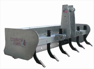

Wanted to ask 230 owners and everybody else(so chime in) what size BoxBlade they are running and why I was looking for a 5.5 for the 230 but they are harder to come by and figured I would go up to the 6' footer just because I want to cover my tracks. The ones I am looking at are by Modern they are galvanized one is what they call the Standard it comes in at about 580lbs (1/4" sides) and the other is Contractor at 835(3/8" sides)with a hinged back BOTH have hydrualic rippers. Now can a 230 do good with a six foot BB I saw Bobcat says there Heavyduty one is listed for 230 in the 6' size I just really do not want to do this tractor in. I was going to post this in attachments but really wanted to hear from the BobCatCrew Thanks for your input
I am also thinking of adding this Top&Tilt so everything will be done by seat except angle

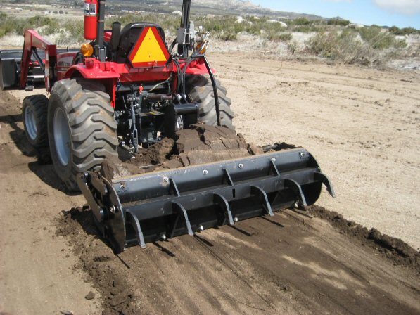

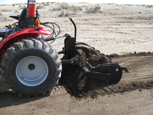

My gut feeling is that a 6' heavy duty box is just too much for your size of tractor, especially when using the rippers. That's not to say that you could not get by with a 6', just that it would be a job to use it. Do you have any hills that you will be working on, or just flat land? If it is just flat, then you could probably get by with the 6 footer. My feeling is that you should be able to pull a full box up the steepest hill that you would ever be working on. If not, the the box is to big in my opinion. I have a Mahindra 3215HST. Right about the same size & HP tractor as the CT225-230-235. I have it to where it weighs right about 5000lbs. I have a heavy duty roll over box blade that is 66" wide. I can pull a full load as in the picture up hill in mid range. I doubt that I would be able to pull a 6 footer with that type of a load.

Thanks guys for your input on this MtnViewRanch I do have a decent hill I live on so yes I thought I might tax tractor too much with the 6' thats why I was posting the question esspecially to the CT230 owners just because of the weight difference of the tractor to other brands on some its about 1k Lbs more dont know if that makes a difference but thought it might. I do not know too much bout the boxblade thats kinda new to me

Out of these and with a 230 and knowing what I have to do tear up a nonexistant driveway regrade to plant grass build a new driveway grade it and then rock it all on a incline of say 8' to 1' incline give or take this is not a time job either doesnt matter how long I have to work it just that it comes out nice and right does that help at all in deciding? :confused2:this is how I feel just eyeballs are going in opposite direction

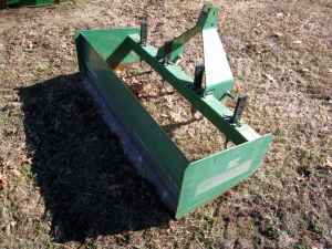

The 1st&2nd one looks kinda like this one with the lever actuated scarifers ?stervis?$800 and other not sure of brand $600 but not refinished 3rd pic is of the Hyd. Land $1100 4th pic is Cammond $375 5th is link to auction nearby here friday of Frontier that sold at $375+buyers+Tax so $430

Well, you have a pretty good choice there.:thumbsup: Based on what you have said, this is what I would do.
I would get #8, clean it up and paint it. Maybe change out the lever on the rippers for a hydraulic later down the road.
If money is tight, then I would buy the Cammond.
I would double check about the loading of the tires. I do not believe that it will affect your warranty at all. In fact I am guessing that there is something in the owners manual telling you how to do it. I know that both of my Mahindra owners manuals address filling the tires. It literally is day and night difference with how well the tractor performs both with the loader and 3pt dirt working implements.
DO NOT GET A LIGHT WEIGHT BOX! It will not perform for you with what you want to do.
Good luck with your decision.
/ Need guidance on BB for CT230 #20
If #8 is like the yellow one in your pictures and 5.5', I think that would be the clear winner.
