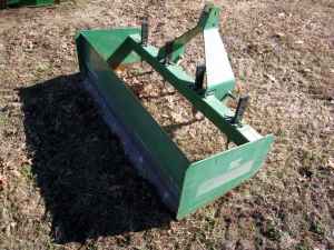

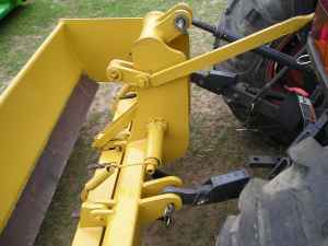

Its kinda like the one in pic I posted earlier but the scarifer bar (I guess thats what you call) it is round and latches with lever when you pull lever it rotates so scarifer teeth drop down and locks in place at same postion as reg box blade then another lever you step on releases it so if you move foward the scarifer teeth rotate back in the up position and lock that way till you pull lever again dont know how else to explain it? Do not think it can be adapted to Hyd since it rolls it is old but sturdy I say somewhere around 800lbs+ ballpark maybe more compared to weight of what I am finding on the new ones. Based on the pics what would you guys put weight at?
Here I found 2 more like it just the one here that I saw is older and little more worn. Sorry shouldve looked more before posting the other pic found these in a posting on C.L Pic1-3 figure about $175gas at almost half the price and one on Fastline Pic4 no price but figure $75gas
Thank you again
Edit:I did look up Howse their website says theirs comes in at
510 lbs. BB66 5 1/2' Hinged Back Box Blade is it the sides?
Canada_CT230 mentioned earlier his BC boxblade comes in at 436 lbs his is a
5'. I dont know what weight should I be looking at have for what Im going to do thats sustainable

Besides that those are 60" units, the first 3 pics look to be of a decent old BB. I would guess 650-750lbs without actually seeing it in person. What is the price on it? If you can get it cheap enough ($350-$400?) with the cost of the fuel to get it, it may be worth it. But I still like that yellow one (#8) if it is 66" wide. Even with the higher cost, it is one nice BB.

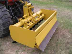

milkman636 MtnViewRanch the #8 from list I listed earlier in post#15 Disregard/Scratch those earlier pics in post #15 those are not it. It looks like the pics I just posted in Post#23 1-3&4 and again now pic1 .
The one at local yard for $800 I do not have the actual pic of it and Do not think Hyd can be added Later because it rolls the scarifers does not lower scarifers as seen in pic#1
About the Howse I went looking and found this on site BB66. Howse says their BB66 5 1/2' Hinged Back Box Blade weighs 510lbs.
Heres a pic #2 from another site of 5' that looks just like the one I saw last night. Sides for toplink are dont know guage? Cutting edge blade not sure if straight or curved website does not say.

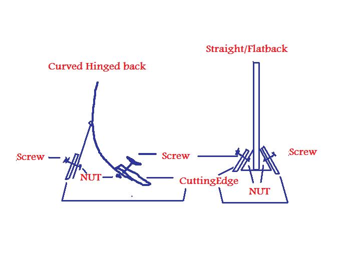

That one is asking $475 + the gas He is listing it as a 66" but does look like it is 66" if you say 1' spacing between each scarifer plus the space to side I know it has a 60 printed on back but think its right. Sorry I shouldnt of posted that pic when I made list I just wanted to give a general idea of what it looked like #8 from list looks more like the picks I just posted
If it is actually 66", then that is a good price other than the time to drive there. See if you can get him to take a picture with a tape measure pulled tight on it. Why would 60 be on the tail end? I hate to see you drive all that way and it is only a 5 footer. I know that once I drove 3 1/2 hours to get a 12" and 30" back hoe bucket for our Case 580E. Got there, had to wait for the guy to show up and when we got into his lot, I asked him where the buckets were, he said right there as he pointed to a 24" and 18" bucket. I said that those were not what he said that he had, he asked if I could use those instead. I told him I didn't need those sizes, that I already had those sizes. He blamed it on his son, that he told him the wrong size, didn't much matter, they weren't going to do me any good. Point of the story, be sure ahead of time that it is the right width before you drive all that way. Fuel ain't cheap anymore.

MtnViewRanch thanks for not giving up Did you look at pic#3 in post 25 I added up on the pic to illistrate that I think it is a 66" I will contact him to see if I can do that with the tape measure pic Good Idea. You posted while I was writing my other thoughts I have been working on it since your other post I just don't type fast I only really can use a 2 of my fingers on one hand and one is my thumb so I am always going back to fix my typing think that did not help in expressing my thoughts and screwed up this thread.

Well, mine is curved in the cutting edge. I was told that a straight cutting edge is not as efficient.
