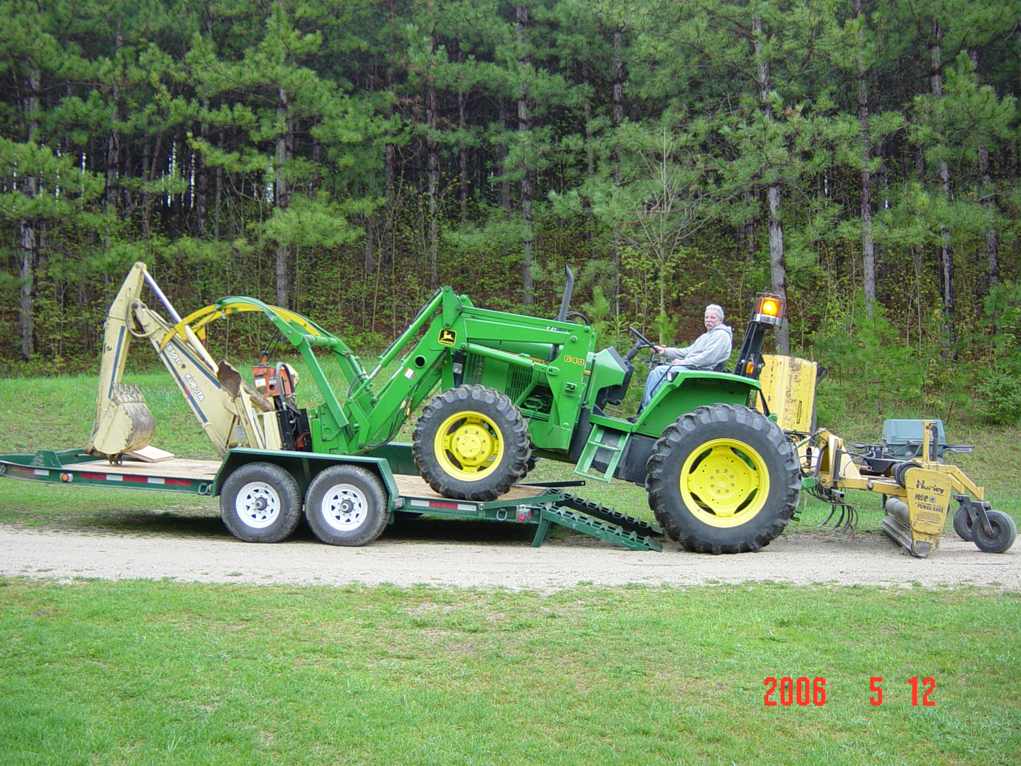

It's not really a very good picture. The backhoe is being moved by the JD forks. But I got this (old style) bale grapple thrown in when we bought our JD 6200. I mounted it to a fork carrier and use it to move brush. It will carry way more than a normal grapple.
It's also great for loading up with branches that have been cut off. Every now and then you compact the load to pile more on. You don't lose one on the way to the pile, and just dump it.

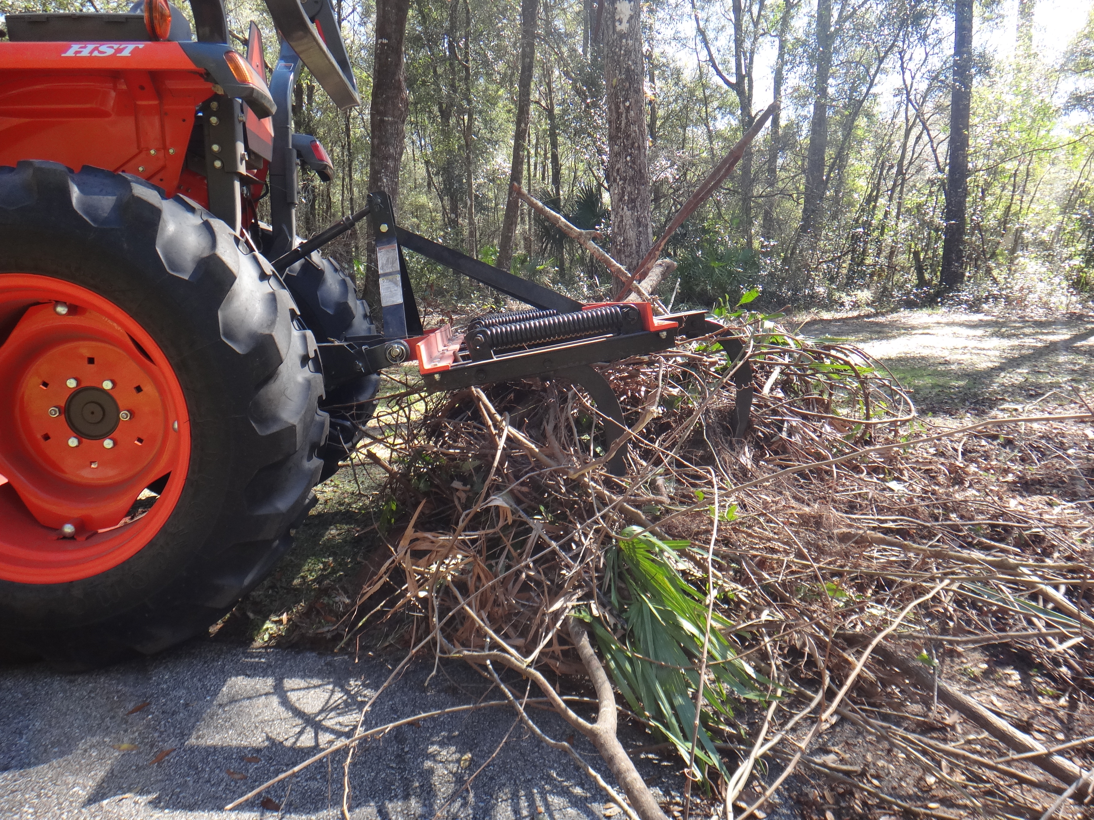

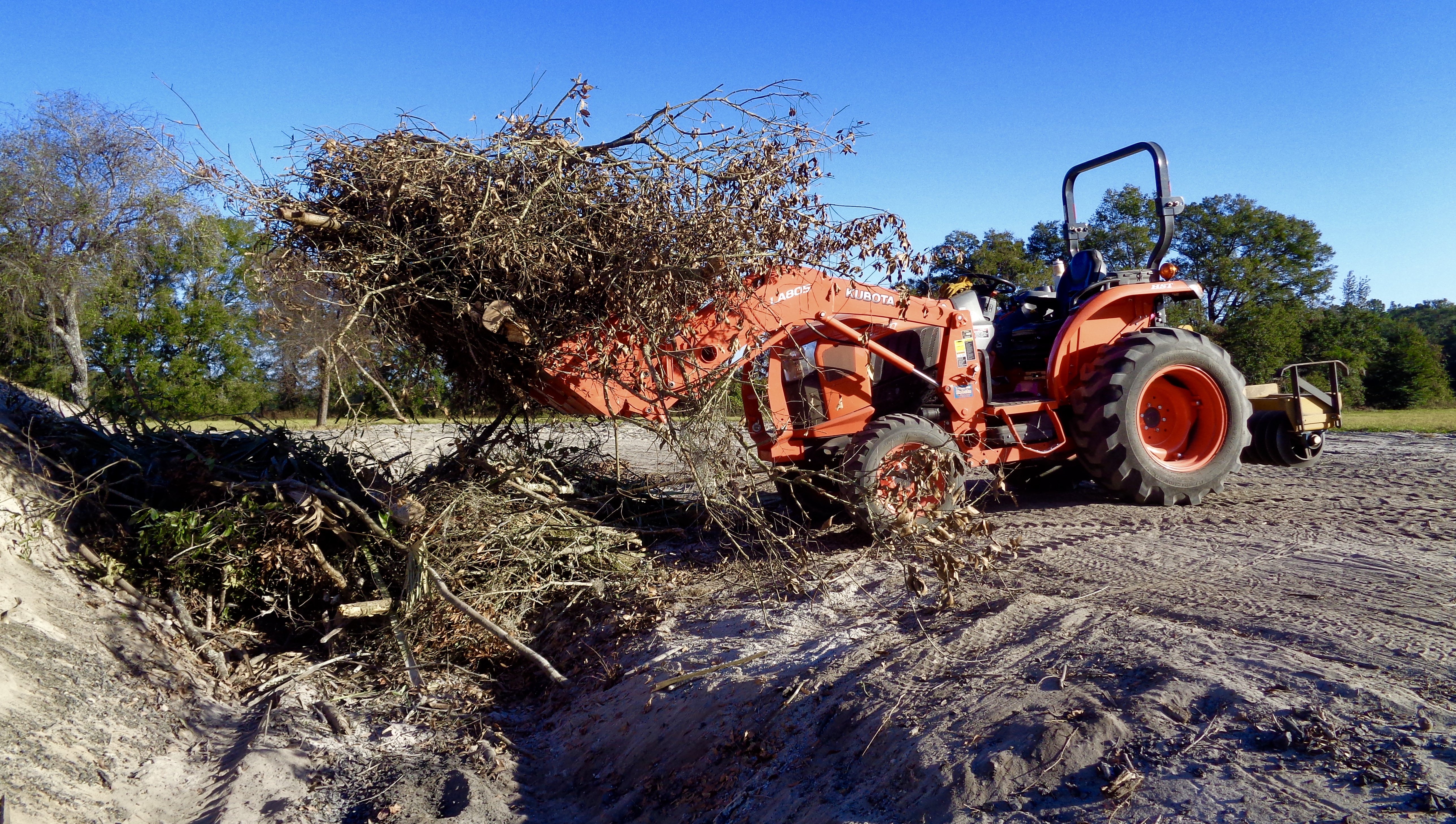

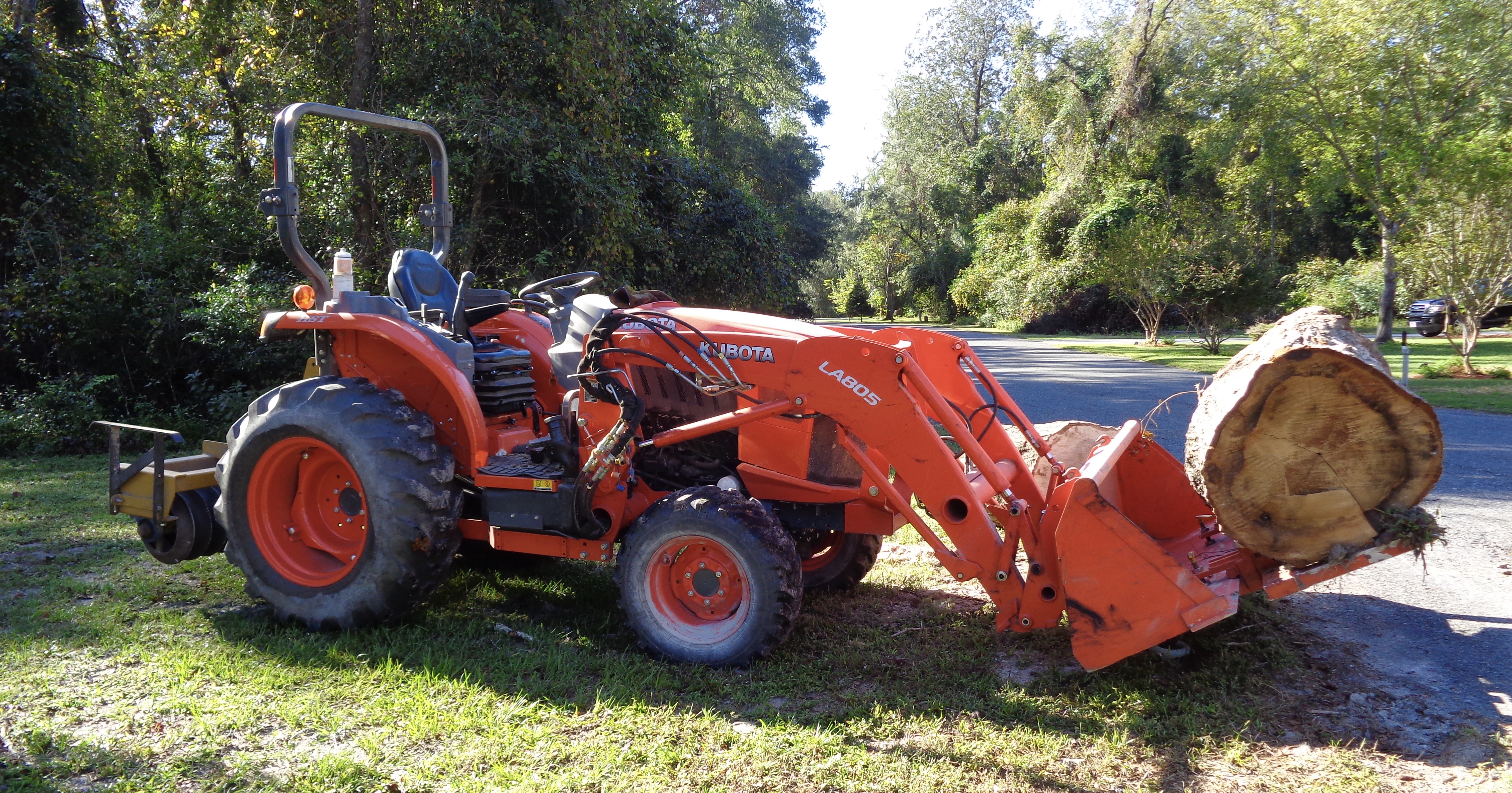

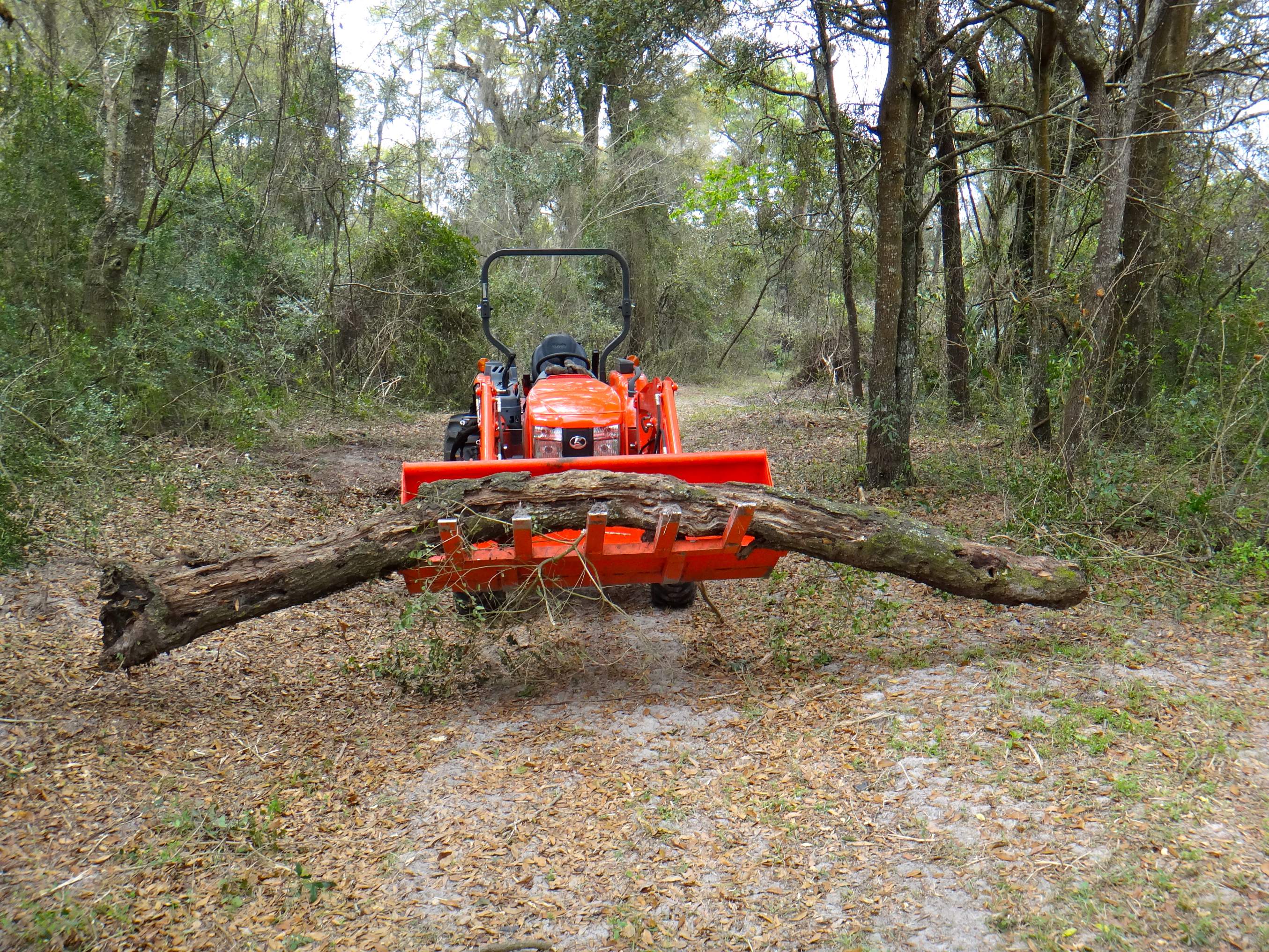

I have Hayne's Clamp-On Aluminum Debris Forks. An excellent product however light brush tends to run away from the blunt fork tips rather than load, unless debris is backstopped by a tree. Forks lift more dirt than I like sliding under brush piles.
Debris Forks pick up up heavier debris with greater inertia, fine.
While I have not used Bucket Solution's UltraFork, I would give this attachment consideration. I think UltraForks would slide under brush piles and pick them up with a minimum of dirt.
(I have a Bucket Spade from Bucket Solutions, fabrication is excellent.)
LINKS (2) : Multi-Spear Ultra Fork
multi-spear ultra fork - Google Search

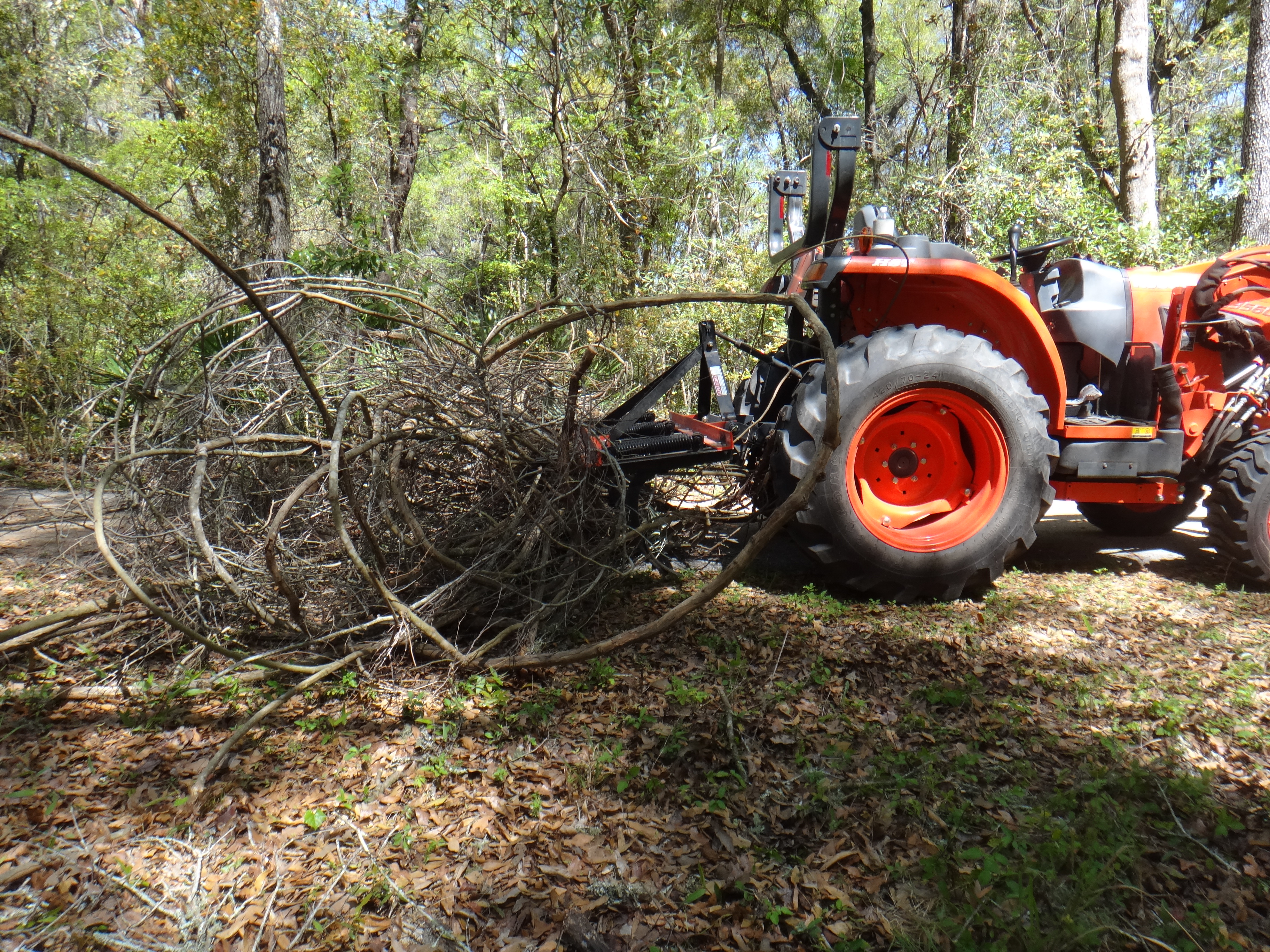

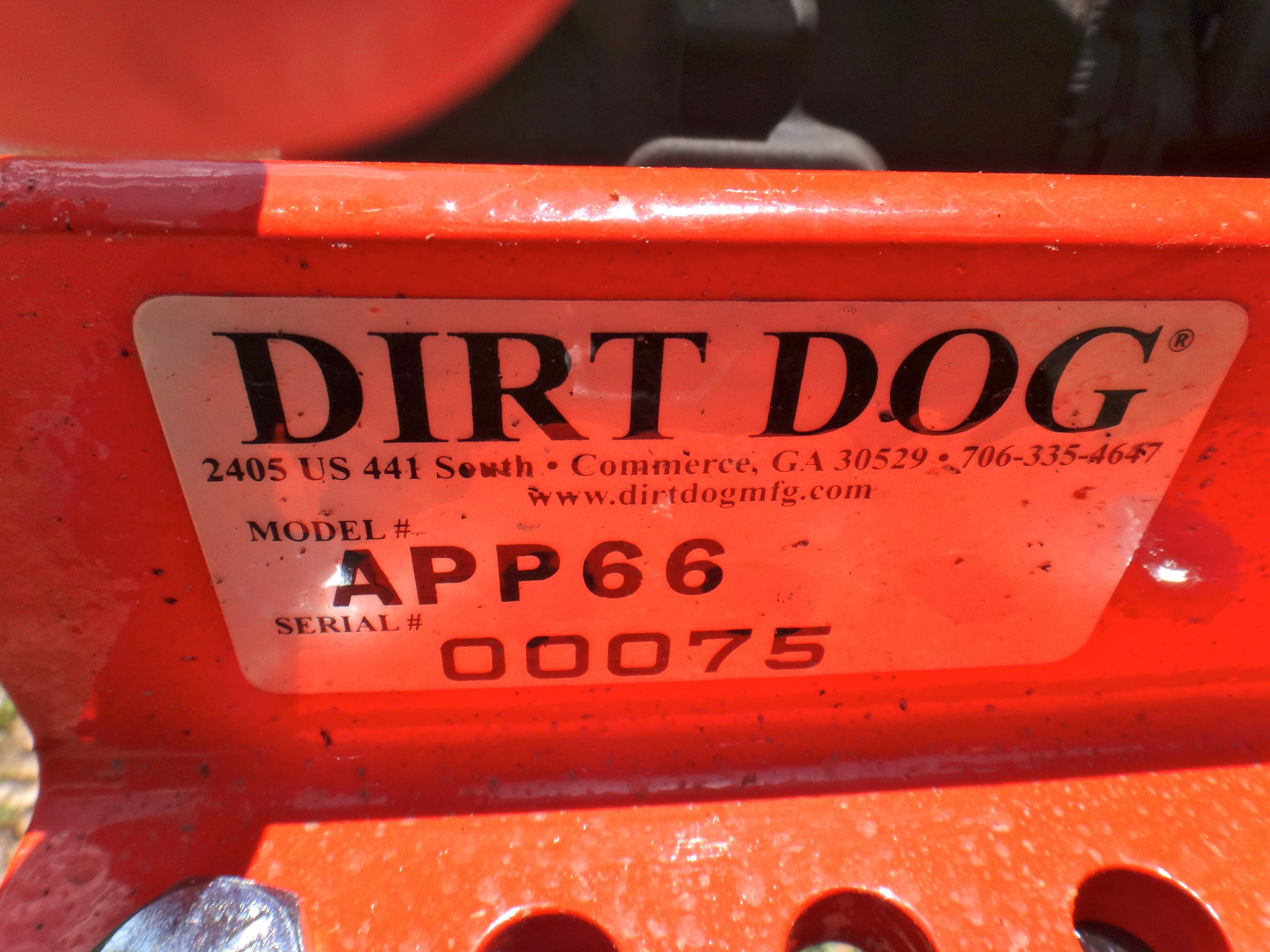

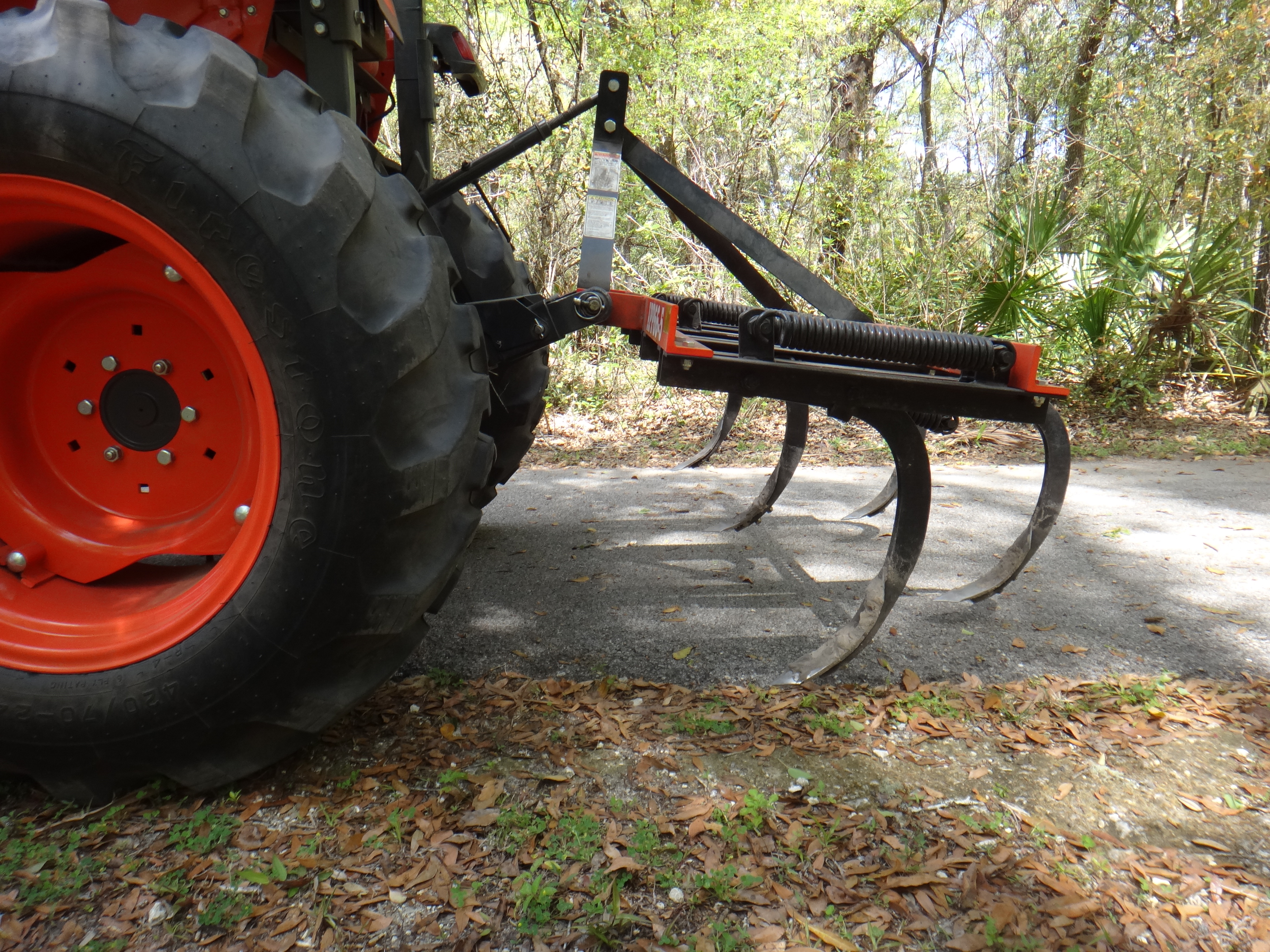

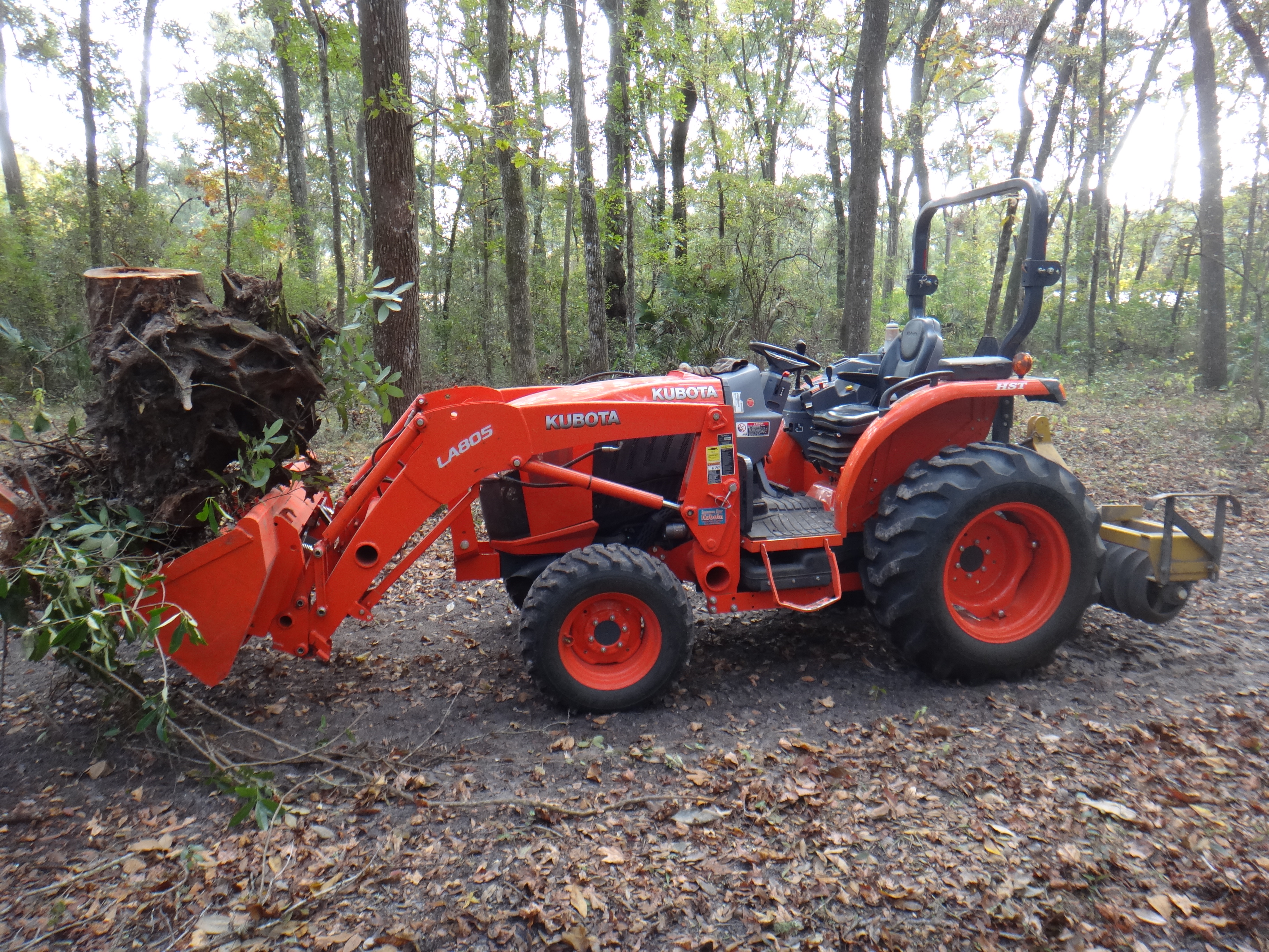

If you only want to transport brush and vines, not tree sections, a Field Cultivator will hook and tow debris piles with barely any debris loss and hardly any dirt. I often work with Ratchet Rake on the FEL bucket and Field Cultivator mounted on the Three Point Hitch. Field Cultivator is about the same price as quality Debris Forks, around $800.
(Five tractor horsepower required for each Field Cultivator tine.)
LINK: http://www.tractorbynet.com/forums/attachments/339095-dirt-dog-all-purpose-plow.html?highlight=

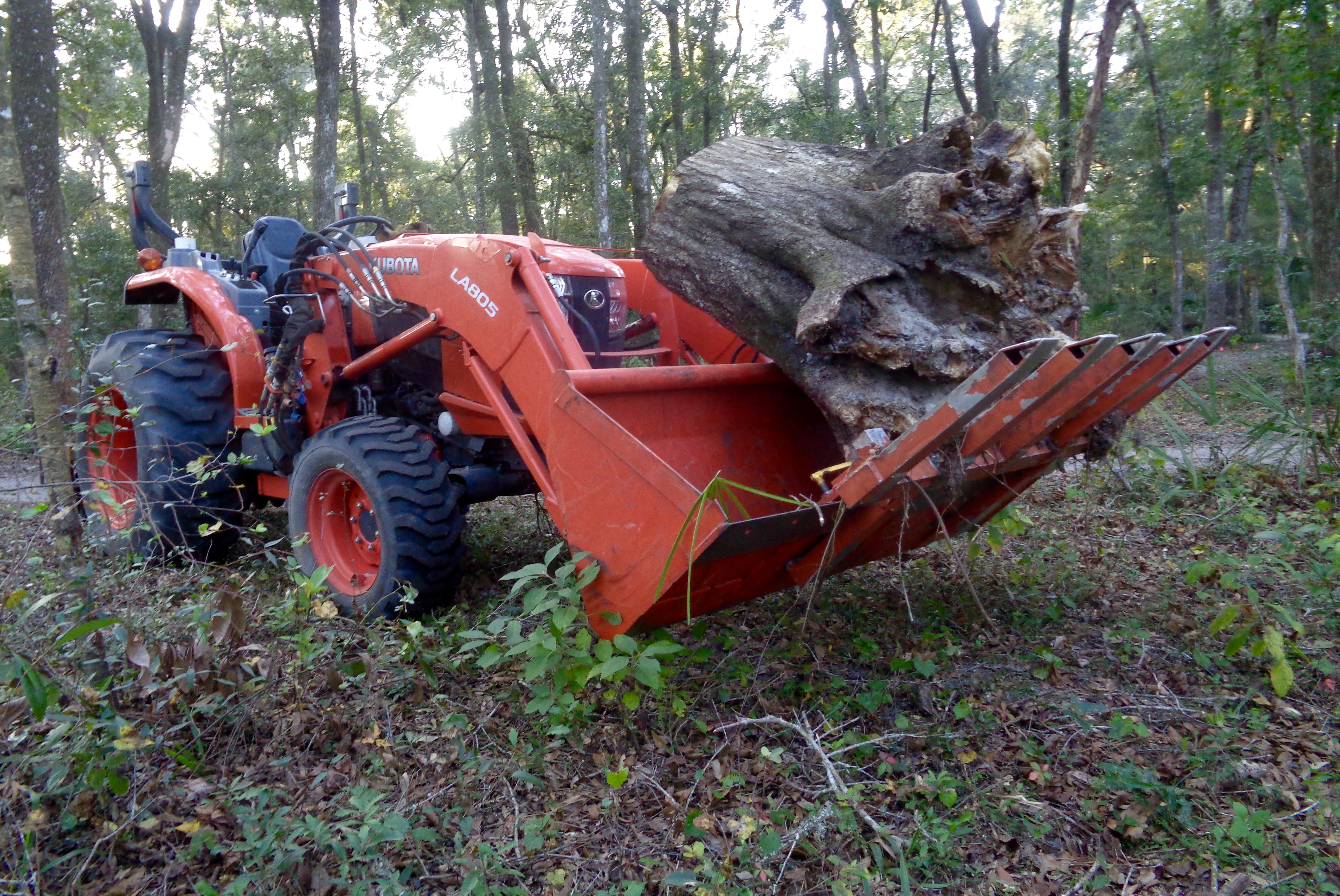

I like that you can buy Worksaver Forks with SSQA and John Deer QA to the FEL. You improve visibility of debris piles and increase payload capacity a bit by eliminating the bucket.
However, I like the design of Bucket Solutions' Ultra Forks a little better. Ultra Forks seem a little beefier (170 pounds/60" vs. 146 pounds/60") and individual tines unscrew so you can vary spacing or replace one easily. Varying the tine spacing allows carrying verdure with less dirt included.
See Post #7.
Manure Forks from Worksaver
/ Need attachment advice for moving brush piles #20
What do you think of Titan debris forks? The 60 are $260. Seems like a good price. Only thing that concerns me is the forks are only 21 long.

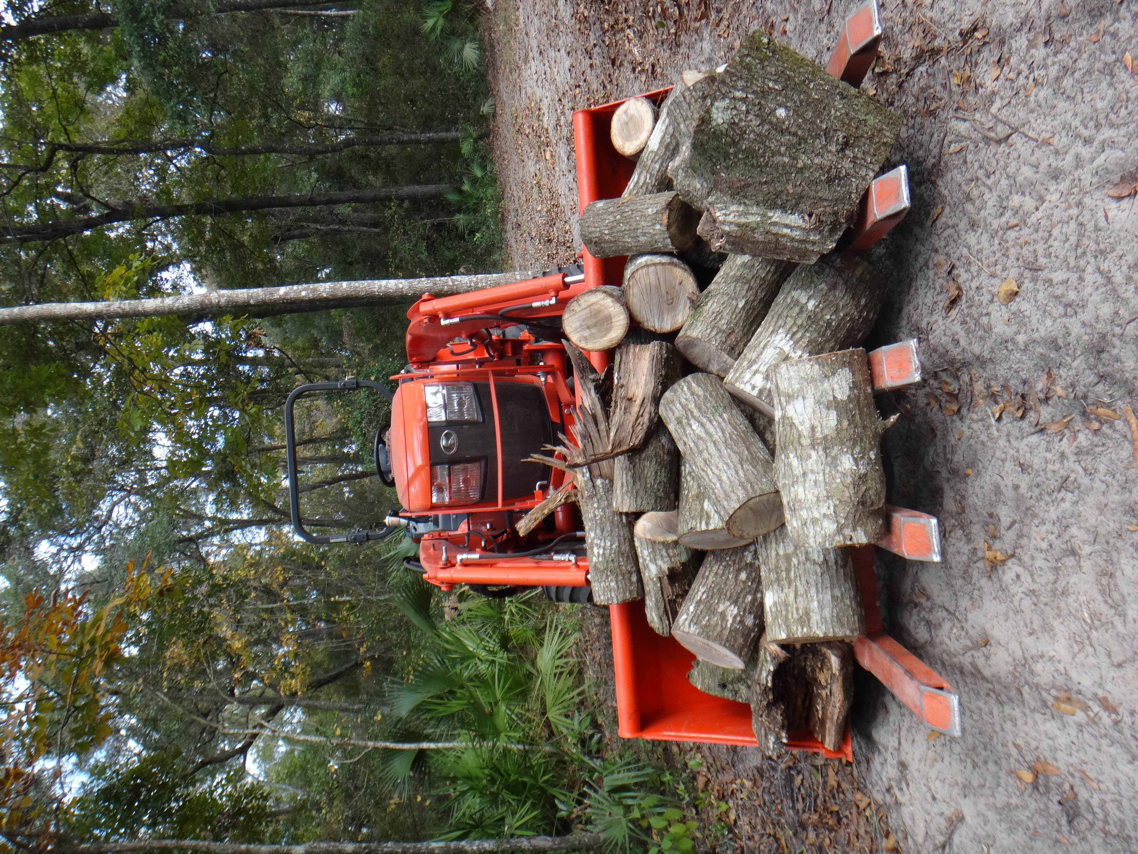

The tines on my Hayne's aluminum debris forks are 19" long; five fork tines spaced over 54" width, outside to outside. I have never wanted more depth.
See Post #7.
Several respondents suggest some pallet fork tasks are best handled with two pairs of pallet forks.
I use 600 or 850 pounds of Three Point Hitch mounted counterbalance when lifting and transporting verdure with my debris forks on my L3560 with LA805 loader, about 1,700 pounds lift capacity.
Kubota B3300SU in photos.
