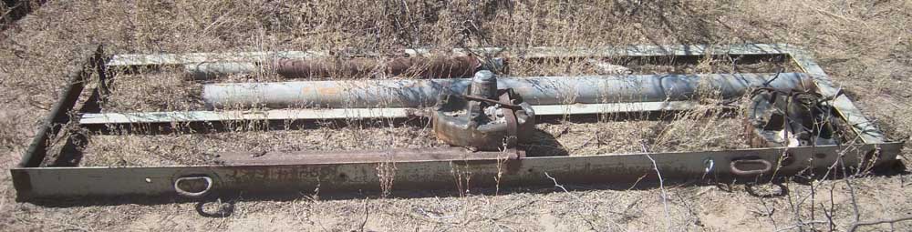

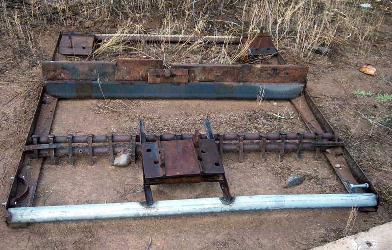

I made a drag for our paddock last week. Like you I didn't want to buy new steel, found the 4x4 square stock and angle iron in the junk bin of local welding shop, along with enough 1/8th inch plate for this and another project, cost $30. Only other cost was $5 for the two lift pins and about 25% of a 2 lb spool of .035 wire (mig).
I used a 4x6 inch I beam found in the woods, someone else had welded the gator blade to it. I welded the hardened steel pins on for my use but it's possible you'd just need the blade welded on, which you can usually get from the dept of highways pretty reasonably (free in my neck of the woods normally).
It is quite heavy, and with the blade welded on to cut into the crest of your roads I think it might serve you well. Yes, there are actual attachments you can buy that will probably do a much better job in a lot less time, but what's the hurry to get out of the woods..............

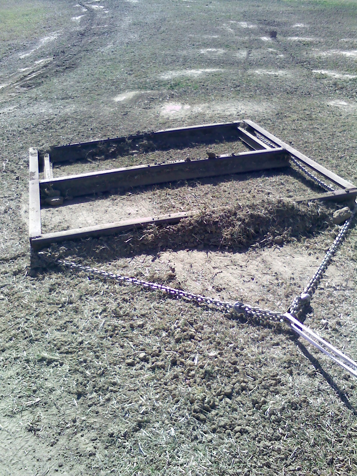

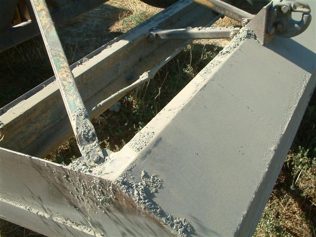

Hi Jeff,
I am using mine today. It is made from old Railway Track. Work well.
Cheers Zac

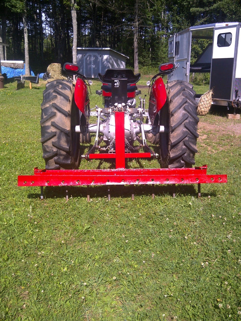

Here are pictures of the 2 drags that I have built and use.
The big one is 8' across, the smaller is about 5' wide. The small one also has teeth that dig down about 4 inches, Helps loosen the soil.
A drag pulled at an angle will move dirt to either the side or center of the road. After dragging the road should be rolled.

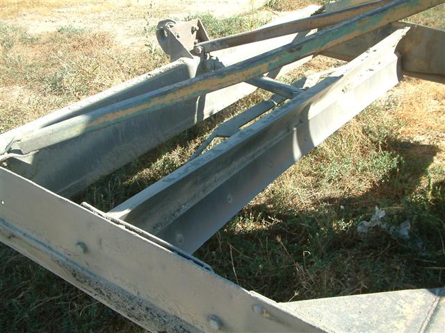

I made this from my scrap pile. I used two old grader blades. I shape the road a couple of times a year with my back blade to get/keep the crown the way I want it, then I use this drag about once a month to keep the road smooth.
The drag goes a lot faster than back blading it, and keeps the road nice. One thing I would do over if I was to rebuild is to make it about a foot wider and much heavier.

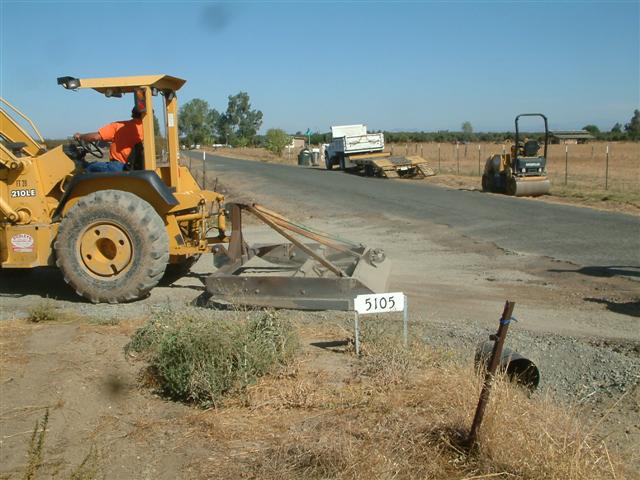

I'd build a float like this one that my contractor used to grade my gravel driveway when it was installed a few years ago.
DSCF0078 (Small).JPGDSCF0079 (Small).JPGDSCF0081 (Small).JPGDSCF0082 (Small).JPG
Good luck
brucewj: The drag you built is almost exactly what I envision for my needs. Where I will make a change is at the front blade. I will flip it end for end and weld it to the bottom of the sides so that the cutting edge will shave the high points but not dig aggressively. Other than the sides being heavier channel than yours, mine will be almost a copy. Also, instead of using a top link I plan to have a length of chain there. That way the drag will be self balancing while in use.
