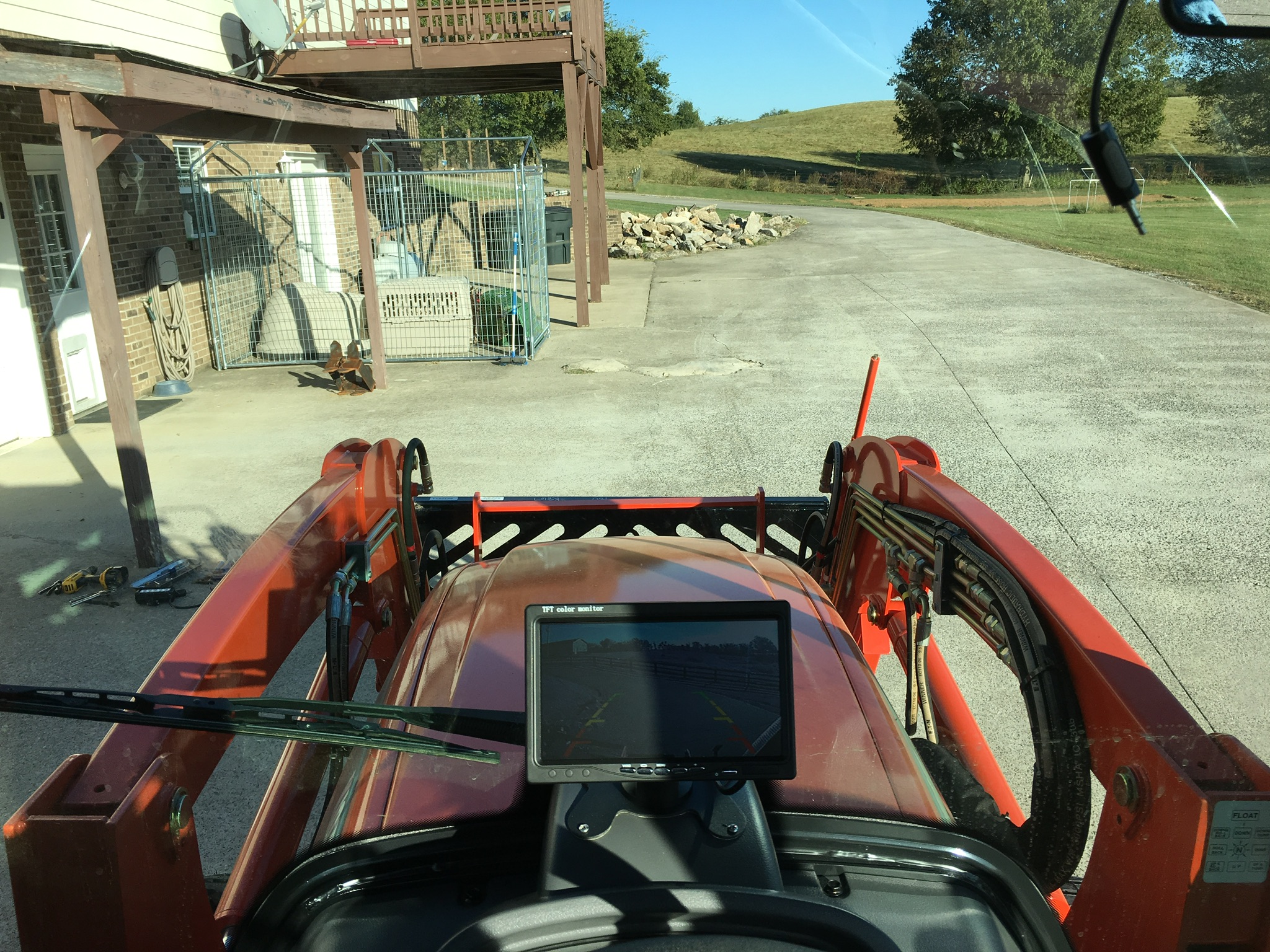

Not much happening on the tractor front. Attached the pallet forks and moved a pallet of wood up to the house. First use of the new camera/monitor set up; I didn't have a very good angle of view- need to work on, probably opt for increasing cable length and doing temporary camera mounts (use magnetic base).
Showed the wife why all the fuss with this camera stuff. Having her sit behind the wheel allowed her to "get it."

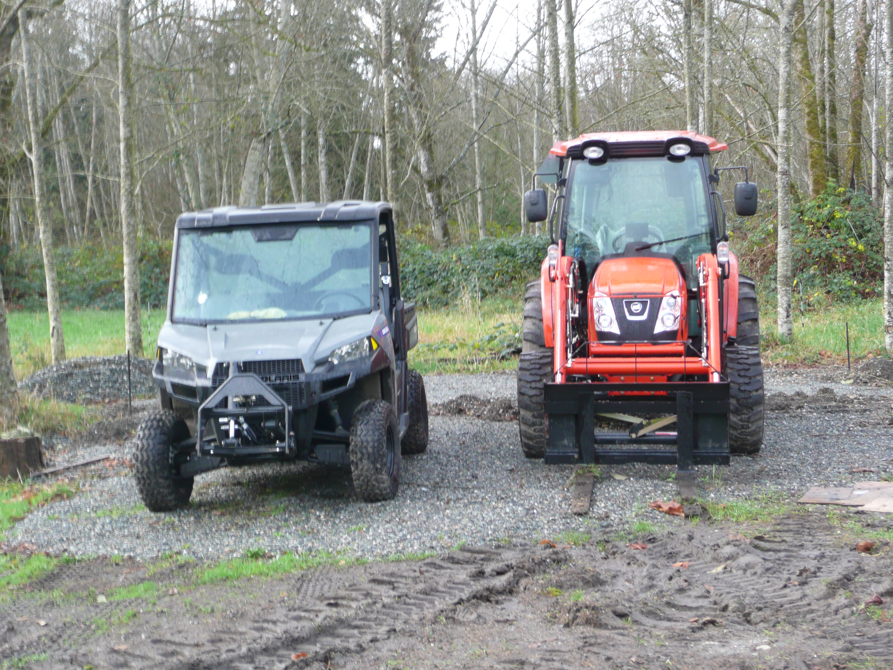

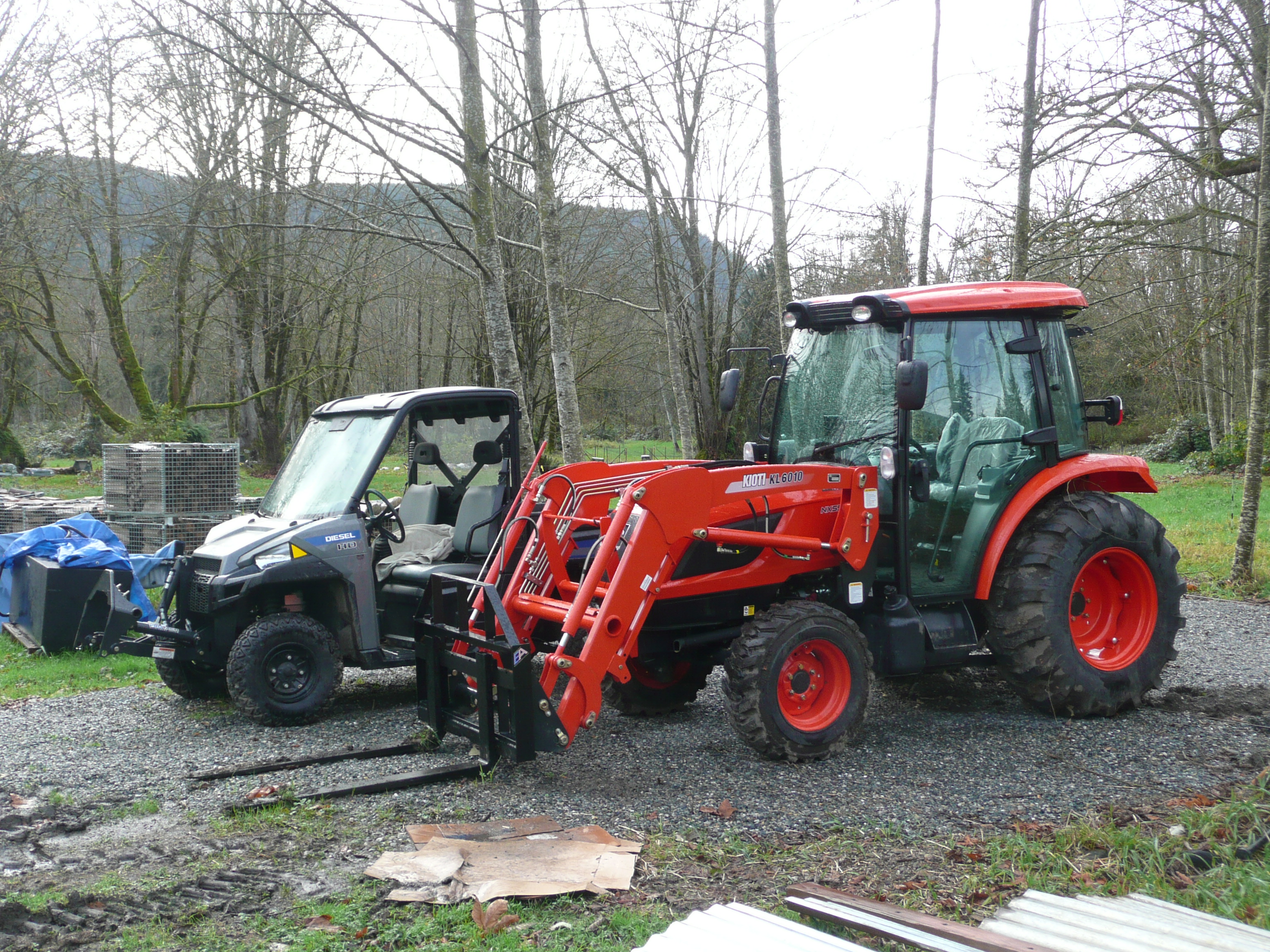

Tractor and Polaris are currently parked side by side and I thought I'd grab some pictures of them after noticing how much smaller the front profile of the tractor is with the bucket off (had the pallet forks on).
For some reason I thought I'd bought a bigger tractor.
Oh! Now I see it!
Does this Polaris make my rear look big? :laughing:

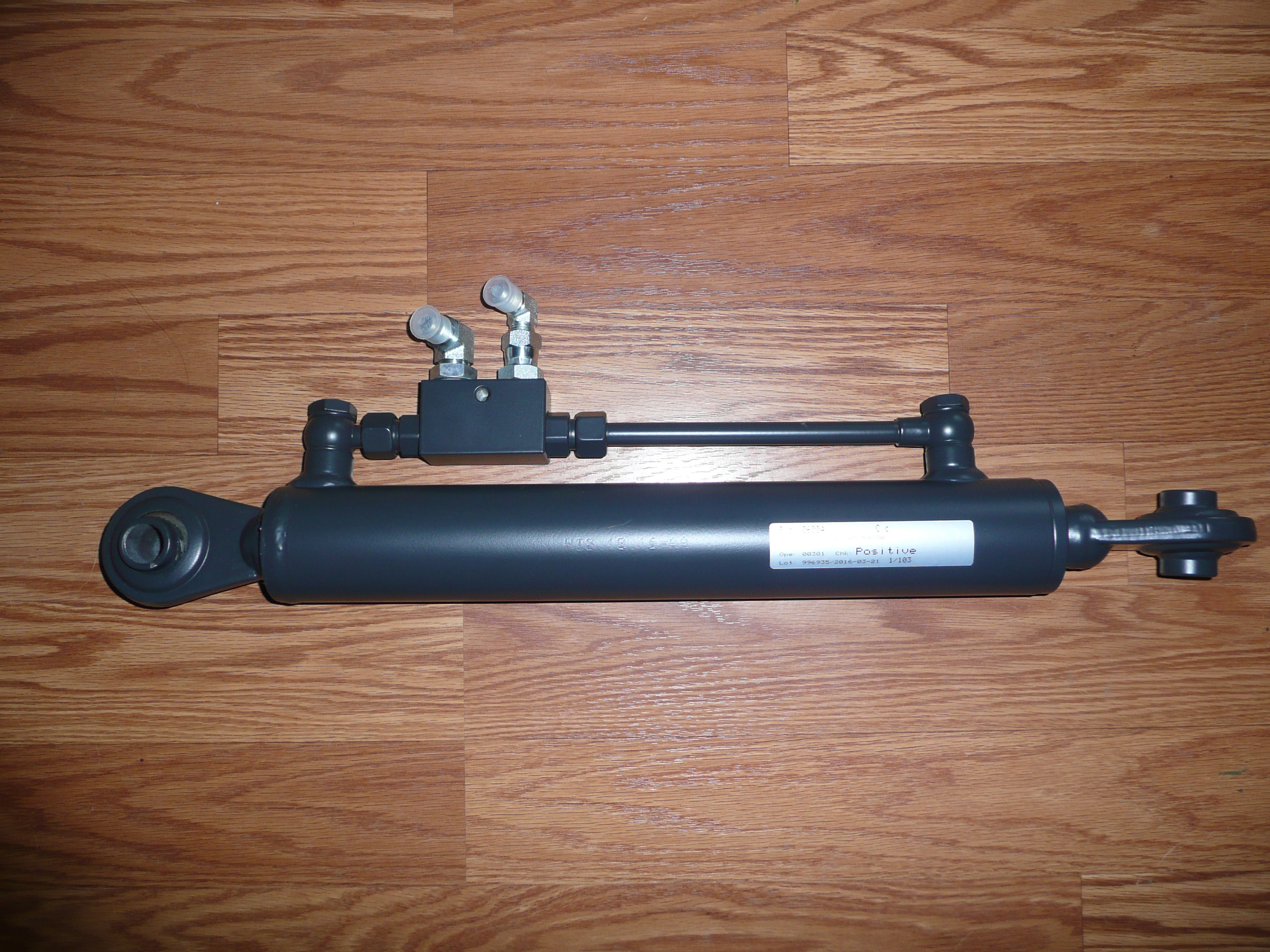

Got my hydraulics order. I'm undecided whether to use protective sleeving or not. My hoses are extra abrasion resistant: 3/8" HYDRAULAX TOUGH Hose Assembly
The fittings for the rear top link appear to fit the bill (others just stuck up/out too far):

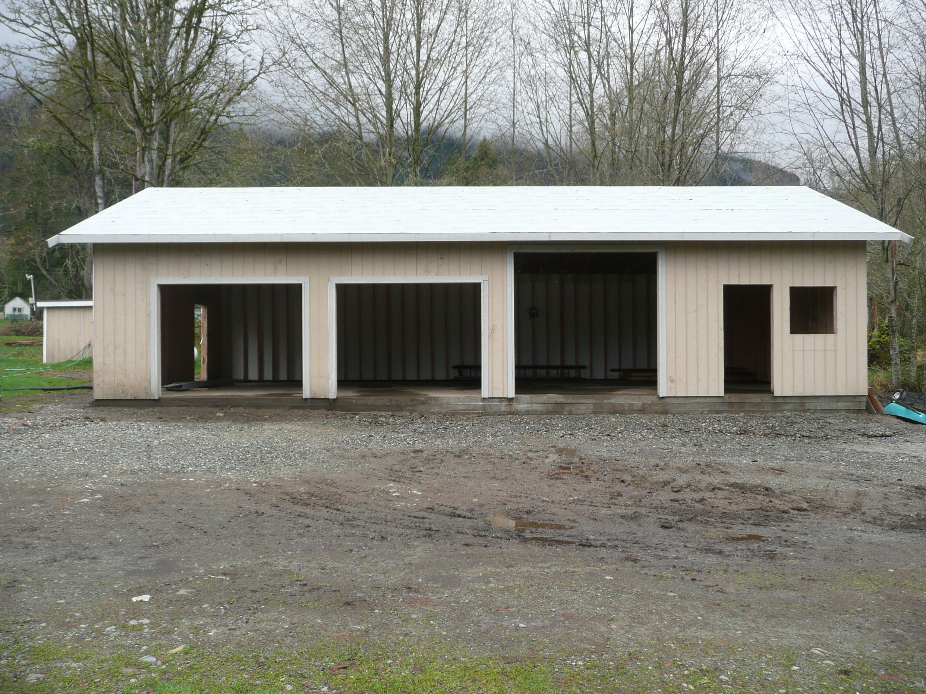

Meanwhile my garage is coming along (slowly). Will have a LOT of grading work to do (going to have to wait until colder weather sets in, which means LESS RAIN!). Hope I don't forget which bay to drive the tractor in to:laughing:

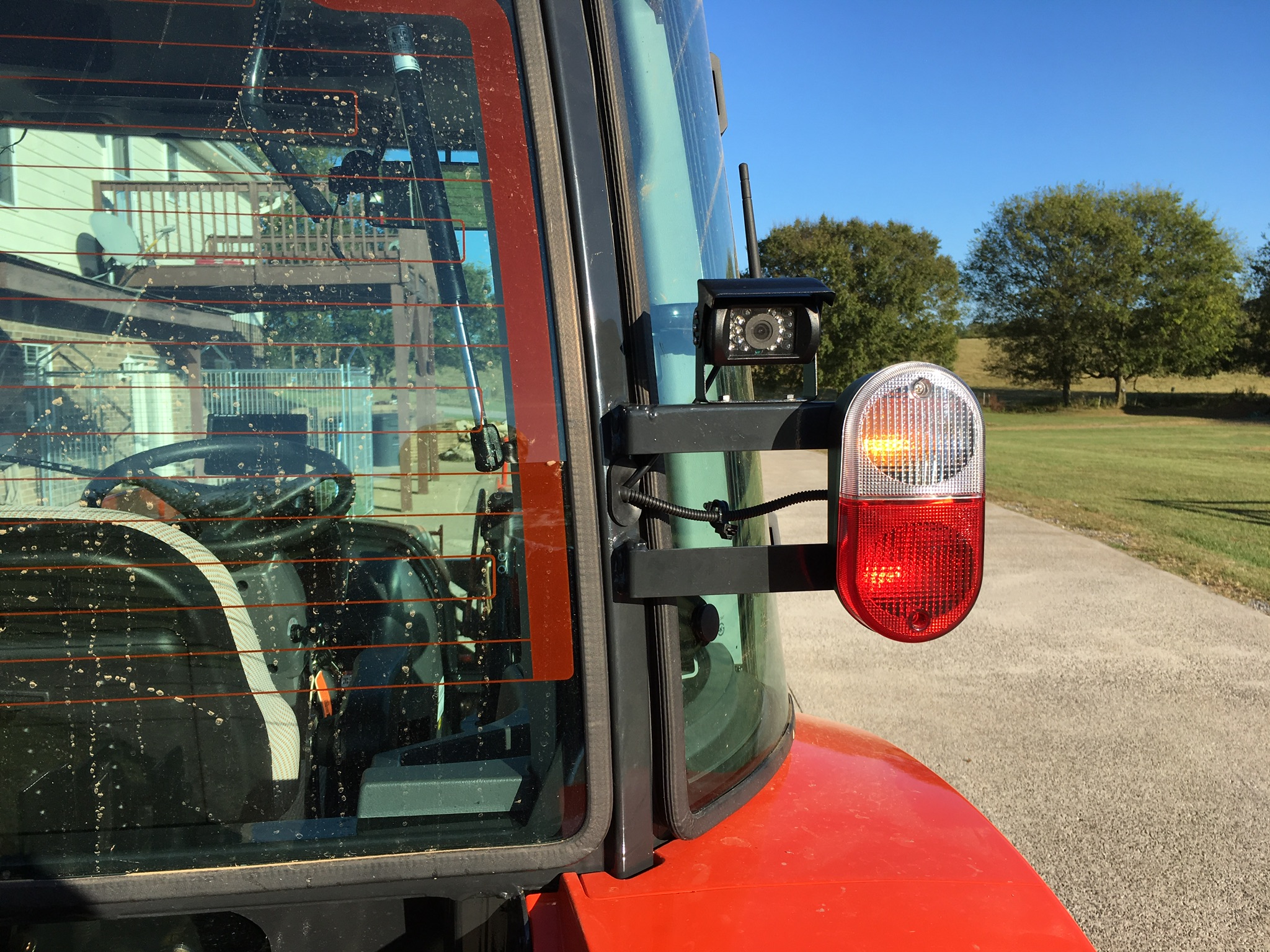

Hope that your dealer is a better than mine. When I went to wire the rear camera on my tractor I found that the cab top got sealed up with RTV. I contacted my dealer about this and after explaining that it's going to be a pain in my behind should I ever need to pop the top off in the future (speakers, or maybe for a stereo install), I never heard back. At least my cab is staying dry: if it wasn't then they'd be facing having to deal with the RTV!
Did order a nice magnet base for attaching a front camera to. Also got a longer power cord (already had extra video cord). Looking forward to being able to place the camera right up next to the action for my next pallet fork activities.

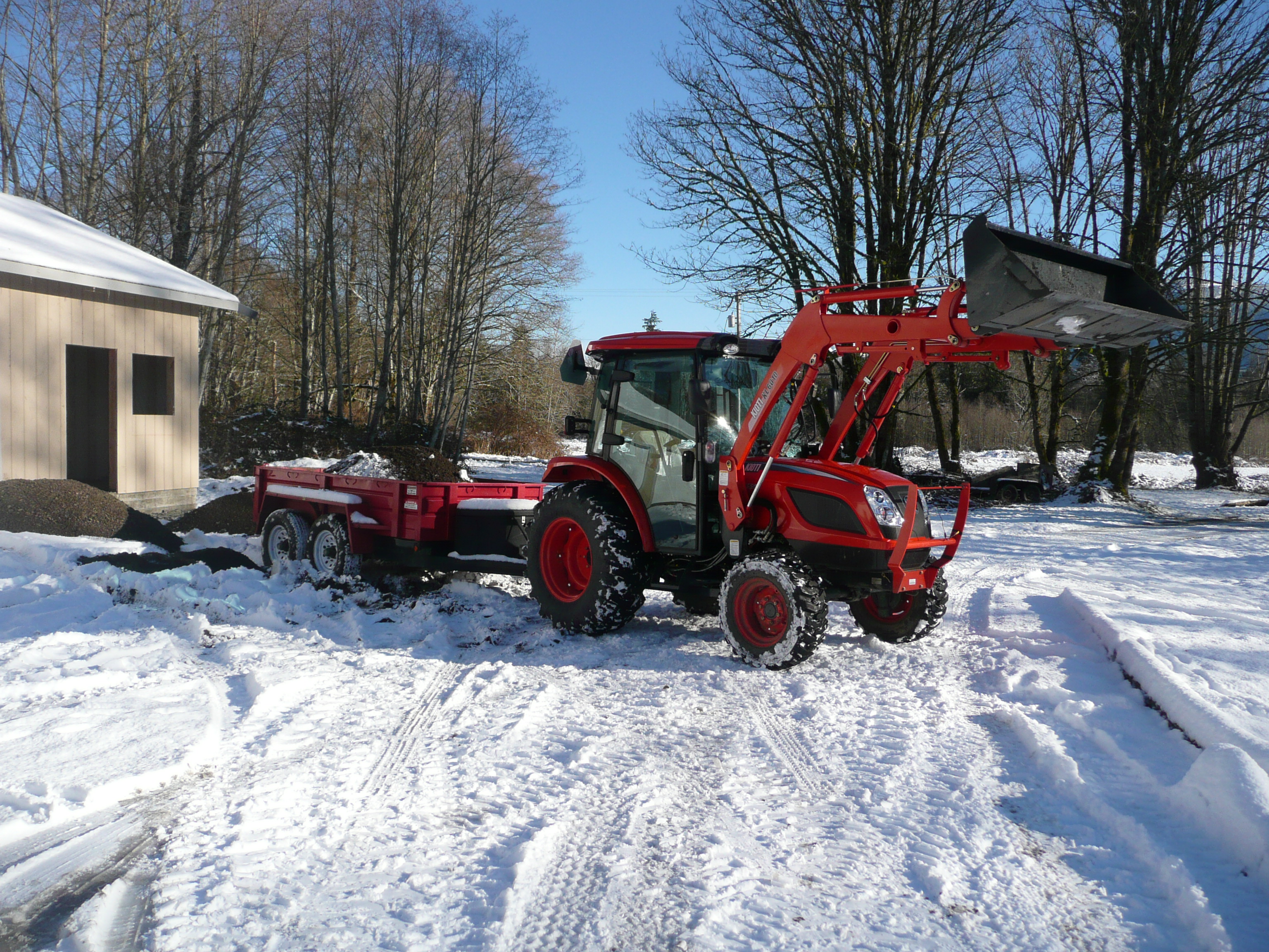

Finally! Tractor time:D
Installed a ball on draw bar. Have run about 5 loads so far. Seems to be working out real well. Only issue so far is that frozen material is sticking to the dump trailer and I have to do a lot of prodding with a shovel to get it out (and the dump trailer has a pretty extreme dump angle!). Now have 13 hours on the tractor!

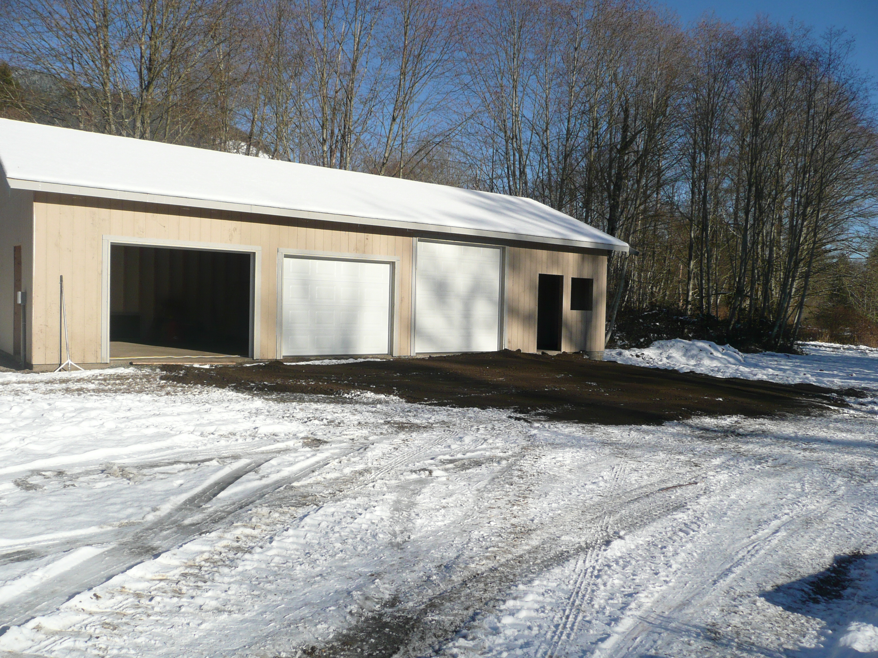

I've hauled and graded 30+ yds of material (not including about 2 yds of leftover 5/8" minus from the site prep) for the garage. Here's what it looked like (with only those couple of yds of 5/8" down in front of the first bay):
Here's how it's shaping up (I will let it settle and pack for now):

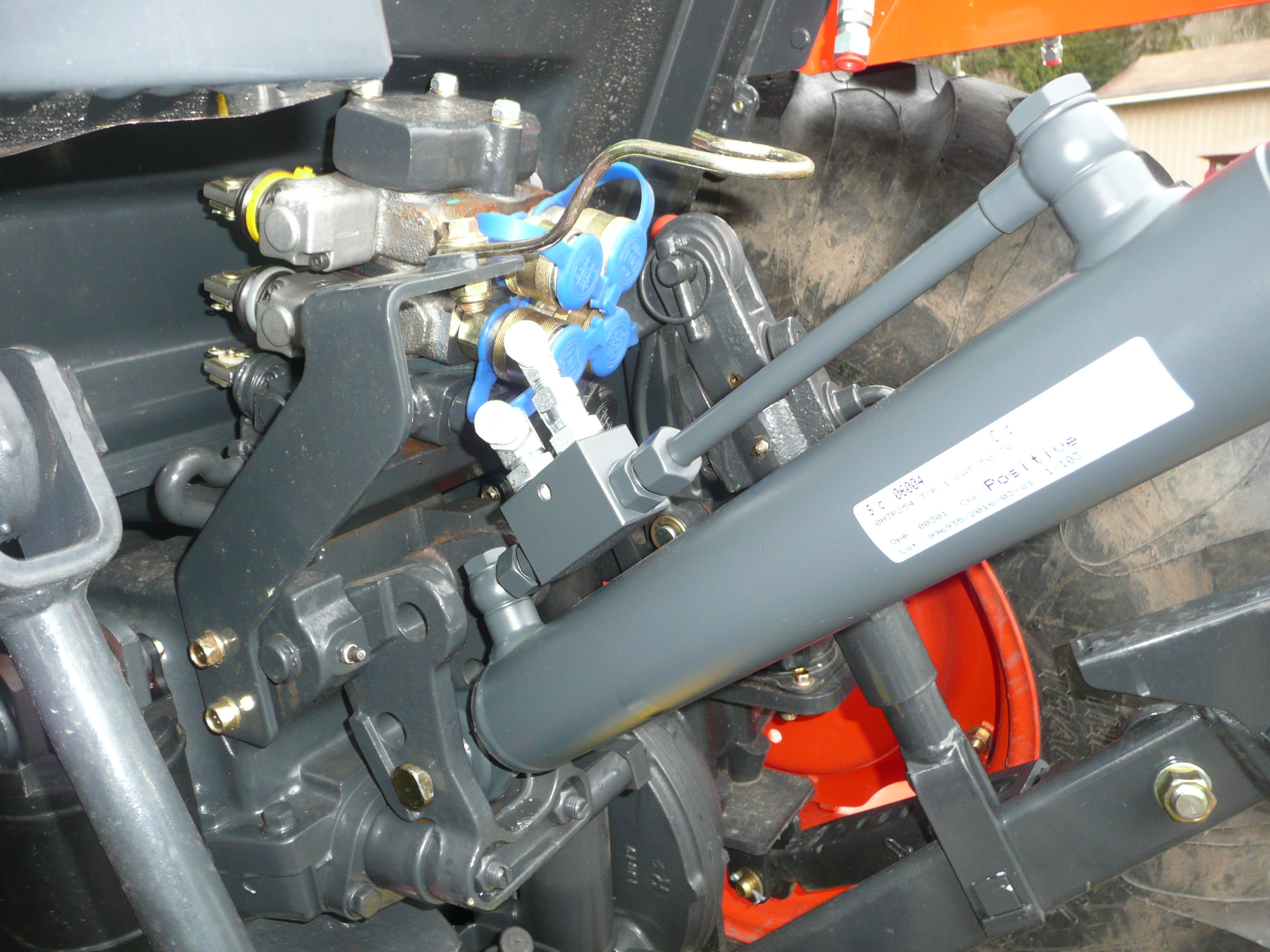

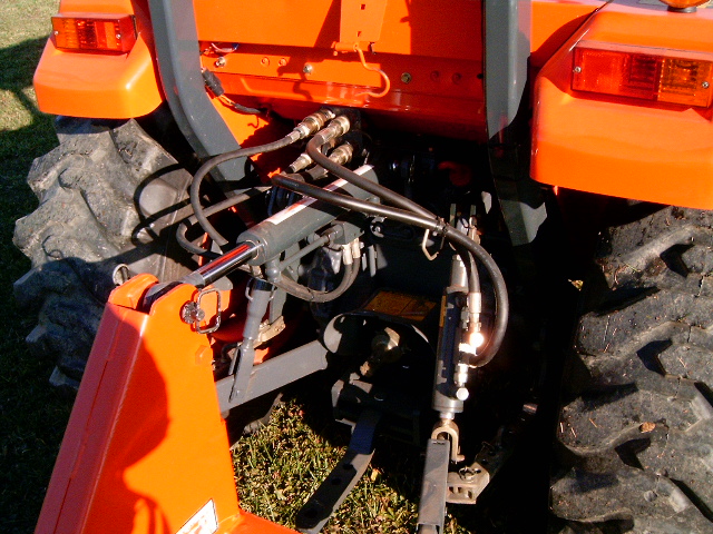

Things are finally settling down here and I'm itching to get underway installing my extra hydraulic bits. First I figured I'd do the top-link. Looking for some input on how best to route the hoses and position the fittings on the top-link.
The factory top-link holder bracket seems to limit full upward travel of the top-link with hoses coming out to the left. Not sure how much travel I'd be losing, don't think it's much; but, I don't want to jam hoses. So, I'm thinking that I should remove that hanger and bracket. I'd need to use something like a bungee until I get a quick hitch.
I'll likely swap the positions of the two fittings so that the taller one is at the rear (toward the tractor): I was moving them around to see if it would buy me more clearance/travel (not much, and not enough).
/ My NX5510H #177
I put my check valve down for more room

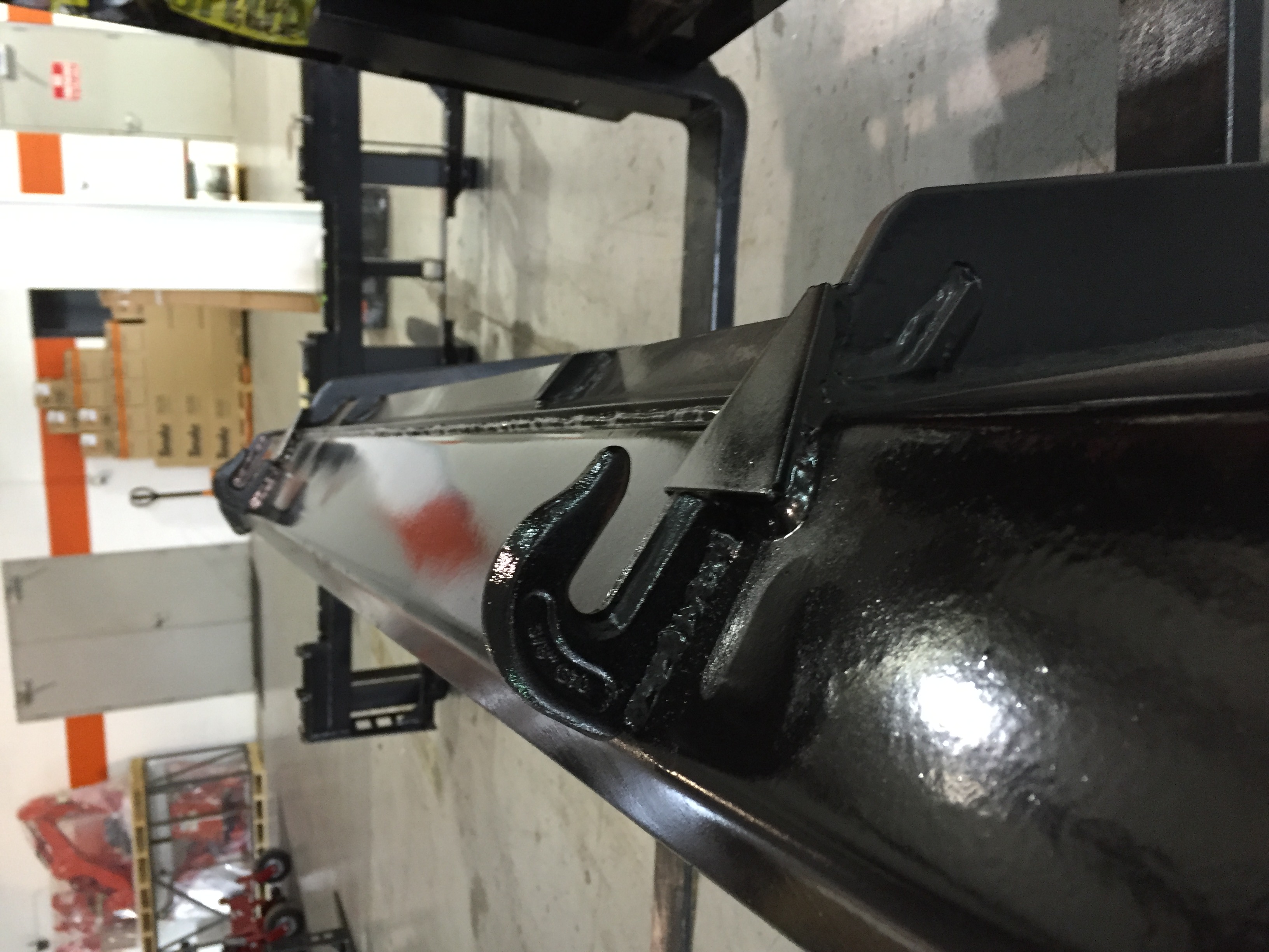

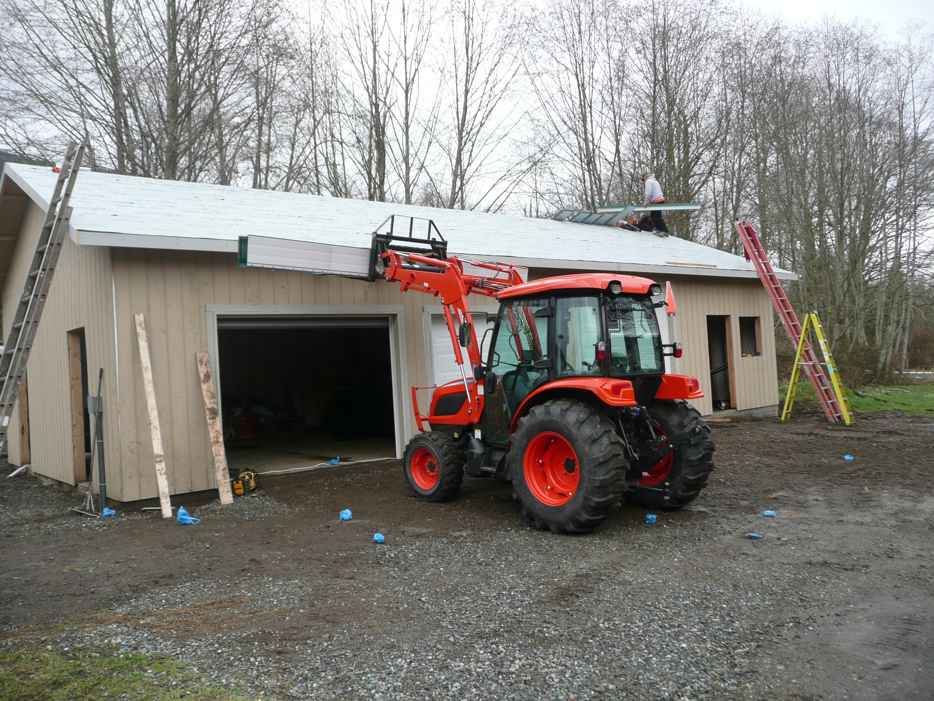

While I was contemplating the top-link issue my tractor was called in to service:
/ My NX5510H
#180
Vince, now you've got me thinking... Is there any reason why a person couldn't loosen up and rotate that block 90 degrees (in my case I'd look to rotate it counterclockwise)?
