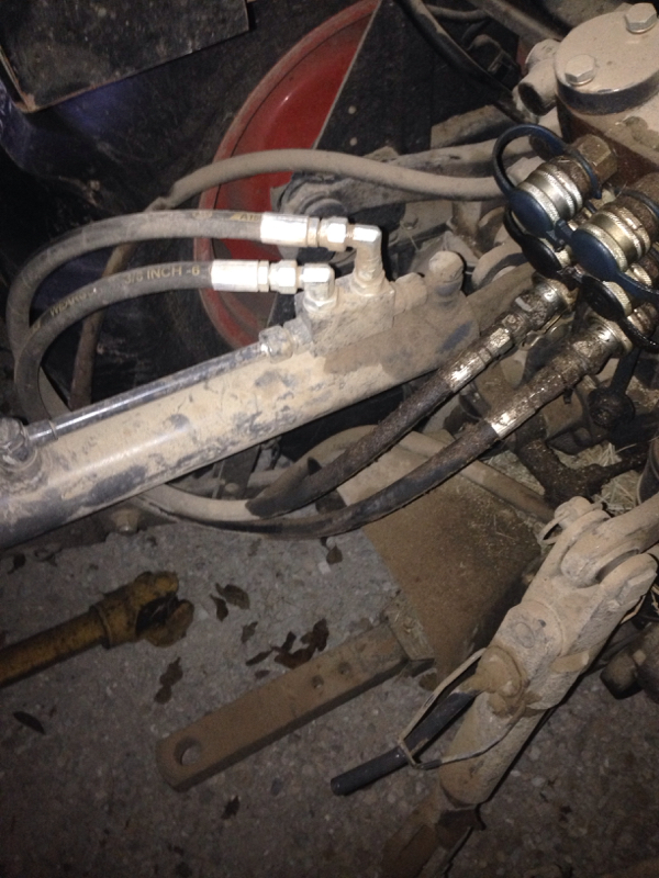

Got the torque tube piece painted and reinstalled along with the hose saver. Need to play around with how the hoses sit: need to have the hoses run more parallel to the torque tube- have it twisted a bit just to work on things. I have a bulkhead connector adapter in there and that makes things a bit bulky: hose saver is clamping on them. Not sure if l will take them out or whether I'll build an adapter that I'll then use to connect to the hose saver.
I'm not having much success getting the couplers connected. I've done all the normal things to relieve pressure (even loosening up a fitting!), but the female adapter on the grapple side (from EA) just won't cooperate. I have a higher quality female adapter on the tractor side (from Discount Hydraulics) and that one works fine.

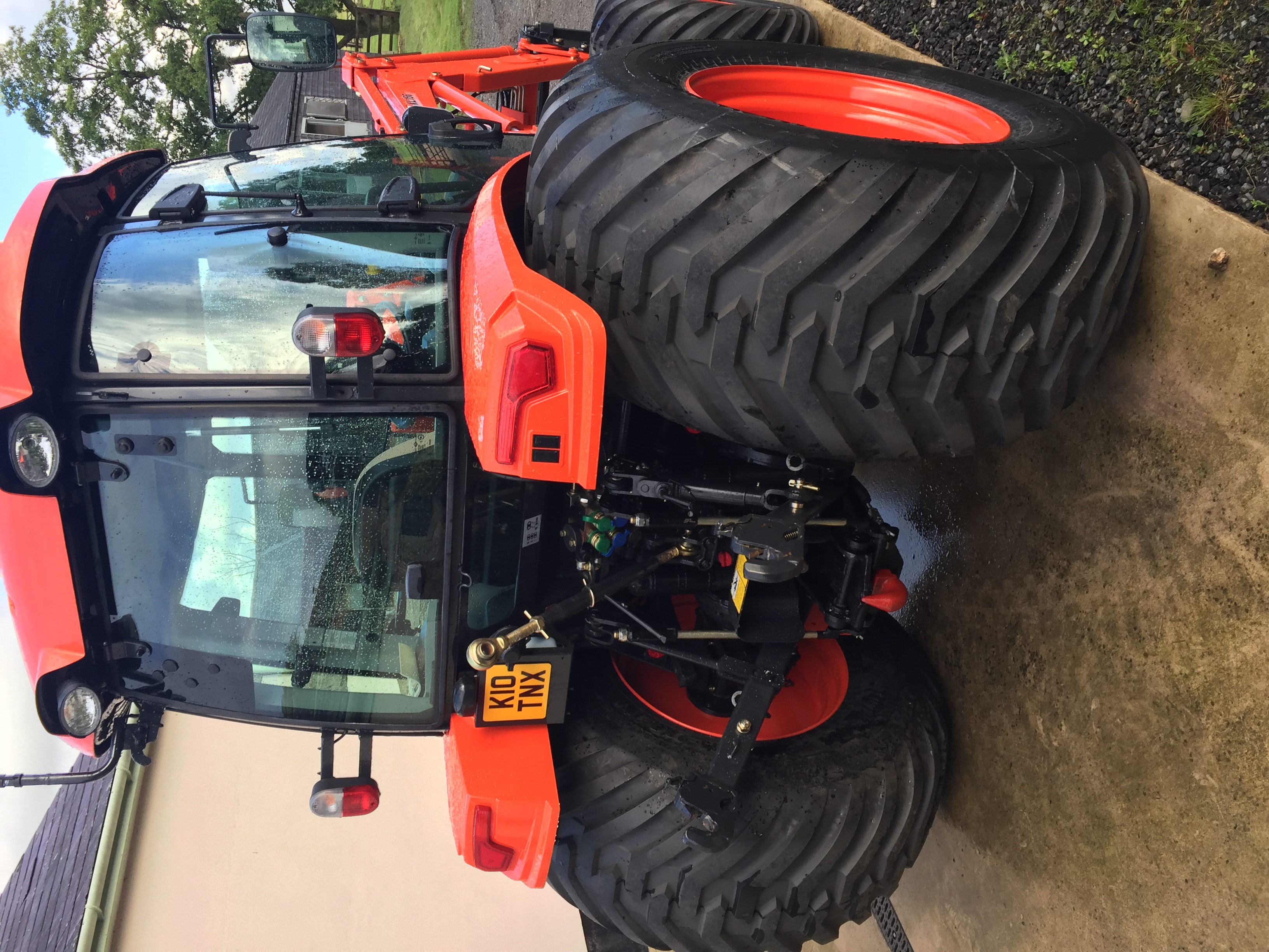

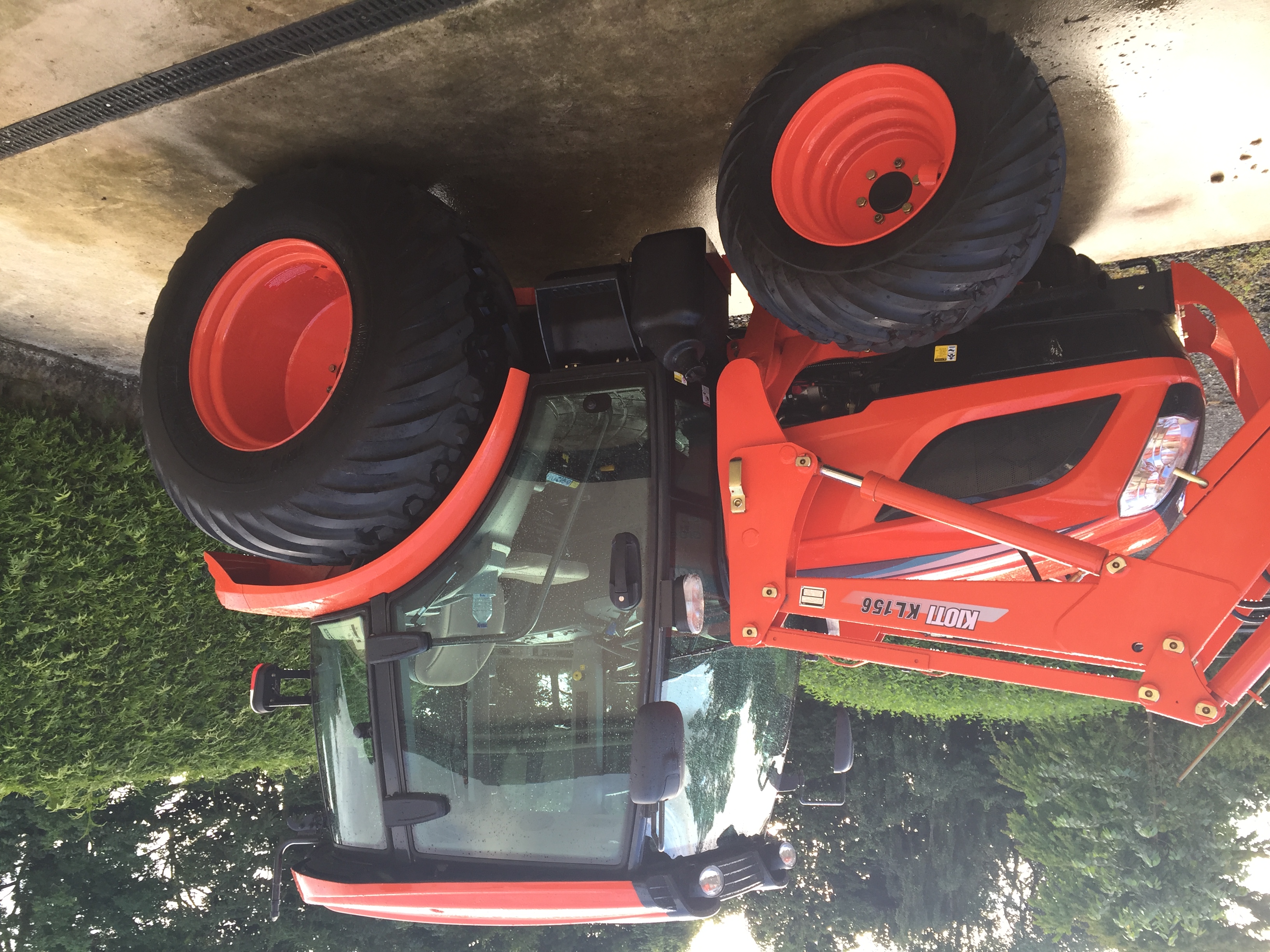

Share a photo of your tires some time.
Just realised I never did this Eric...
Here's four pictures:
Sadly she's not so clean now.. These were taken the day the tractor was delivered..

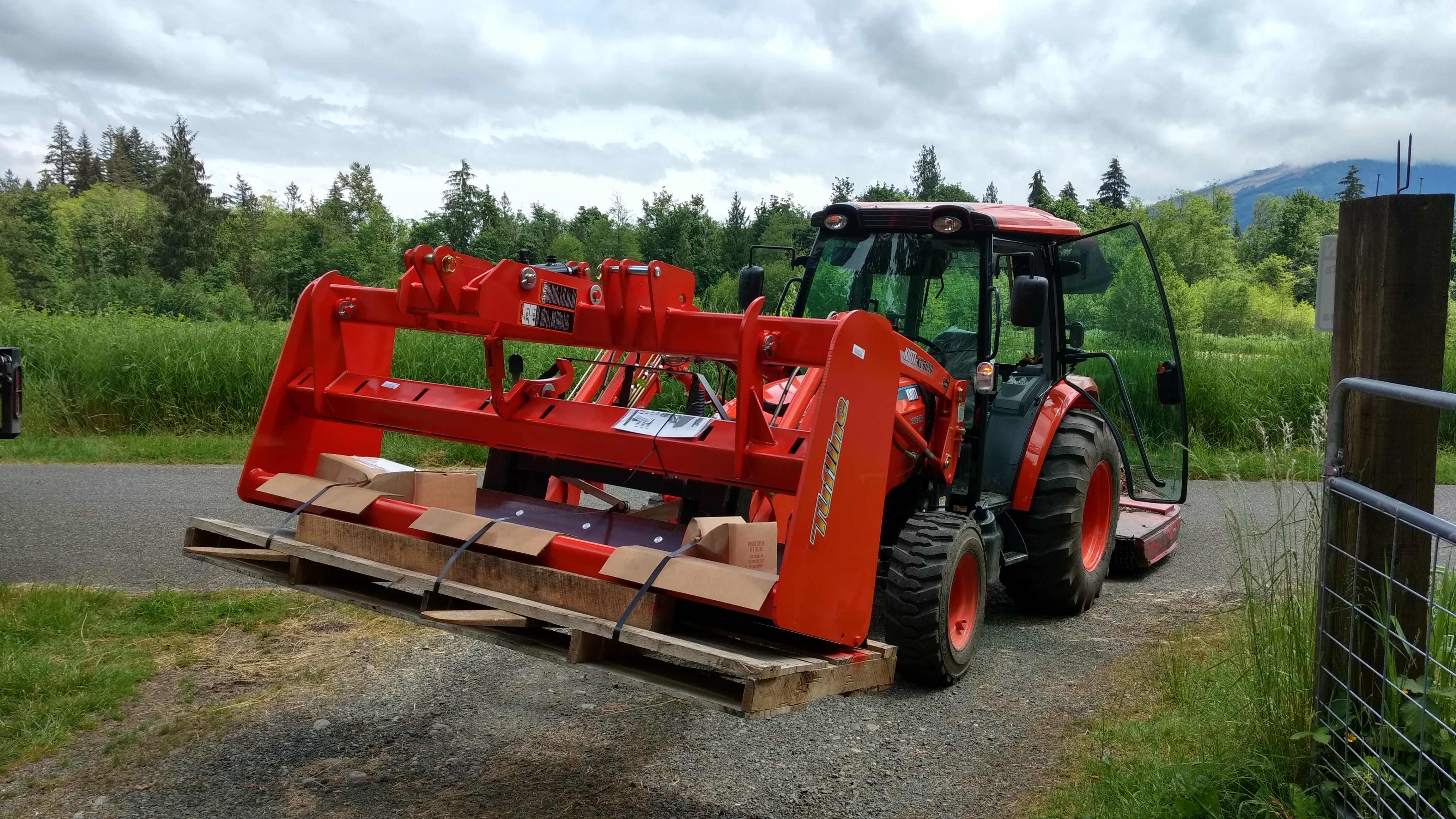

FINALLY got my box blade!
84" Tufline. I was going to go a bit smaller/narrower, but realized that the wheels were set out on my tractor, in which case with an 84" unit I won't have as much sticking out as I'd initially feared. This, IMO, was the best deal that was out there. Not that I'm banking on it, but this may be QH compatible. The scarifiers are pretty cheap, not replaceable tips. I'm not really digging into a lot of hard ground so maybe they'll hold up: I've only broken one scarifier on my five-footer on the B7800 (my folly).
