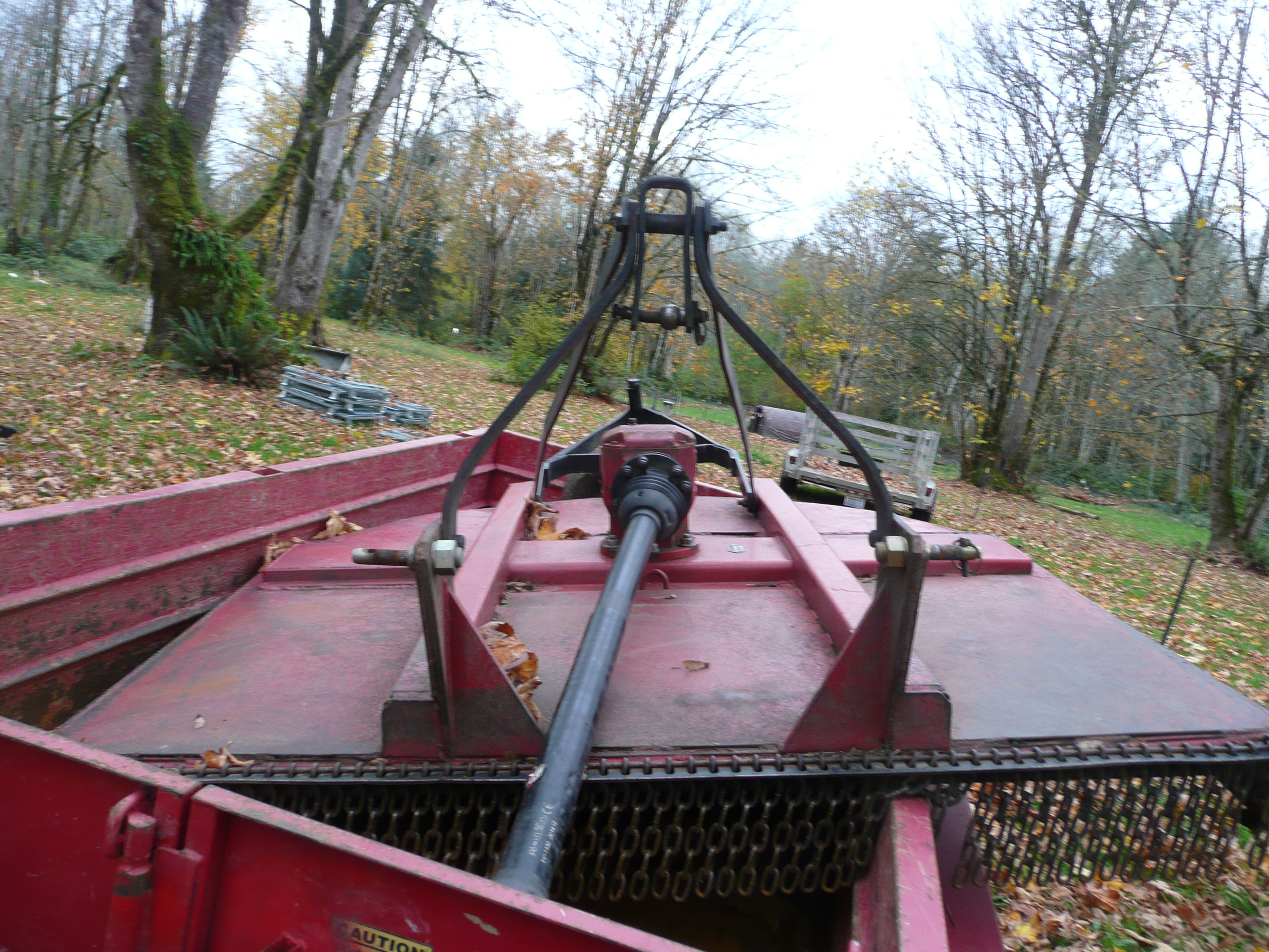

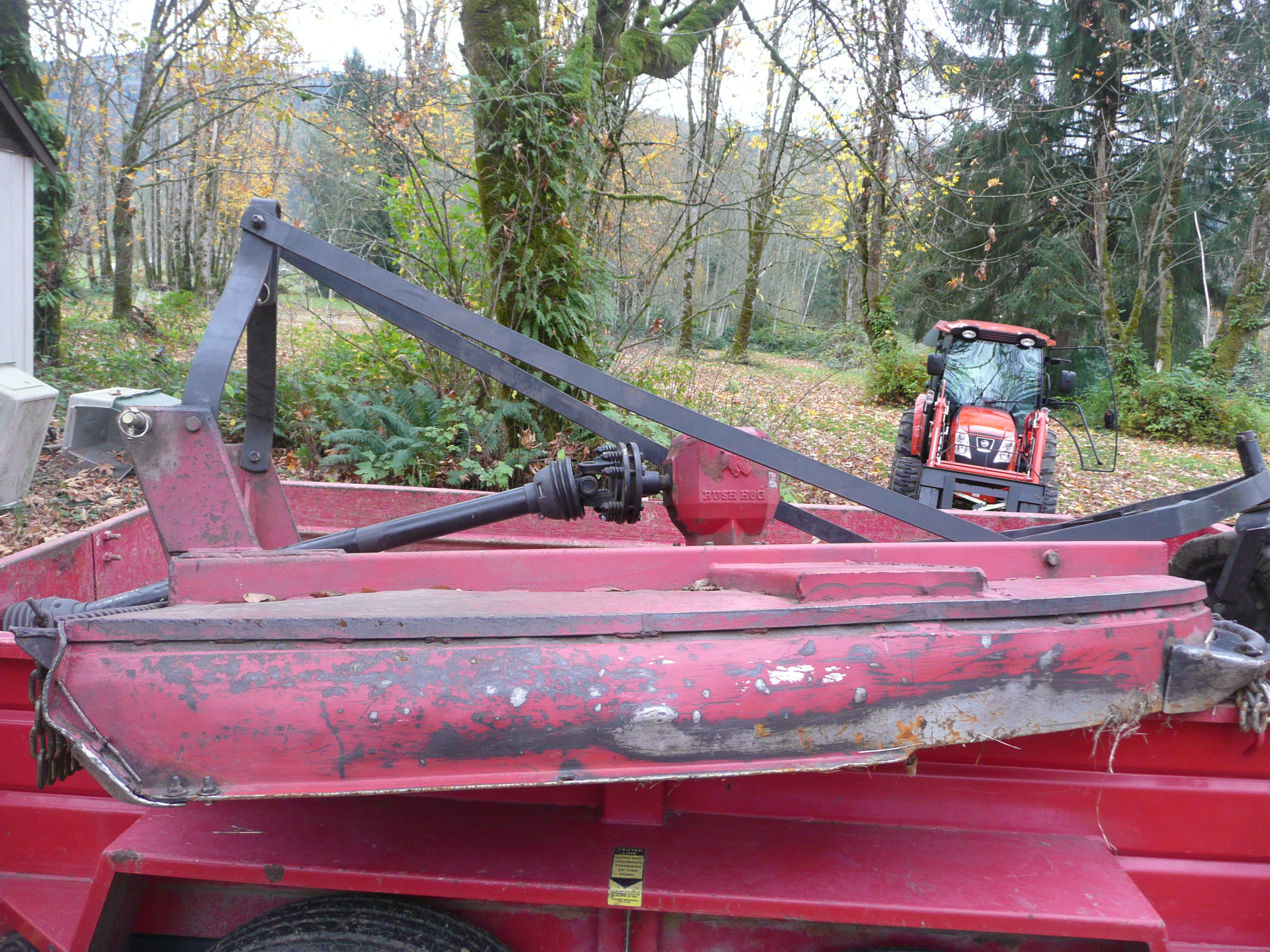

Also just ordered up a new PTO shaft for the Bush Hog 286 mower. The one that came with it was trash: I replaced a U-joint only to discover that the shaft was bent; previous owner had replaced the shaft due to being unable to find replacement U-joints- I suspect he hadn't spec'd the shaft properly and that that resulted in him stressing and bending this one. Not a big problem as I am wanting to concentrate on this one fence segment for now; but, really want to have this mower available for mowing as the Kioti is just WAY nicer to mow with than the B7800.

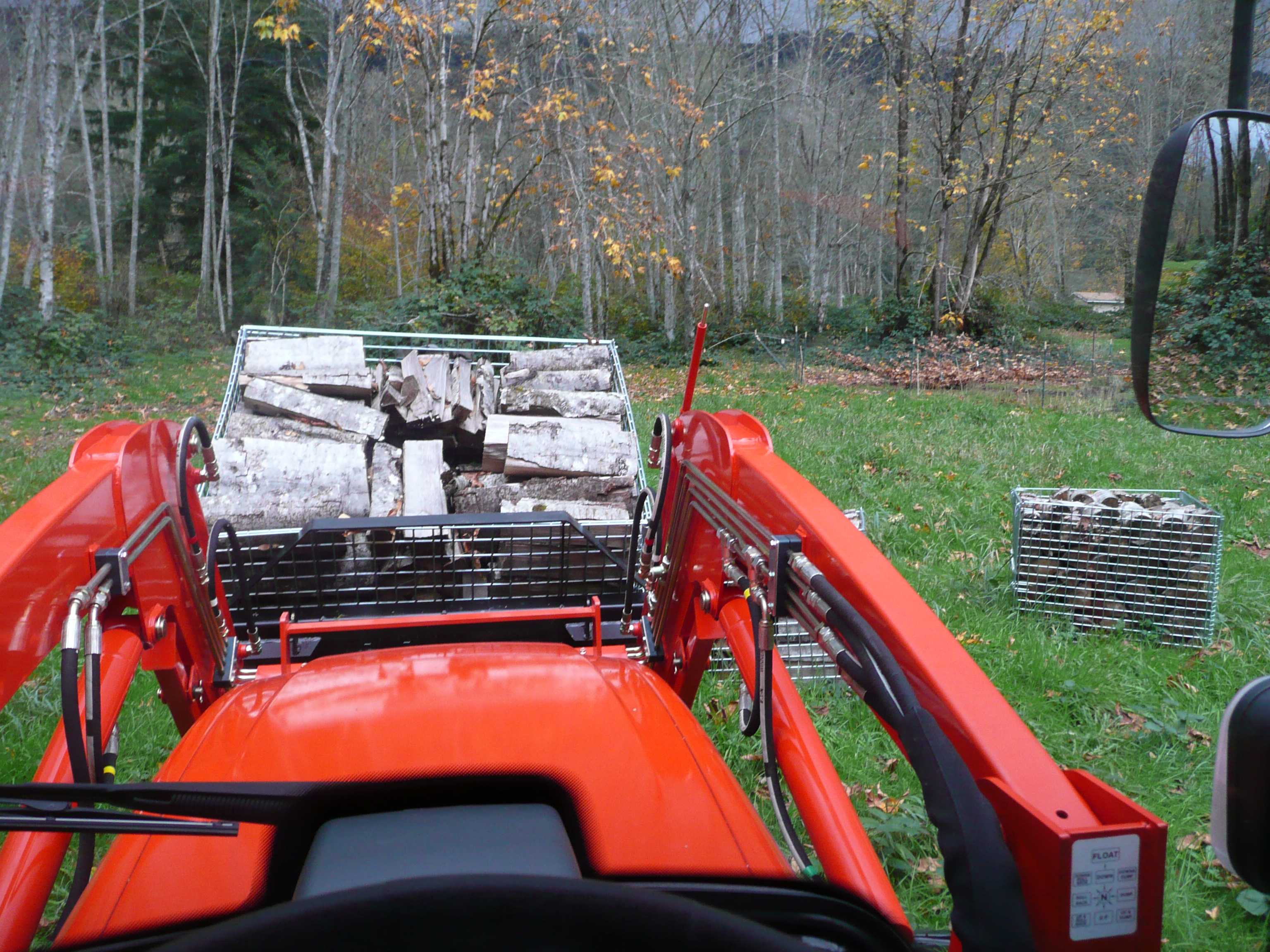

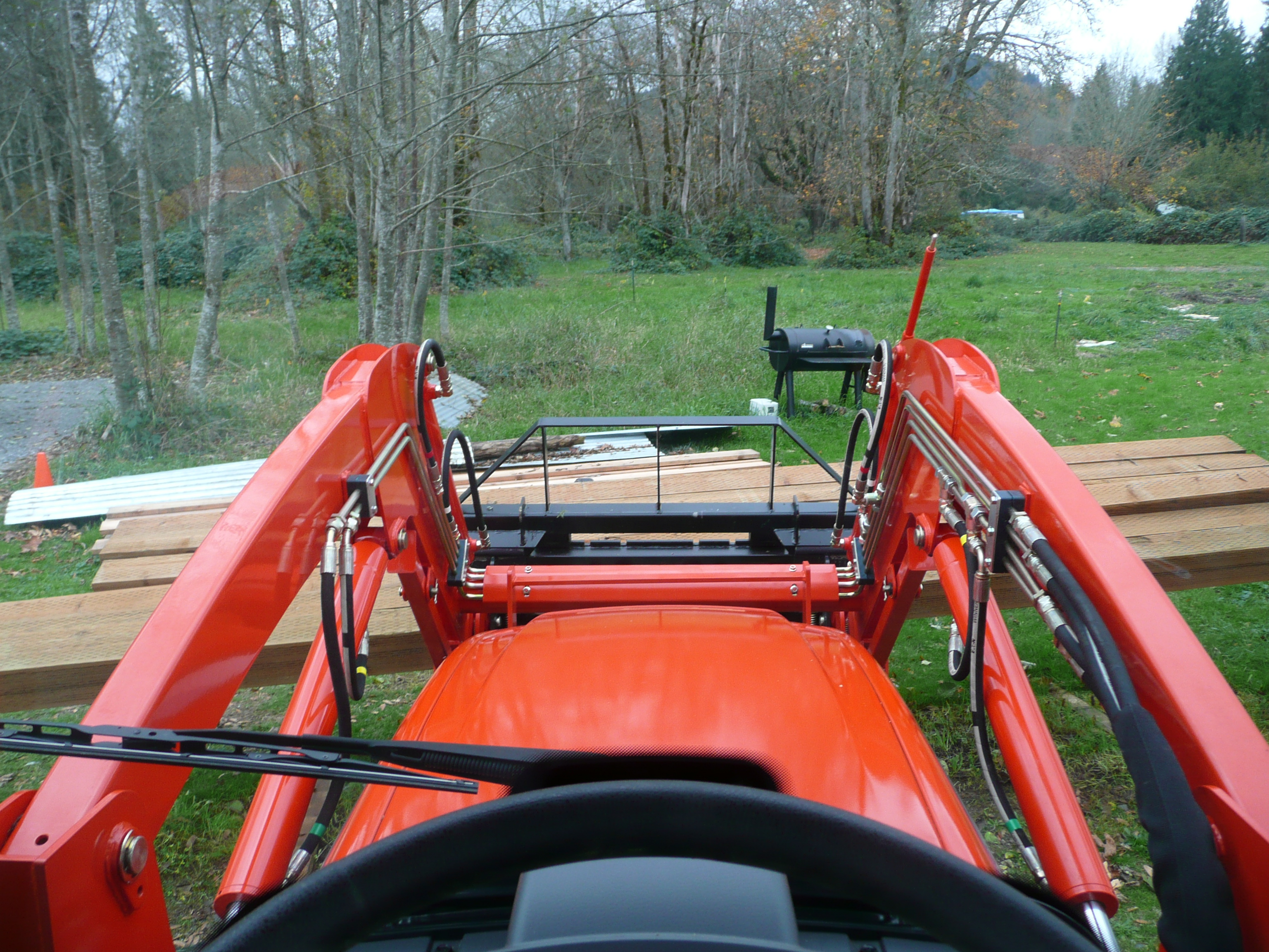

Staging the Hose Saver (HS) and I'm not liking how it looks. Some of this has to do with the length of the lines on the grapple- they're 6'. EA said that they were going to provide longer lines and it now looks like that wasn't a good choice. While the HS appears like it will support the 3/8" lines on the loader OK the grapple lines (1/2") have too much slack.
Another issue with the HS is that it seem too short, such that the hose couplings hang down and against the torque tube. If I were to lengthen the 3/8" lines to drop the couplers lower then the excess slack on that side (grapple) is going to be worse.
It's a pain trying to temporarily set things in place to check position/operation. I'll see if I can get a picture (need another set of hands).

Kind of depends on the hose lengths. I'm actually a bit long: wish they were shorter. I'd also have liked to have had 3/8" couplers rather than 1/2": larger are bulkier and heavier.
Speaking of these hoses... the hose fitting on one of the hoses failed (at the rear). Pretty messy. A bit upset that a higher quality hose (higher abrasion resistance and higher pressure rating) failed due to a bad end. Not sure what I'm going to do about this. I'm pretty much caught up on all the stuff I was wanting to grapple in which case I removed the grapple (disconnected the hoses from the rear remotes) and put the bucket back on
