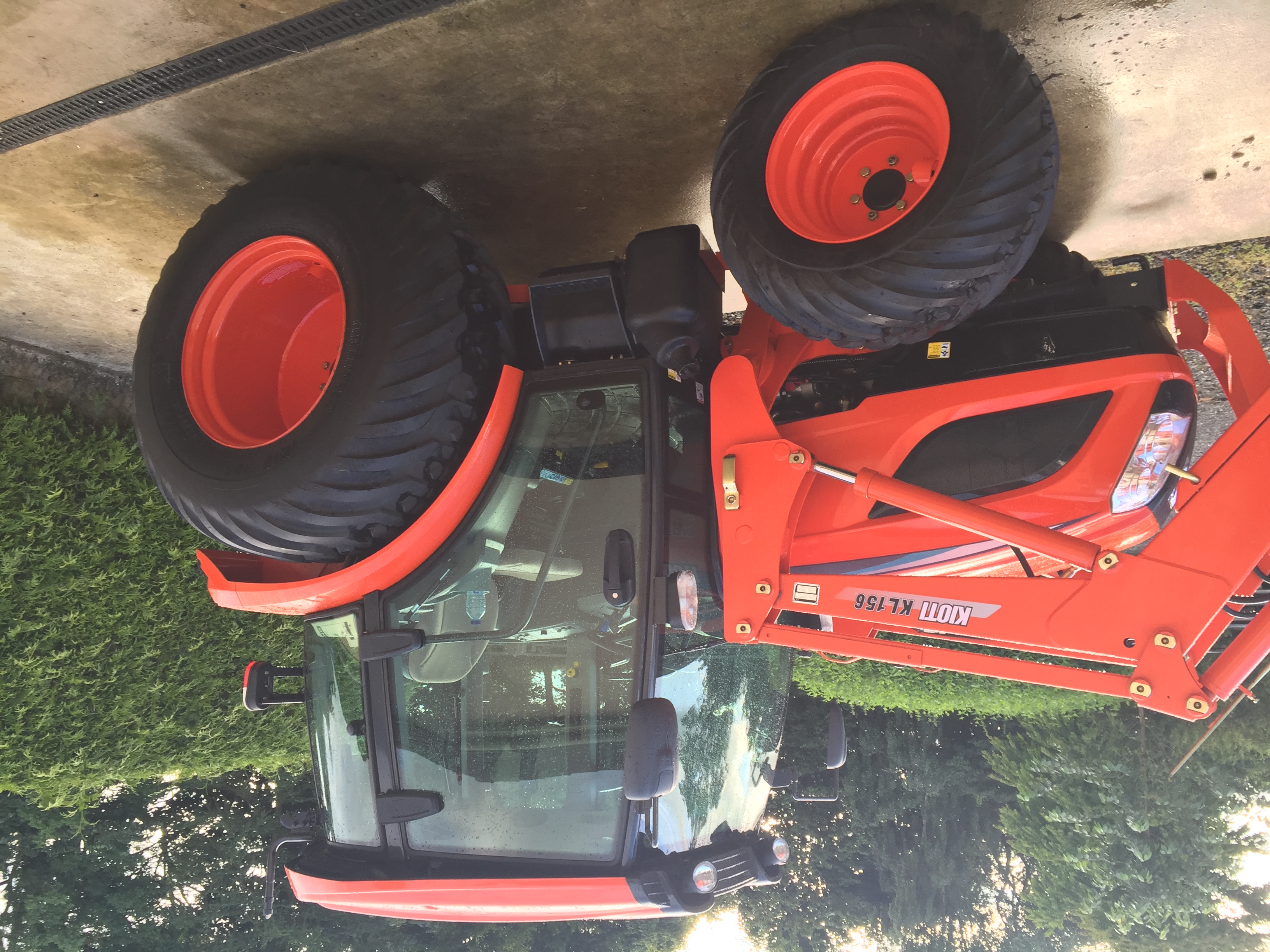

I'd been documenting in another thread an issue with the left side cab door not closing tightly. My issue wasn't an exact match for that thread so I figured I'd pull my issue back into my thread here.
Background:
Door used to easily close from the inside by pulling on the support rail. About a month and a half ago I found that the door would more often than not just bounce and not latch. It came down to having to apply more energy to latch properly. I was unable to adjust the hook(?) on the cab frame so that the door would both latch easily AND tightly. I can get it to more easily latch but then the seal is poor (bottom lower corner) and I get a fair increase in engine noise coming in.
The seal on the glass is well compressed on the rear/hinge end of the door (I need to take a closer look to how the right door is fitting/sealing). It makes contact sooner at the top front corner than at the bottom front corner. And it's the front bottom corner where it's not really sealing at all (seal just barely touches)- this results in increased noise. Here's a picture that kind of shows all this:
Although there is no adjustment at the hinges it's like the top hinge is tighter to the cab frame, causing the back half of the door to bottom out before the front can get any compression to the seal (at the front end).
In that thread Threepoint suggested that the glass may have been marginally produced, that the deflection might be more than allowable specs. Because I have nothing else to go by I went ahead and measured bow, or measured what I figured would be a good place to measure at. I measured from the middle top of the (inside) glass to the bottom (inside) rear (lower part of fender and just above the step). Measurements on the left door were: 2.334" On the right door I got: 2.123" This would indicate a difference in bow of almost 1/4" I can only guess that the left door's top is pulled in by ~1/4" more: cupped more at the top (top is making contact sooner)- I should look to take measurements from top to middle and then middle to bottom to establish whether this could be the case.
I'd thought about swapping the door latches (from the glass doors) side to side. The one on the left has to be more worn than the other side but, while this may account for the door not wanting to latch as readily, it doesn't account for the fact that the door isn't sealing as it did/should.
Many thanks to countrybumpkin for trying to help me figure this out.
