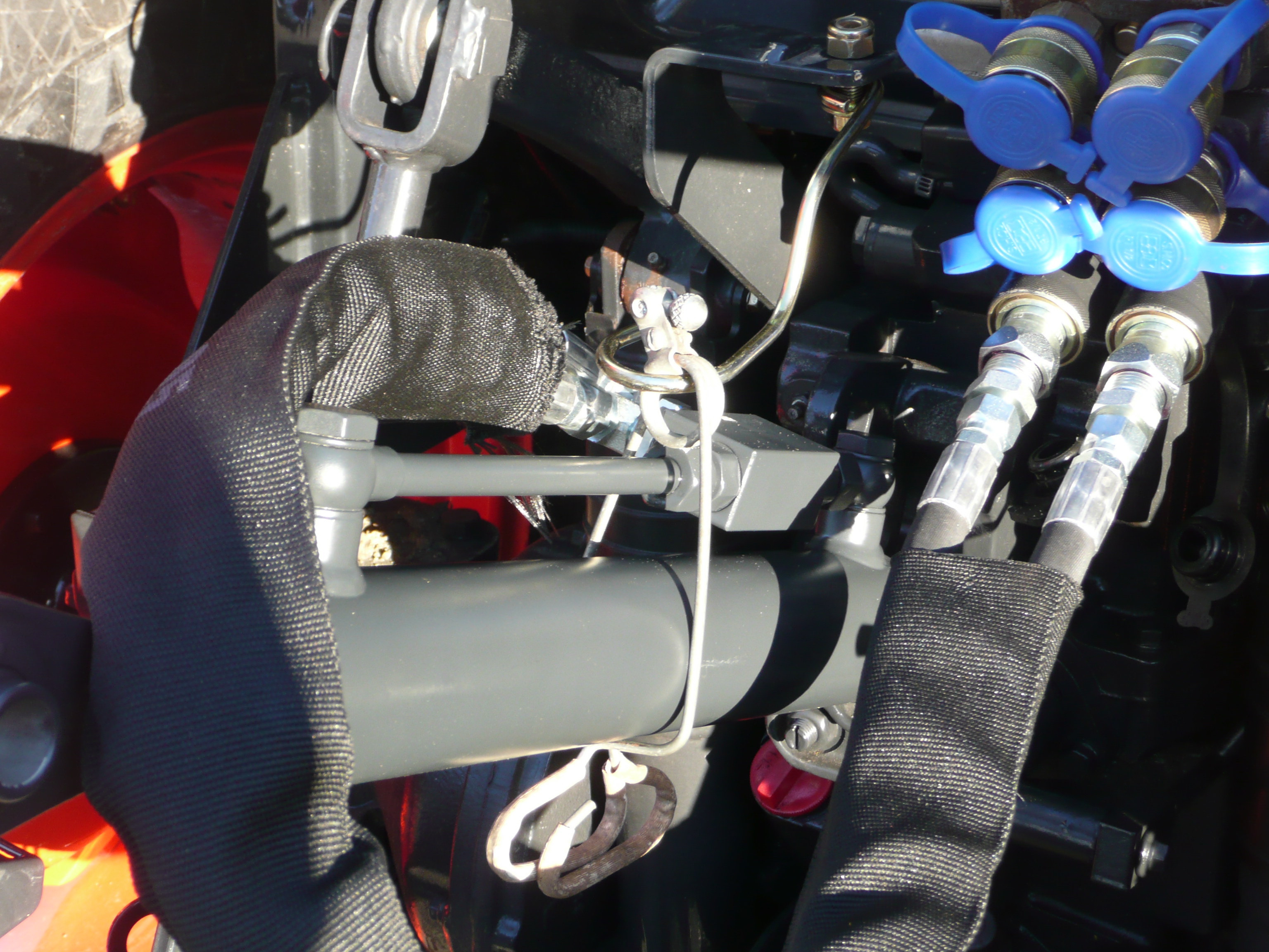

Got the top-link hooked up and working.
Rotated the port block 90 degrees so the hoses come out at the side instead of at the top (where they would end up hitting the support bracket).
I didn't have a suitable bungee cord (just really springy stuff that would likely allow the top-link to bounce around too much when not hooked up) so I improvised :D I'll ditch this when I get a quick hitch.
Despite being informed by the vendor to be sure to tighten the nuts to the port block, I forgot, only to be reminded when I operated the unit and got fluid coming out! :eek: Tightened up and it seems OK now: didn't have time to really stress it, so don't know if it's leak free (my connections are leak-free).
When one cuts protective sock material is the cut edge supposed to be burned to keep it from fraying? I'm kind of thinking so. Maybe I can still do it (carefully) in situ.

Made a bunch of material runs today. I noticed that I had a leak on the top-link. Ugh! Yup, I forgot to tighten one of the hose fittings! All good now.

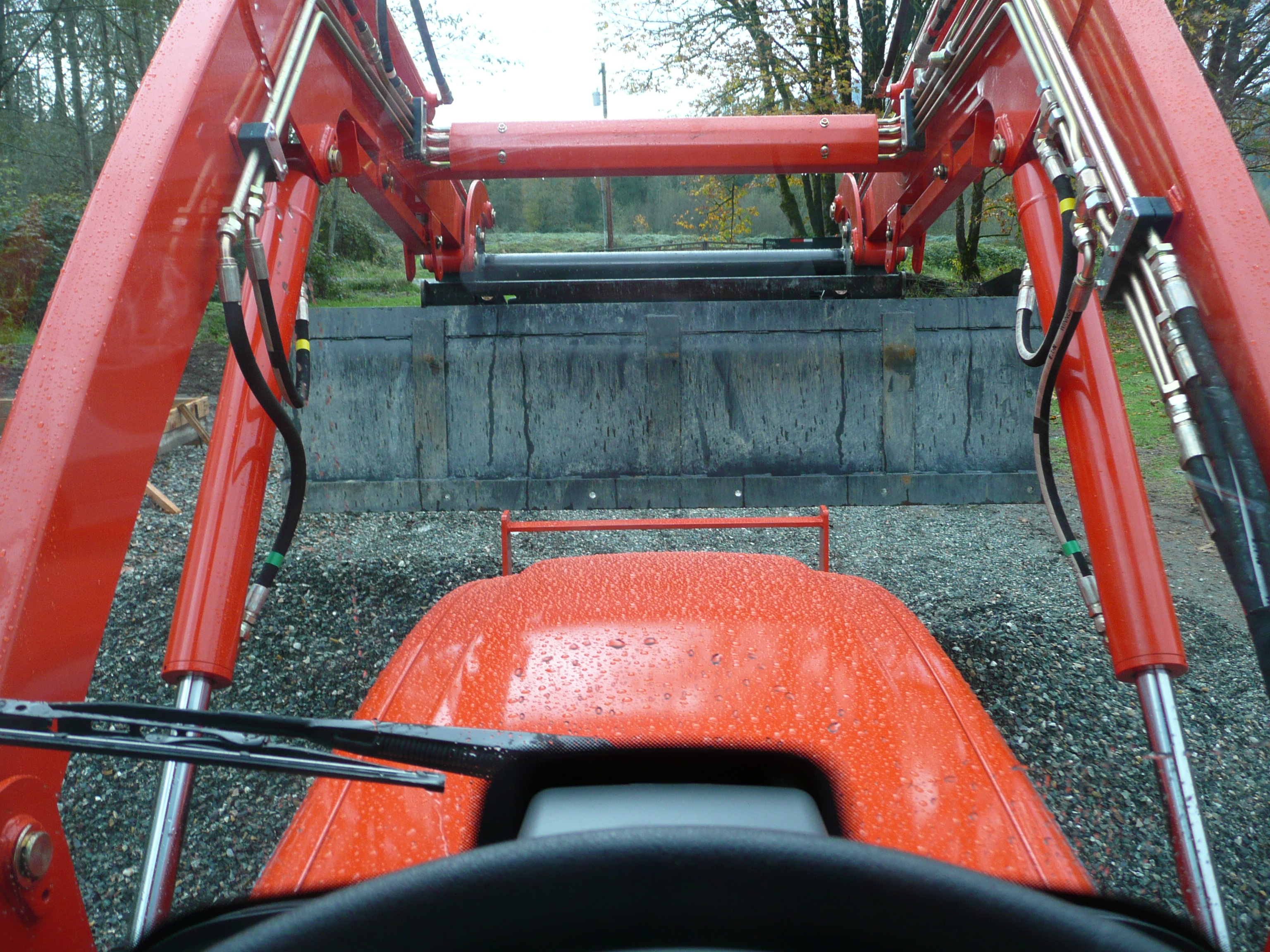

Finally got a chance to start plumbing for the grapple.
This was the first time I've driven the tractor in to the new garage. I thought the view in the monitor looked kind of cool so I took a picture while entering (camera is on a magnetic mount and is attached just under the brush guard's bottom plate):
Picture showing off the side profile of the grapple:
