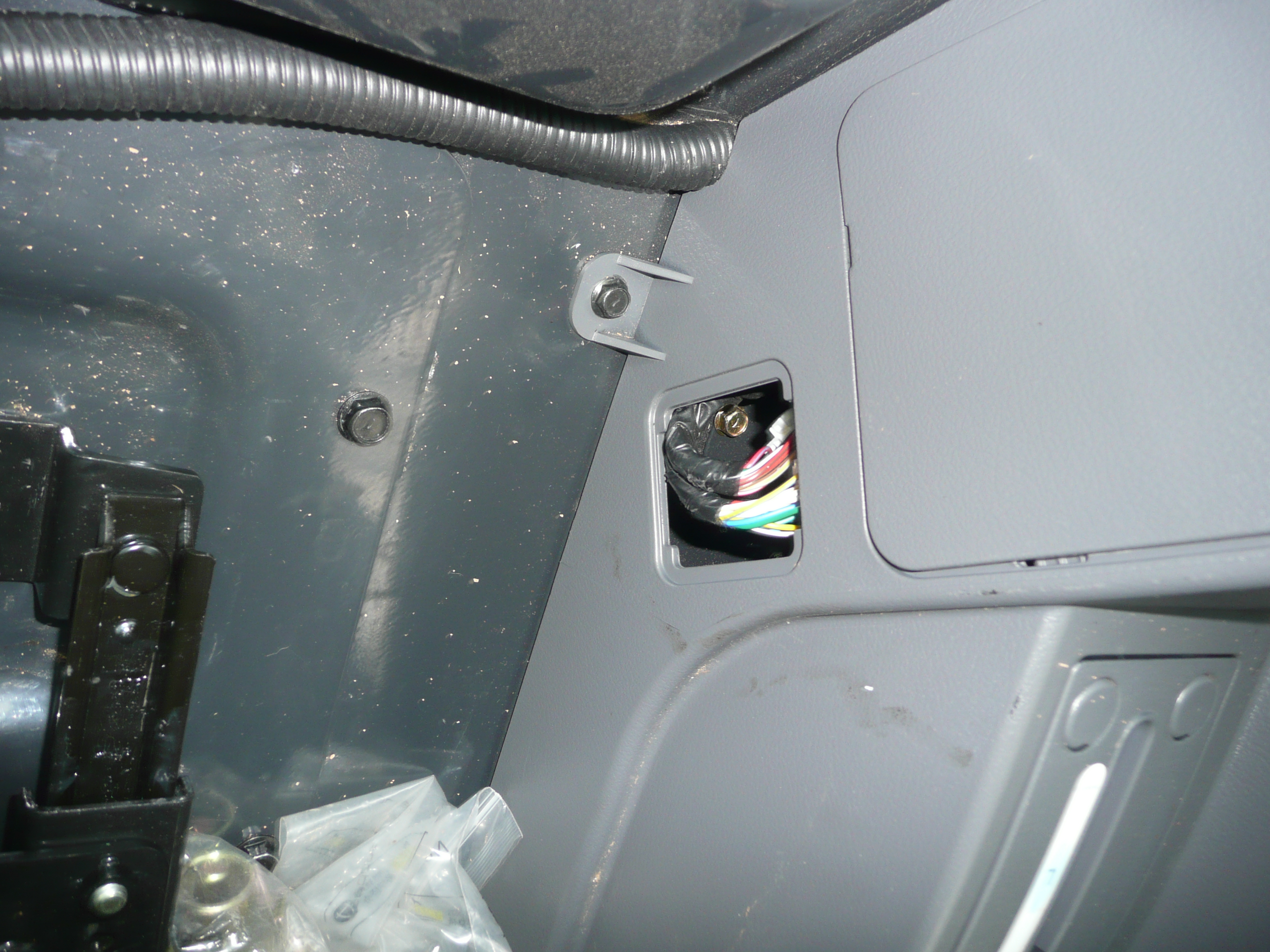

Grease all your electrical connectors that you can get at including the ground strap bolt.
Check all lines for abrasion points/routing. I put some heater hose around the airconditioner lines under the hood where they insisted on touching something sharp-ish. I pulled some wires out of the bottom corner of the cab tubing to have the loom guard contact an edge, rather than the small gauge wire insulation outside the guard. I put a few pieces of heavy tape here and there to protect some things...**** maybe.

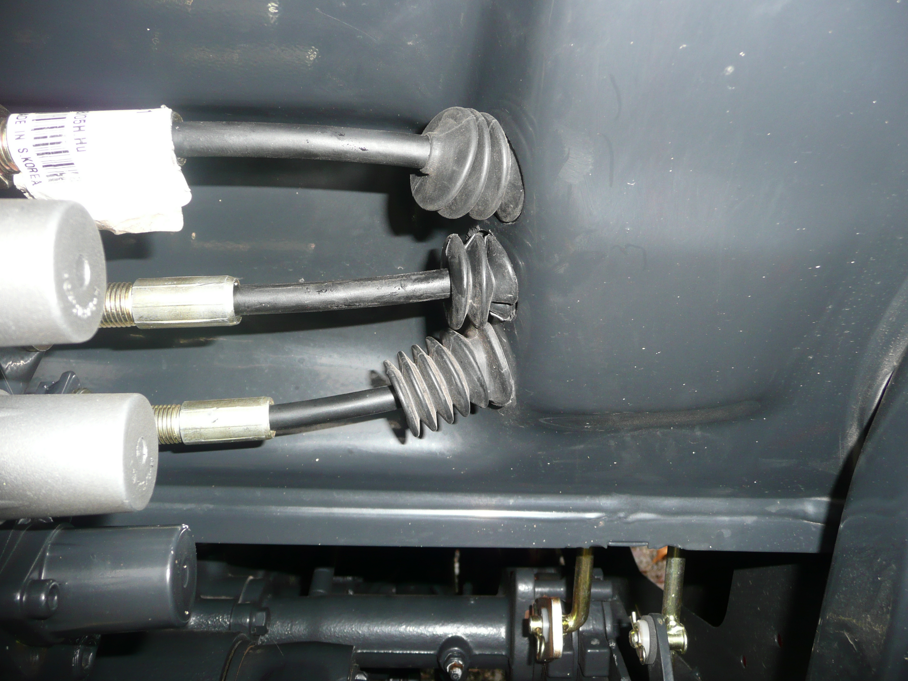

Doing some work the other day and encountered an odd situation. I was shifting into gear (lots of in and out of the tractor- safety switches are a pain!) and hit "M" and stepped on the travel pedal and nothing! I shifted into "H" (because the lever went into it fairly easily) and same thing. Poking around I decided to step on the reverse travel pedal- MOVEMENT! Step on the forward travel pedal and NOTHING. Can't recall what I did (perhaps flipping on/off the Linked Pedal switch?), but it started operating correctly again and I had no further issues.
Speaking of shifting, the shifting is really bad. I find that I'm constantly having to battle to get it to go in gear. It seems that altering the engine rpms helps.

Speaking of shifting, the shifting is really bad. I find that I'm constantly having to battle to get it to go in gear. It seems that altering the engine rpms worked.
I had/have the same issue. Seems as it warms up to operating temperature it gets smoother to shift as well as the more hours I put on it. I'm up to mid 20 hours and things seem to be settling in.

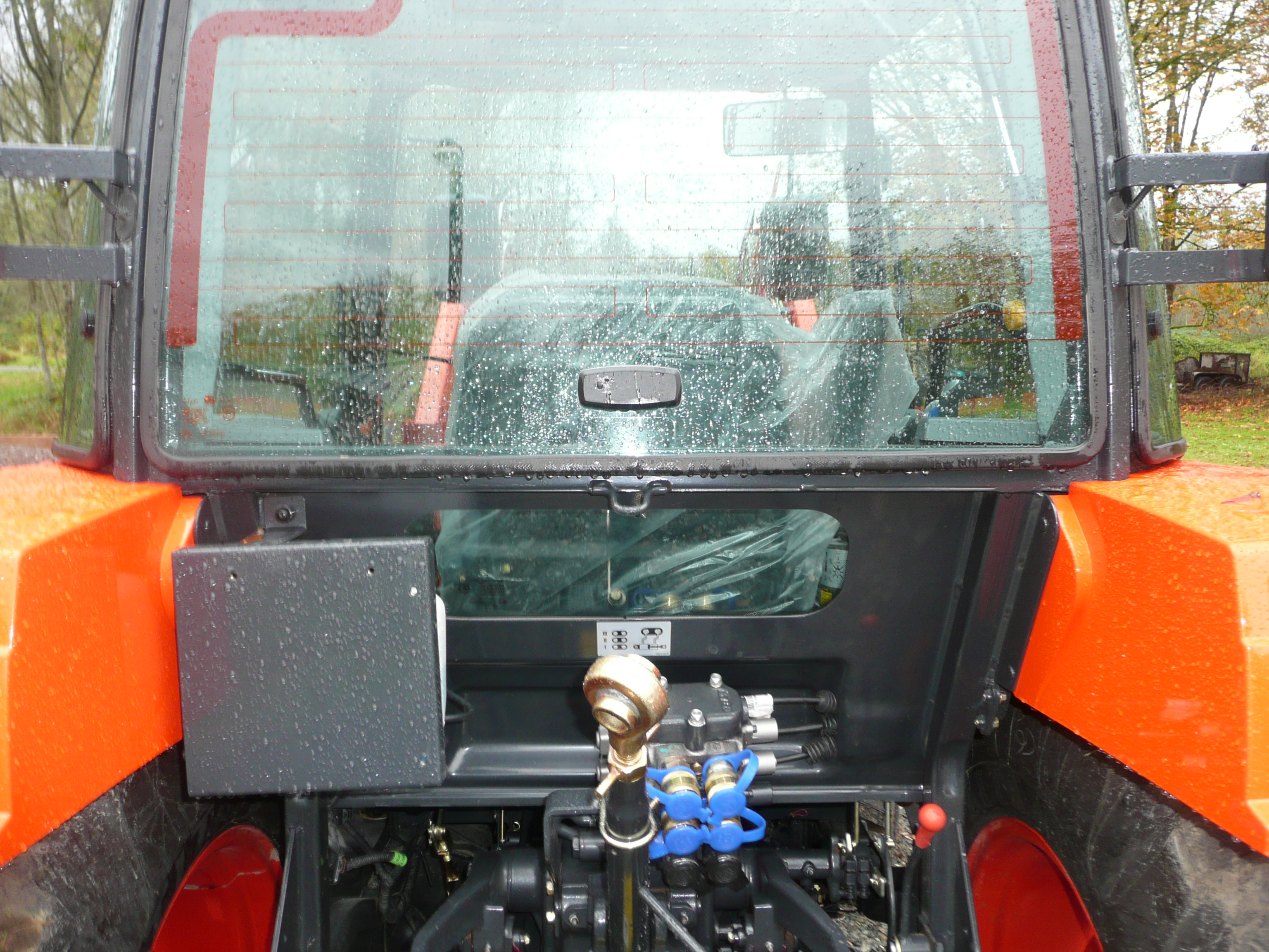

I'm all good on the top link: parts ordered several days ago. What I'm currently fussing about is hydraulics for a 3rd function to/on the FEL: lots of bits here because I'm going to put in another set of disconnects between the tractor and the FEL.
I'm up to 7 hours. I seem to recall some folks mentioning lubing up some of the cables; one would think that the factory would have done this if it was of any help: seems that the behaviors would be reversed, in that new it would shift better and that over time, as the grease/lube wore off, it would get stiffer. Just kind of find it hard to believe that this is acceptable from the factory. I'll give it some time.

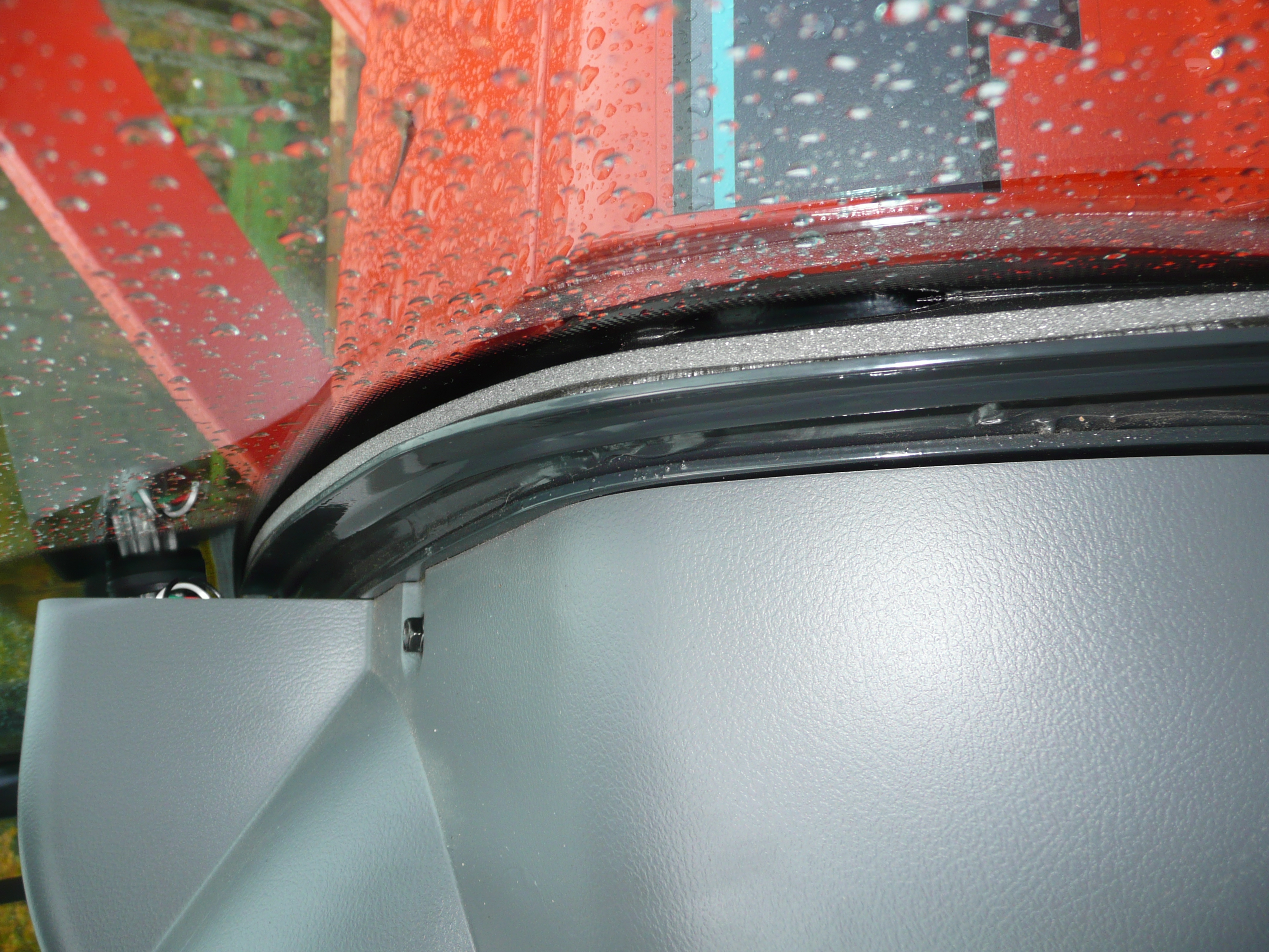

Good news/ bad news day on the tractor front.
Bad news: cab is leaking (again), and appears to be worse:
Dealer says that they just haven't had problems like this with cabs before.

That is exactly where my NX6010 is leaking at. Having my headliner replaced next week. We (dealer and I) believe source of leak was from the grommet around the outside light wiring being unseated. Is your rubber grommet seated properly? Appears can be pulled out just by rotating light up or down. I have a thread in the Owning/Operating forum with pictures.
-Craig
-Craig
Craig, yeah, I recall reading your issue (and was wanting to revisit it).
Dealer says that they hosed it down pretty good and had no leaking. Not sure how well they went about it.
Although I'm pondering storing the tractor in my new garage, it will still get more than its share of exposure to rain (it rains a LOT here!). I really can't have a leaking cab. Funny, I spent years (on and off, and more as a very limited hobby) sealing up my old truck. My 23 year-old truck is more water-tight than the tractor! And this isn't a boast on the truck, either: I still haven't got it 100% sealed.
I'll call the dealer and pass along the note. On one hand I'd prefer to not have a water damaged headliner; on the other hand I don't know that I want to wait a long time for them to get a new one in and installed. If this is a factory issue then having to replace the headliner might be more incentive for them, factory, to do a better job sealing things up.

Yes the fitting is actually a short straight bspp to jic then a jic to jic 90, to make it taller than the other hose, when I first put mine together I thought I was going to need to have that hose go over the top of the other one. Worked out better to just clock them both to the side, I just haven't installed my other short fitting back on.
Just discovered that a shorter fitting won't work! Once you have one installed there's not enough clearance to tighten a second one. I just picked up (from Tractor Supply) an NPT swivel adapter (female to female to connect to the fitting that was shipped with the cylinder) and an elbow (NPT to JIC). This stack of fittings really sticks up- 3" (not fully tightened); the other one is about 1" (not fully tightened).
