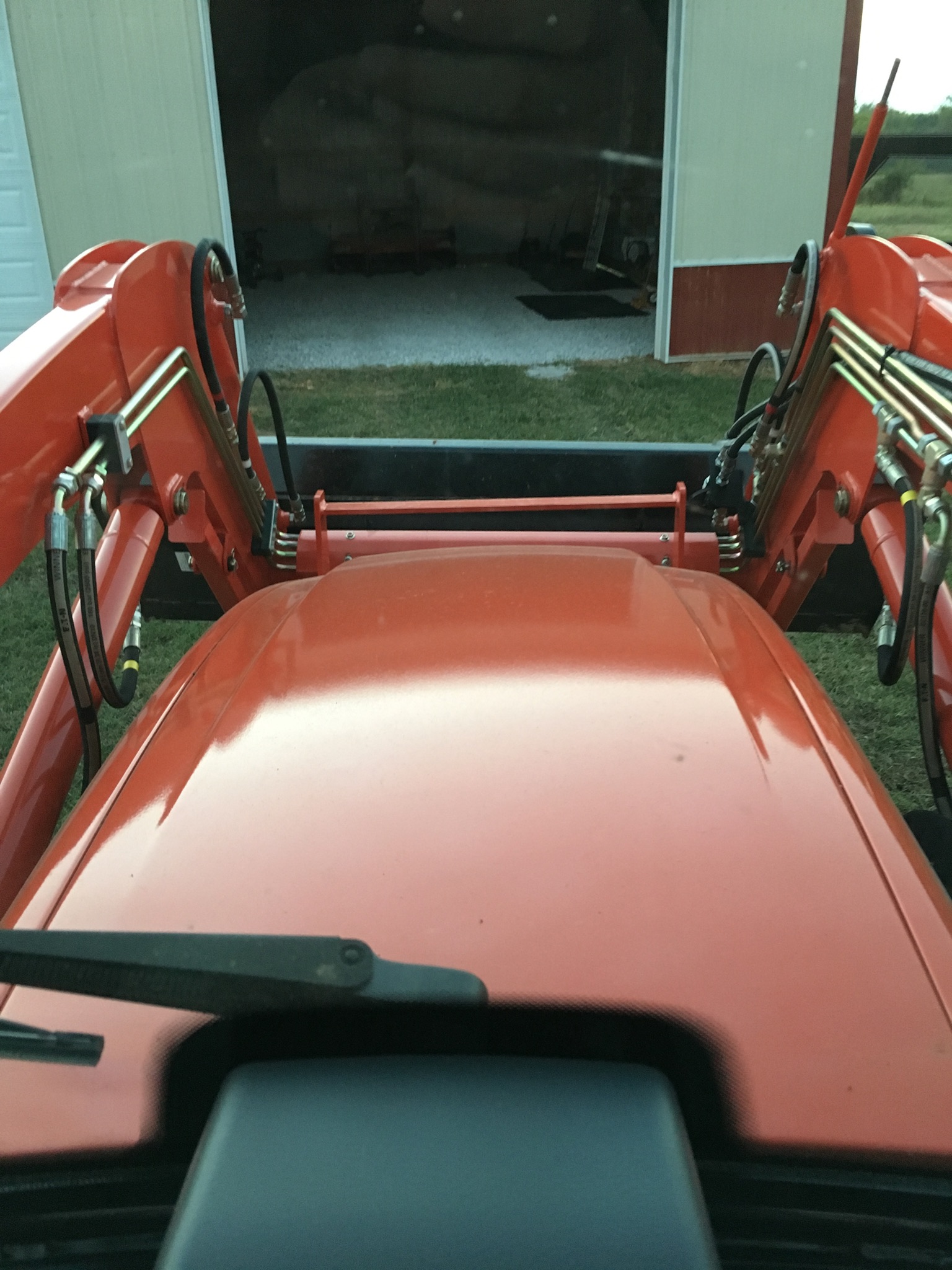

/ My NX5510H #108
The pic isn't the greatest, and the tractor is a bit dirty but at least you get the idea of what it looks like hooked up. As for the parts list just order 2 of each item and you would be set.
Looking closer at your picture, did you ditch one of the fittings (on the valve port toward the middle of the cylinder) that came with the cylinder? That connection looks like it's shorter than the other one. Optical illusion?
/ My NX5510H #114
Yes the fitting is actually a short straight bspp to jic then a jic to jic 90, to make it taller than the other hose, when I first put mine together I thought I was going to need to have that hose go over the top of the other one. Worked out better to just clock them both to the side, I just haven't installed my other short fitting back on.
/ My NX5510H
#115
OK, thanks for the clarification.

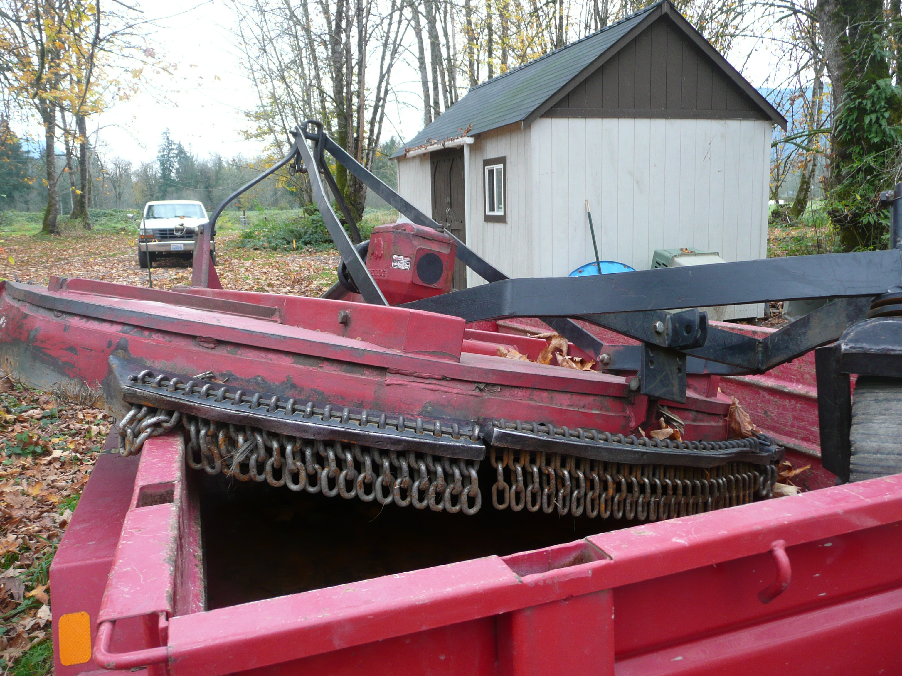

As promised, pictures of the "new" Bush Hog. Had not unloaded it yet: had a bit of a time unloading it- had on the pallet forks for some other work and those didn't prove to be the best thing to use; I think the grapple would have been better. As you can see in that last photo the original deck is pretty much toasted: when the guy welded on the extra plate steel he really did extend the life of it (foresight). Unlike with the previous owner, the deck won't take such a beating as I don't have much in the way of rocks to worry about.

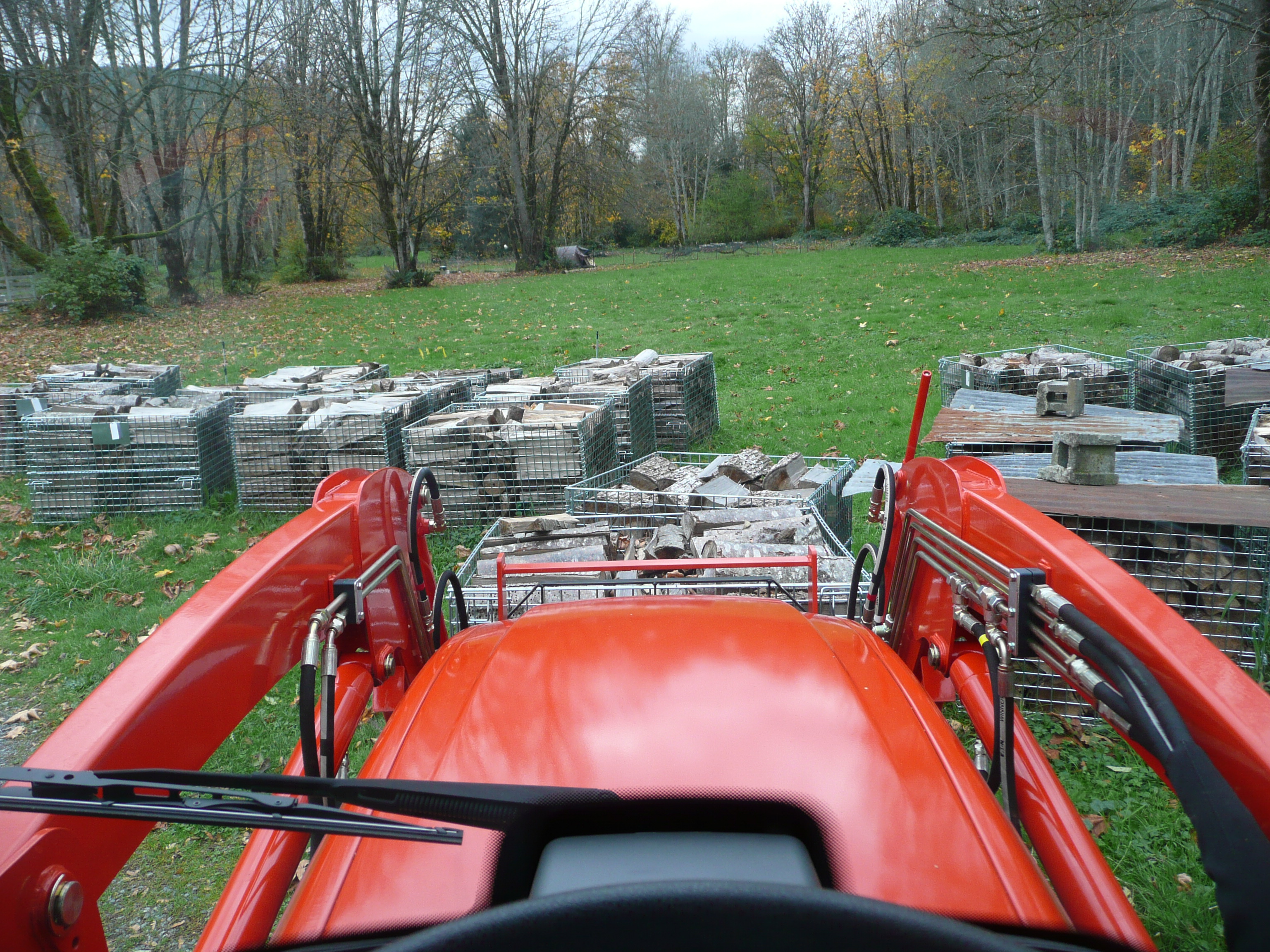

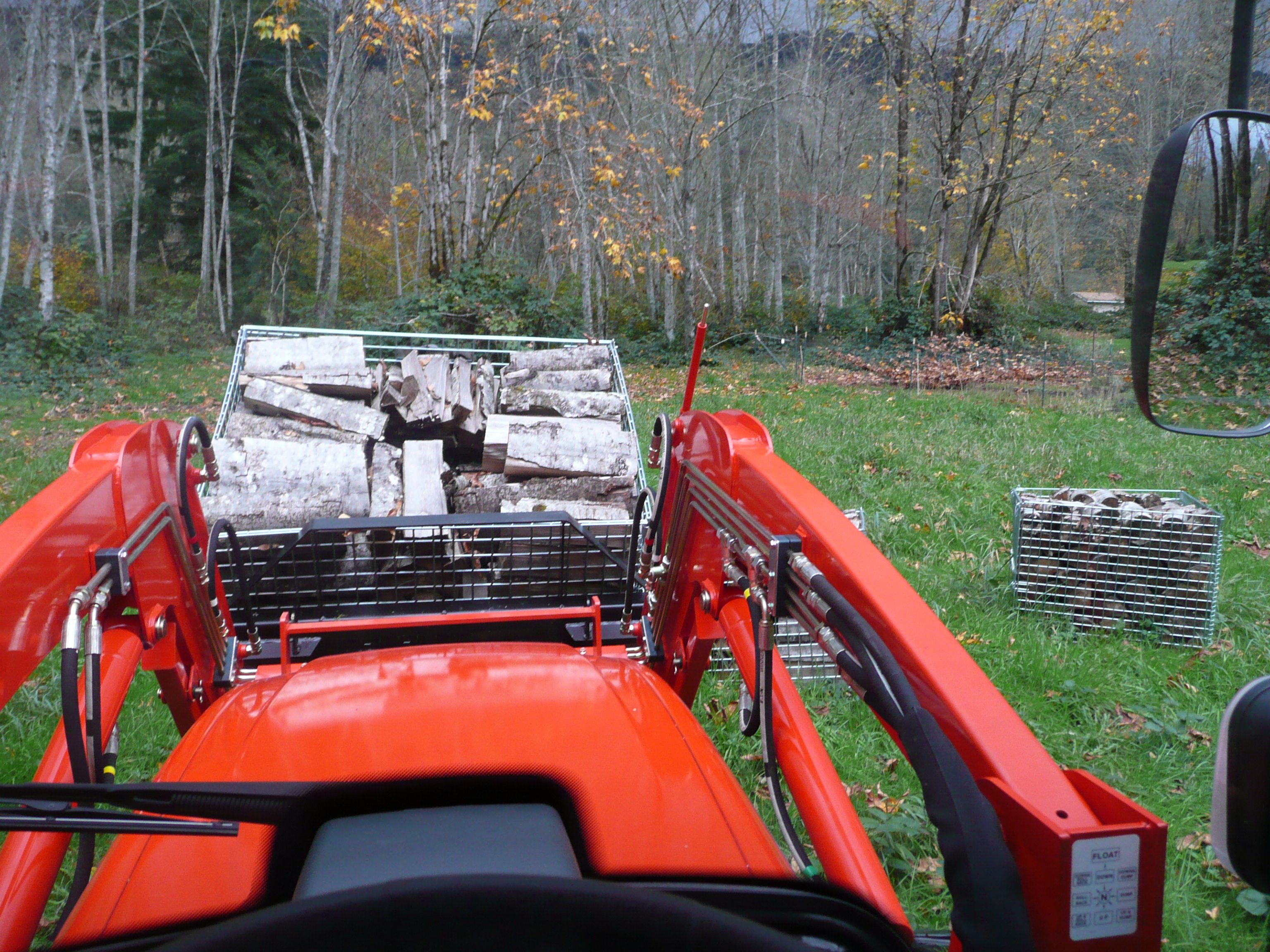

#117
A lot of forking around...
Moved the poles for my new woodshed out of my way:
Shuffled around some cages of firewood. They're scattered about while in the process of building the woodshed. Needed to move some around so I could grab one with seasoned wood in it for delivery to the porch (which required moving those posts -see above- out of the way in order to do):
Retrieved some strays from out on the property (still one way out there- I got its sibling but only after traveling over really soft and wet ground; didn't want to go back over that ground to fetch it! this tractor has a lot more ground impact than the B7800!):
I am looking forward to installing the cameras and monitor. Unlike with my B7800, I cannot stand up in the Kioti and look down at the front w/o it activating the safety switch/cutout (will contemplate bypassing this]). I ended up digging up a lot of grass+dirt:thumbsdown:
