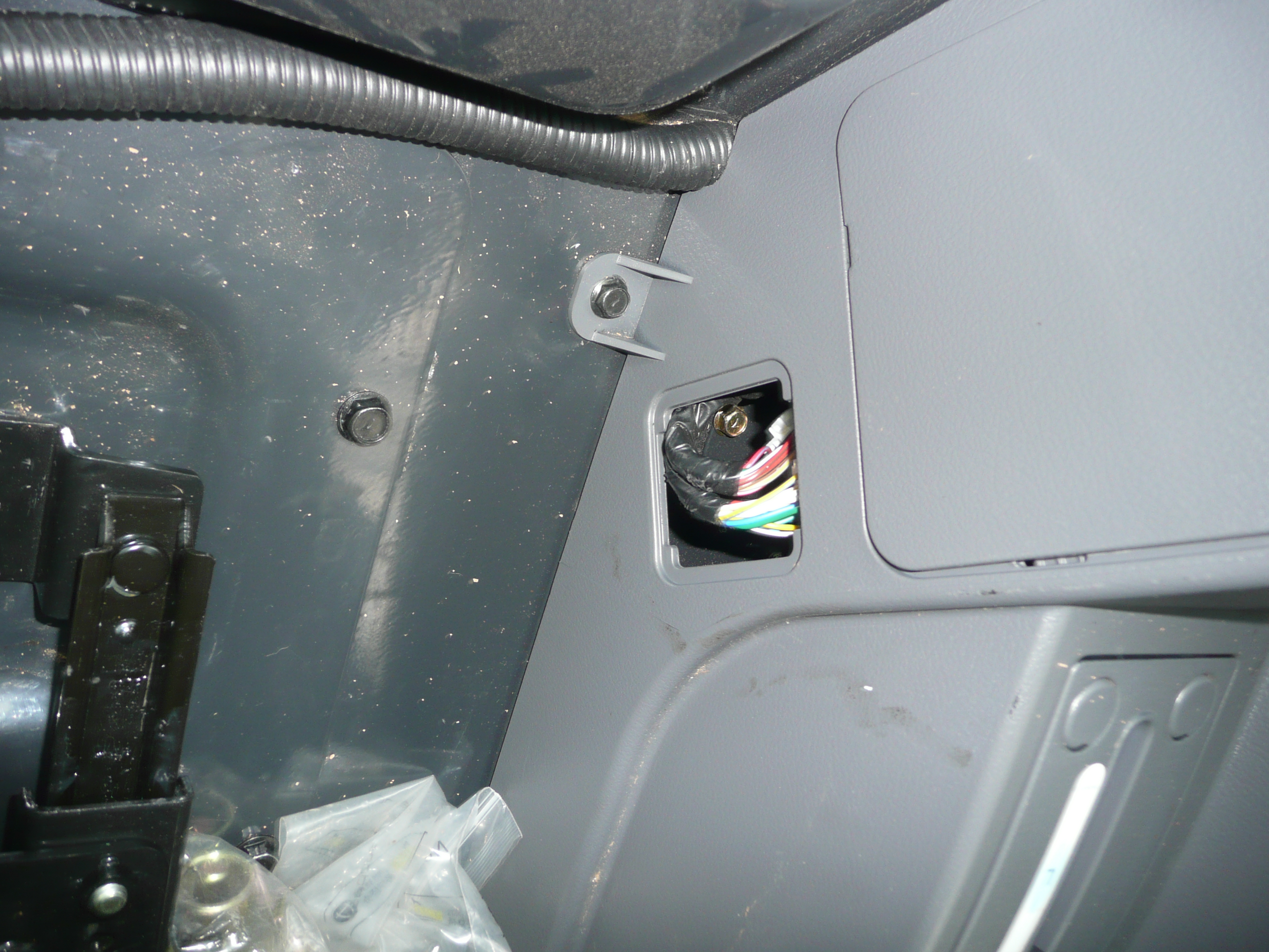

Here's a closer look at that gap in the bulkhead. It's sealed from the outside, so no concern there; just that it's a QA issue (that metal is clearly bowed back):

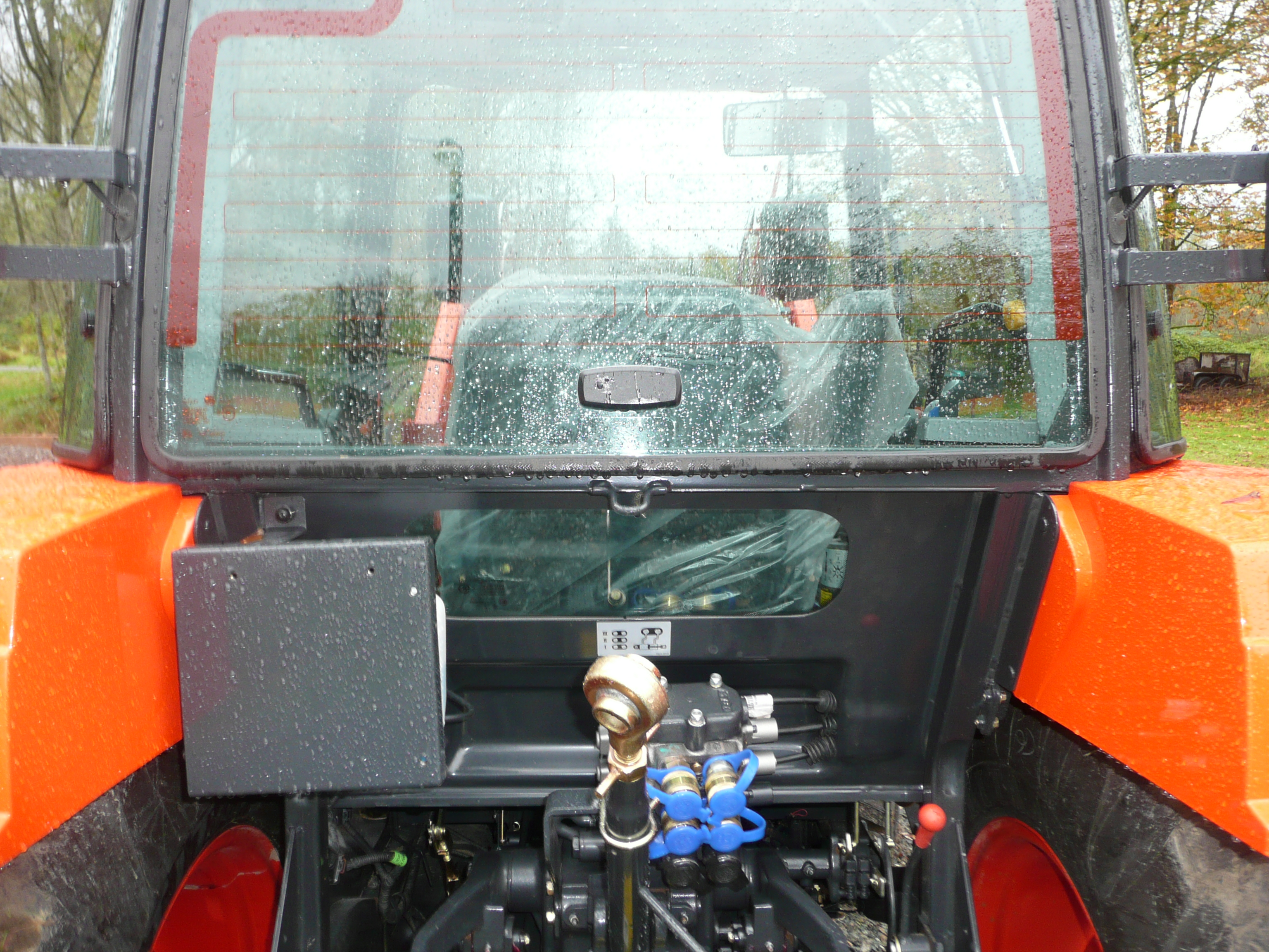

And on the back window, would folks nag the dealer about this? (it seems to function fine)

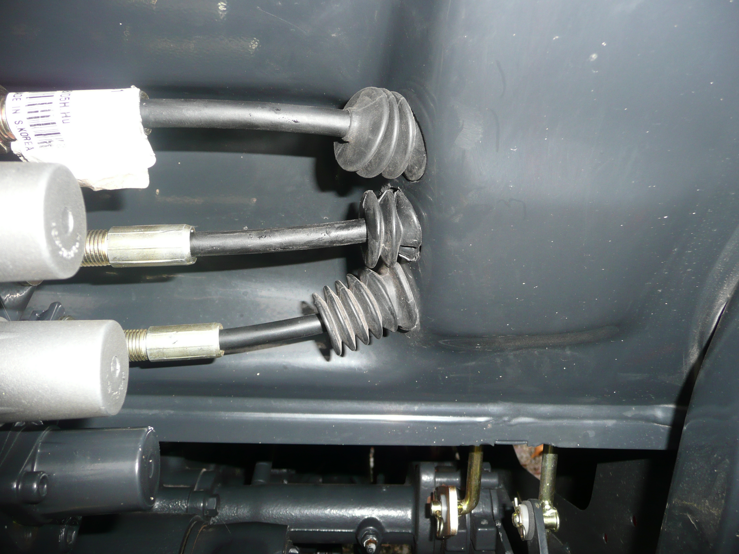

And another nit pick:
The boots on the additional valves' cabling are clear inferior to the stock one (bottom). They don't really seal at all. Should I demand replacements?
Also, the hydraulic stack is twisted (counter-clockwise) a bit: you can see that in my post with the back window.
It's all fairly trivial, but it sure does speak to QA, attention to details: factory and dealer.
/ My NX5510H #66
The rear remotes are installed correctly , as for the boots on the cables they need to be pulled out farther so the ends seal like the lower one.
/ My NX5510H
#67
You're right! They'd just stuffed them in. Able to get the top one reseated. Middle one, however, has a rip in the boot (rubbing due to not being installed correctly), and, I can't get it to seat anyway (too much of MY time here); cable is pinched to far against the edge.

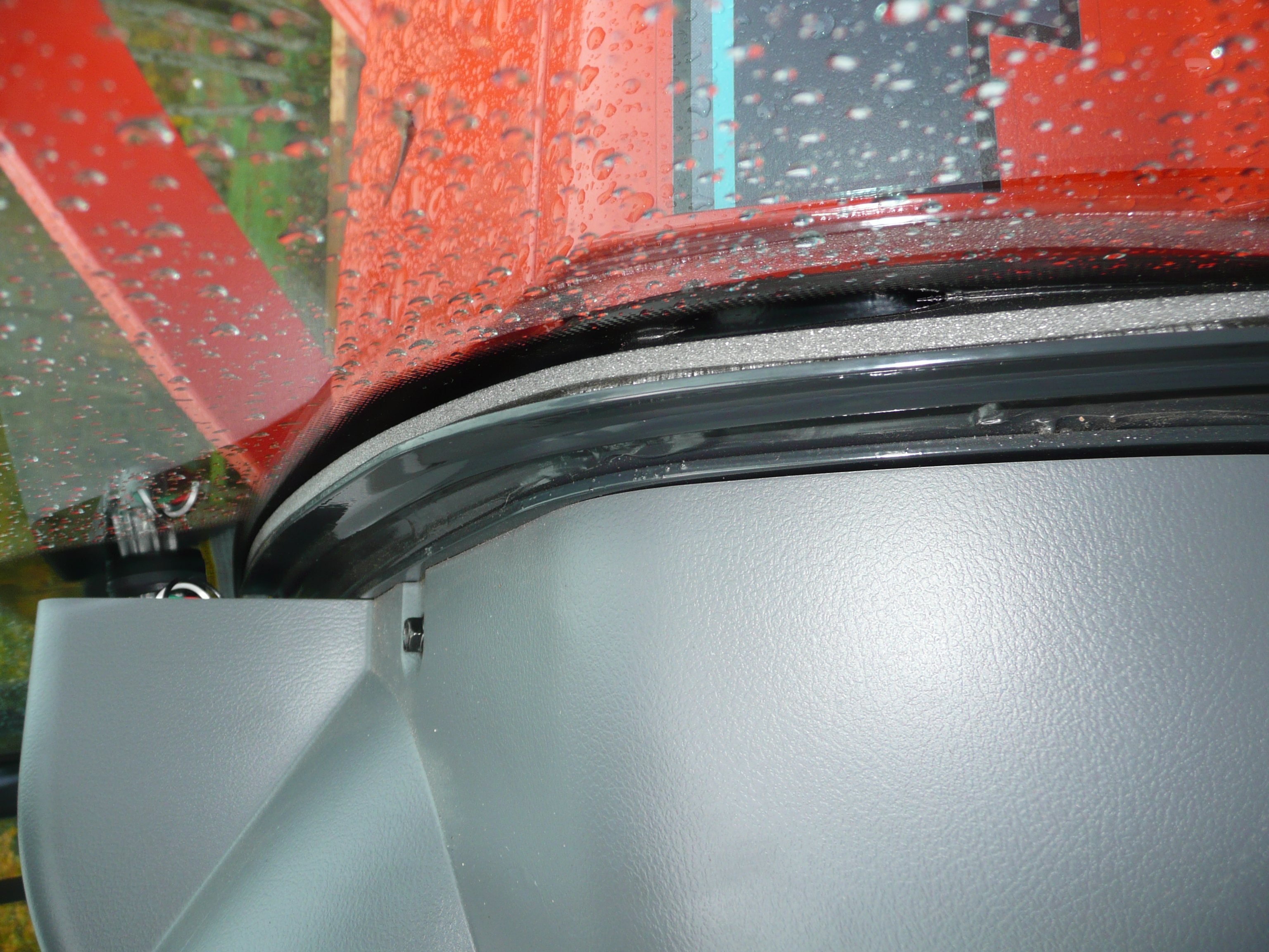

Here's a video of my water incursion (wife spraying water):
[video]https://www.dropbox.com/s/asmcneh3ze3c5mg/P1120622.MOV[/video]

No, wouldn't say it's a disappointment. I'll take these things over some sort of component failure. Operationally everything is fine. Just spread some more gravel with it today; raining and I was still dry- cab leak is minor (unless you shoot a strong stream of water at it). The significant issues have to do with the cab- cabs greatly increase the complexity of things.

Eric, yes, I recall seeing/hearing about that! I think that that was in the back of my mind when I was thinking about whether to consider a quick hitch (one of the reasons I was shying away). Sigh, and I'd sold off my Cat 1 quick hitch some time back.
Just noticed that it doesn't look like your rear window has a defrost element in it. I was surprised to see that mine did. Maybe they're now stock?

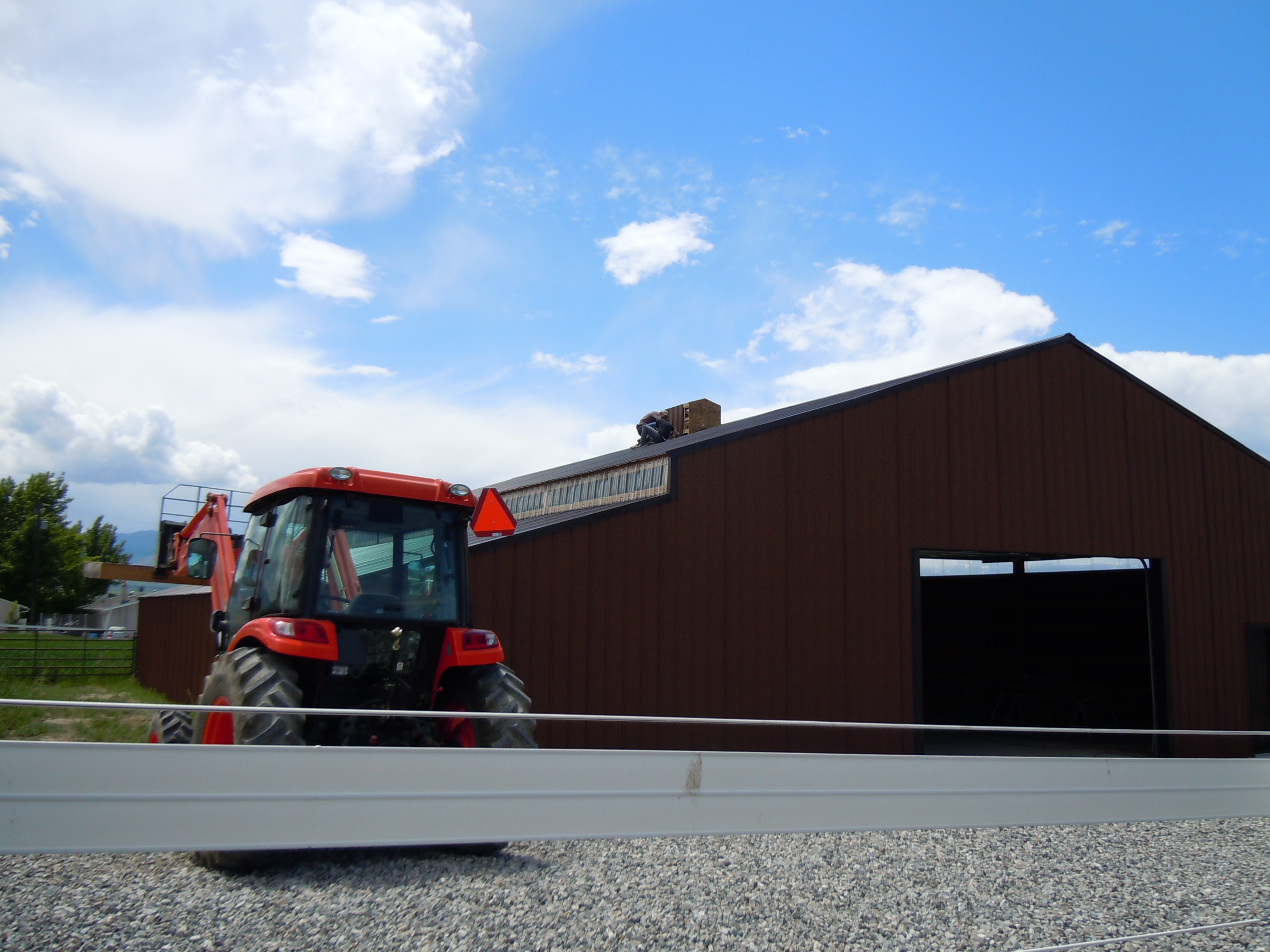

Not sure if the loader arms settle down/equalize over a period of time. Out of fear of you seeking out institutionalization :)laughing:), maybe do some bucket work and then see how it looks? And yes, I'm totally bugged by this; perhaps more so because I don't understand what's going on (though even if I did I am not certain that that would keep me from being distracted by it like it's a chipped tooth [in your mouth]).
Here are a few random shots of loader work I've done.

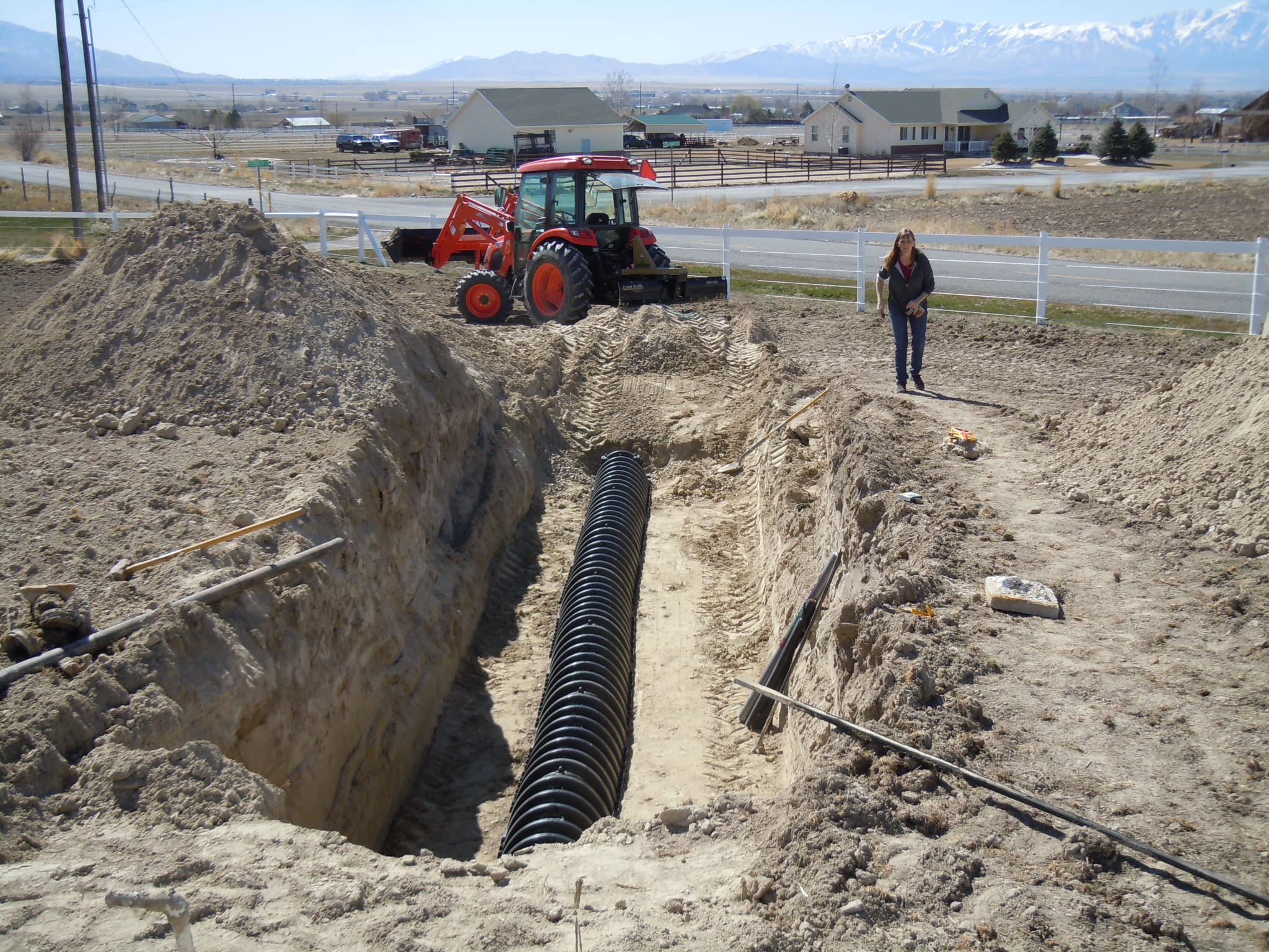

Dug up my leach line with the loader, about 4 hours of time.

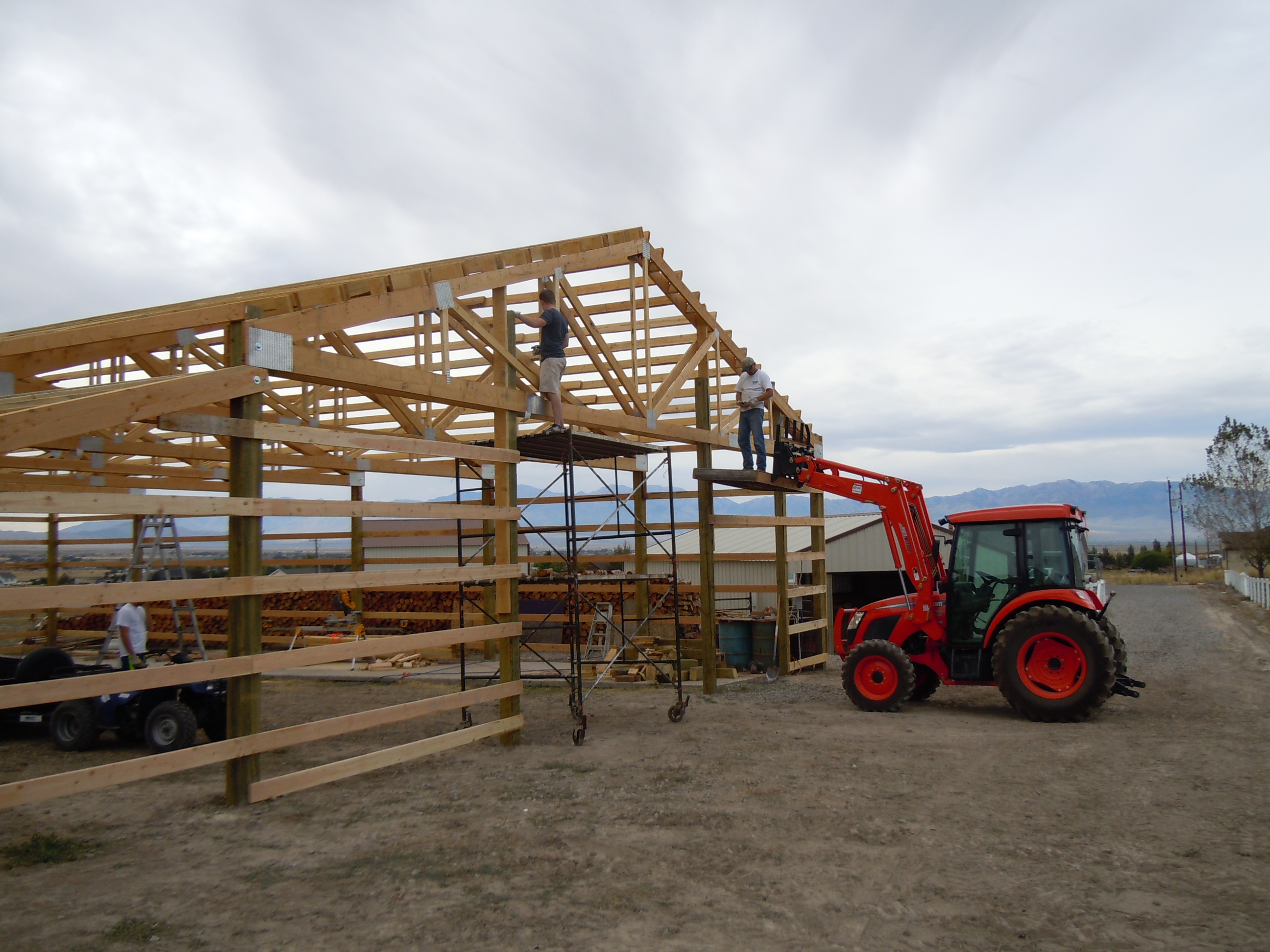

Moved the crusher fines into the barn and smoothed it out, about 3 hours of time.
With the pallet forks on, built the barn, used the loader every day for about 7 weeks.
Not a good shot but the last picture shows the gravel in front of the barn, moved and spread that also.
I love the tractor and have done lots with it as I'm sure you will also. But I think Kioti should at least see some photo's of how crooked the bucket looks---it just ain't right.:confused:
However, like you said; the tractor functions and works like it should, you are going to really love it.:thumbsup:

No option for a rear window defrost was available when I purchased mine, also appears from your pic of the rear service remotes they have changed to a different type of valve.

I don't remember having the option for rear defrost on mine either.
