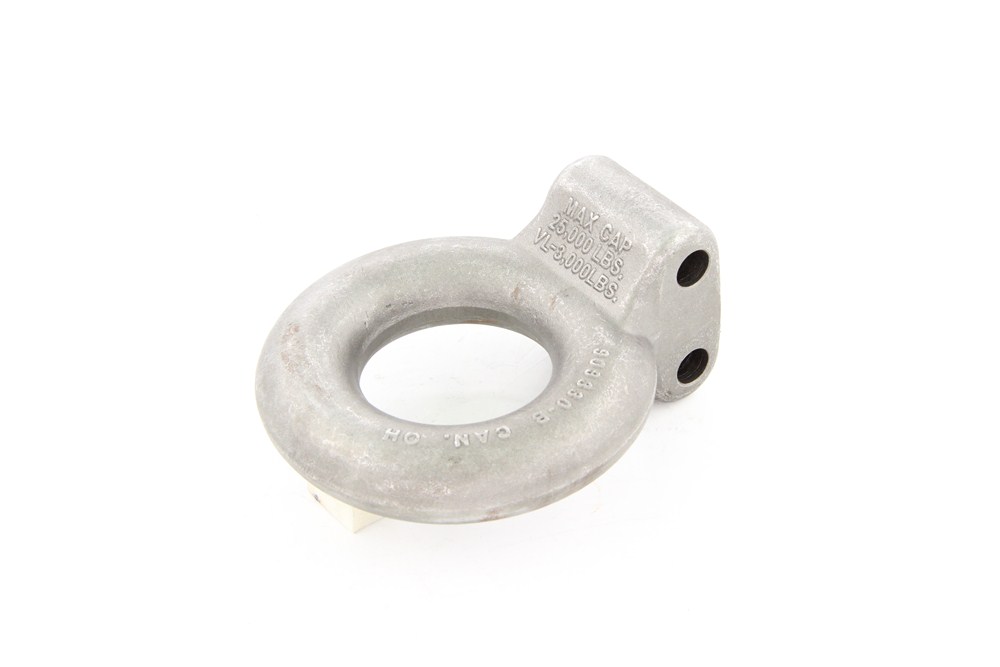

OK, looks like it might not be all that difficult at all. The ball coupler on the trailer can be swapped out with a lunette ring:
Lunette ring:
Would then need to figure out something on the tractor drawbar. Seems that others have struggled with this. Best(?) solution (from http://www.tractorbynet.com/forums/attachments/233690-pintle-hitch-draw-bar-2.html):

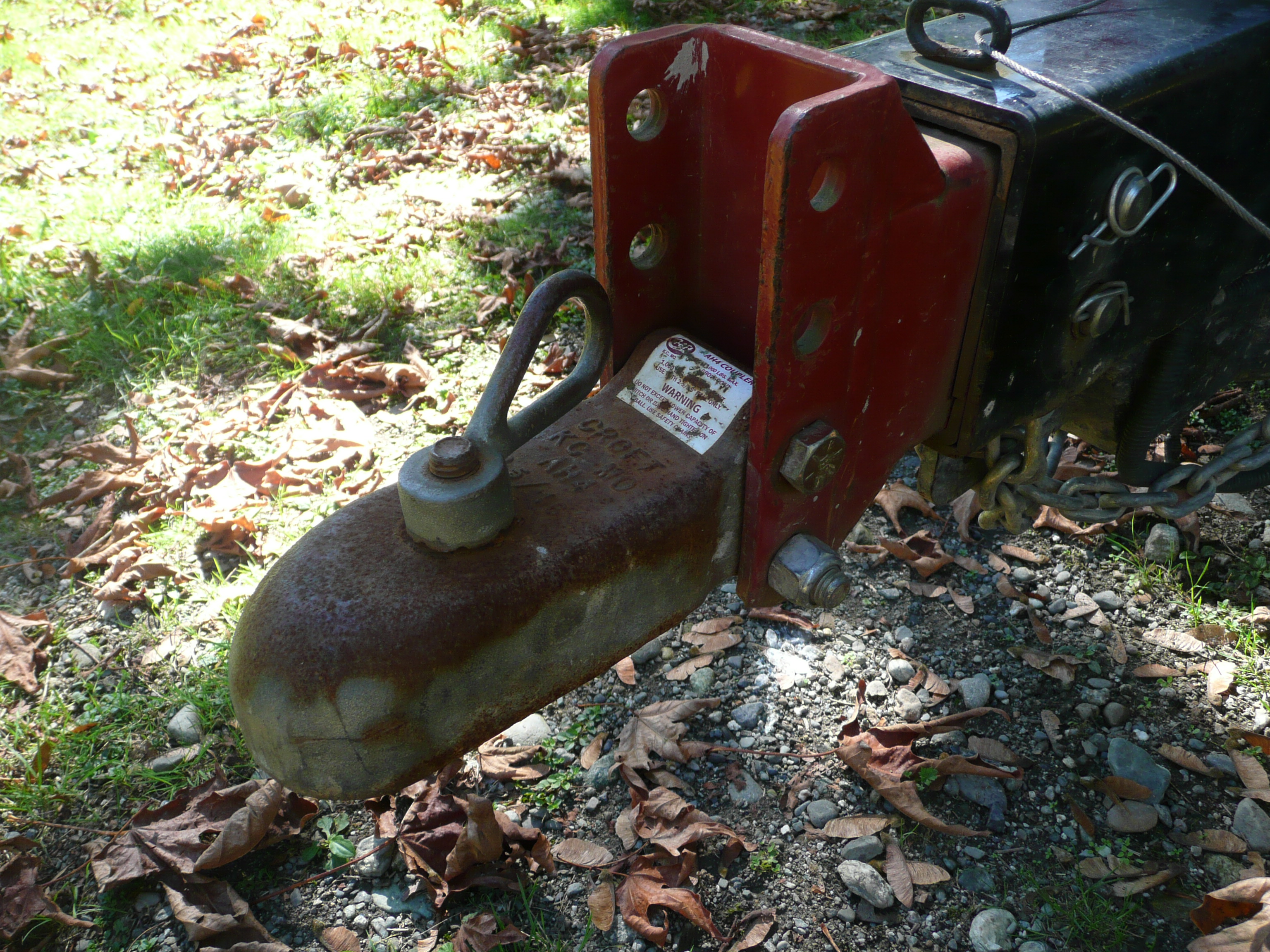

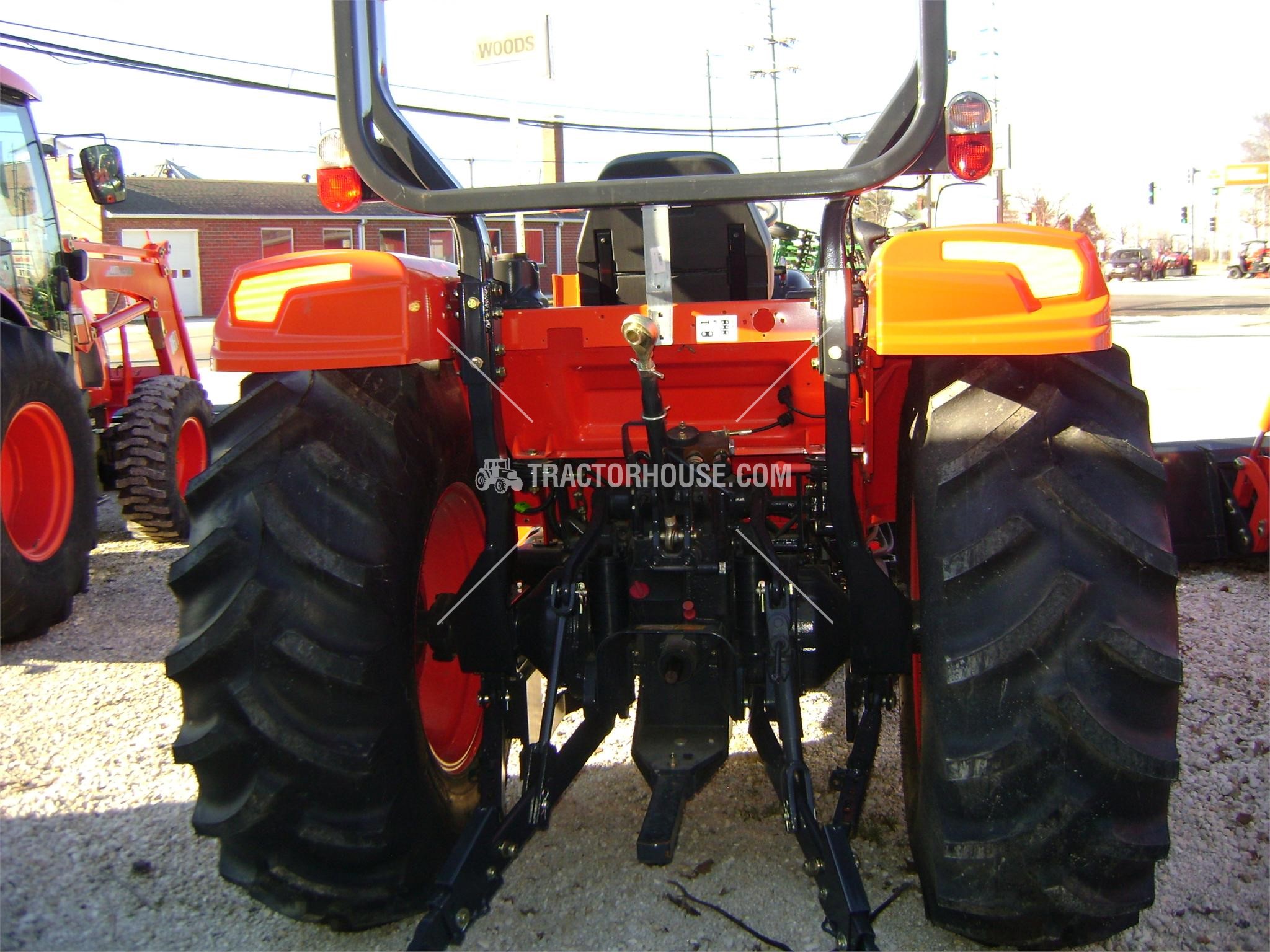

This is turning out to be quite confusing! Here's a picture I found from the Internet (listing for an 2015 NX5510):
This looks like solid a solid square bar with holes.
Yes, the first picture of the ball hitch is of my trailer. Main point is that I can pretty much put any coupler on that that I'd need.
/ My NX5510H #28
Why not just buy a 2-5/16 the ball and bolt on your tractor's drawbar and use the coupler that's already on your trailer? Your new nx will have a solid drawbar that you can bolt a ball on. Here is what your drawbar will look like

/ My NX5510H #29
OK that looks easy to fix.
As you say, getting a towing ring fitted to your trailer is easy. All ours tend to be welded, but that two bolt mount looks pretty substantial too.
Use high grade bolts though!.
To hitch to a ring with a drawbar - it will need to gain what's known as a hammer strap on the top of the drawbar.
It needs to go in a sort of Y shape like the picture I showed before (red drawbar).
It doesn't matter if the bottom bar is straight and the hammer strap goes above it, as long as you have something to lock the pin in with - top AND bottom.
The pin has a collar at the top, and the clevis pin at the bottom.
Your options then:
1. Ignore this idea of using/changing to a pin and ring for your trailer, and just fit a standard towball to your drawbar. Cheap, not as effective or as tough - but will probably do you for a while.
2. If you have ordered the tractor from a dealer - see if they'll just swap out the drawbar supplied as standard for one with a hammer strap fitted.
3. Fit a hammer strap yourself - but you'll probably need a decent workshop to drill the drawbar (tungsten drill) if it's not already got the holes.
Hammer strap can be bought most places, but you may get a good price from the supplying dealer.
A quick search here found a US site selling them - though this does look expensive. We'd expect to pay maybe GBP20 or GBP30 for one (c.$50) e.g.: Order Hammerstrap, Drawbar A-3545-8913 for tractors for sale | Best price 95. | Hitch & Drawbars at TractorTool
I guess it's now only a choice you can make.
Over here, all our trailers for proper tractor towing are pin and ring.
I have gone a step further on my NX6010 for using the ring towed trailers with a "pick up hitch" as you can see in the photos of the back of my tractor...
Unless you haul a trailer a lot, or are constantly swapping them about (like we do) - it's not worth it...
A neat animation of how one just like it works is here: Dromone - Mechanical Pick up Hitch - YouTube
Advantage is that you can hitch up/unhitch safely whilst staying in the cab!
Hope that helps,

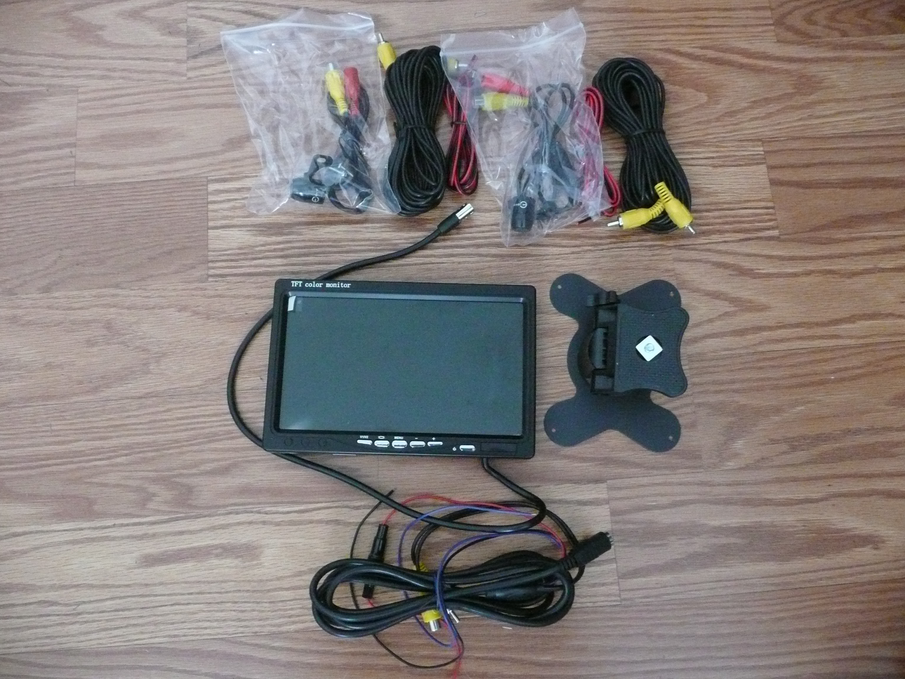

Haven't mentioned (here) that the monitor I got was bad. White screen and nothing else: two different cameras and two different photo cameras and no images on the monitor. Sent it back for another one. Sad, in that the retailers have ZERO ability to provide "technical" assistance, couldn't tell me what the "Menu" button is supposed to do! No documentation. I'd figured that if the "Menu" button was supposed to bring up some sort of display then that would tell me that this monitor was in fact bad (not something that I had hooked up wrong; I'm 99.9% certain that I had things hooked up right- the .1% is in case my mind is failing me :D).
No word from the dealer today, so figure that this is going to drag on for another week. At this point it doesn't matter all that much because we're going to be having a ton of rain for the next week+.
