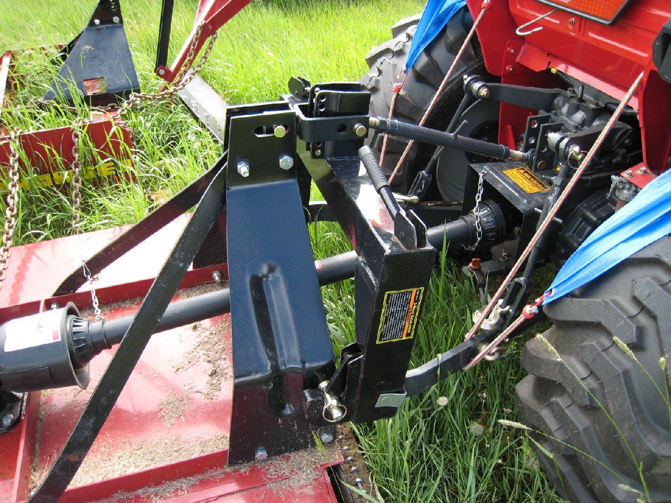

/ My Harbor Freight Quick Hitch #154
"Did you ever go ahead and make a mount for the loader attach points? I'd like to see a picture if you have. "
Yes, there's a picture in the other quick hitch thread in this forum and here's a different picture. Basically, it's just an 11 inch wide by 17 inch long piece of channel iron welded to each side, with the JD pins and hooks welded to the channel.
/ My Harbor Freight Quick Hitch #155
Very slick! Looks good. Did you just weld those pieces of channel to the sides of the hitch, then hold it up against the loader arms to mark the spots for attaching the JD hooks and pins?

/ My Harbor Freight Quick Hitch #159
"Very slick! Looks good. Did you just weld those pieces of channel to the sides of the hitch, then hold it up against the loader arms to mark the spots for attaching the JD hooks and pins?"
Tom,
Yes, that is exactly the process I followed. When I attached the channels to the QH, I set them at a forward angle to allow more curl for the attachment.
