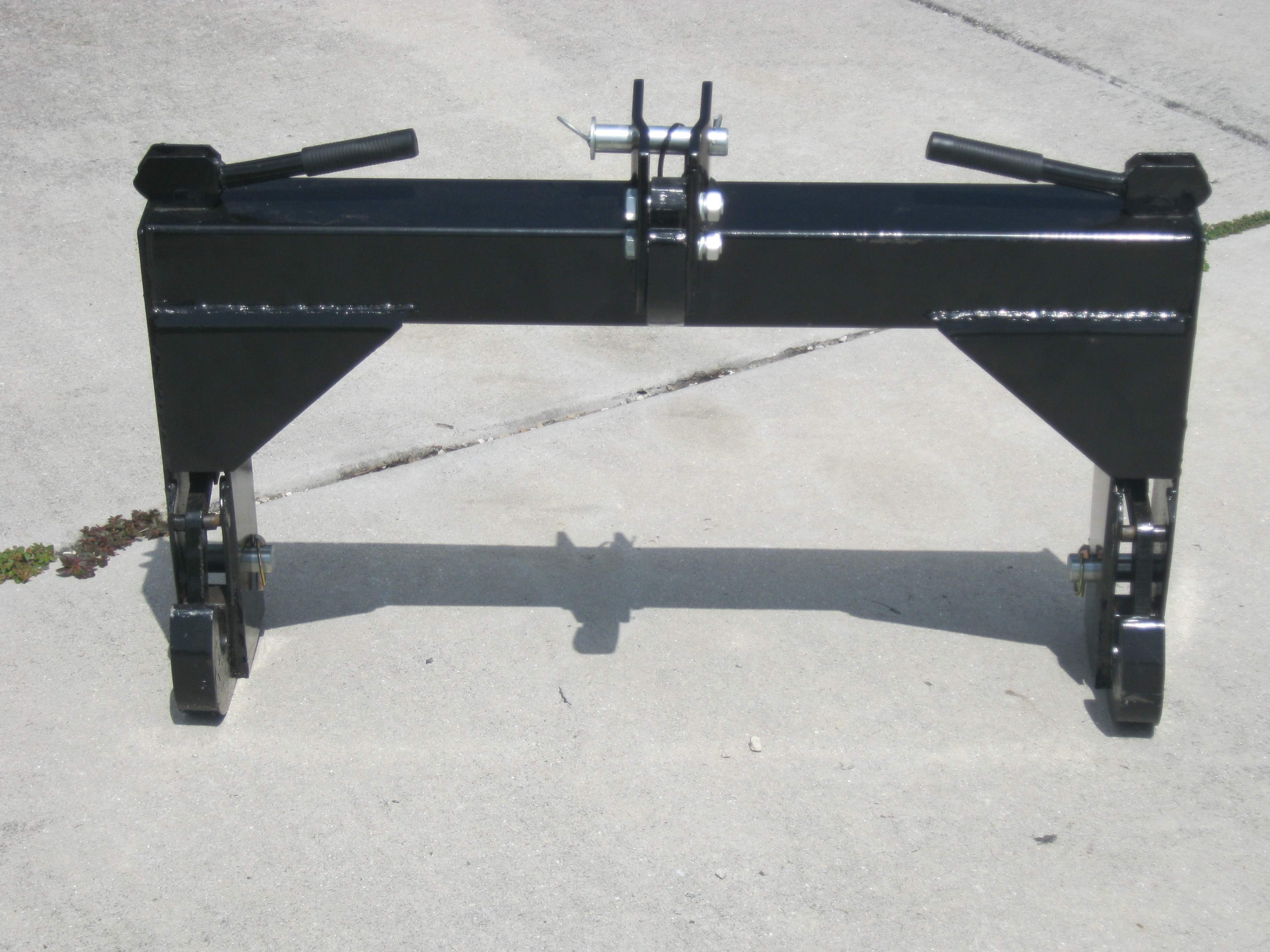

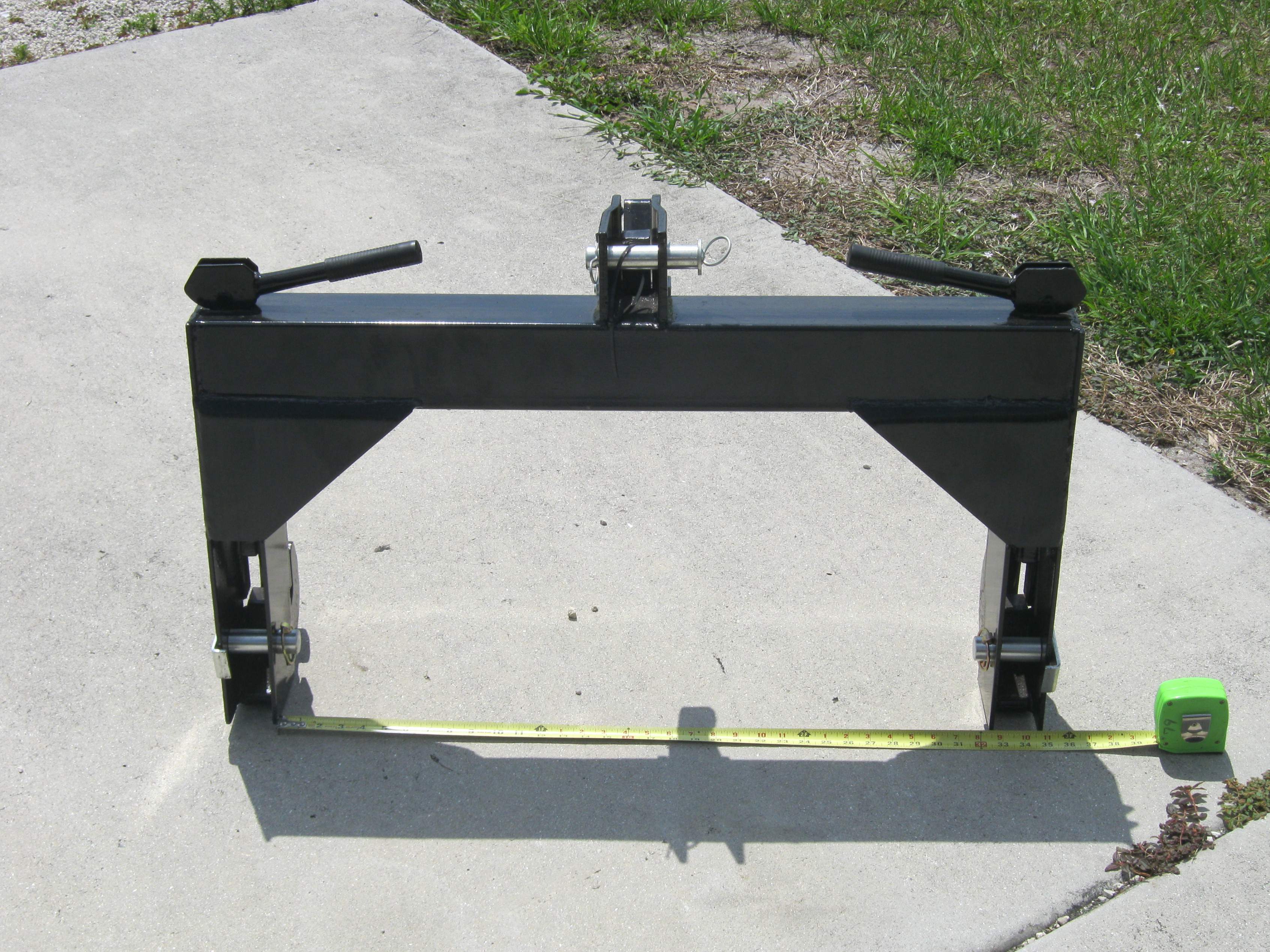

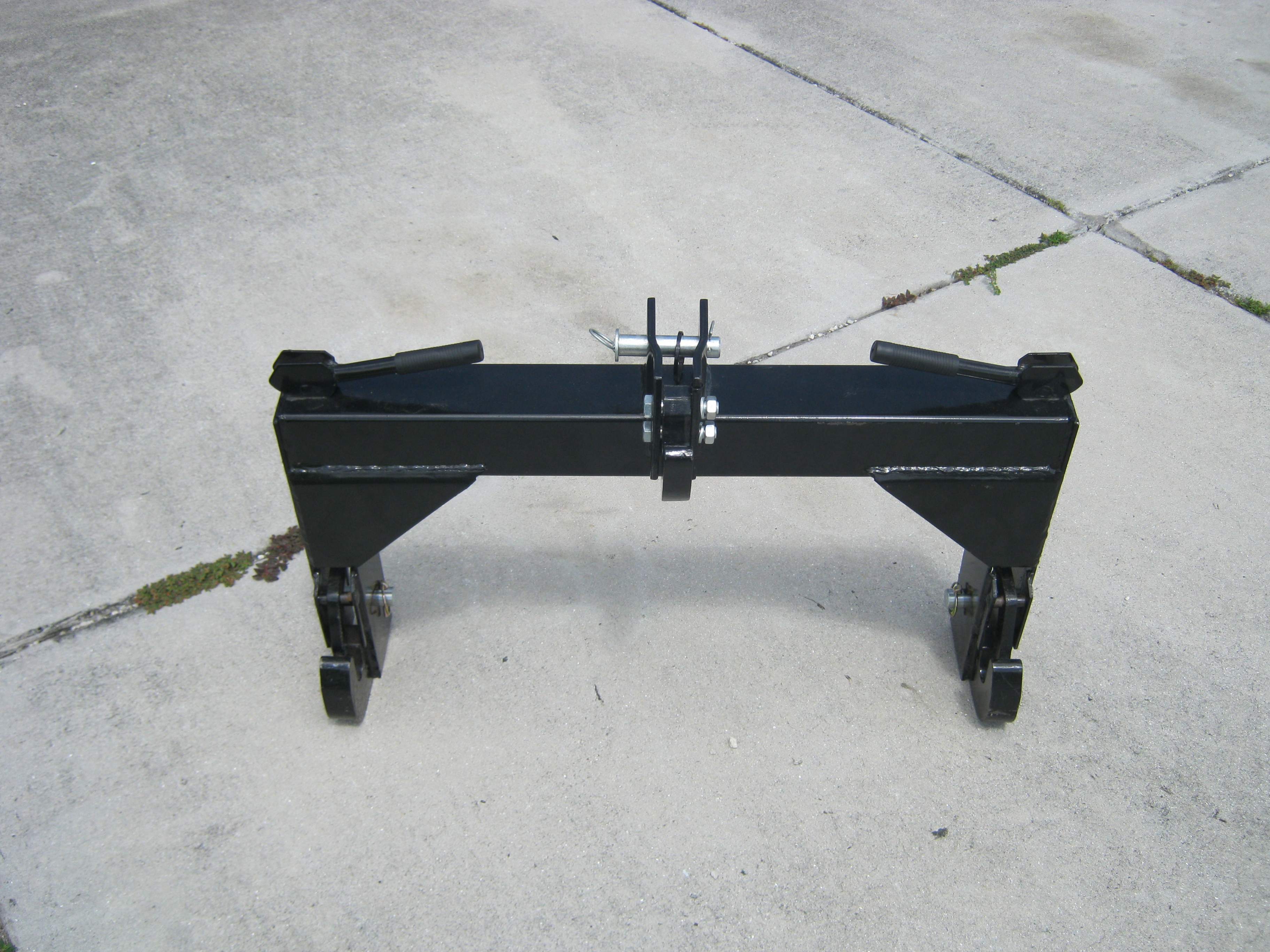

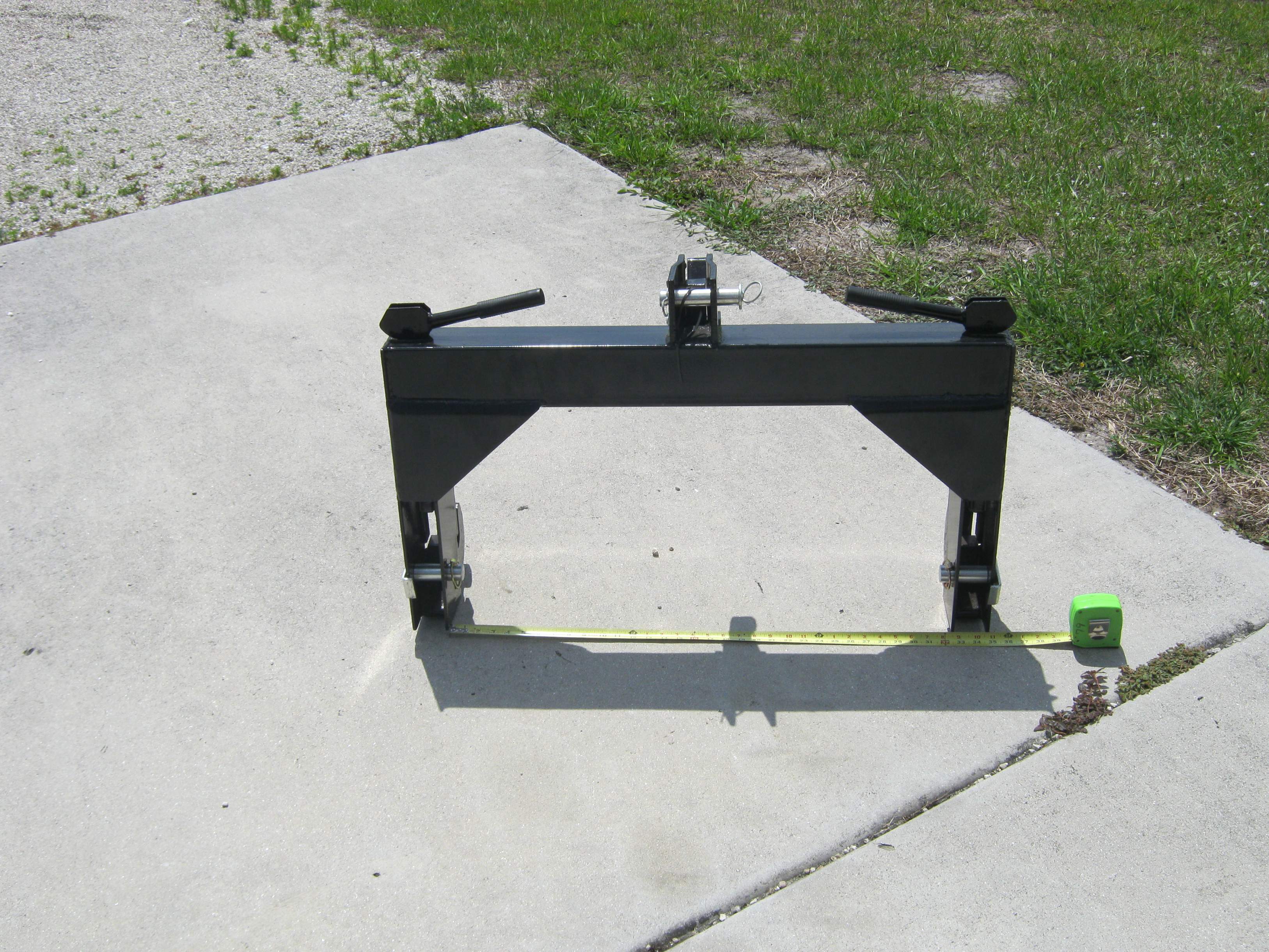

Was in HF the other day to kill some time.One of the quick hitch cat-2's had no price tag like the others.I asked store manager if he would sell it too me for $99 plus tax like cat 1's,to my surprise he said "go ahead take it".Came home with it (little less than $106 otd).:thumbsup::D Boone

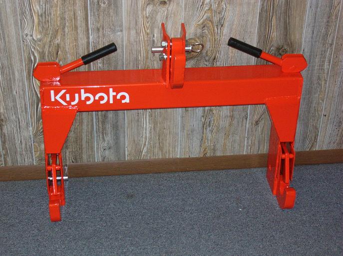

Got mine ready to install.
/ My Harbor Freight Quick Hitch #178
Nice job Countrybumpkin, looks good!
